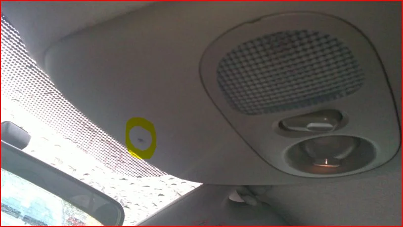

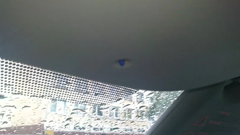

Another sollution would be like its on my dci100 with climate control...no fan just the sensor is on the bottom of the roof panel, like here
