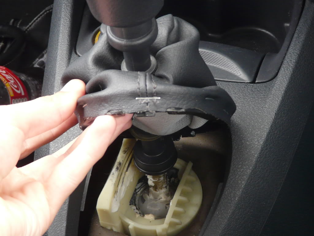

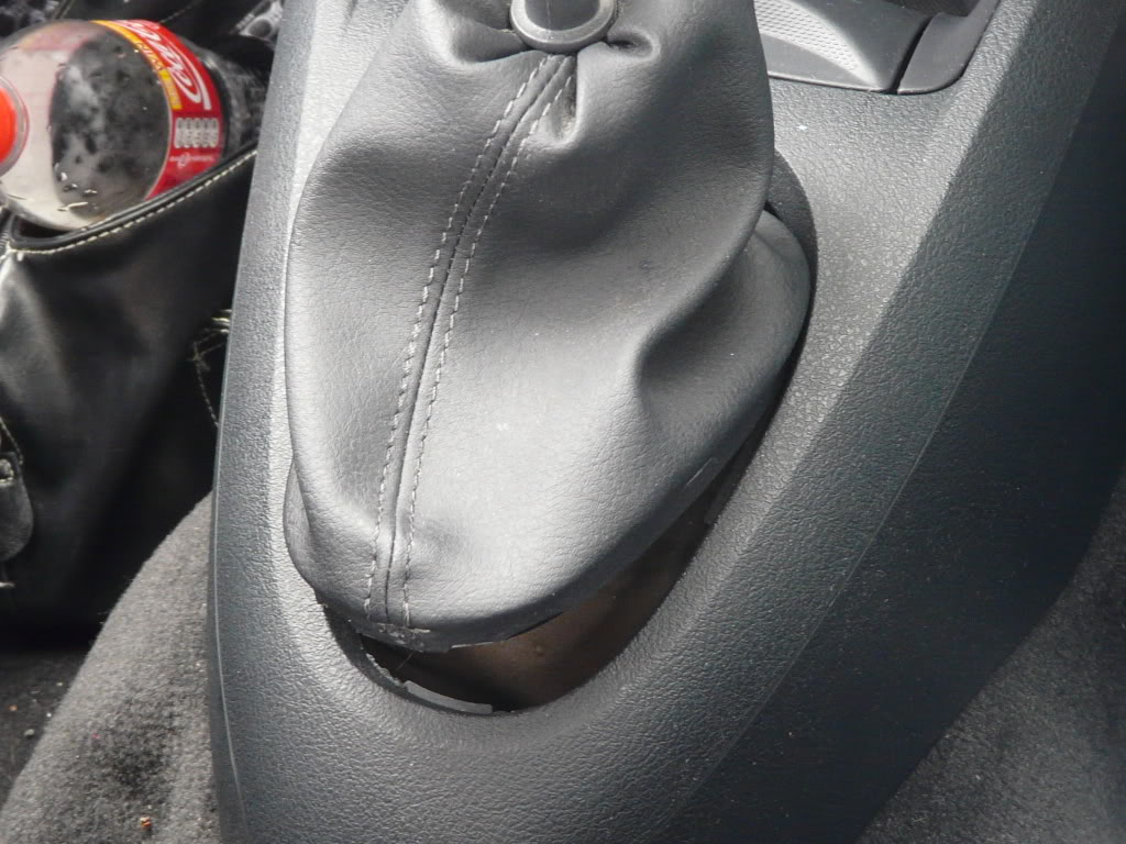

It would seem ive broken the leather gaiter cover on my 182.

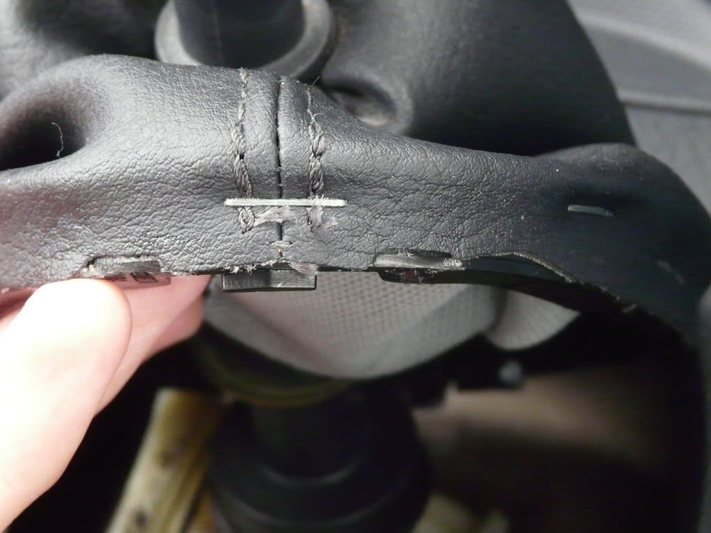

Was at longleat yesterday and when i went to pull away at one point, i put it into first and the whole leather part came with the stick. it came up from the back section at the end. The clip at the front is still in place but it would seem there should be two prongs at the back that lock in under the console part.
pics are here:
Take it that it will need replacing?

Yep, between £5-7 from renault, takes 5 minutes to fit.
One of the better bits to have busted, cheap and easy!

Cut the old one off with scissors. Top has a small zip tie underneath, quite fiddly.
Then turn new one inside out, fix zip tie tight under gear knob and sort out how you want the 'ruffles' . Cut excess zip tie once its zipped up, and invert it and clip in to place.

Fixed mine with a cable tie. Drill a hole for the tie near that staple, then undo the cowel so you can get at it underneath, loop the tie through the cowel where the clip used to go, then through the gaiter, zip it up. Refit cowel, Job done.
