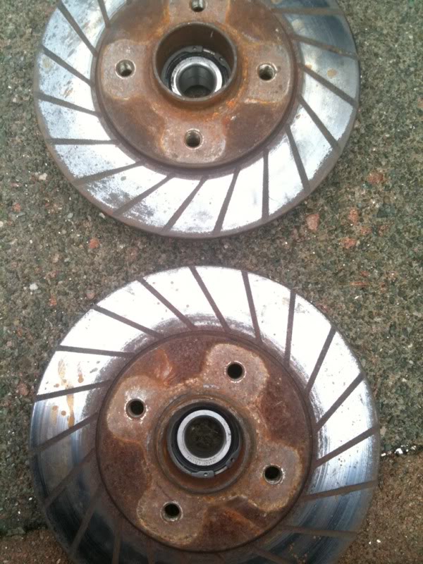

Busy day today... I'm off to Ireland this evening in the car, so I needed to get these rear bearings sorted. Was a bit worried that something would go wrong (as something usually does). Was a bit of struggle to get one of the disks off, but with a little pusuasion it popped off. The rear bearings were clearly bummed as I could feel how rough it was when just spinning the disc. Once off it was a 1/2 mile trek to a garage to get the new bearings pressed in. They are surprisingly heavy when walking with them.

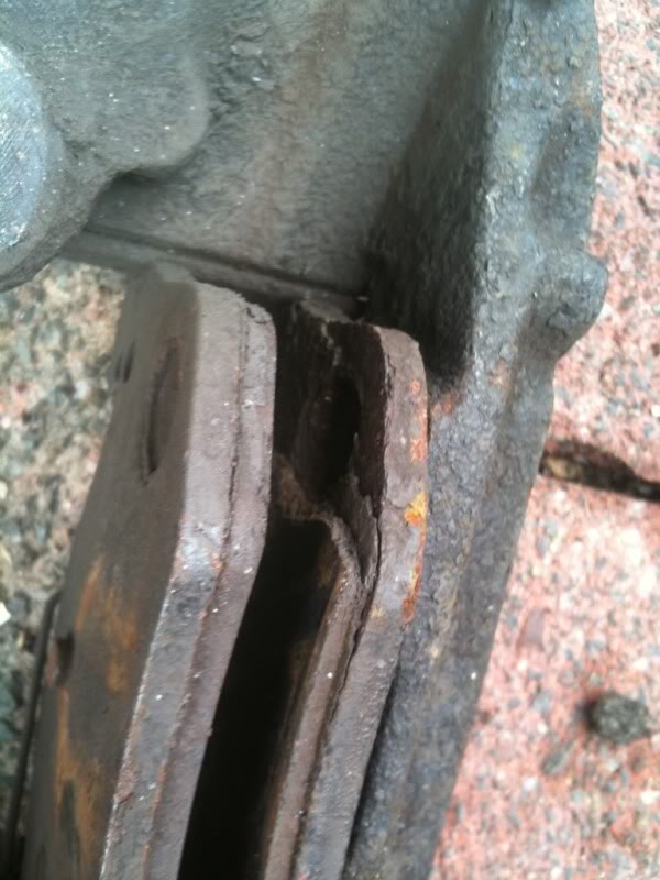

In the process I noticed that one of the rear discs had a strange wear pattern, quickly found out why. They will get changed in a few weeks anyway, and I didn't have time to go looking for rear pads today.

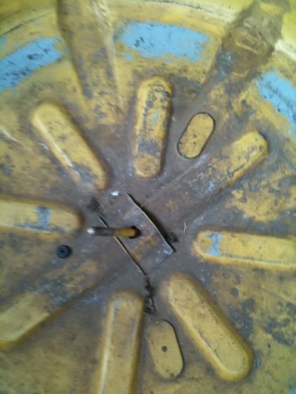

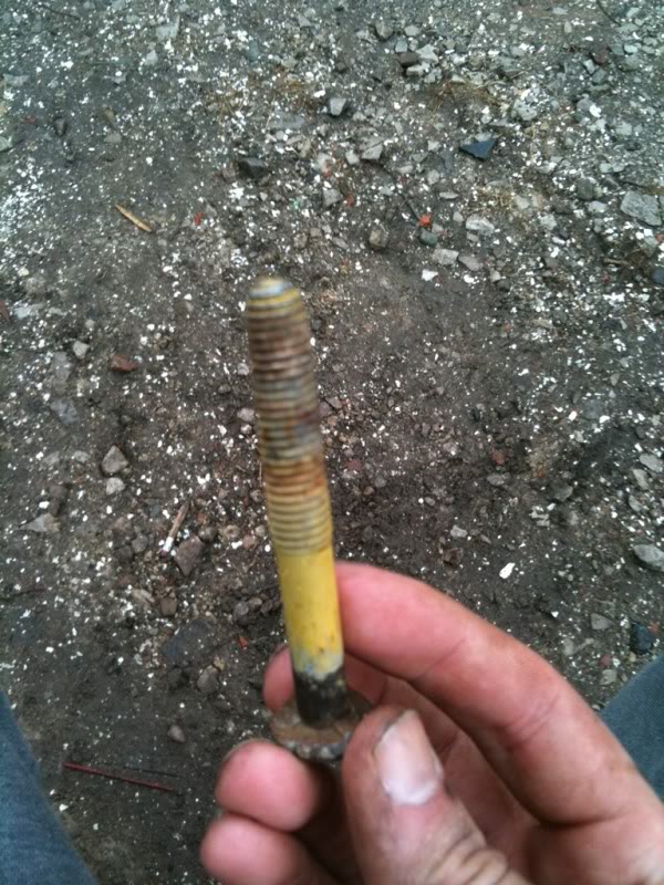

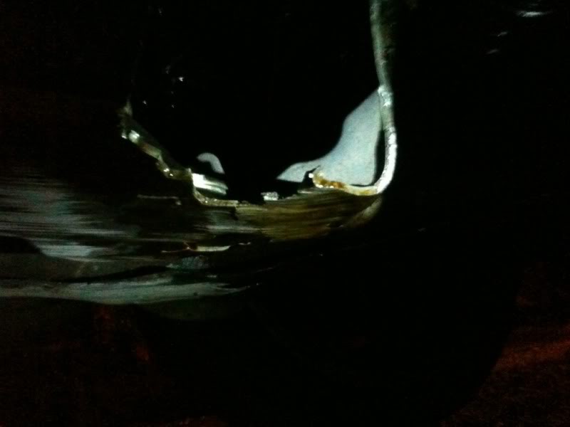

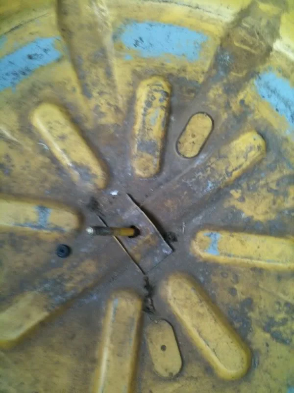

On the N59 between Newport and Westport there is a small hump/back bridge in the middle of a long straight. On Sunday night I was heading into Westport at roughly 11pm (keep in mind how dark it is in the countryside) and although driving rather 'quick' I wasn't hooning it, so I'm not claiming I am blameless. I hit the crest which sent the car pretty airborne, causing it to bottom out quite heavily when it landed. At first I thought I had either a rear puncture or a rear bearing had collapsed as the rear end was all over the place. The oil light came on and I quickly turned the engine off and rolled to the side of the road. Looked underneath to find oil dripping hevily, and oil all over the rear of the car (the oil must have been all over the rear wheels causing the rear end to lose grip).
Recovered the car to my aunties and my cousin and I went about investigating the damage, we found that the entire back of the sump/oil pan had sheared off after a pretty hevy impact. There doesn't appear to be any damage to the pickup (although the pics don't show much). I decided after much headscratching that the best thing to do is get hold of a sump and send it over, and have my cousin kindly fit it for me.
After a latnight phonecall to f0xy he told me that where the oil pump and pickup meet, it is common for there to be damage after an impact. So I'll be sending over a spare pump and pickup just in case. I'll then catch a flight and bring the car home.
HOWEVER.... I had a great holiday, and I'm not as annoyed as I thought I'd be. I was massively impressed with the car, as were my cousin and his friends (who much prefer Jap/German cars). After taking them out for a ride, and giving my cousin's Celica GT-Four a run for it's money on the straights and twisties they are now converted.
The damage: Sorry for crap quality

Honestly?.... Yeah it was fun! New sump/pan on the way, the I'll post it off to Ireland.

Looks like you grounded out HARD!!!

Yeah, it's not 'that' bad really, it's a relatively simple fix. I'm very surprised I didn't damage anything else to be honest. I'll be sure to inspect everything (or get my cousin to). when being towed home the car felt ok, but for obvious reasons I couldn't start the engine.
I had a quick drive of it and found the power great, but it felt heavy. It was a bit of a mess in the bends too, as it seemed to have quite soft suspension (especially compared to a 172 on coilovers). Barely saw any clios over there, and no 172s. They are almost unheard of over there, and it did impress.
I hit the ground from quite a height by my guessing. There is a few scrapes on the bottom of the bumper, so I reckon I've gone down at a bit of an angle. I had a good look around underneath and it looks like the sump took all or most of the impact. Everything else seems ok..... Scene points? haha

As most will know, the rear bearings on the 1*2 is insude the rear disk, this means they are essentially changed every time you fit new disks (those that are supplied with bearings). I changed the rear bearings a few months ago, which is a relatively cheap job. The disks had plenty of life in them, so I opted to just get fresh bearings pressed in. I used the following item:
http://www.ebay.co.uk/itm/120690676835?ssPageName=STRK:MEWAX:IT&_trksid=p3984.m1423.l2649
After a few months, one started humming again. I thought this was down to just not being the correct torque. I put off changing it for a while, and strangely it stopped making a noise. I wasn’t too worried, but was conscious it needed changing. I was warned by f0xy that if the bearing completely fails, then the wheel can essentially fall off, although the wheel could be held in place loosely by the disk and calliper.
I eventually decided it was time to get it sorted, and changed the rear disks this weekend, genuine Renualt parts, with bearings included. The reason for this thread is that I noticed just how bad the bearing was, once I jacked the car up.
According to Ryan at NWP – the hub nut supplied with the original kit isn’t correct for the car. It’s just a general nut that is shipped out with every kit as it fits various vehicles. The nut doesn’t cover the whole bearing, so you need to either re-use the original nut, or get a genuine one from Renault. Which I’m told is roughly £1-2.
So if your bearing was making a noise, but has stopped, jack up the car and check for play.

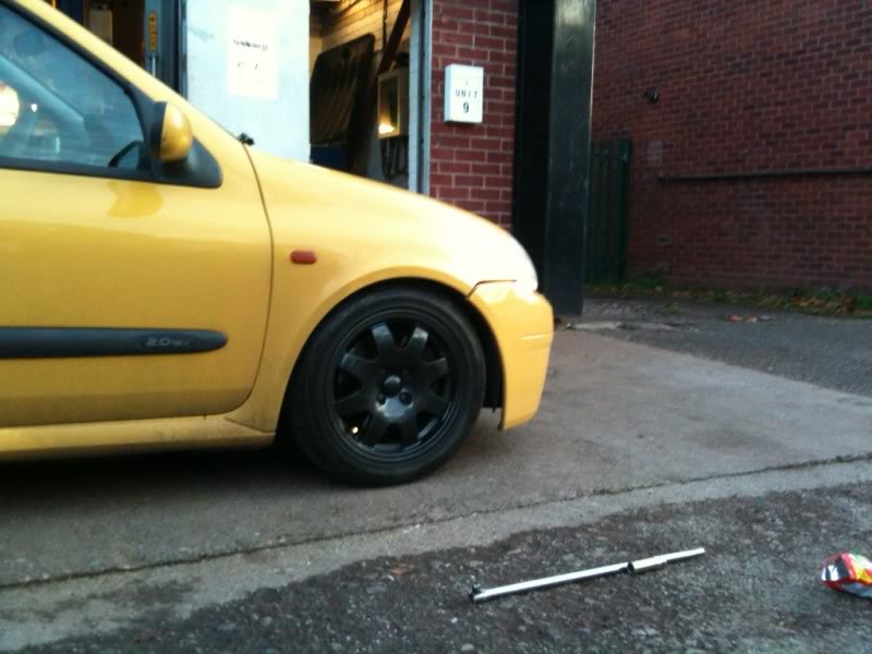

I've always been fond of the Williams wheels, and as I was down at NWP last week, I decided to trial fit Adam Anderton's whilst I was there with him. I wouldn't go for this dark of a colour (dark grey, fading light in photo) but I think they suit the ph1 very well. I'm tempted, but I think it'll be something for next year.
Yes the car was filthy, hadn't been cleaned in over a month.

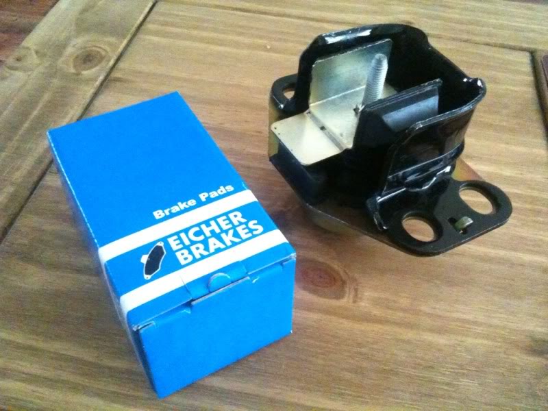

Finally got round to changing the engine mount and rear pads fitted with thanks to f0xy, also sorted out the front bumper. However, we could't get the hub nut loose, so will have to attack it with an air gun at some point next week and change it next weekend.
