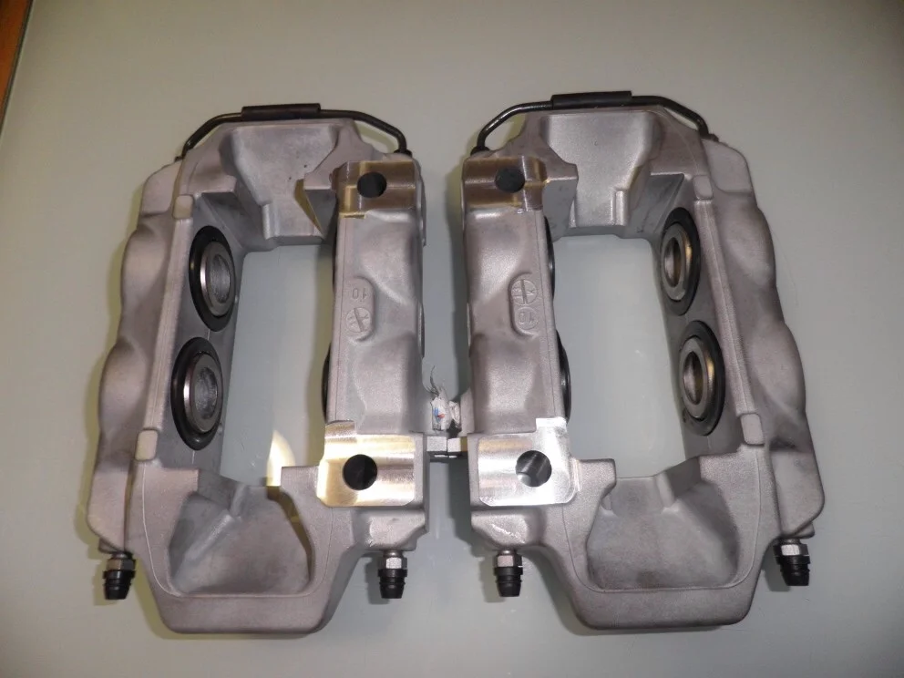

i really need someone to help me out here with this.
I've been quoted £100 to knock back 5mm off the mounting points, plus they say the calipers will get marked as they will have to be clamped.
I've bought them new so i don't want them scratched or marked. if i did then id have gone for used set.
who here has had a decent job done and where? anybody?

I'm assuming they are suggesting due to the odd shape clamping will mark the Caliper
thanks. need this doing, two on each, i don't mind paying some postage as long as somebody can guarantee they will look after them and not scuff them up,
he didn't seem that arsed that I've paid top dollar for brand spankers, said he can 'maybe' put some paper in to help it out, 'no thanks mate ill go elsewhere

It'll have to be clamped across the cylinders on both sides.
And something will have to be put in between ( where the disc goes) to stop deformation.
Could be clamped with some not too hard wood or something.
Although putting pressure on a powdercoat is always a risk.

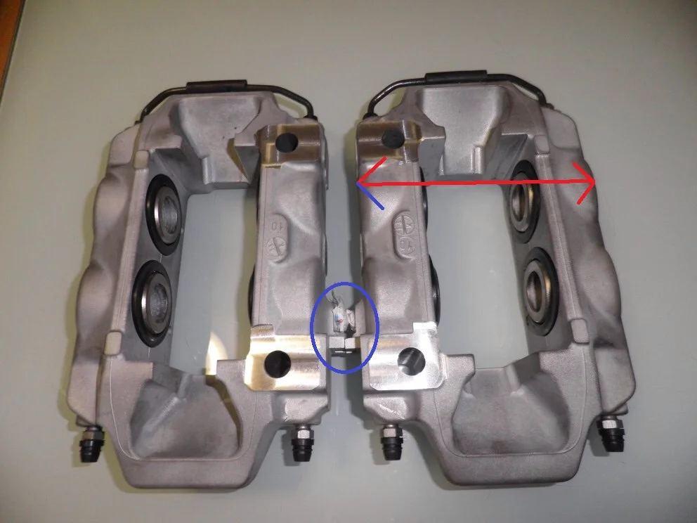

I think looking at the very odd shape it was probably a good shout by the engineering company saying beware we may damage powdering coating.
they are going to need to be secured some how

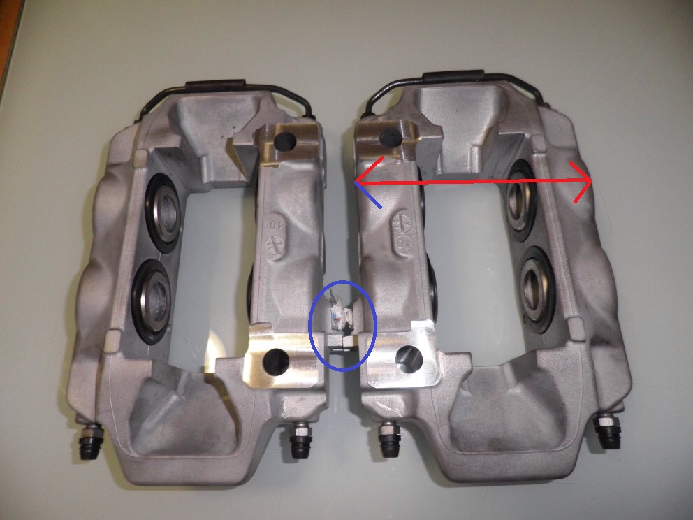

what is the width of them - red arrow below?
also as circled in blue, that's a bit of a fooker for putting in a vice

subject to their width I could put them on my manual mill and do em. think my vice on the manual opens to 120-150mm
but as everyone is saying marking is possible

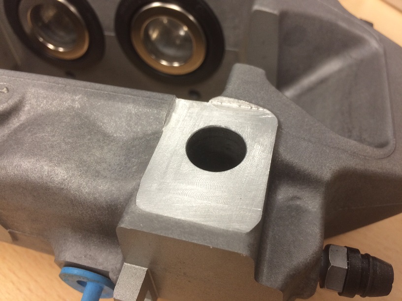

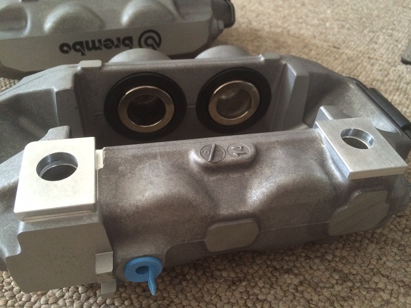

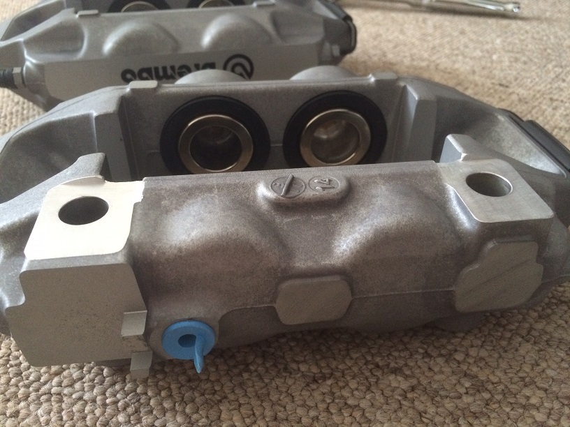

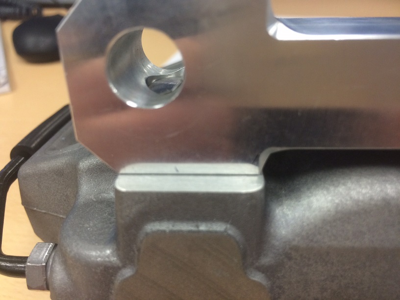

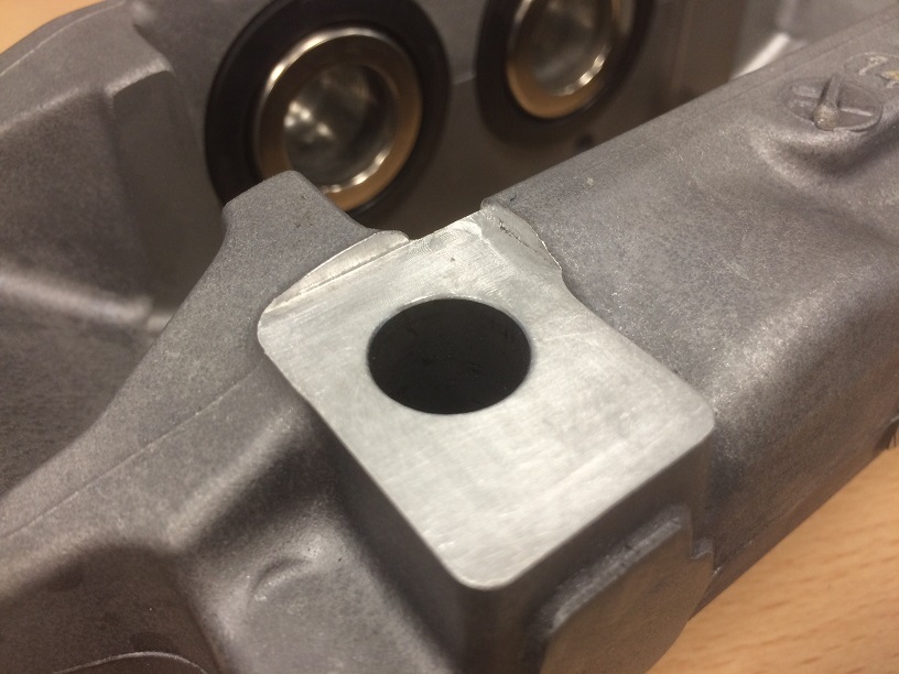

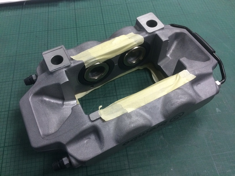

i did the milling today in one caliper at the moment for the 280mm disc fitment. I think everything went well.

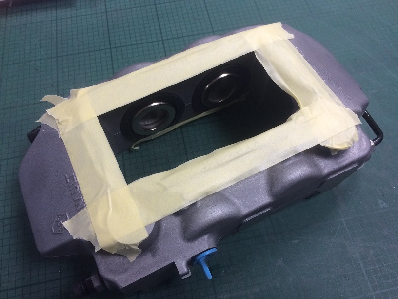

Some masking to protect the caliper

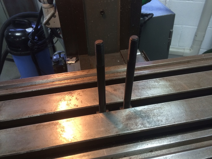

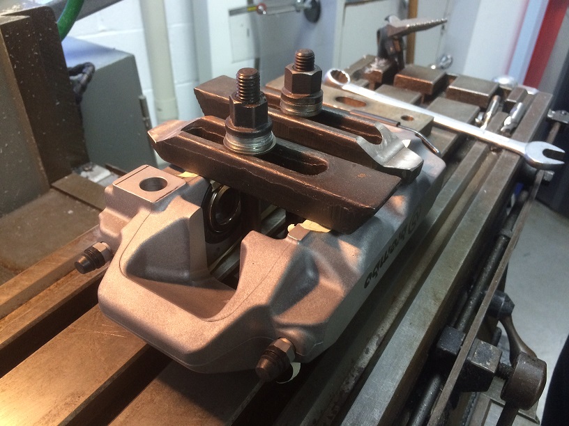

The milling bed

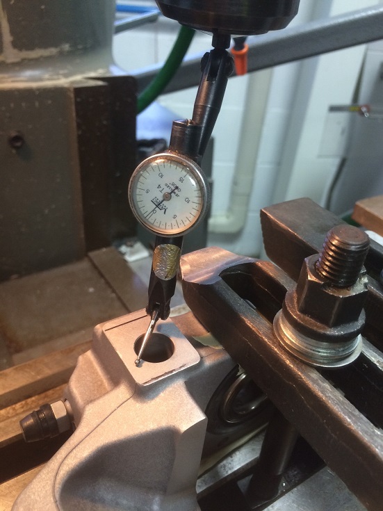

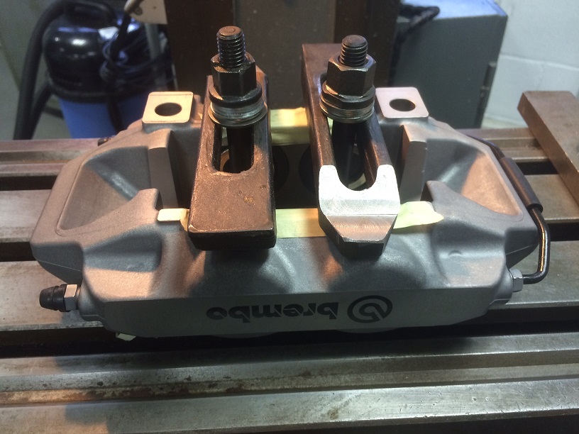

Holding them down. i decided to hold the down like that and not across the pistons to eliminate any deformation / damage to the caliper
Clocked to make sure that is even

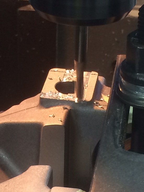

Job started

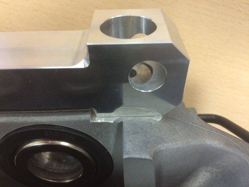

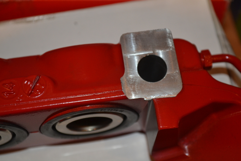

End result ( 5 mm off)
With the bracket

is not a hard job. The hardest bit is to set and make sure that the caliper sits square. it took me an hour to do one caliper.

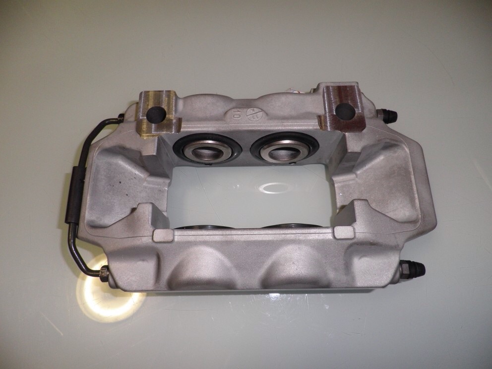

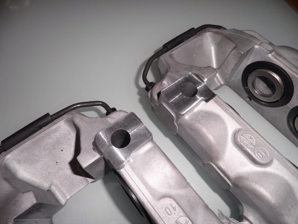

Small update. as i have access in a work shop here where i work i had the change today to make 4 spacers for the calipers. These spacers replacing the 5 mm that i had to machine out from the calipers. Picture with the spacers on the calipers will follow.

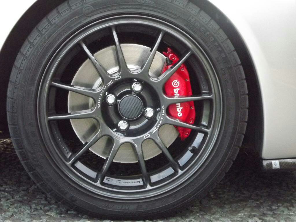

hi mate, are these 197 calipers? or 406?
also is your objective to fit with 15" rims or 16"?
Chris Powell made his own brackets to fit 197/200/225/230 Brembo callipers with 280mm discs and 300mm discs, the former needing 5mm milled from the brackets in order to fit under some 15in wheels.

If you are using 280mm discs obviously you will need the 280mm brackets and you will need to machine 5mm from the caliper bracket mounting phase as you see from the pictures above.
