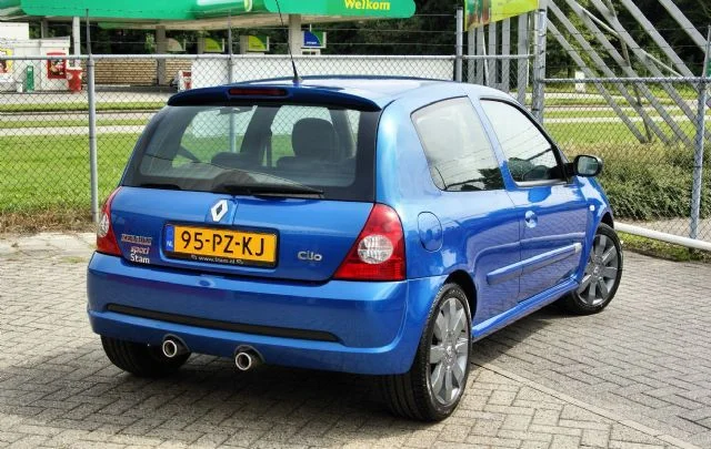

Hi, I have had my 182 for a few moths now, and I'm loving it!

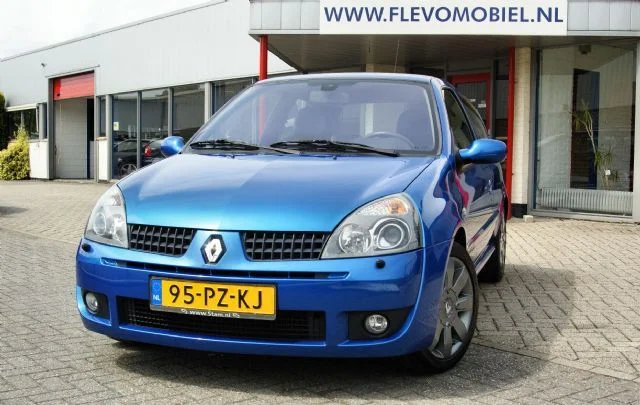

this is how she was at the traders:

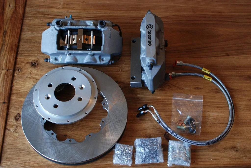

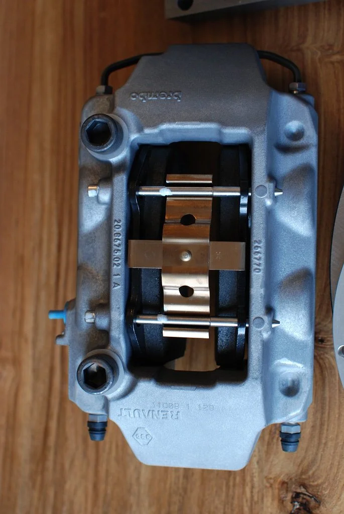

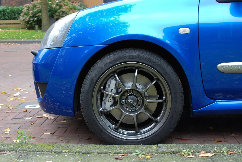

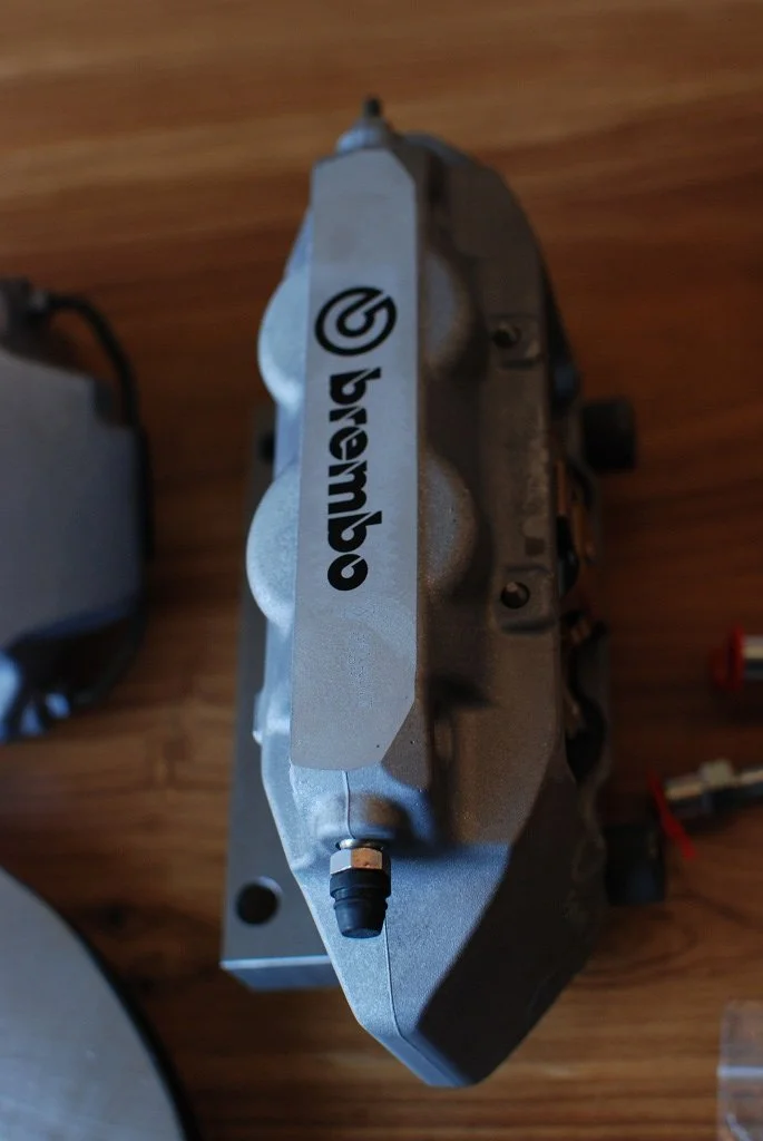

This is the brakeset I got for it:
Said brakeset fitted:

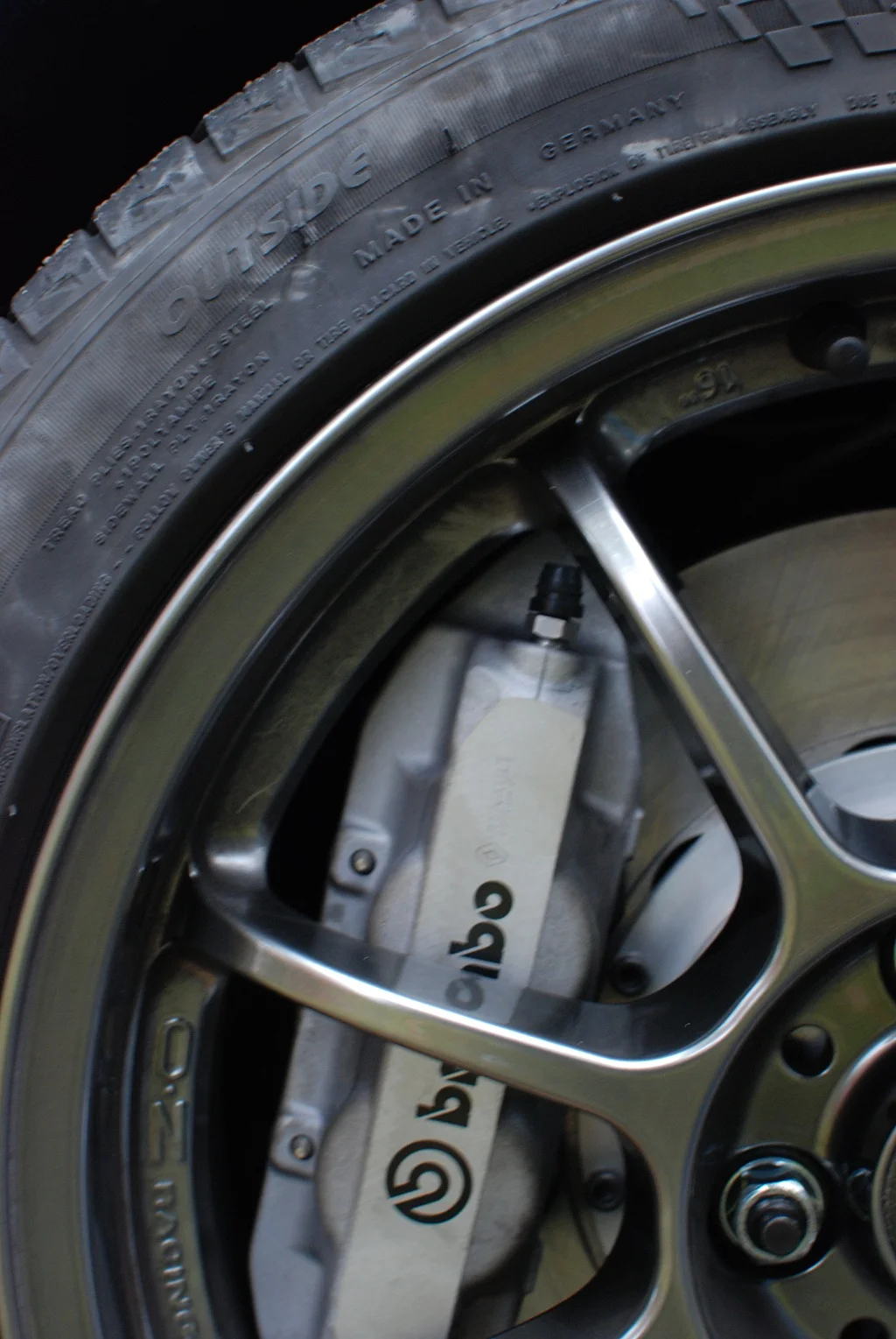

The wheels are OZ Allegeritta in titanium tech.

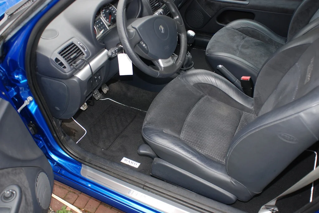

and this is the Yanoo fast road shift fitted, for reference the car is is 1st gear:

The brakes are off a Megane R26...the complete set came from Rikus automotive he's a trader on here....needless to say it brakes really well :evil:. can't get a fagpaper between the wheel and the caliper though.

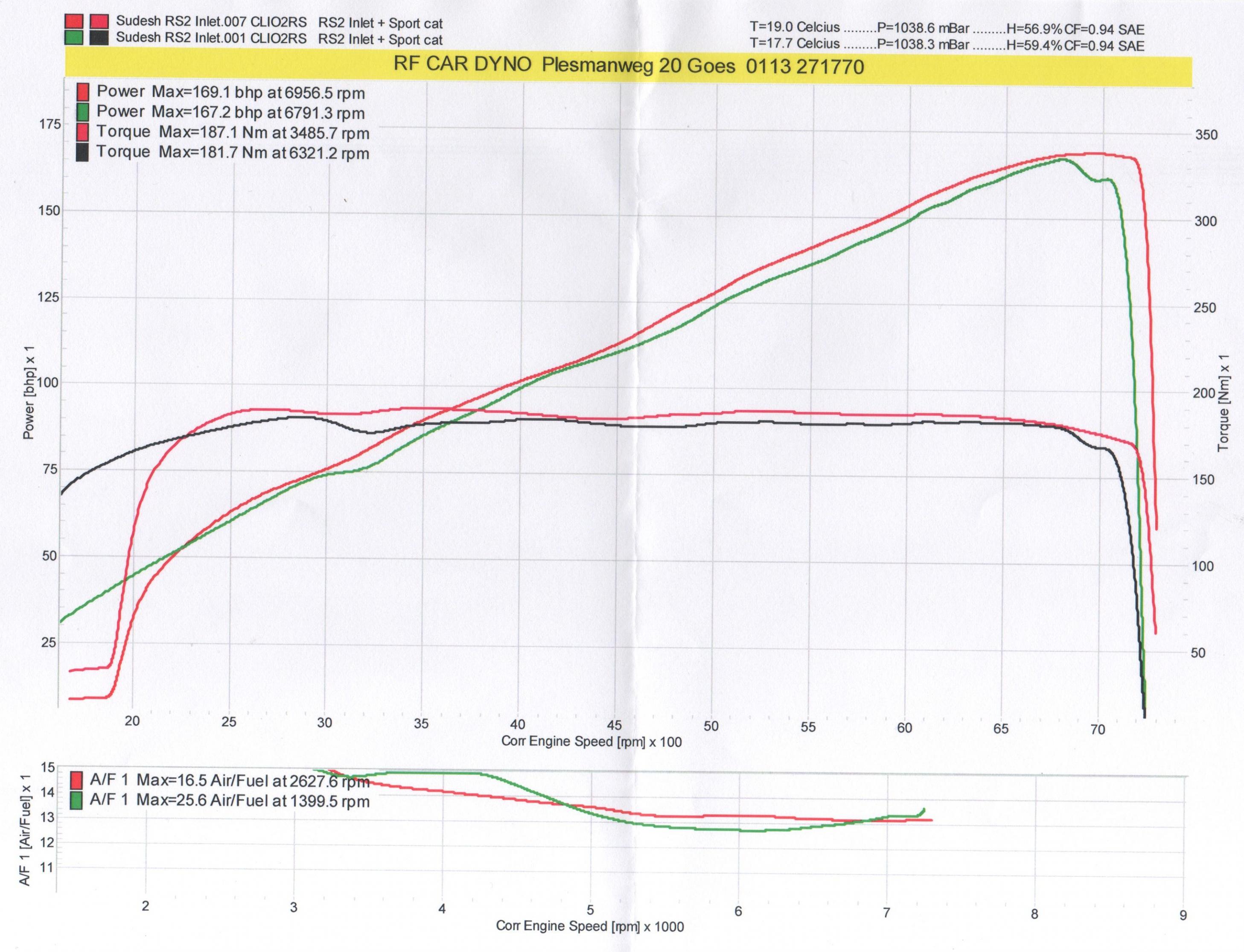

I fanally put the RS2 on, mapping on Sat 10/02
Putting it on was a lot of seat and tears as i'm not a experienced mechanic, and i made an error which I still have to fix....
bozothenutter
well she is mapped and I'm well pleased, it is a different car, the torque boost down low is veeeeeerrrrryyy nice.
It was mapped by Henk of fastchip.....he's a very quiet bloke that just gets on with it.
169 hp at the wheels
  e92 + E46 M3 + Cup
Glad you managed to get it all on & running :)
Results look great! Over 195bhp at the flywheel :cool:

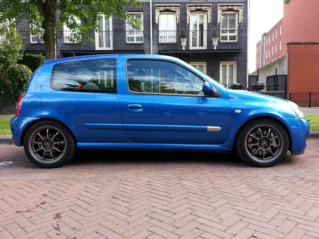

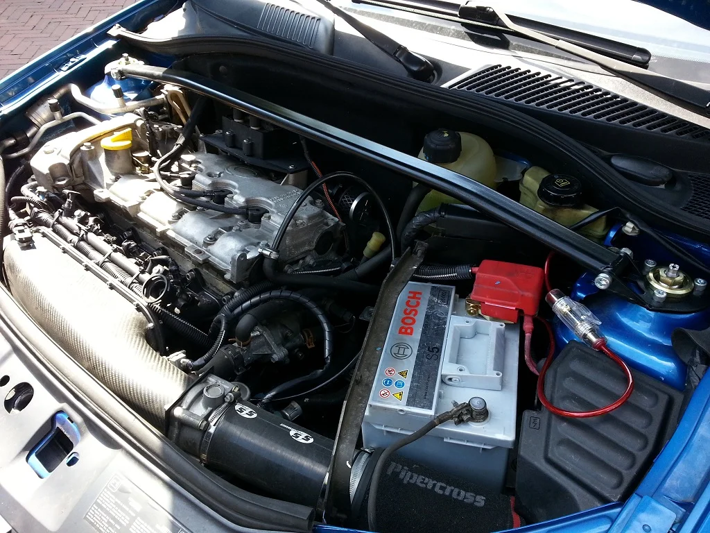

Got me some spax and pure topmounts/strutbrace.
20120706_164809a.jpg the strutbrace

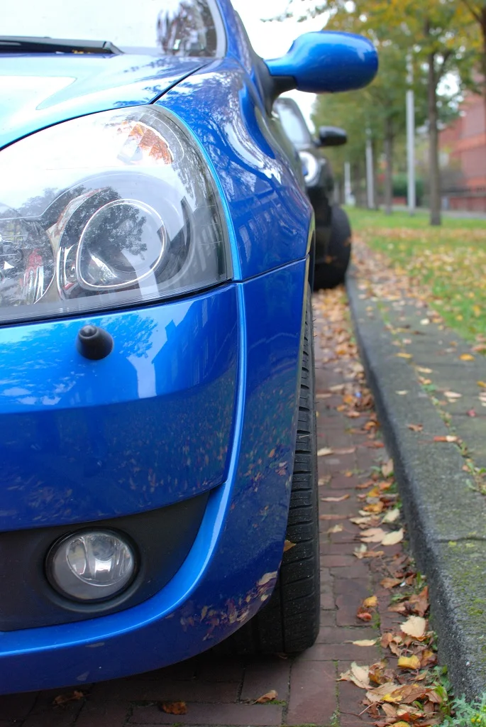

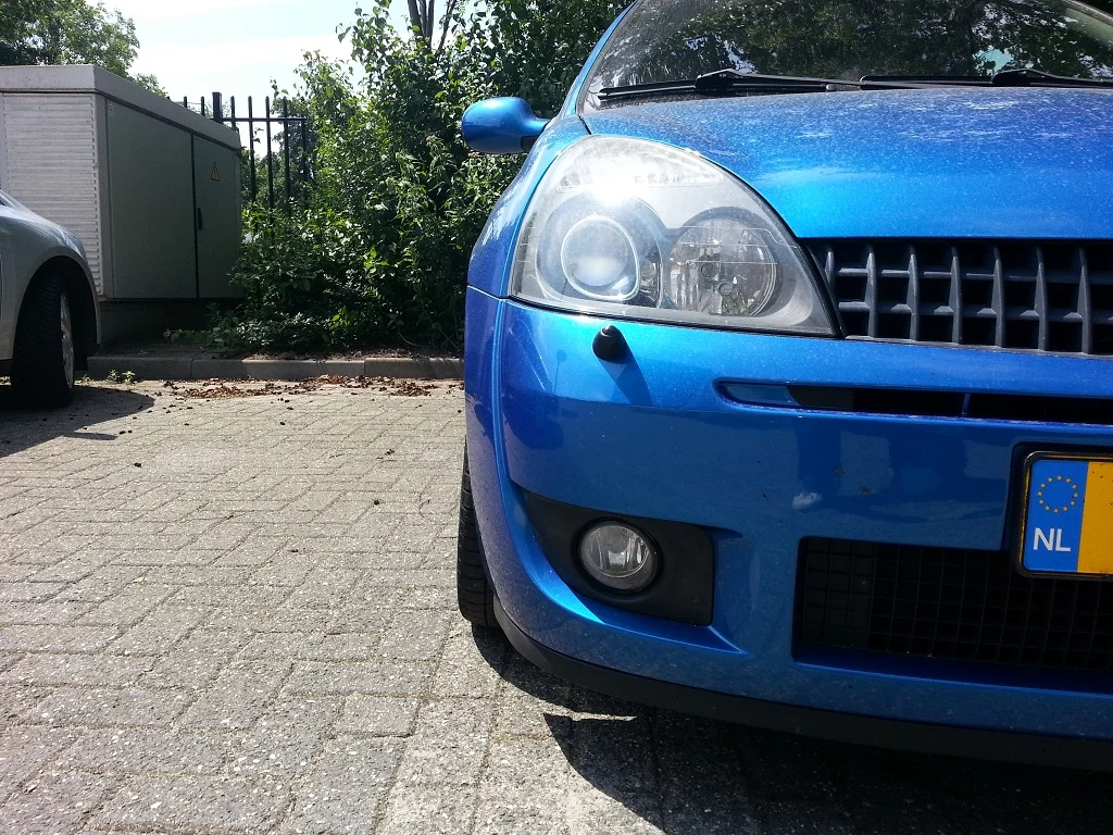

DSC_0731a.jpg the camber before
20120704_130710a.jpg the camber after..-3.5 it's not gonna remain that way -1.5 is what I want, but I still need to get my ass down to an alignment centre.
It is a bit mental to drive now, tires squealing everywhere at walking pace.....
Side on pictures to follow as I keep forgetting them.
Spax are setup with 12 clicks all around as per danny's instructions, and loving it so far.

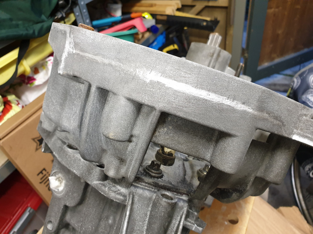

Beauty Queen that I am, i have been pimping my gearbox....
End cap painted in Arctic, gearbox will have casting seams removed and get a lick of silver paint (looks good and will make it easier to keep dirt off)
