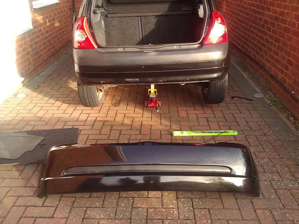

Do you need the wheels off to get the bumper off? It's on my list I havnt looked yet :(. Tidy Car, I like your plans :)
You don't need to jack the car up and take the wheels off to remove the bumper but it helps one hell of alot. The more wiggle room you give yourself the easier it is :)

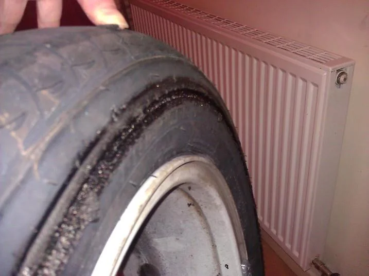

Some serious stuff has happened with the Clio in the past few days! The two tyres on the left hand side were 185/55/15 and the right were 195/55/15's. So naturally I got the two left ones changed to match; then the s**t hit the fan....
A few hours later I heard a grinding noise... And smelt rubber....
Turns out the coil spring on the passenger side had snapped at the top and bottom! I'm thinking that the previous owner snapped it and put the skinny tyres on to avoid the broken spring grinding the tyre (I would've noticed if the spring snapped like that!)... What a tool.
So after buying two new tyres I need a new spring (Can't afford coilovers yet :() and another tyre, because mine now looks like this!
Every cloud has a silver lining and all that though; because now I've put the 185/55/15 spare tyre on (black hubcap; doesn't scrape the spring) it looks pretty tasty. So I'm thinking, black alloys and a white centre diamond is the direction I'm gunna go in, stealthy and all that!
