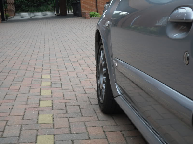

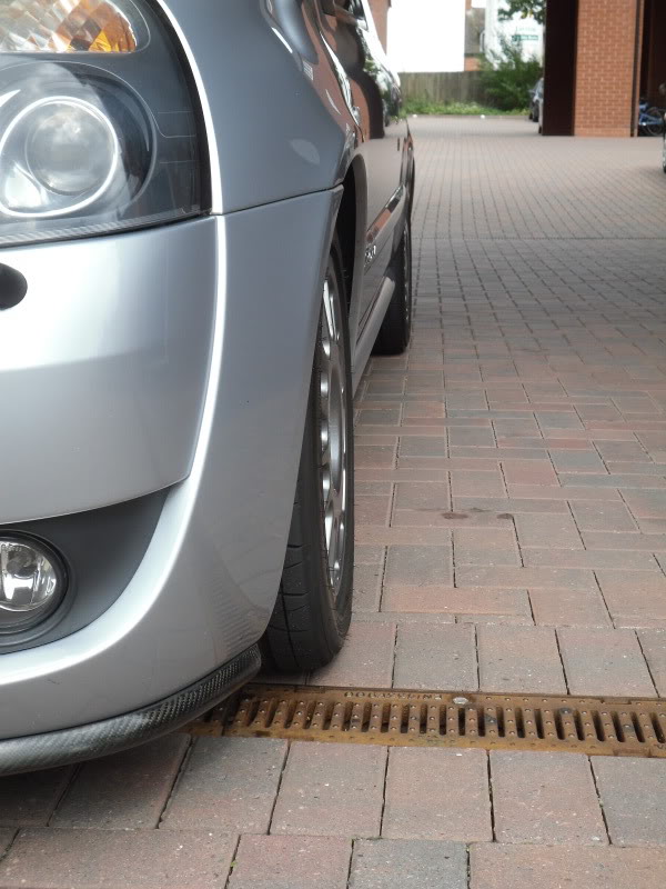

That's pretty much what we did when we fitted the coilovers, just whacked the OE bolts back in.
The camber bolts allow for the adjustment to negative camber (what you want).
Nope...didn't bother with corner weighting.
Couple of pics to show sort of what it looks like.

Ahhhaaa, understand now. Do you mind if I ask how much it cost you and if it was worth it? I think the car handles mint allready, could it possibly get even better? :)
maynard
  ph2 172 track car
Yeah it gets better!
Not sure as I had some other bits and bobs at the same time, best off speaking to Fred.
