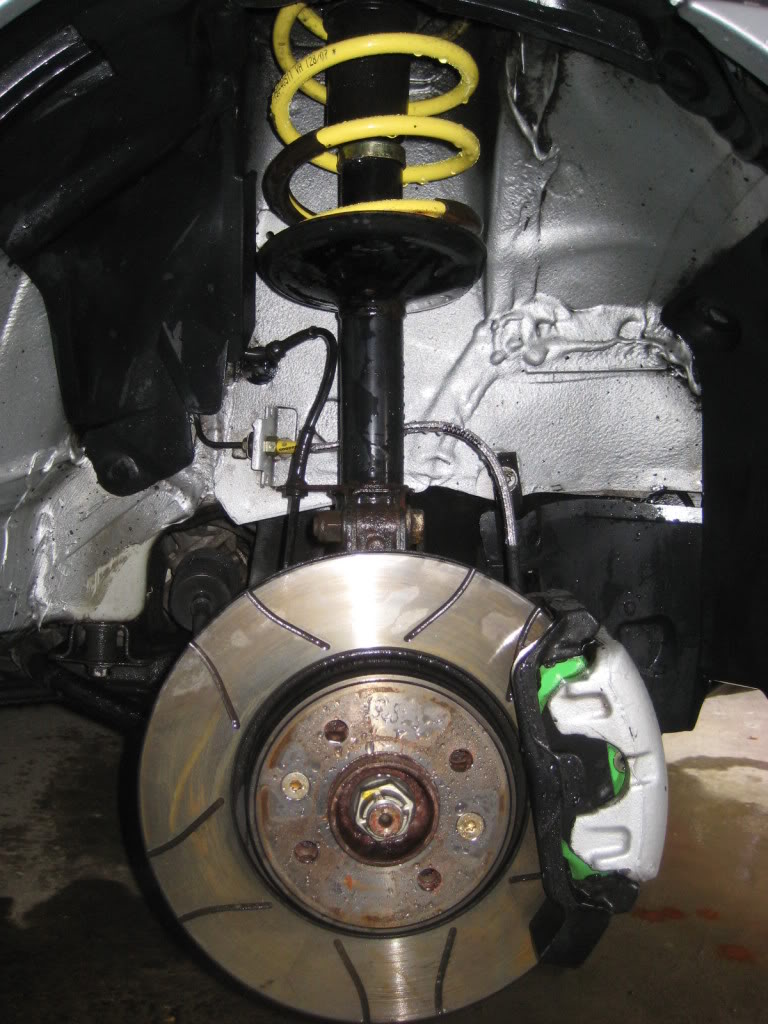

I'm running drilled disks all round with standard calipers, braided hoses and green stuff pads. Little bit of vibration when really using them hard but never faded on me! (Never tracked it though tbh)

Brembo HC Discs, Mintex 1144 Pads, HEL Braided lines.
  TrackCar & F30 330d
Brembo Max
Goodridge braided hoses
Castrol fulid
Green stuff pads
