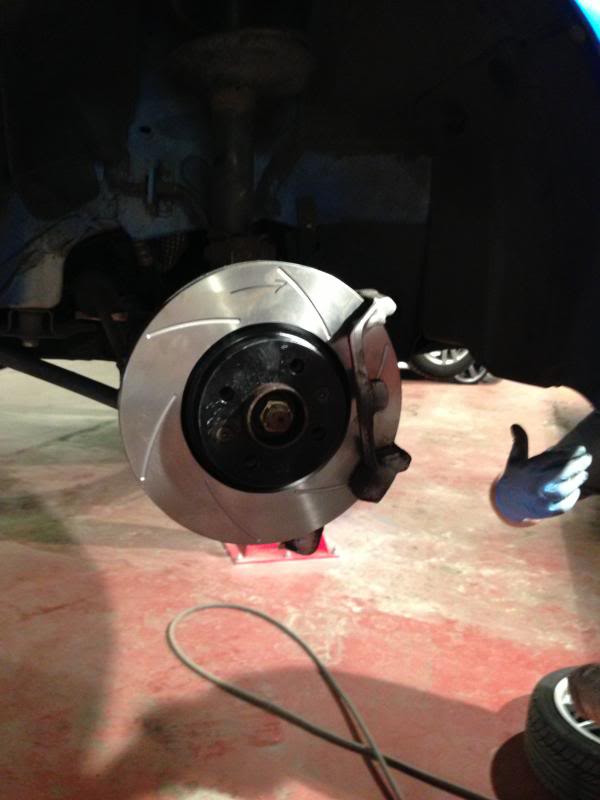

I use Godspeed grooved items on my Cup and they seem pretty good!
