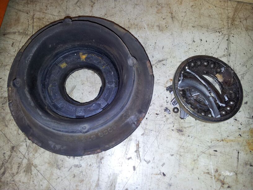

Bearing in the strut
The bearing in the strut has shattered into a million pieces.
Can you get this separately and were can i get one from asap?

Mine did this too. Bet you were getting the harshest clunking when turning?!
Yeah GSF sell the bearing but Fred says its a bit gash and doesn't fit properly or something? If you're doing it yourself you could try tho. If you're paying a garage to do it you're best off buying a new top mount kit for about £45 from Renault to save having to do it again.
