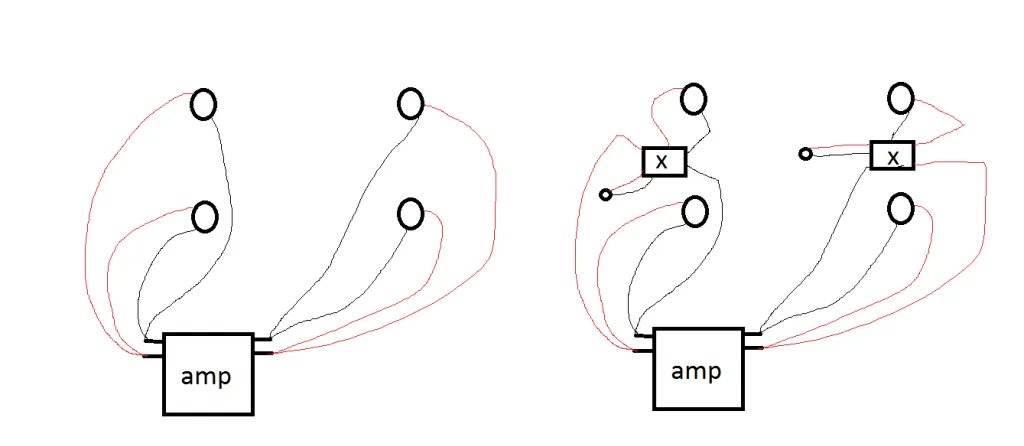

Can i add a crossover in like the really bad picture below. The amps currently running 2 speakers off one channel @ 2 ohms. but the tweeters are currently being powered off the headunit output :S its a big bodge basically and i'm trying to rectify it..
im not sure this will work but worth asking before i try
Ideally you'd want a 4 channel amp, two channels for components in front, and two for rear co-axials.
Failing that you'd be better just amping the components and getting rid of the rears
