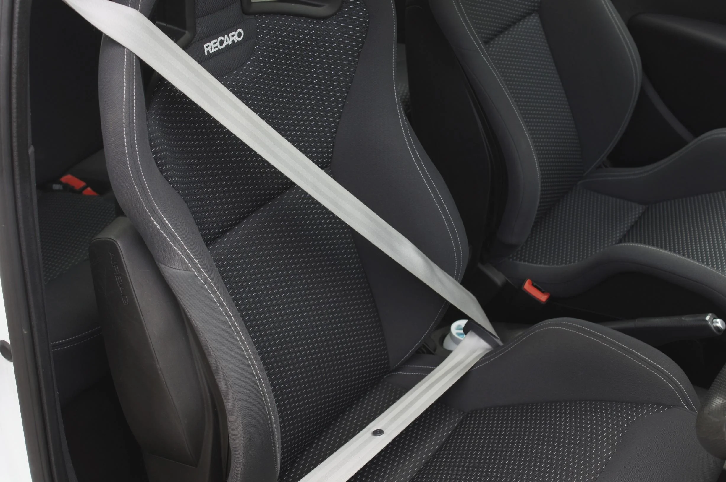

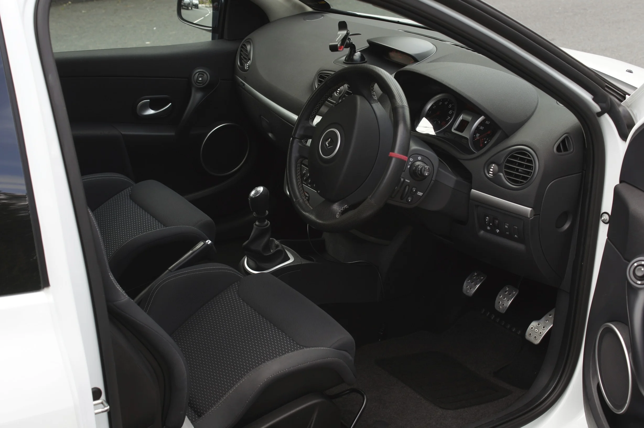

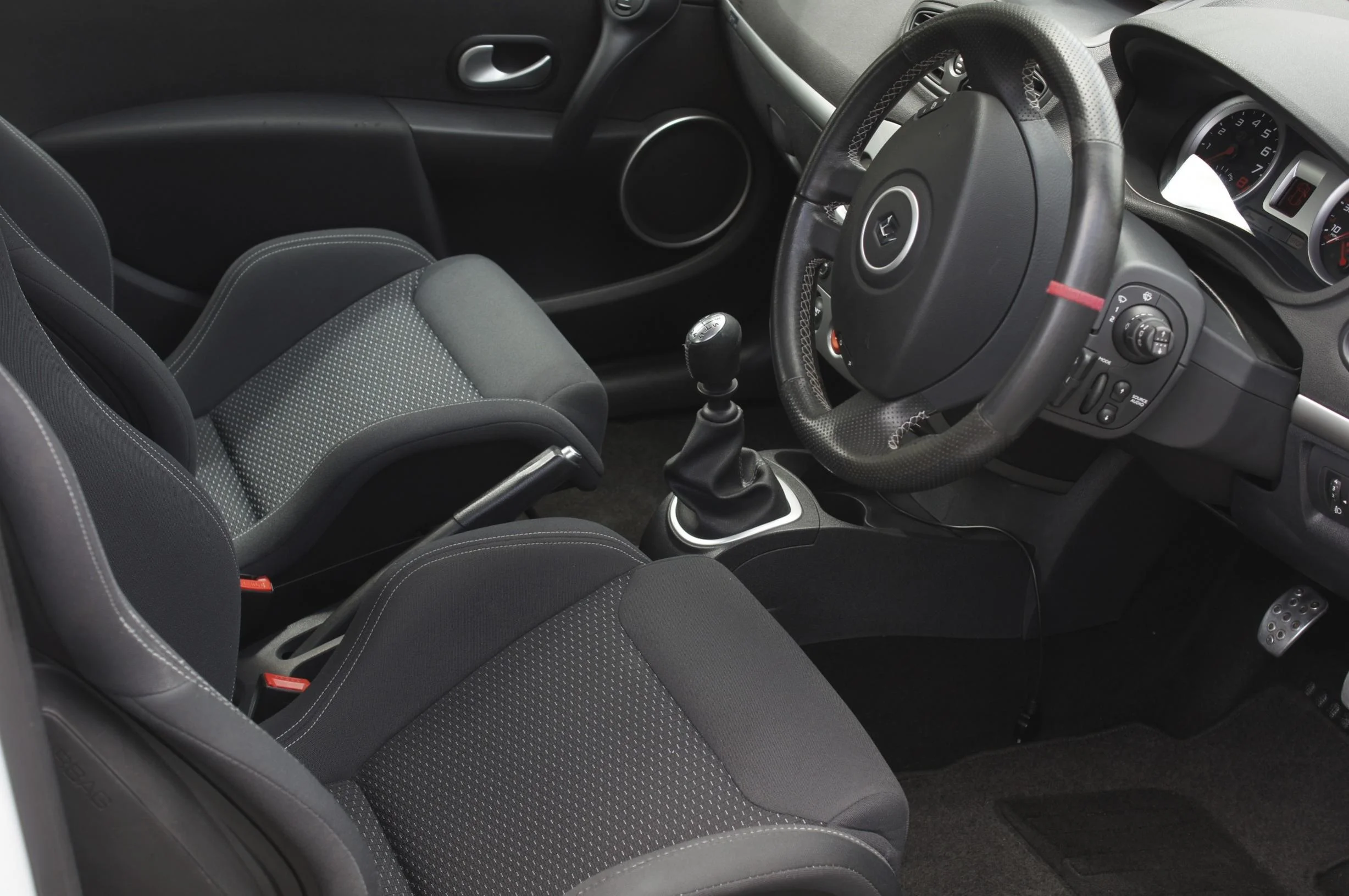

Interior pics taken today after a thorough deep clean, it was a bit grubby when bought but now other than a few annoying trim issues is as new inside which is how I like things, the colour of the water after cleaning the seat belts and headlining was horrible!
