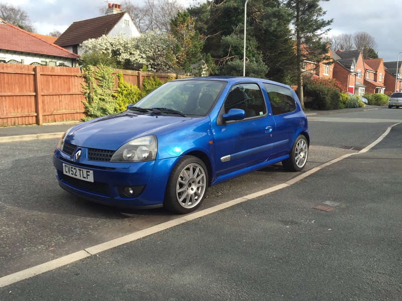

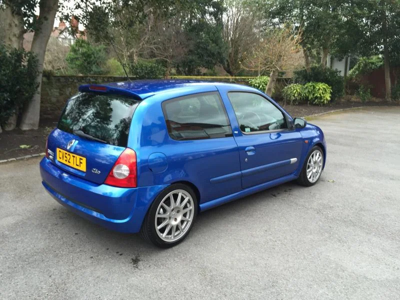

Picked this up a couple a months ago with 64k, 3 or 4 previous owners. Ive managed to trace most of the service history, now I'm just waiting for it to be sent to me. Overall not bad, it's got the odd scratch and ding here and there.
Im not sure exactly what's going to happen with it. I had planned oem refurb but now I'm more focused on fast road/track car. Since getting it, it's had:

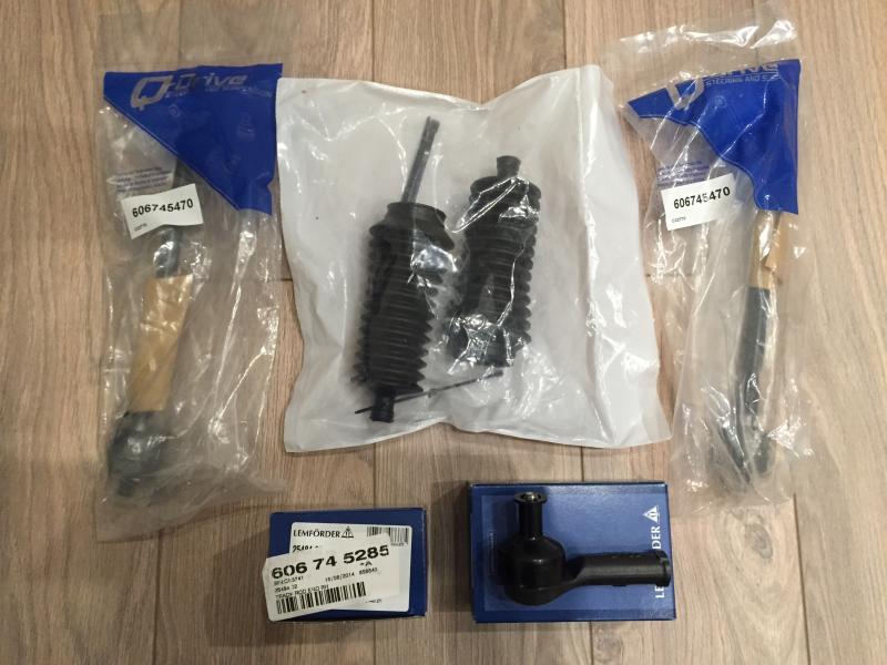

▪️New tie rods, track rod ends and gaiters

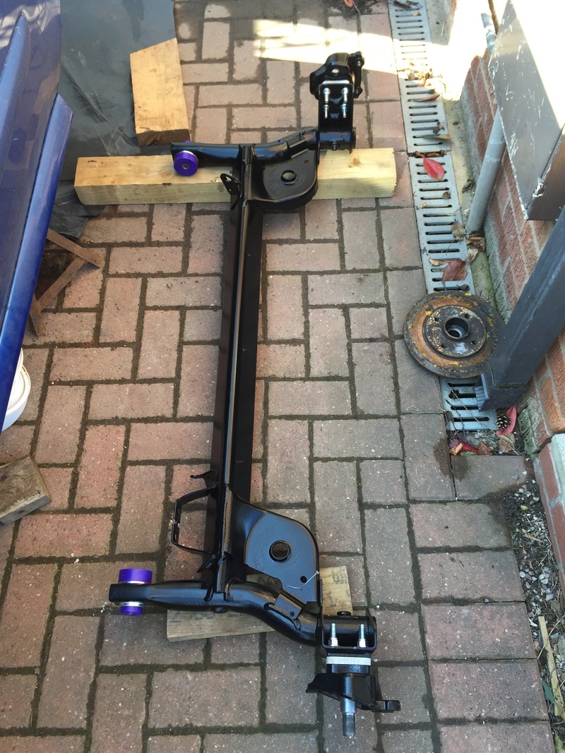

▪️Freshly powder coated rear beam
▪️Powerflex beam bushes

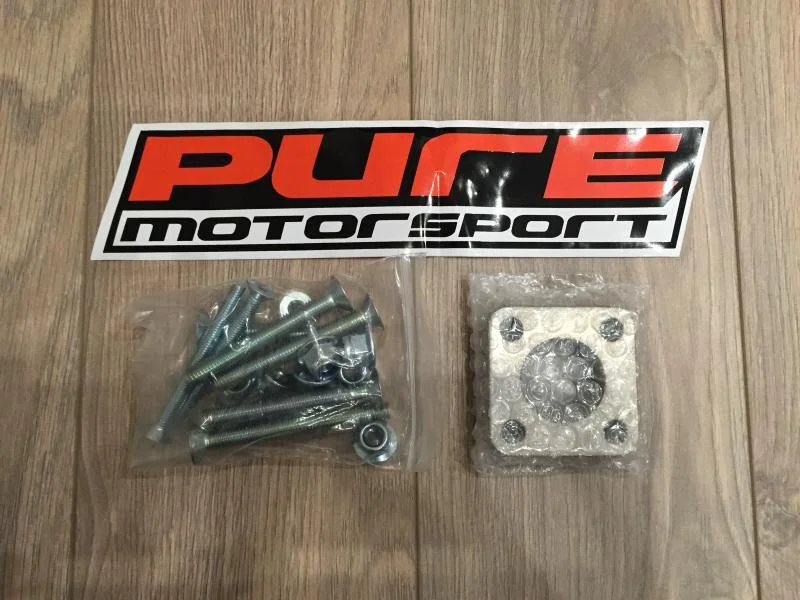

▪️PMS 10mm axle spacers

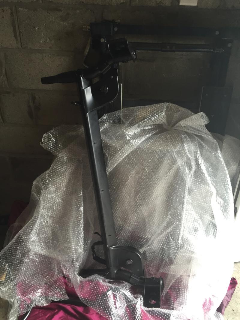

▪️Powder coated subframe

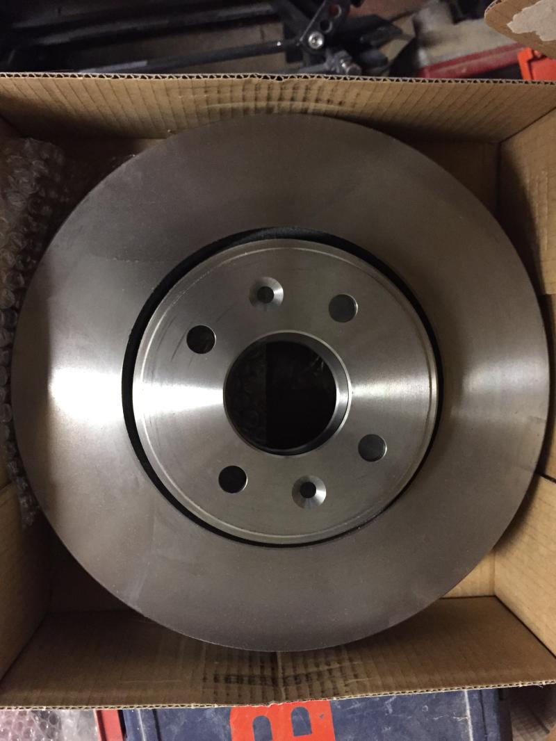

▪️Brembo HC front discs

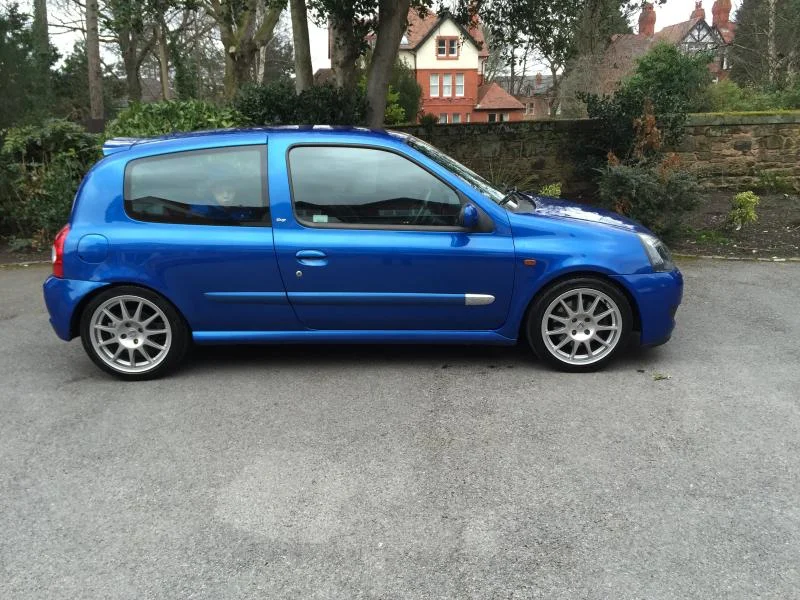

Some pics:

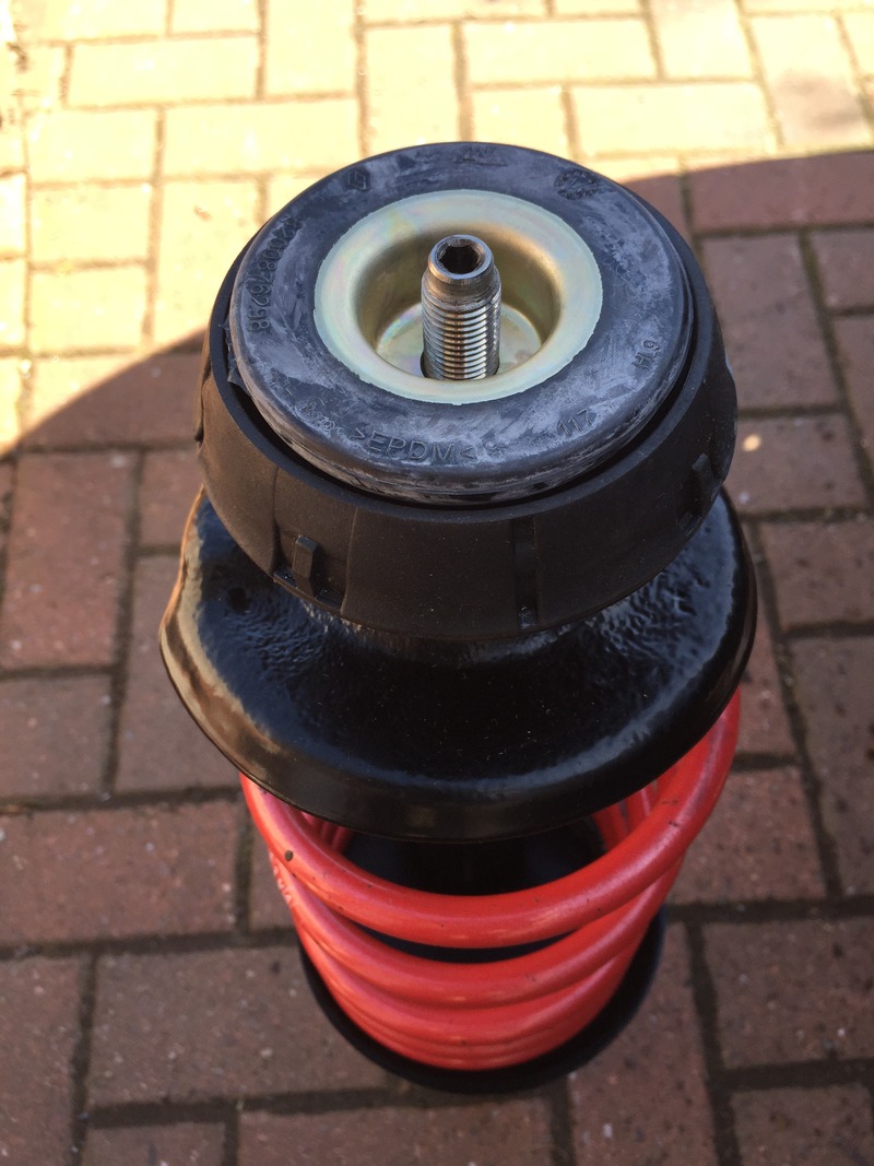

I like them, I went for stiffer springs. Played about with the settings and it's not to bad now on the roads considering the state they are in.

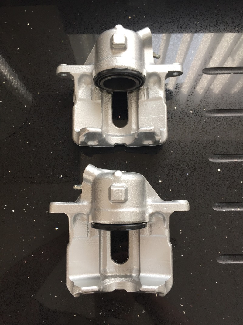

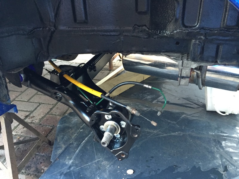

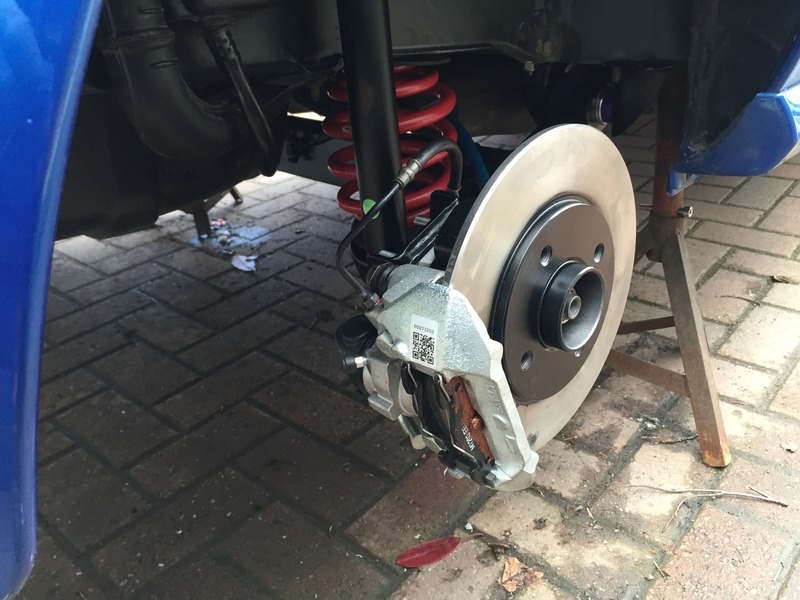

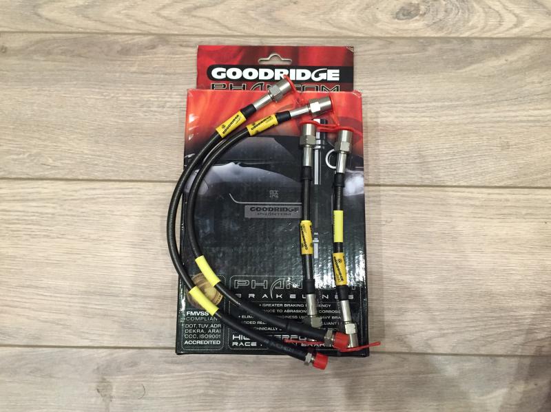

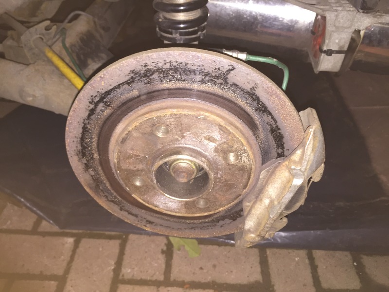

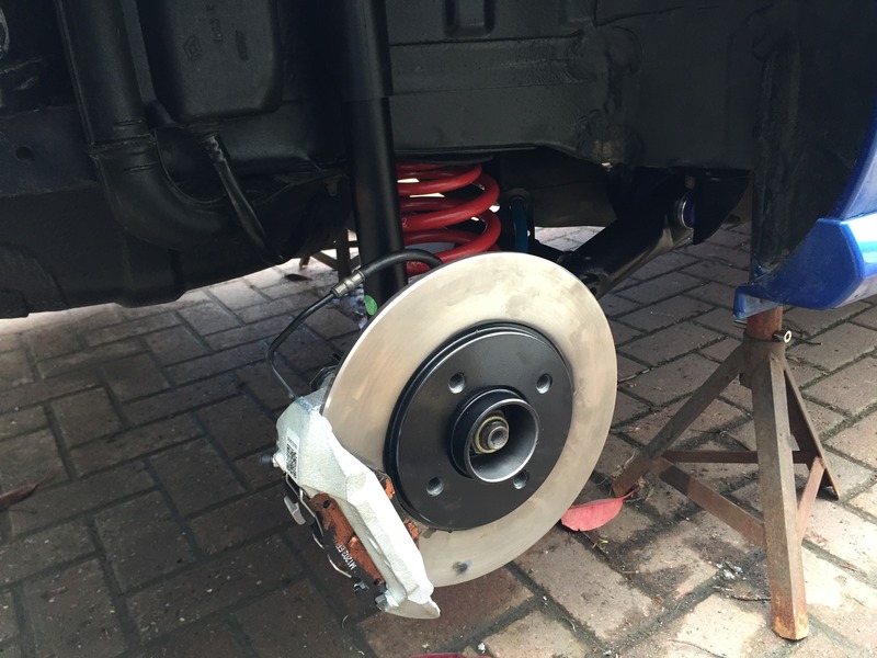

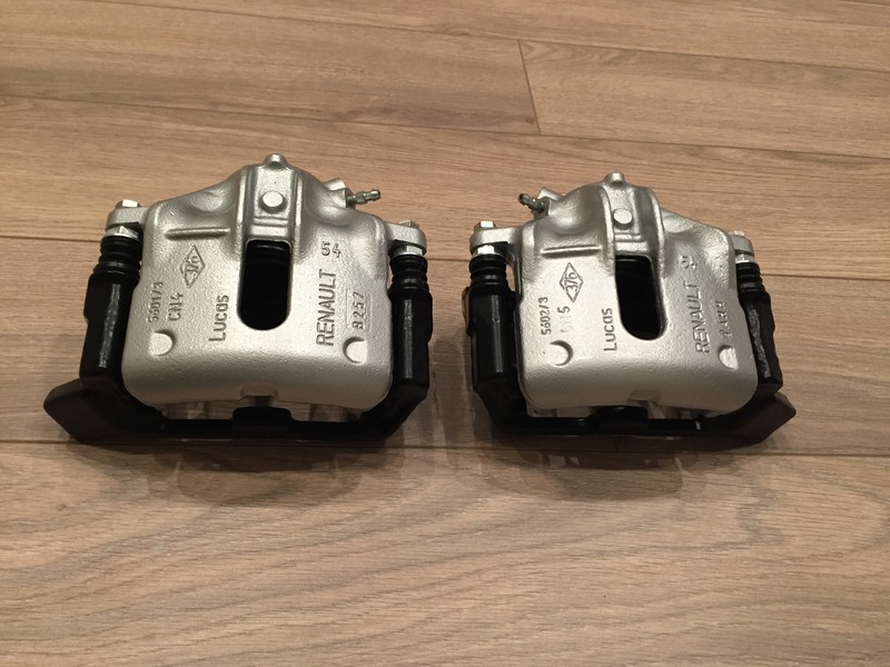

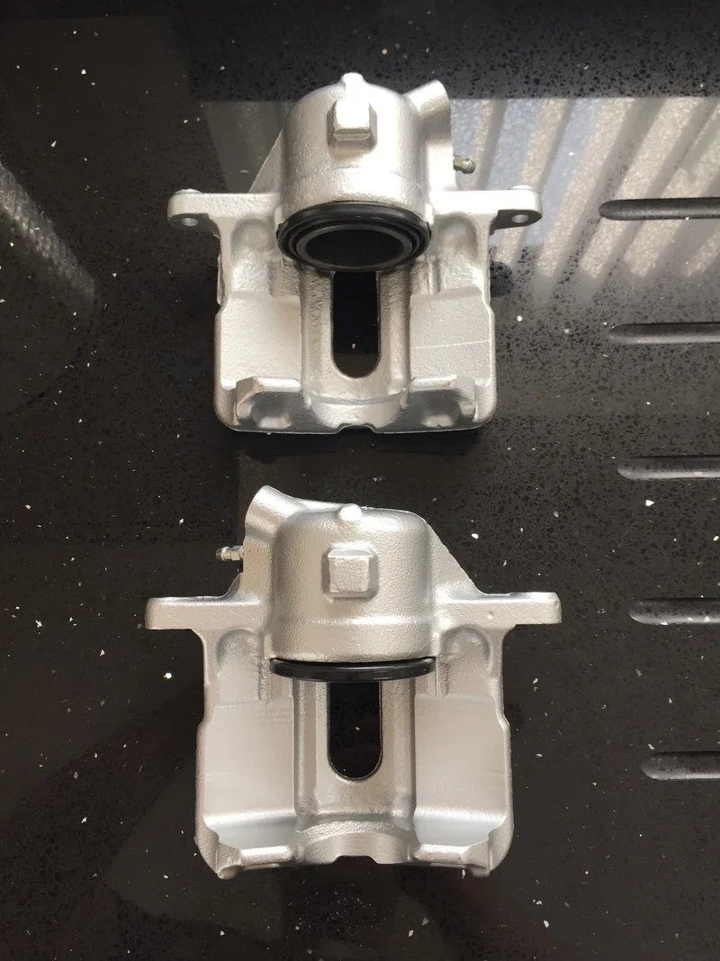

Finally got round to fitting the rear end suspension back on. New discs, pads Goodridge braided hoses, Powerflex bushes, Eibach sport line springs. Decided to go back to standard cup suspension for a bit more comfort.

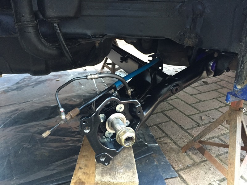

From this
Looking cleaner
Now onto the front.

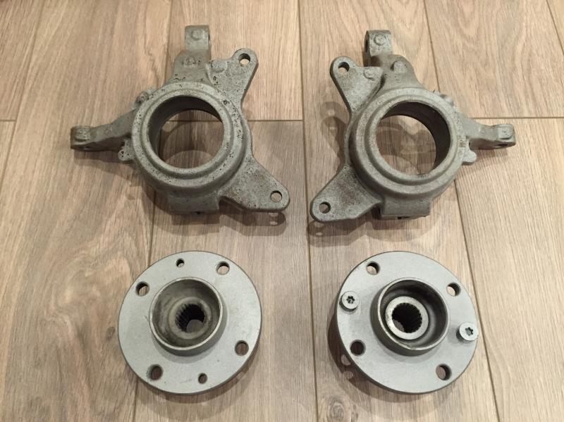

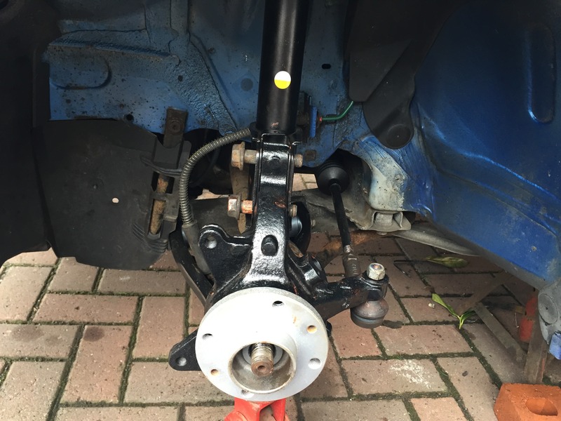

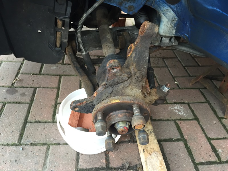

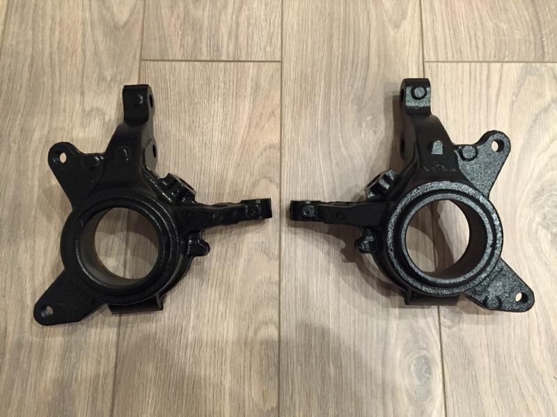

It's coming along slowly. I was going to leave the original hubs but they've got far to much corrosion so I'll have to put it back together to get them off. Need to get a move as its in the way now. Think I'm going a bit ocd on it.

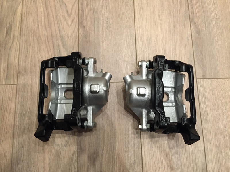

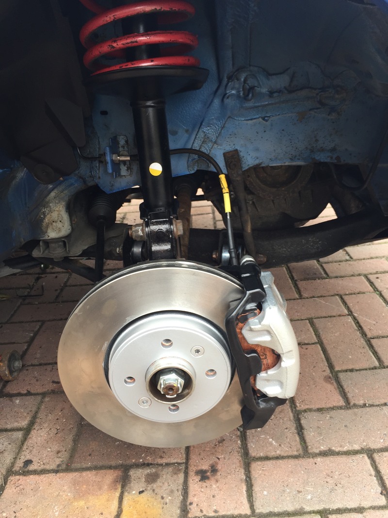

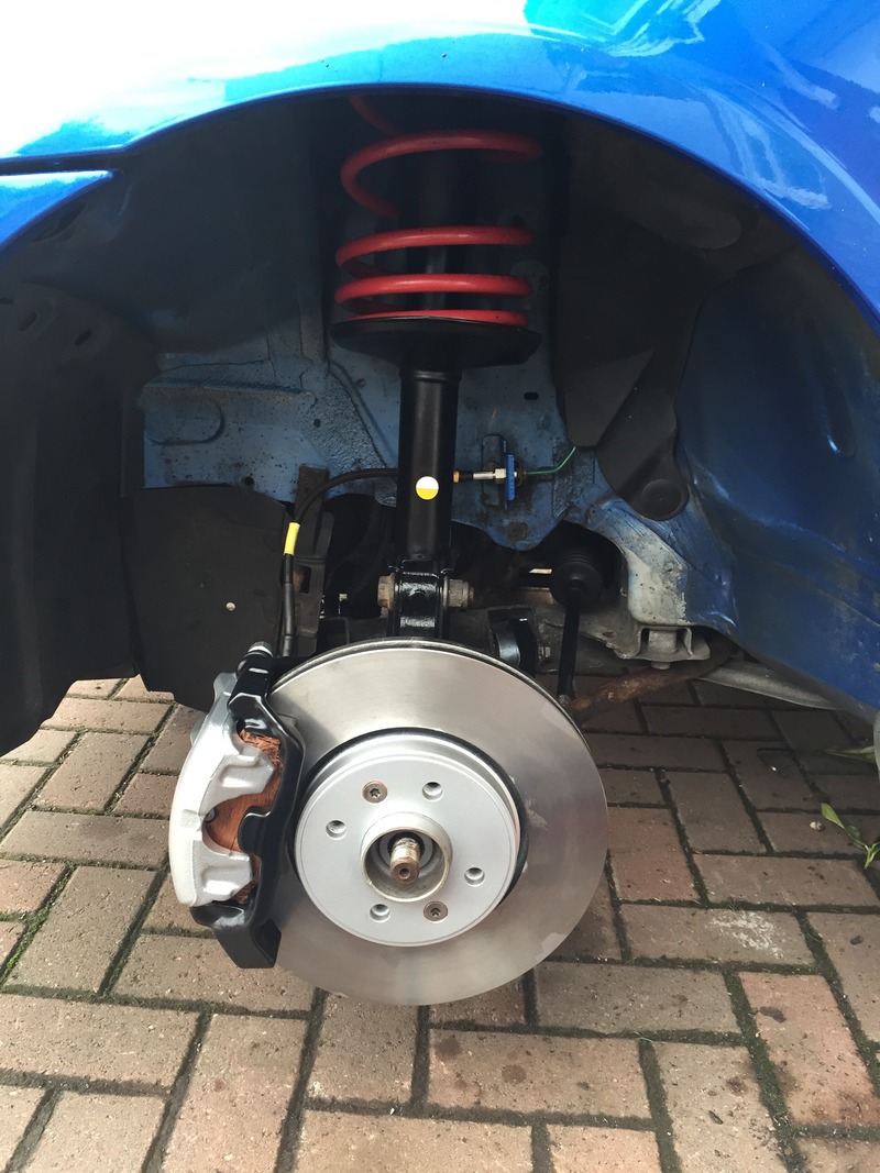

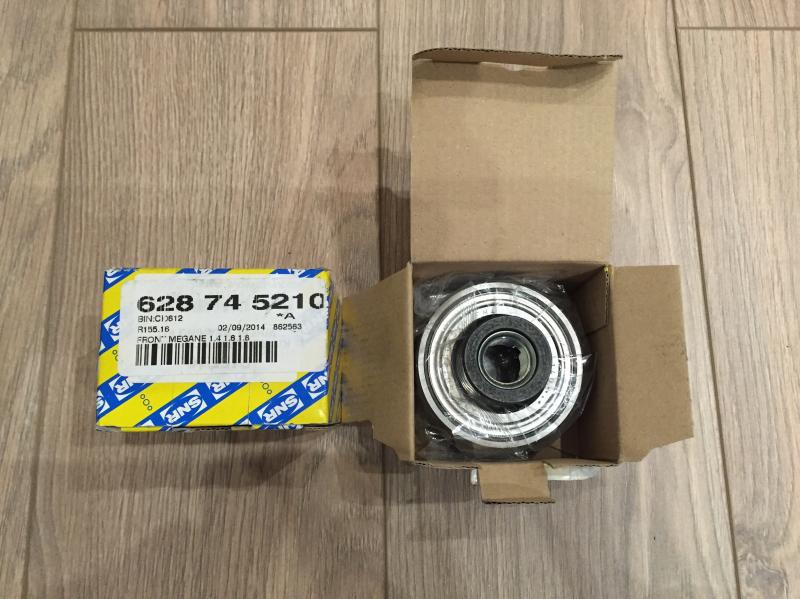

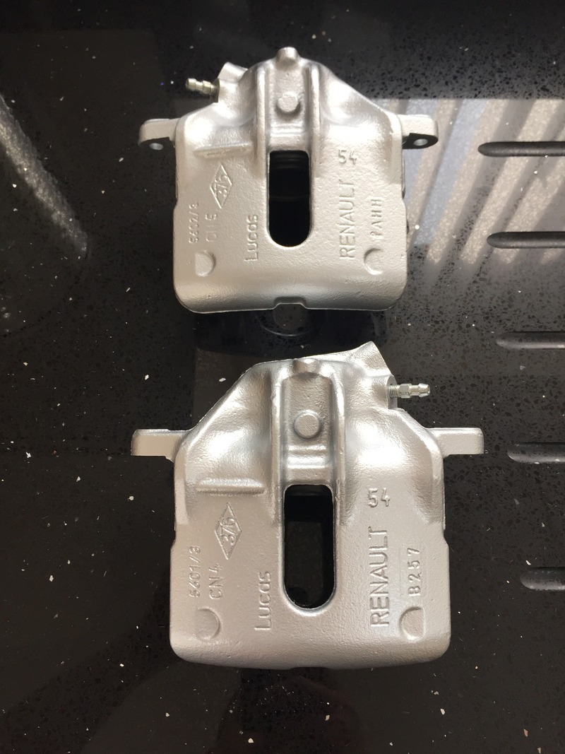

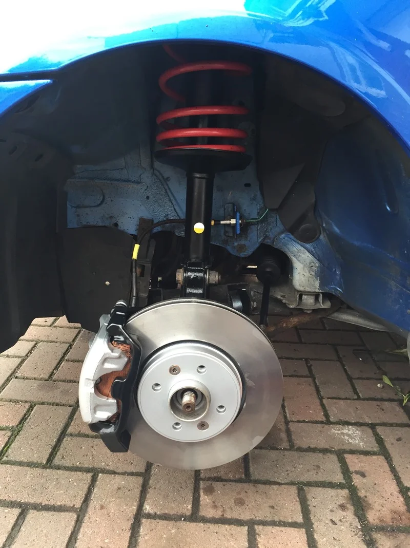

Had the new bearings pressed into the hubs and fitted the new shocks, topmounts, bottom arms and callipers, braided hoses discs and pads. Just need to bleed the brakes now.
Hopefully it will settle a good bit, this is how it's sitting at the moment.

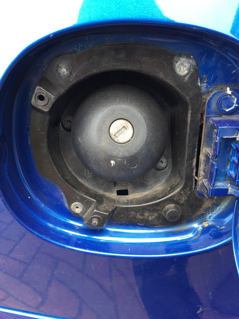

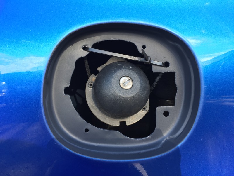

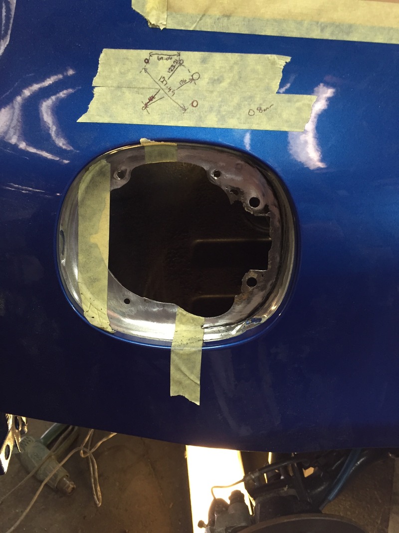

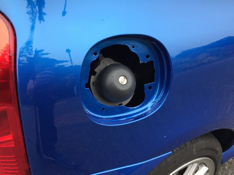

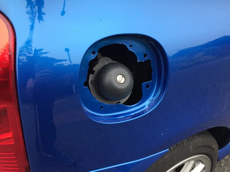

Thought I'd investigate the bubbling behind the petrol flap. I didn't like what I found so it was off to the body shop to be cut out before it spread to far. It's been done properly, all cut out not just cocked up so shouldn't come back. I'm really pleased with the work they done.
It's already for paint now.

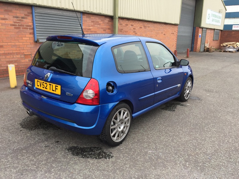

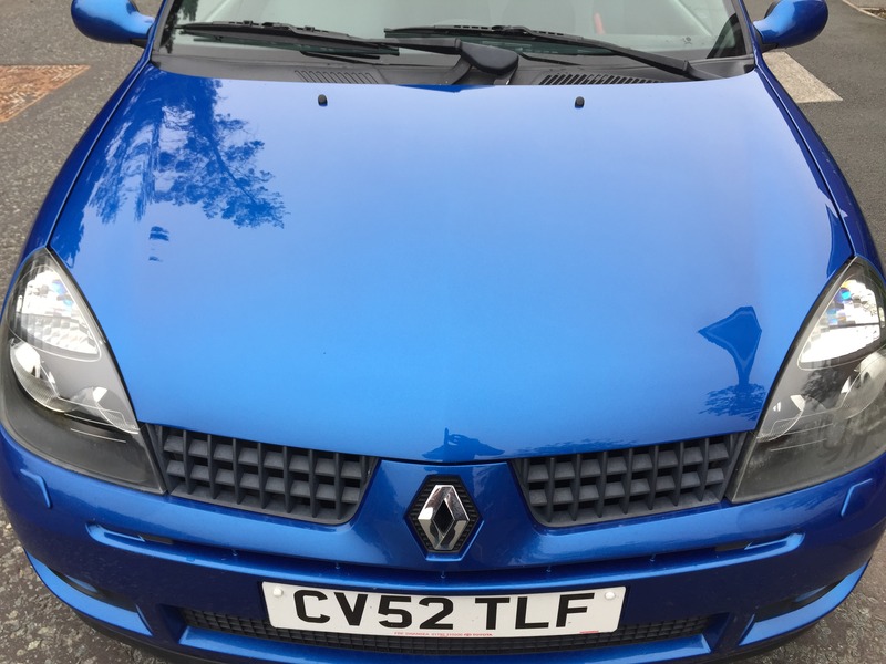

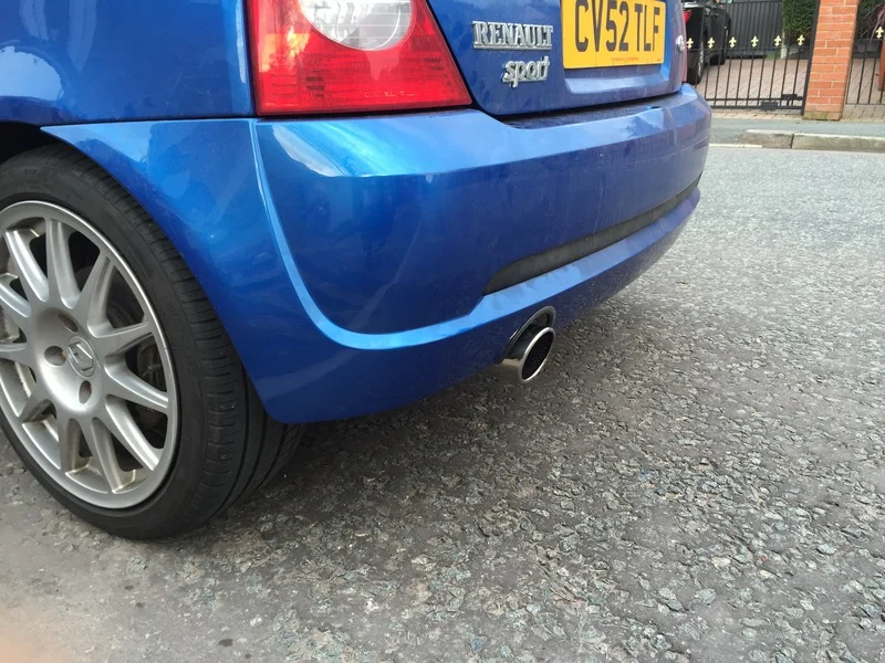

Got the car back from the body shop after finding rust behind the petrol flap. It's all painted now and I also had the bonnet done as it had the usual dents on the edge.
The new flap (genuine) has also been painted and fitted now just didn't take a pic of it on.

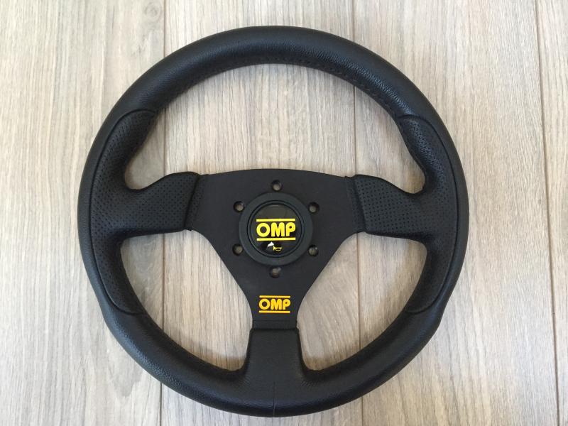

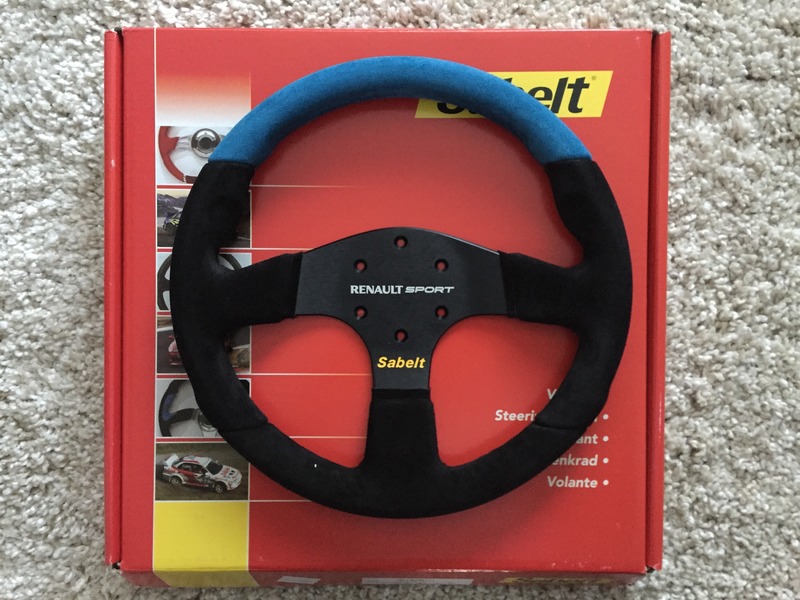

Also got a new Sabelt steering wheel but sure if it's going on yet.

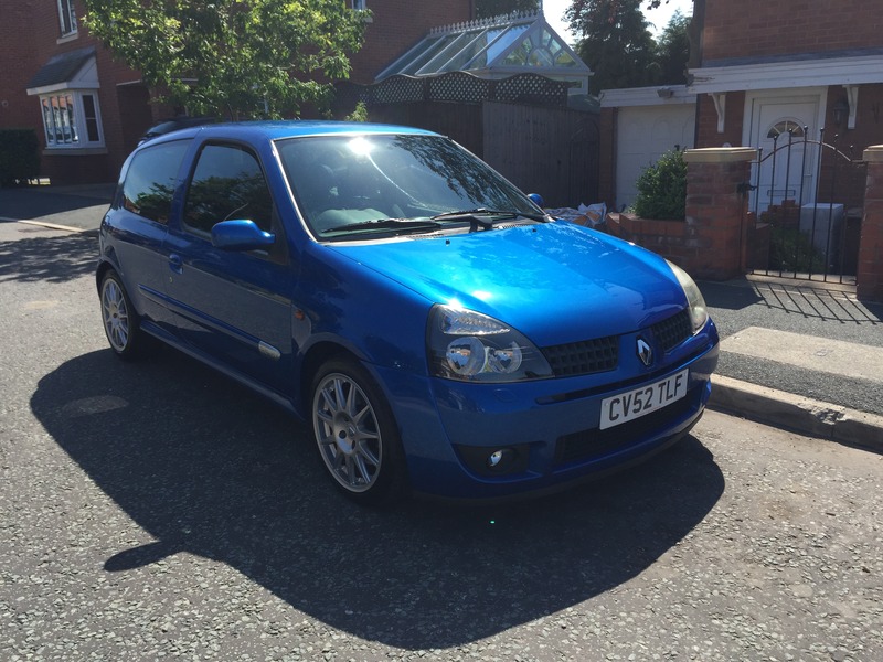

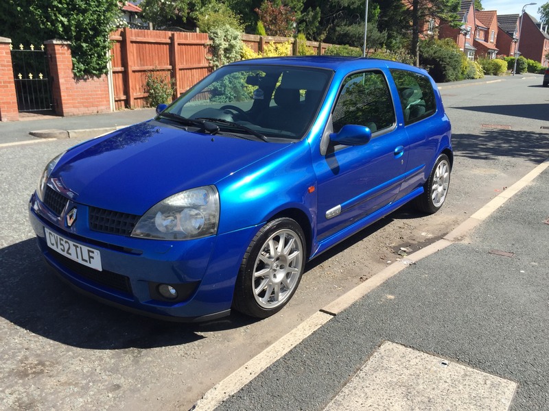

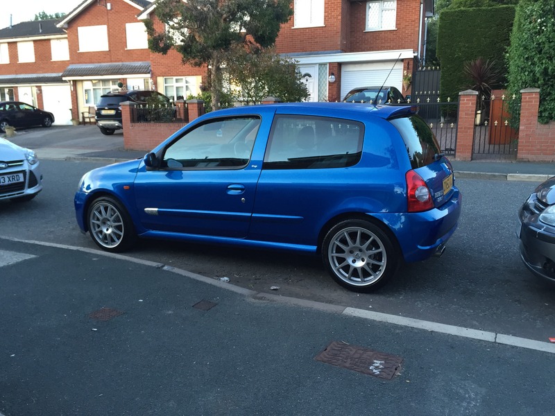

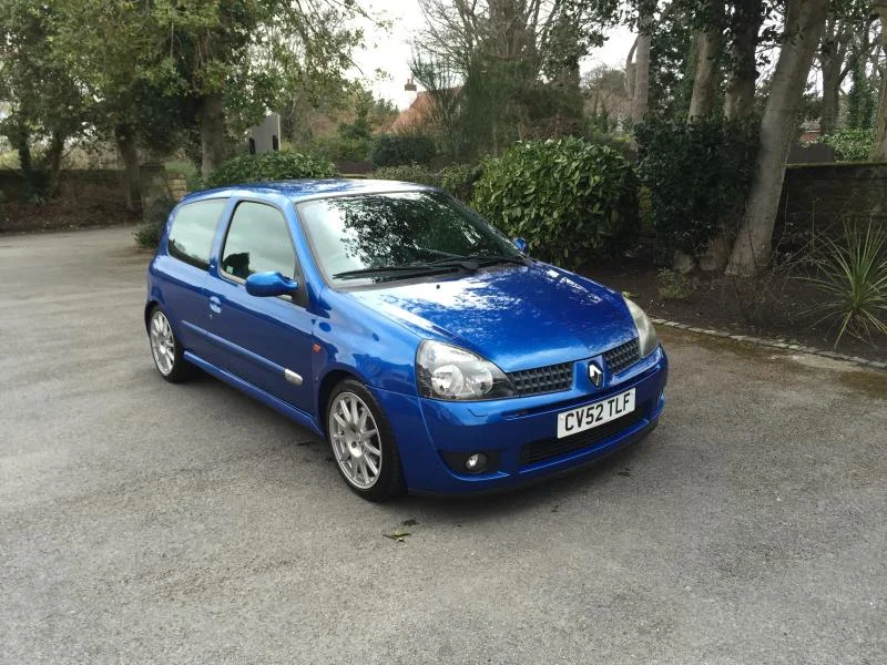

Give the car a quick polish today it's starting to come together now. Headlights still need polishing and two dings on the roof need removing.

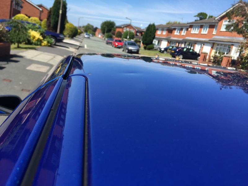

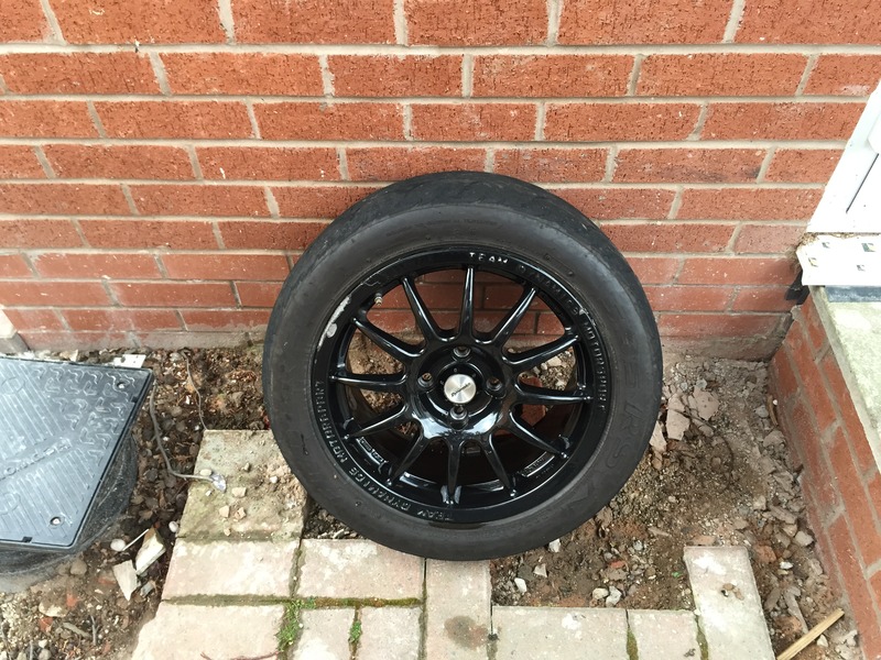

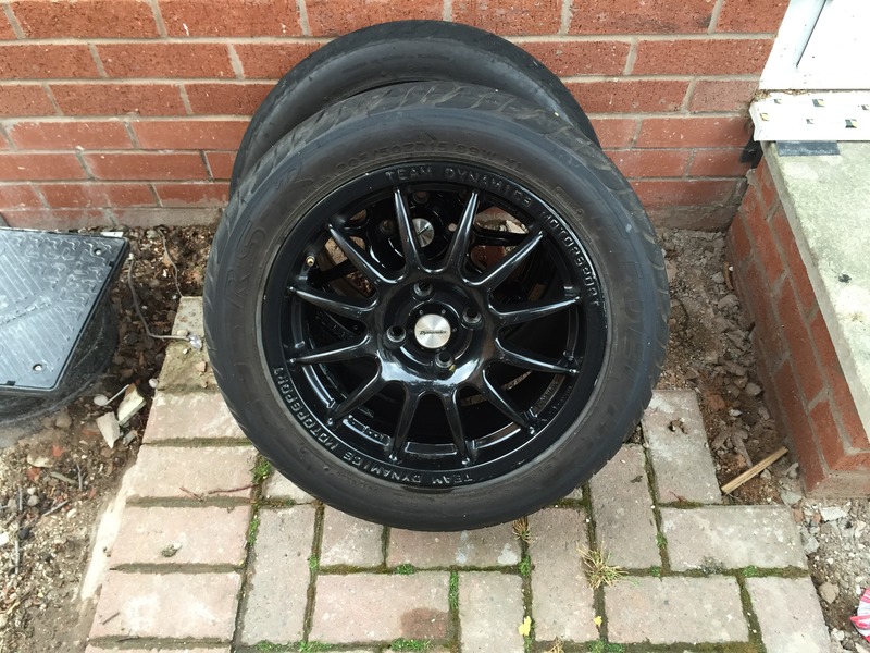

Had the dings removed today made up the results. I'm picking up a set of pro race 1.2's track wheels tomorrow so I just need to get a track day booked a then.

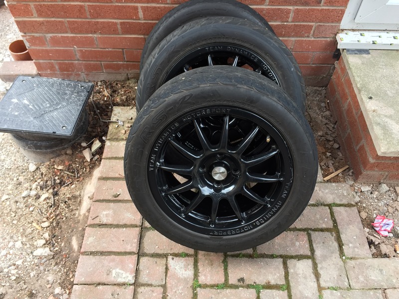

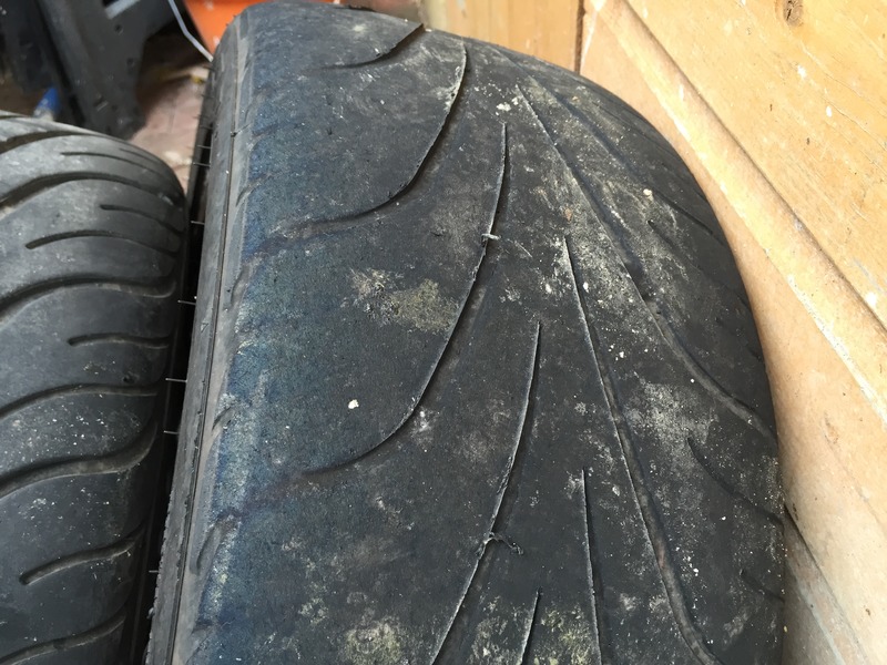

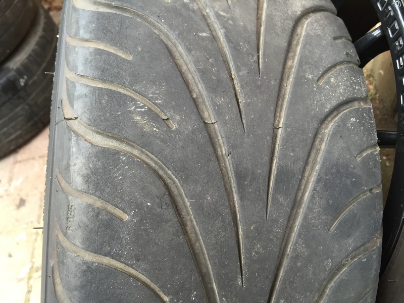

Picked up a set of track wheels 15" Pro Race 1.2's with Federal RS-R's, two will need replacing but might get a track day out them. Not bad overall one has been curbed but I'll blow that in.

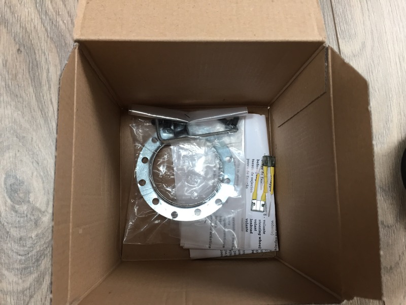

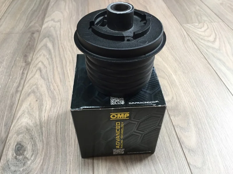

And an OMP boss for the new Sabelt wheel.

It's pretty much staying as it is now just need to get the headlights polished. It may very well be up for sale in a couple of weeks but we'll see.
