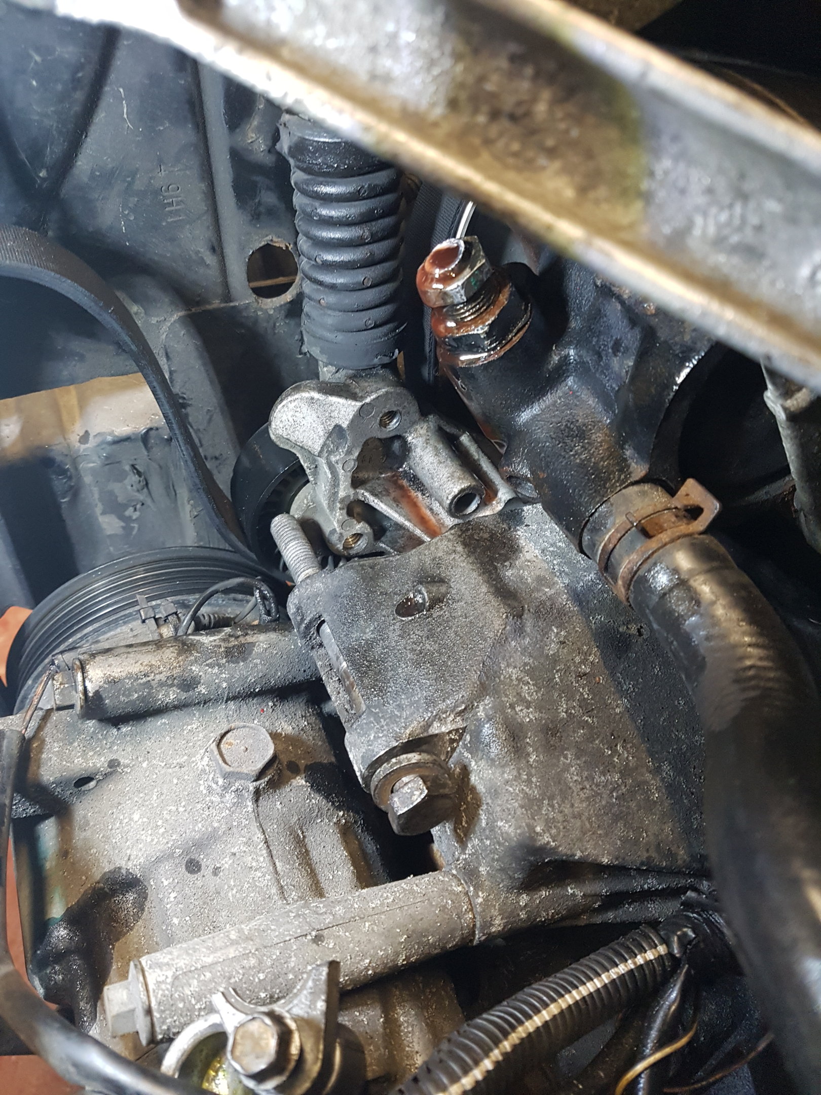

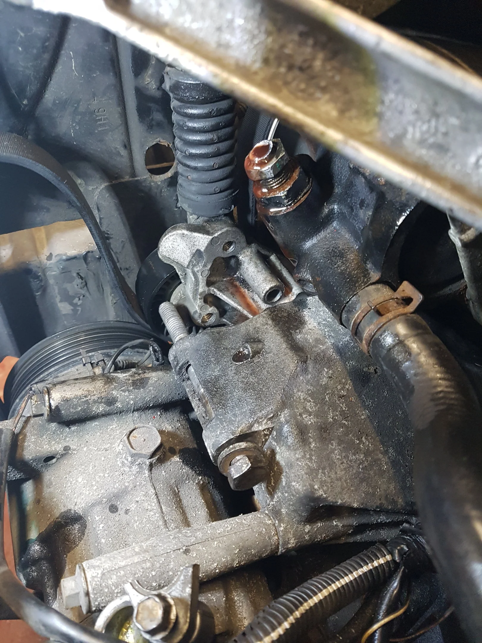

Power steering pump leaking so took a closer look. Found alternator sitting funny and bracket snapped and a bolt not fitting correctly.
Only just bought the car recently.
Can anyone advise which whole this alternator bolt should sit in top or bottom?
And any advice for changing the power steering pump?
Thanks all :)

  Clio 182
neither, that's the tensioner!!
Oh I'll take another look tomorrow.. everything it touch has problems or issues:/ need to find were alternator bolts up and all looks to c**k with missing bolts and snapped bracket.
Cheers

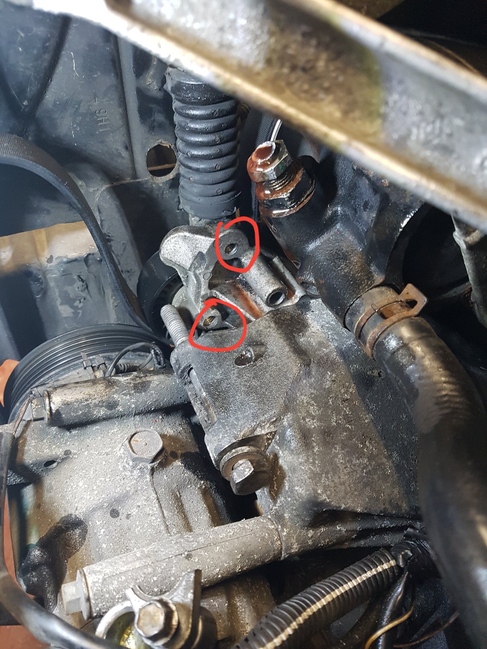

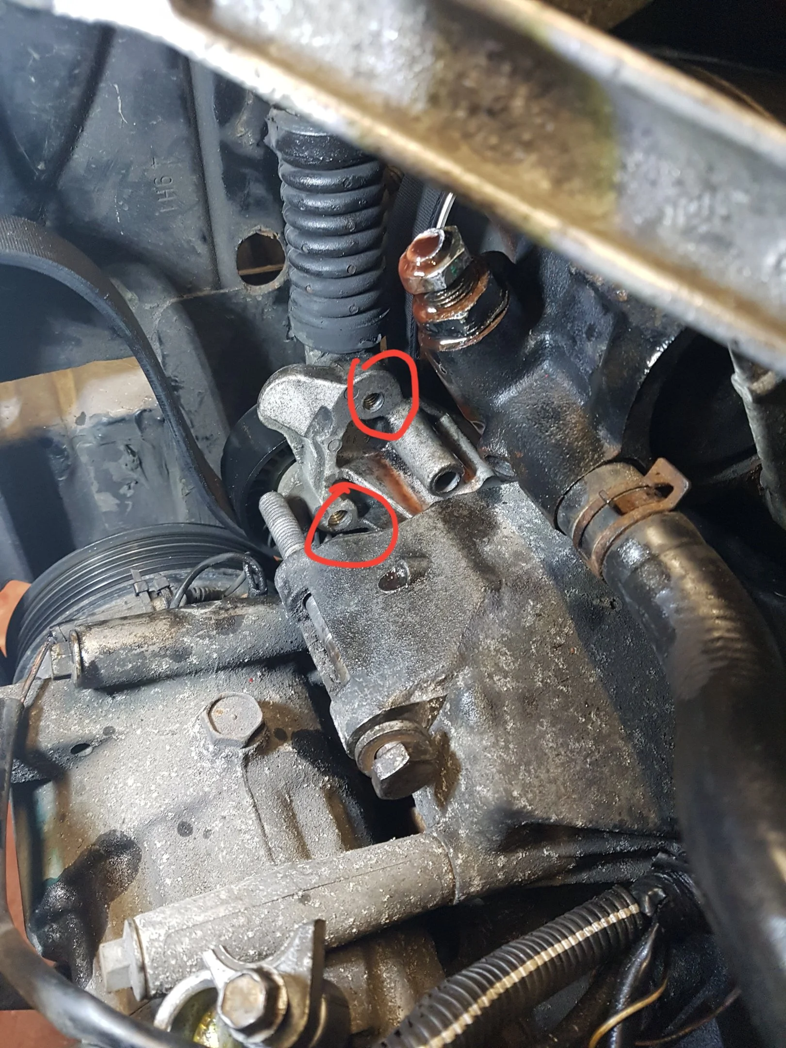

  Clio 182
bracket coming off the head towards the slam panel.
Cheers

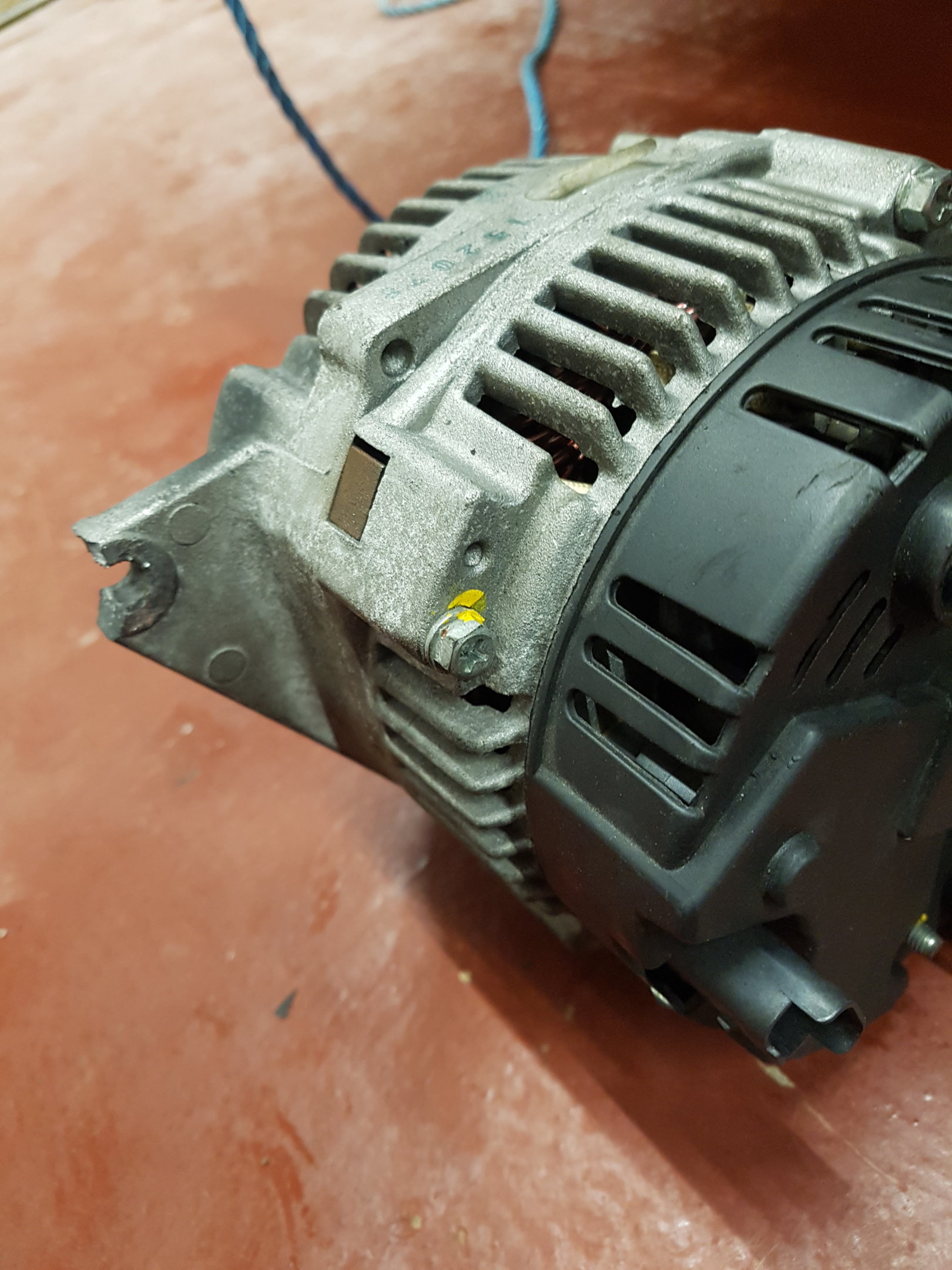

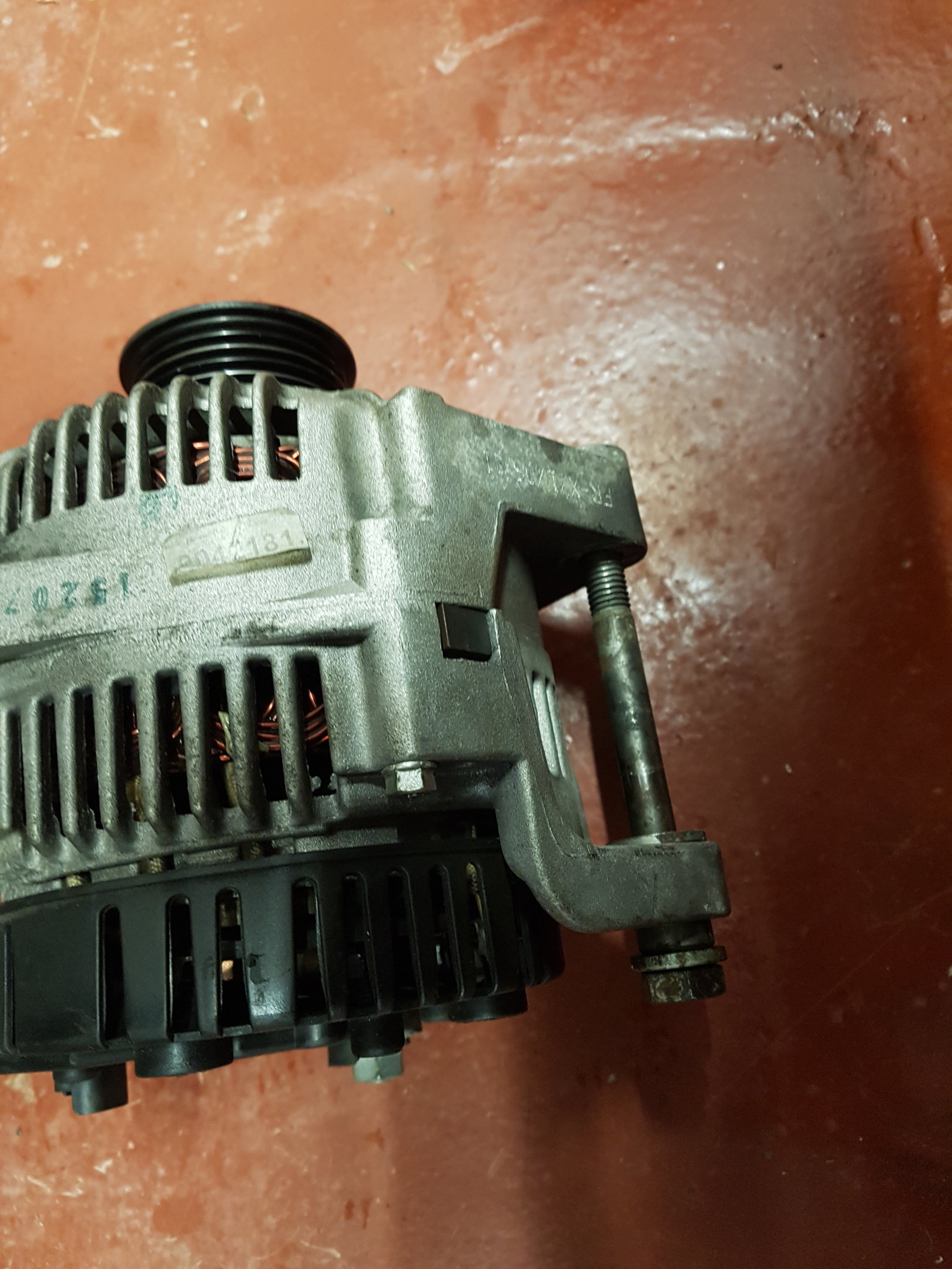

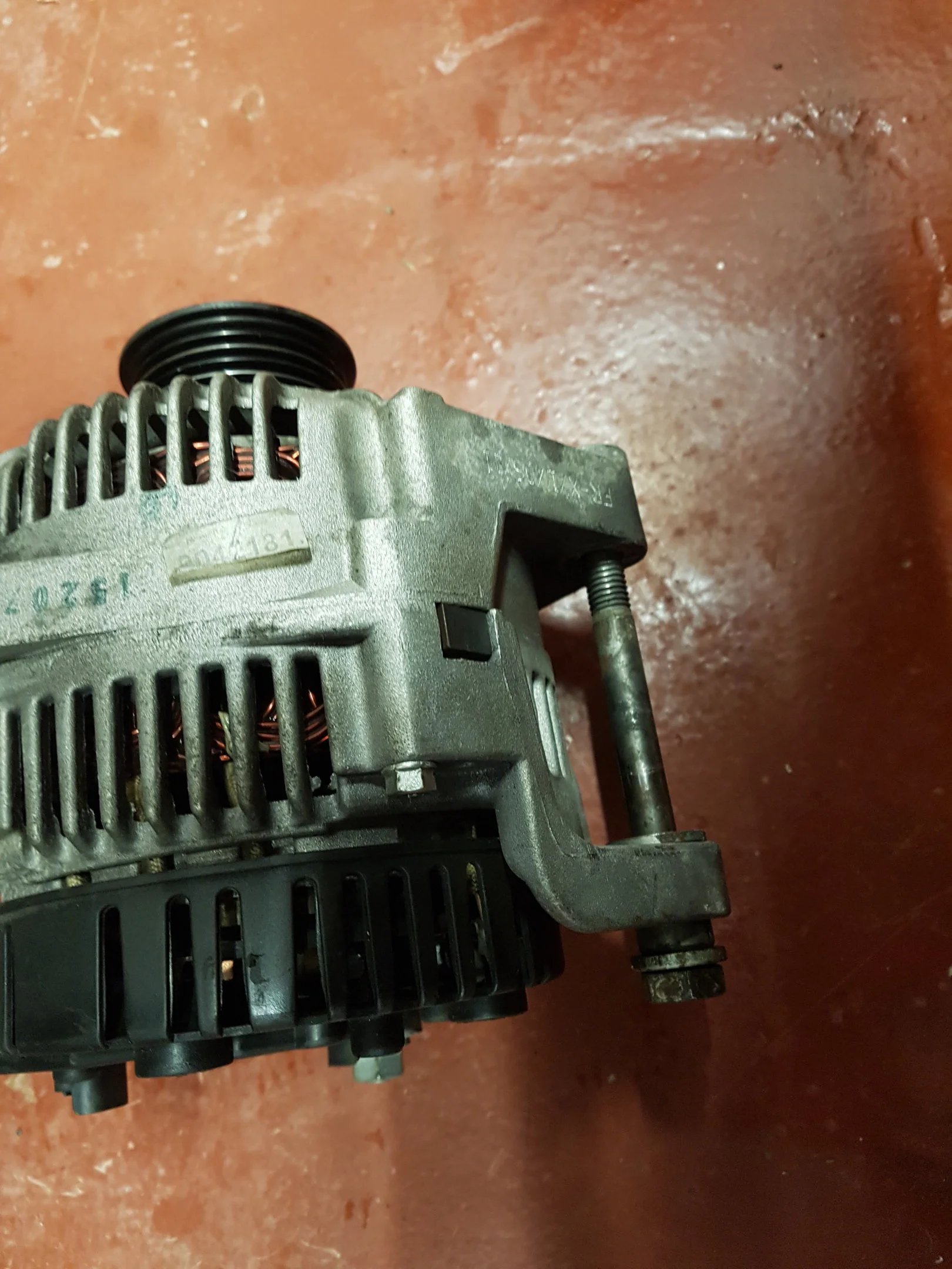

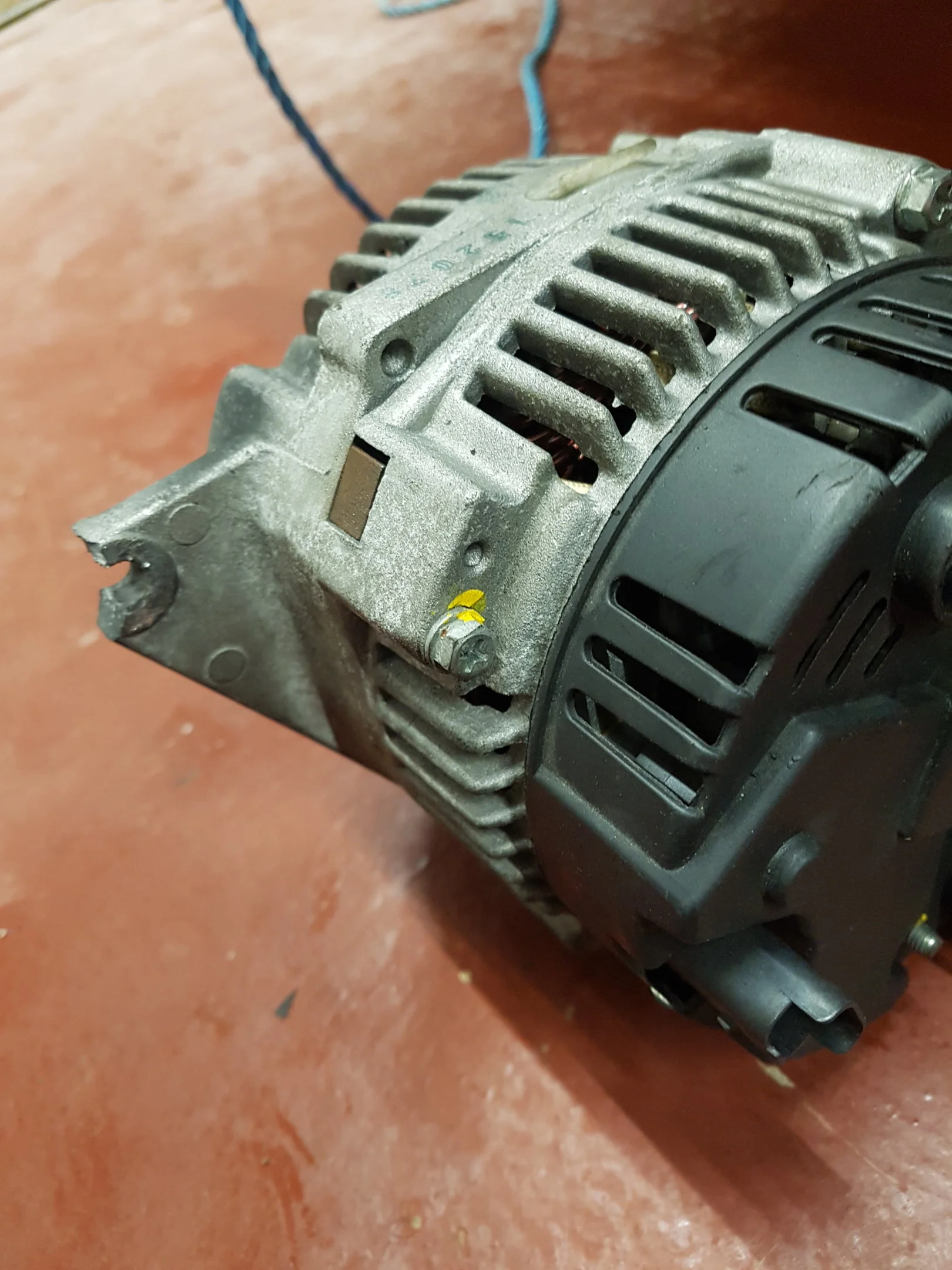

That's the alternator bracket part that's snapped on mine like shown. Spotted it as the alternator has a bit of twist with the belt. Not sure if a little twist normal
The other bolt underneath as shown slots n but doesn't tighten no thread on the alternator holes and not long enough to have a bit on the end.
Cheers

  Clio 182
either wrong alternator or threadhas been stripped in it.
Okay cheers don't think its had thread stripped probably wrong alternator.
One more question, any different in 182 and cup alternator?
Thanks again for the help

yup but i don't think they will fit each other properly though? the single mounting lug is in a different location.
  Clio 182
So you have the correct 110 amp 182 alternator, but the thread is stripped for the long bolt, and the top mounting lug is broken.
In addition, you say the steering pump is leaking, and you appear to have a fractured steering pump hose.
