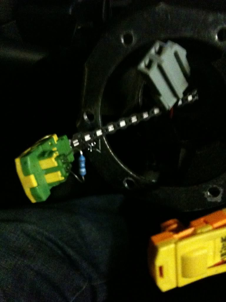

    Should be like this mate

    Yeah that's cool. I've just gone to maplins to get some 3.3 ohm resistors so I'll fit them later and clear the fault codes again and see what happens. If that doesn't work I'll use some 4/5 ohm ones.
