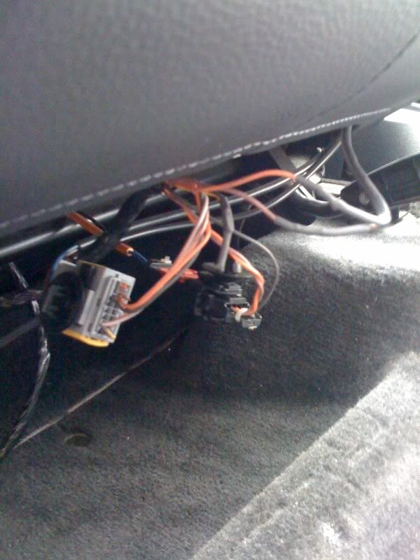

Did you plug in the grey plug or just use a resistor on it?
  Titanium 182
yeah, All I need to know is if they grey plugs should be connected.
Cant be bothered disconnecting them and adding a resistor to find out as its akward to get to under my seat
  Titanium 182
not the best picture but I have used a block connector on the brown and light brown wires with 3.9ohm resistors.
The grey plug you can see is plugged into the seatbelt pretensioners.
Yet I still get the airbag light coming on, even after disconnecting the battery
What am I doing wrong here, its doing my head it.
Do I need to cut the wires on the grey plugs as well and use a block connector?
  Bumder With A Buffer
LHang on where is you black connector for the seat airbags?? That's why it is on.
Il post a pic......
  Titanium 182
Il post a pic......
I cut that plug and used the block connectors as the stupid light wouldnt go out. Im using 3.9ohm ones just now and its not working
I also have3.3 but havent changed them yet. what ones did you use?
