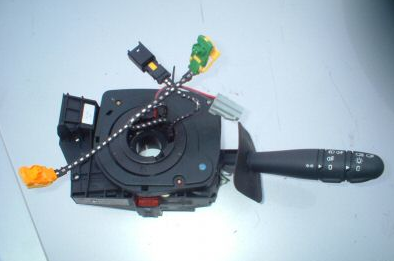

Airbag squib ring probably faulty.
Sits under the steering wheel and controls the airbag and the CC functions.

I'd put money on it being the airbag ring, easy to fit. I got one from sutts autos on here for £25 delivered so i'd try pm'ing him.
Looks like this:

Yes, exactly the same problem.
I tried changing both pedal switches, but that didnt help and I dont think the switches effect the speed limiter.
I tried putting an rstuner map on as remaps can cause problems.
I tried a different wheel which made no difference and it isnt the dash switch since it lets you select it and lights up.
Basically this is the last thing I tried, dont think there is anything else short of a cut in the wiring between ring and ecu or a fucked ecu but your likely to be getting other issues too if thats the case.
