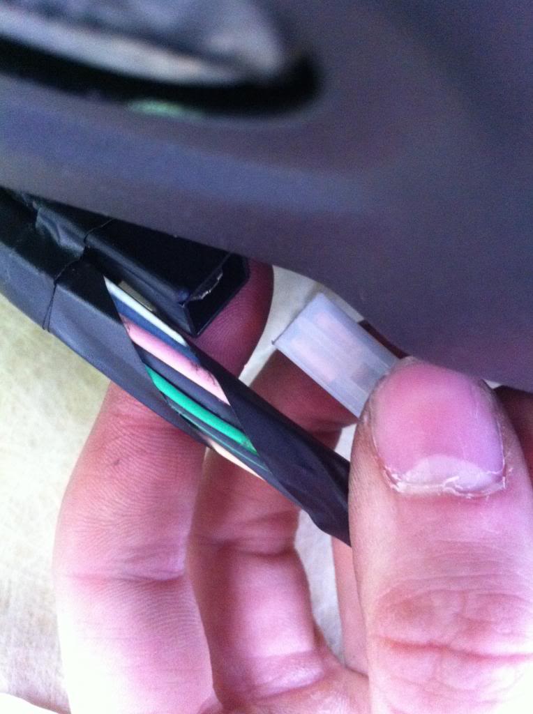

So I've always had really weak reception on my radio.
I changed the aerial base yesterday, but to no effect. However I noticed that this plug makes no difference whether it's plugged in or not. Can someone tell me what it's for please?
  Beaten up 182
I'm guessing the base is amplified?

  Arctic 182

Yeah that's what I thought - might explain my terrible signal. But yeah I did, you also have to pull away the side panel on the drivers side as that is where the other connector is to the one pictured above. Just have to undo the screws and pull it away slightly, then you can disconnect it and connect the new one.

Changed it today, thanks for the info. Unfortunately some %^&* had cut the aerial lead so as well as changing the base I had to replace the lead as well.
