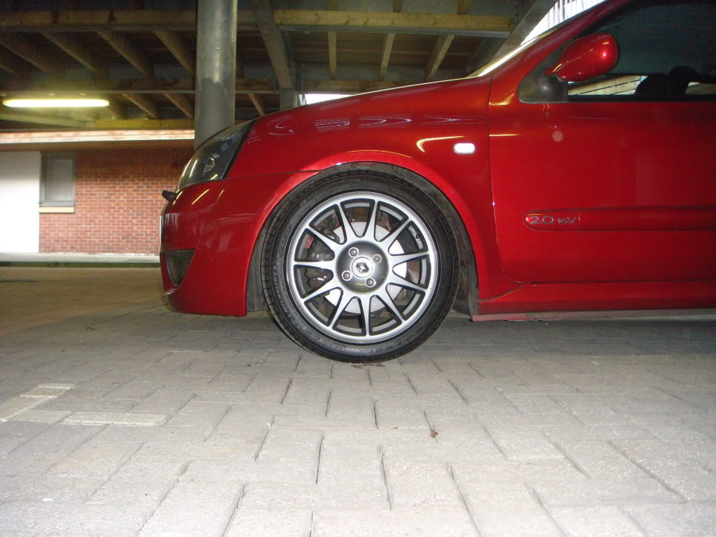

I have been adjusting my suspension this evening in preparation for combe trackday on the 24th.
I have H&R coilover suspension on my 172 which is set quite low :eek:
Its quite noticeable when I go out for a "fun" drive that there's scrubbing when cornering hard.

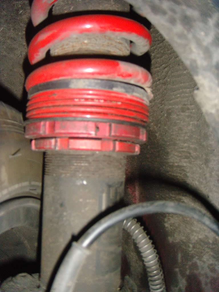

I don't know how low exactly the suspension is currently set so before I started, the way I measured it was that there was 25mm of thread left for height increase on the shock. Using this method I raised the height by 10mm, leaving 15mm left of thread.
Wheels back on and out for a test drive... no noticeable difference :( the car feels slightly more bouncy but cornering seems just as bad (or maybe worse?) than before..
So, need some advice from you good people! :) Have I adjusted it wrong? I assume to raise the height you de-compress the spring allowing more height. Are coilovers naturally lower than normal suspension on their maximum height?

Could be why. Since yours is a 172 the 'correct' (although the trophy offset isn't wrong) would be the 172 cup offset. The Trophy turinis are the 'correct' offset for the 182.
I may be completely wrong here so don't take what I say as gospel, but it could be the reason behind it :eek:

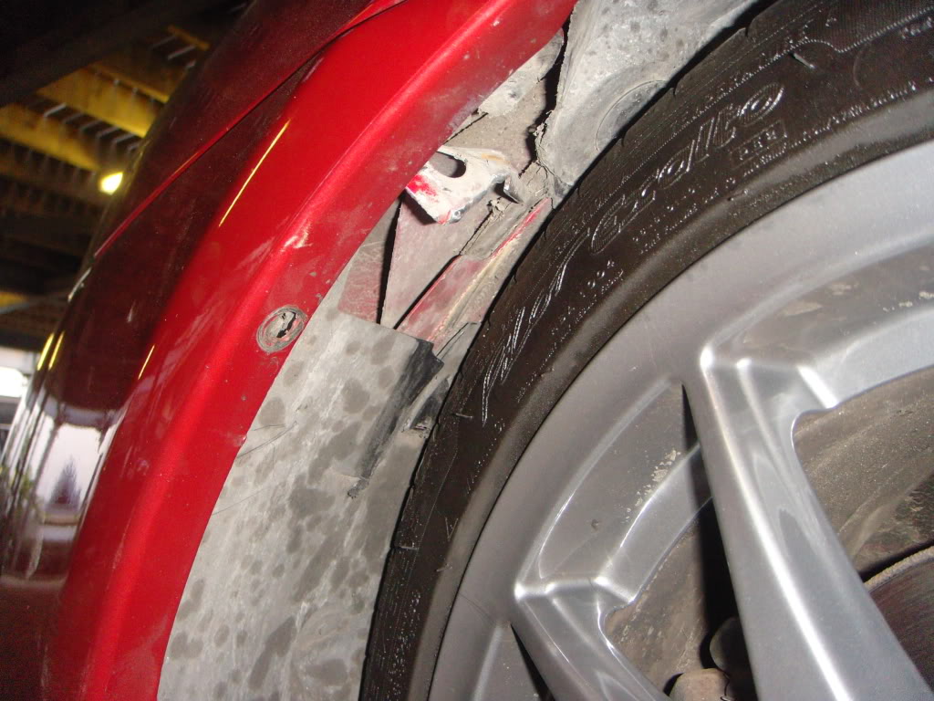

Let them rub the arches away then they won't rub anymore. No point raising them up it's a pain in the arse.
Just cut the bumper mount off and you'll be fine. Mine is set low and it doesn't rub at all anymore.

Had mine set silly low and you can see marks on the drive shaft and on the inner chasis leg. (caused by hard right handers and it being too low) Ive raised it now, 90mm from the bottom thread on my FK's, drives much better.

The spring doesnt change in length the more you wind it up or down, It just brings the damper shaft out the body! AFAIK the more you raise it the more comfy it should become ie softer.
Odd how yours scrubs though I have 37 offset OZs on my 182 on H&Rs wound as low as poss on the back and the front to match the stance, Doesnt scrub at all cornering, I was told it should scrub its nackers off! Admittedly it does catch when travelling with some pace down some uneven country roads but only when it gets rough on the straights
I was under the impression around 43 was the offset for 172s so it shouldnt catch if they are trophy wheels unless it is the bumper bracket in which case it can be bent up or cut off!
My advice would be to take a wheel off and look for teh ET mark which wil give us more idea what wheels they are
  lift number 1 @ btm
I'm not sure about the offset or scrubbing issue, but does the op realise that changing the ride height will have an effect on the other settings, ie. camber, castor etc?
I seem to remember that the standard 172 wheels are et 46, but I also ran 37's.
They were fine with 45 profile tyres, but rubbed on the rear with 50's
On et 43 I can comfortably run 205/50/15 track tyres with chunky shoulders and have no rubbing issues at all.

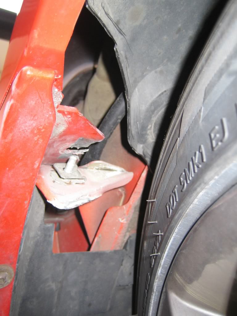

on the way back from wk today my gf hit a bump in the rd.. scrub scrub ( as usual :( ) however there after the passenger side is scrubbing on the smallest of bumps.. this is the result ..
The metal bumper mount has bent down and over.. im surprised they tyre didnt puncture.. obviously this is a pain in the arse and i need to get it sorted asap!
so im not sure what todo height wise now.. leave as is, or put it back to as it was before. here are some more pics of the shock and side-shoot.. i dont think this is stupidly low, but cant believe the problems im having..

that doesn't look good!
is the wheel as close to the strut as it looks in that picture too?
have you had a good look around all the mounting points, whishbones, etc, too?

do you not think that tyre and wheel looks close to the shock in the picture?

no. the spring is compressed exactly the same amount. only the platform has moved.
it is possible to run into problems at the other end of the adjustment, where the spring is being compressed between the platform and the top mount.
but here the spring is just resting on the platform with the weight of the car holding it down.

s**t!... its just clicked how this now works.. so to raise the suspension the bottom platform should move up the shock, not down like I have done it..
So the way I measured it was 25mm of thread left under the platform before I started, I adjusted that down to 15mm.
What I should of done to raise it was raise the platform so 35mm of thread is left beneath the platform.

it could well feel more bouncy because of the suspension changes, the most efficient height would have the wishbones parallel to each other. i imagine yours are pointing towards the ground in the centre of the car at the moment?
They always run that close if your low and have camber, as long as they don't touch then its fine.
Most people don't run that low so their adjuster is more in line with above the top of the tyre rather than lower down.
