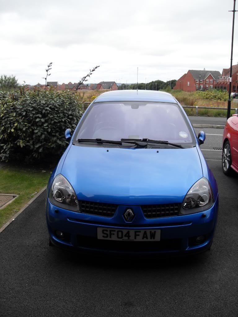

This is the 182 before any work was carried out:

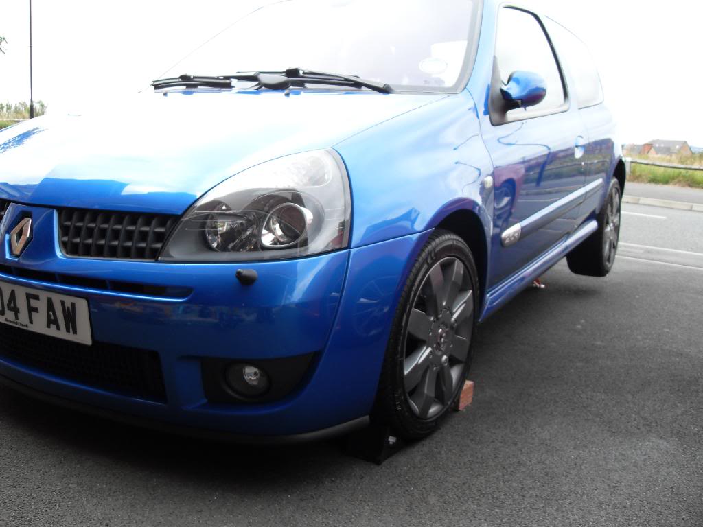

I can honestly say i have never been under the car before and i didnt own any axel stands.

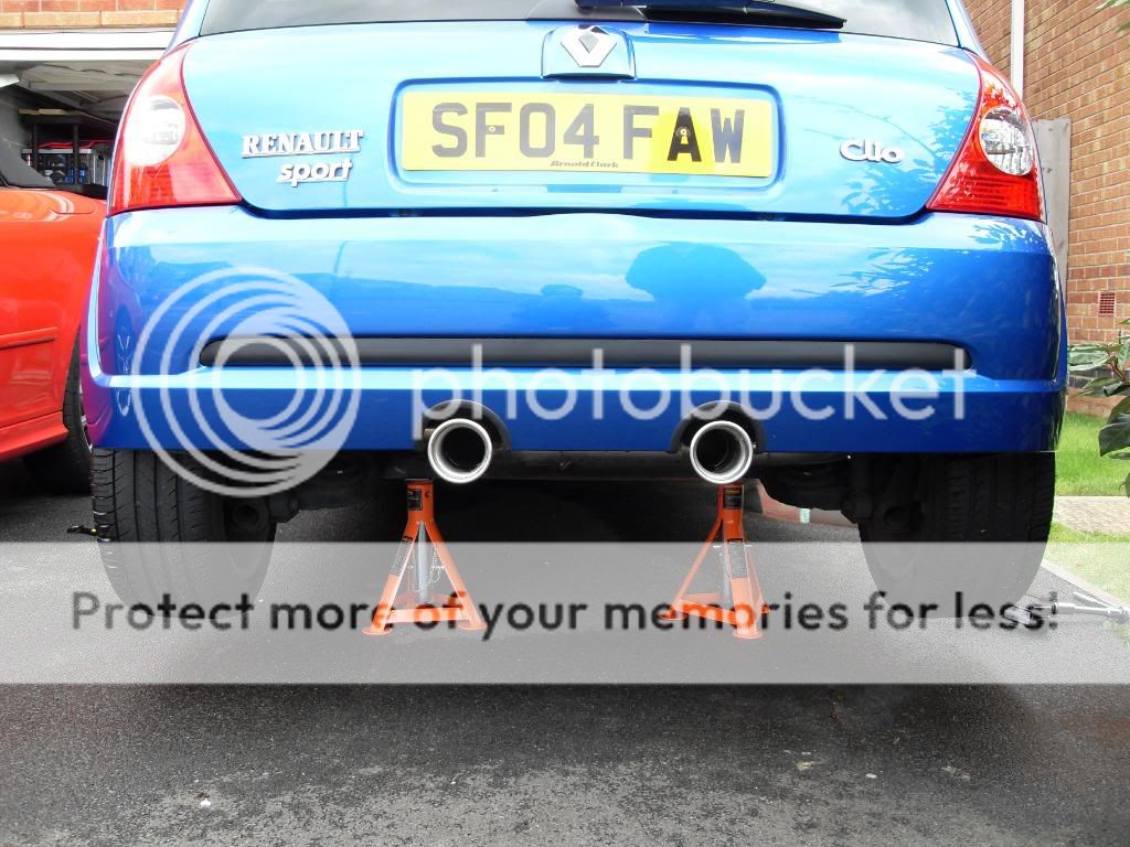

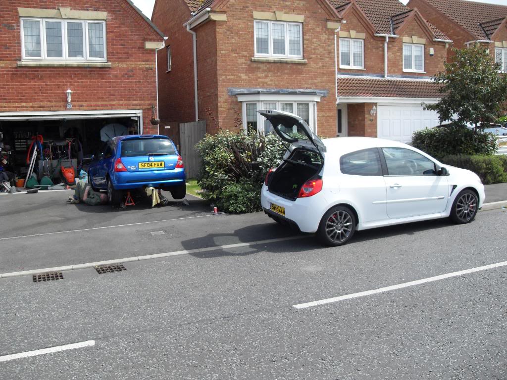

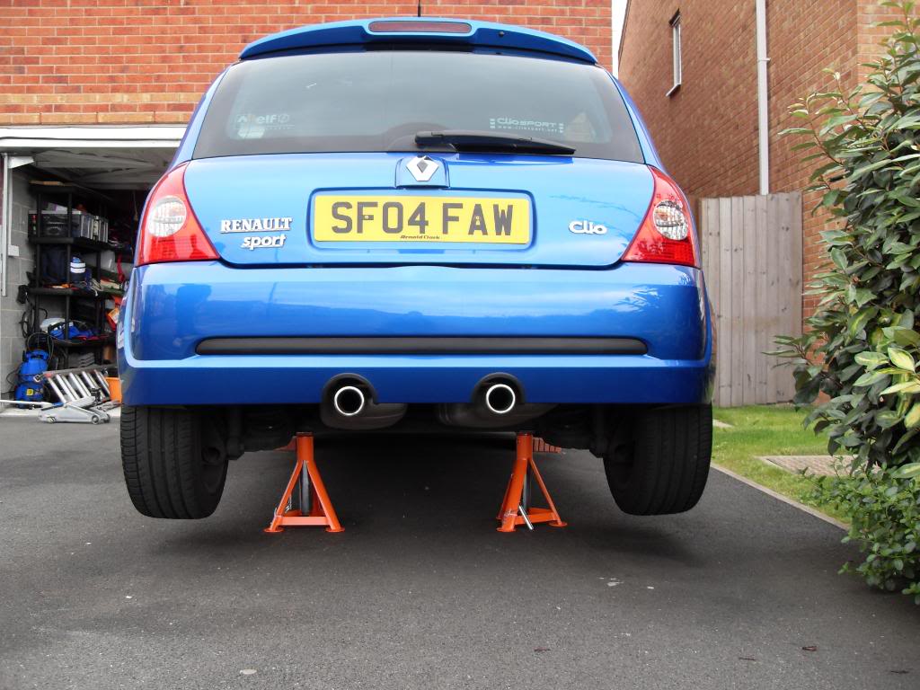

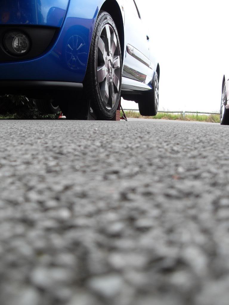

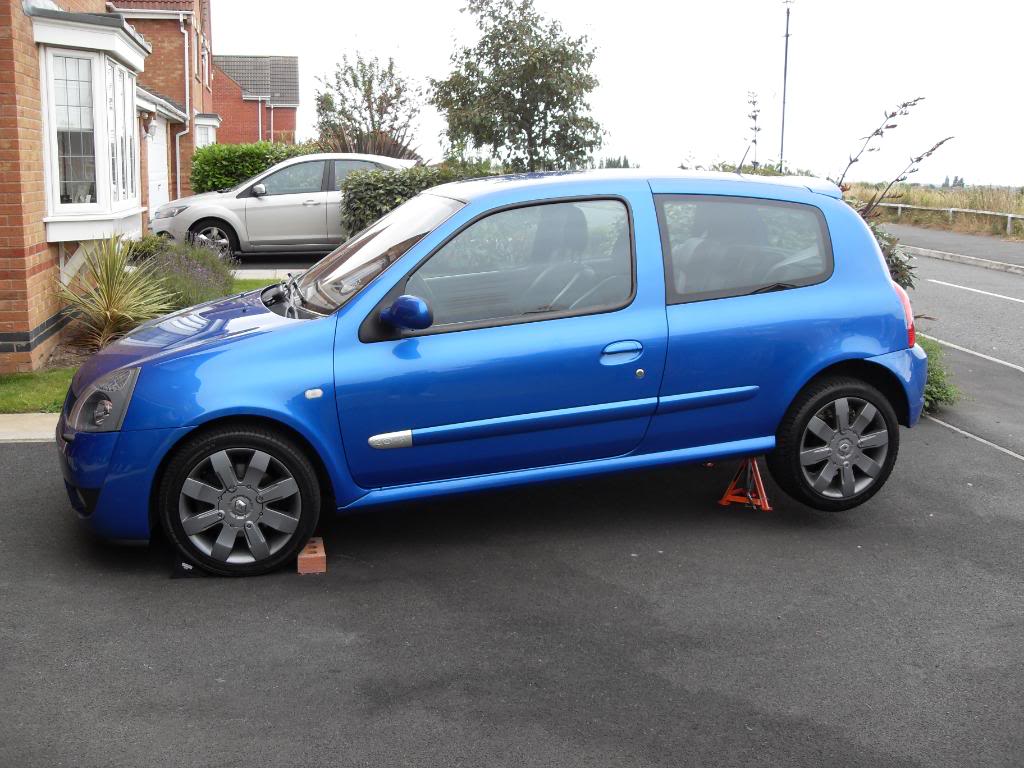

For some reason i have been a lil scared of jacking the car up :S but up she went:
I thought it would look a lot lower at the font than this with the rear on the stands:
Does look mean though :approve:

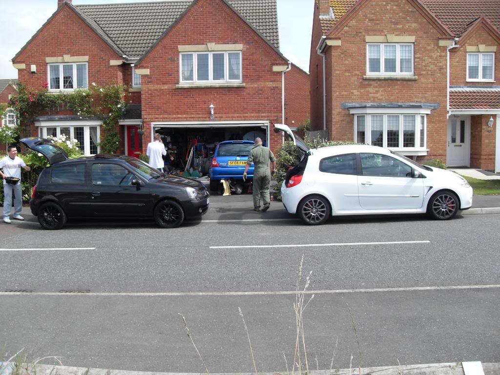

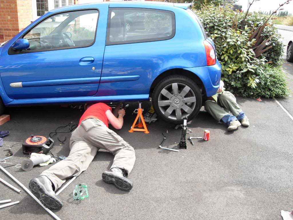

I managed to get so far (not very far at all) and then i needed an extra set of hands, so Ste came to the rescue (Ste01):
Followed shortly by Liam (Camble):
The house then started to look like a pit stop:
Liam's 1.2 16v:
Ste's 197:

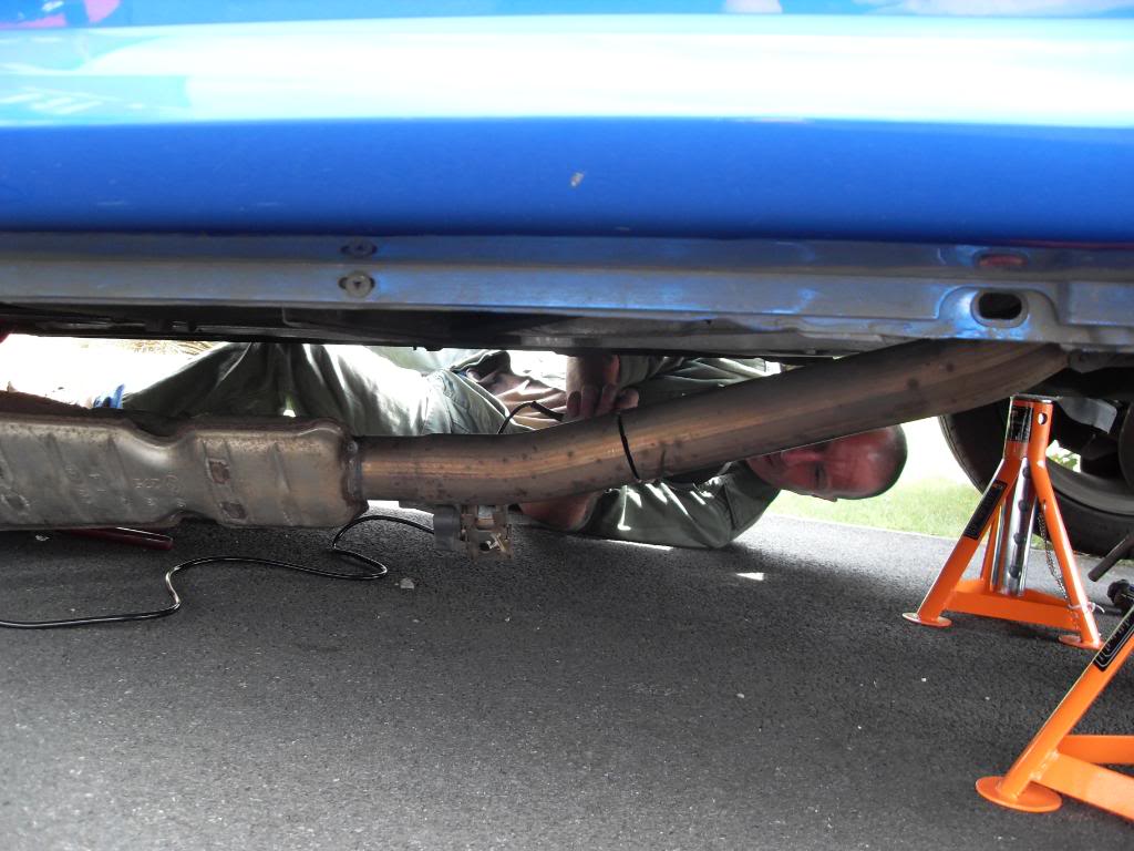

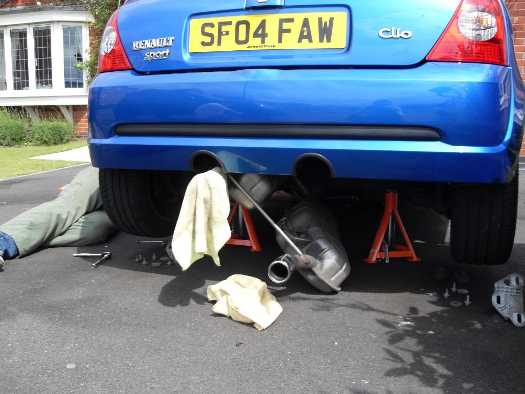

I only managed to get the bracket that holds the cat and centre pipe together off (took ages) and some of the bolts, supports etc. I was determined to get the exhaust off in one. This is Ste telling me it isnt possible as it is:
Think we spent 20+ minutes trying to find a solution to get it off in one, by this point Liam had got bored and was on a mission of his own....... to create a 1.2 bumble bee!
More pics of his progress:
http://www.cliosport.net/forum/showthread.php?t=435090

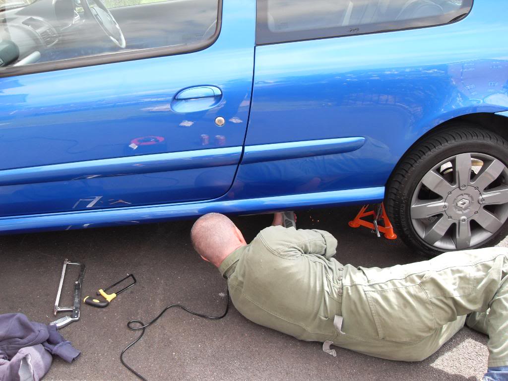

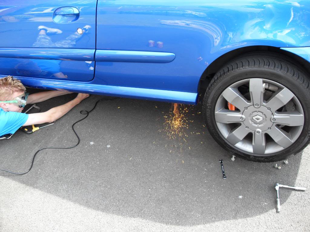

We then decided the only way off was to cut it off :dapprove: Ste again jumping to do the work:
Me and my brother taking turns to get our hands burnt whilst Ste cut away (this is my lil brother on his go) :D
I was waiting for it to go bang!
Still unable to get the exhaust off even when we cut it my dad came to the rescue and started removing the heat shield's:

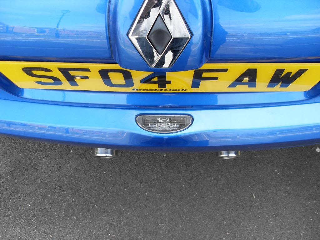

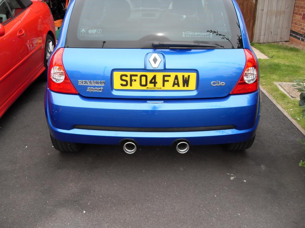

Eventually we got the new exhaust on (then Ste and Liam had to leave):
It was leaking from the centre and just before the back box but this was solved by tightening it up. This is what it looks like now:

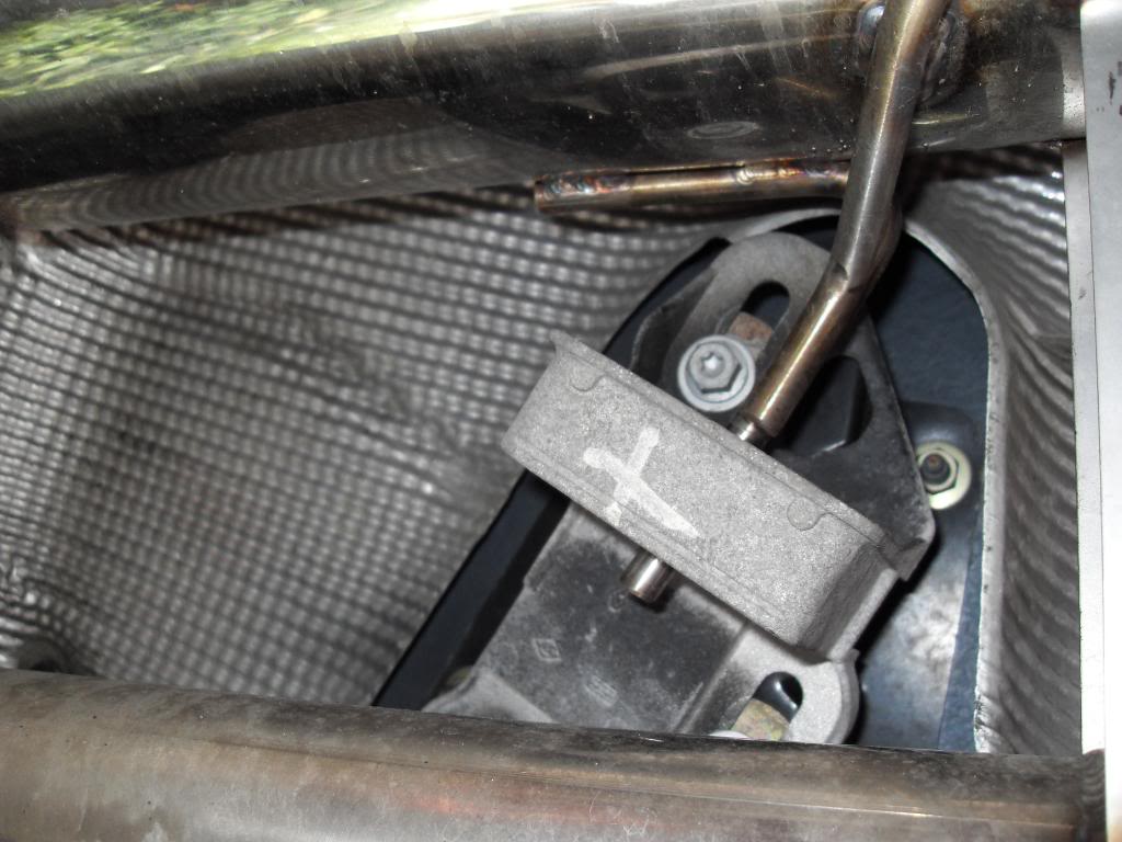

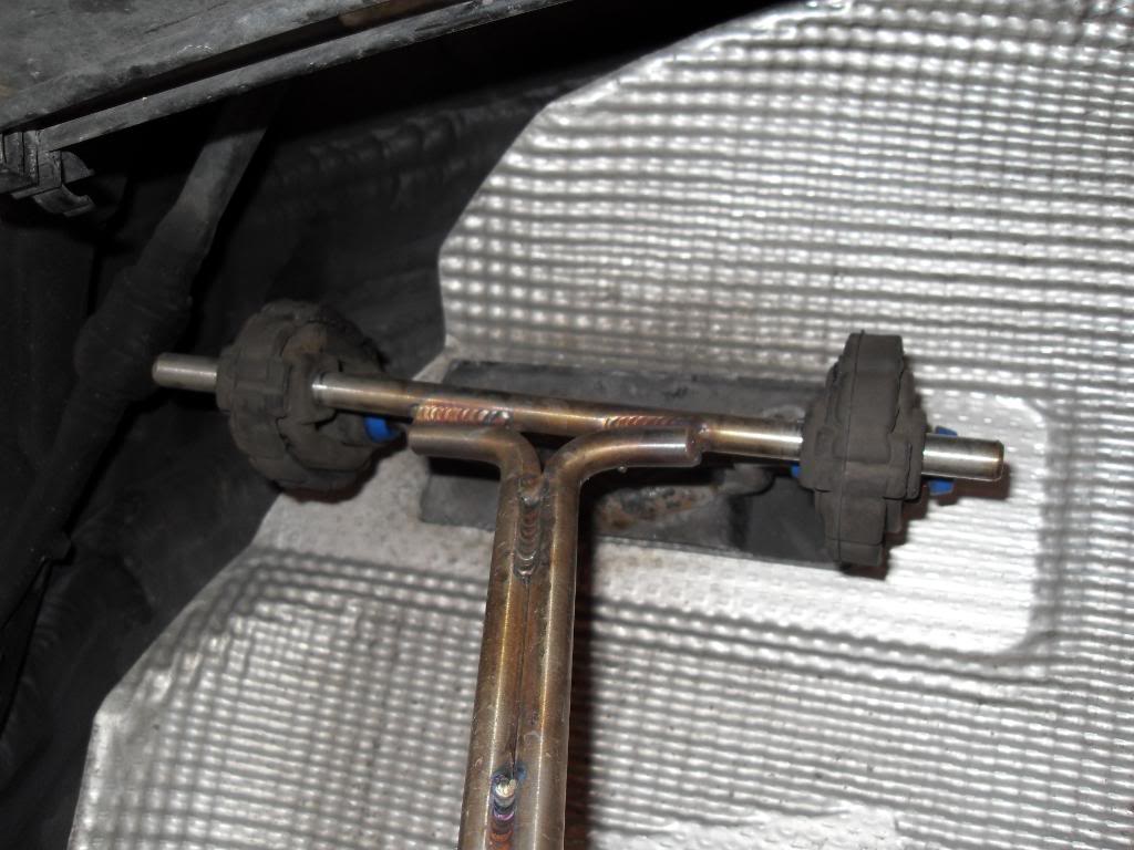

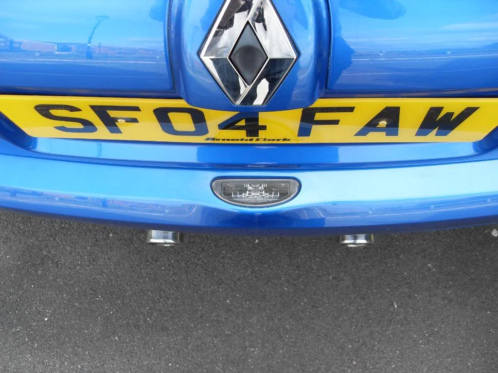

I am happy with the exhaust but i want it to sit better in the centre, i tried tonight but i think i will need new brackets (with the rubber x's) as the x's have started to give way and i may need to bend the arms. I will do this when i have the new brackets.

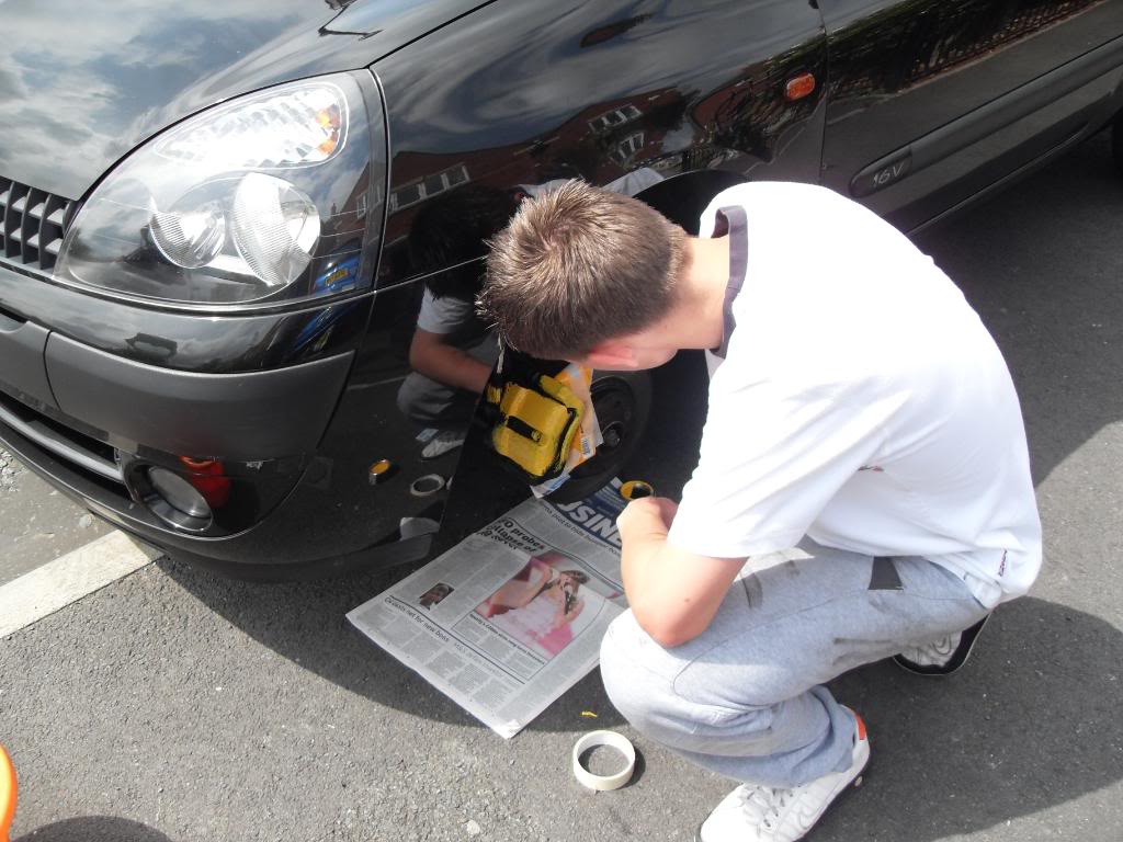

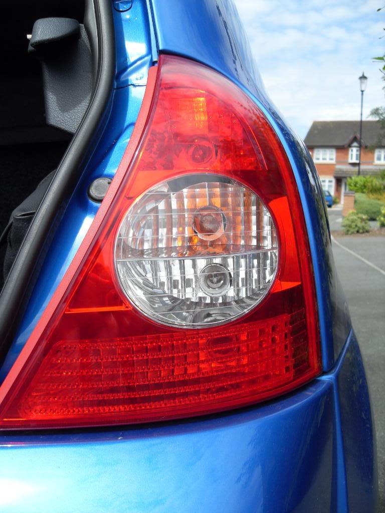

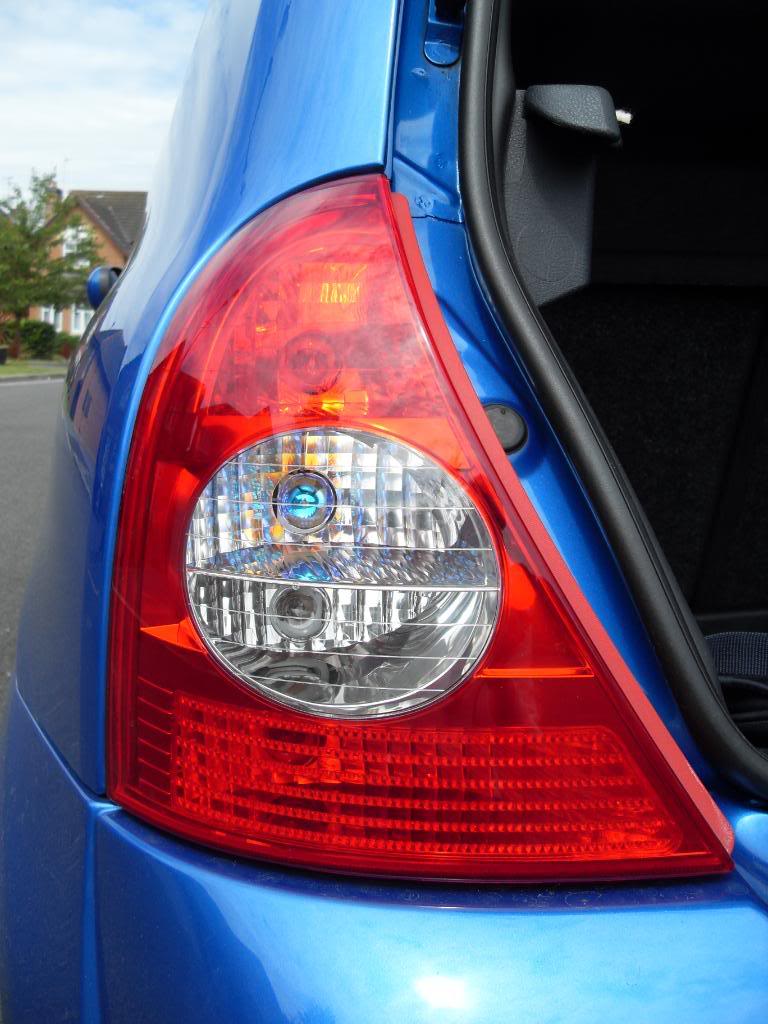

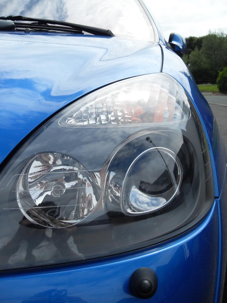

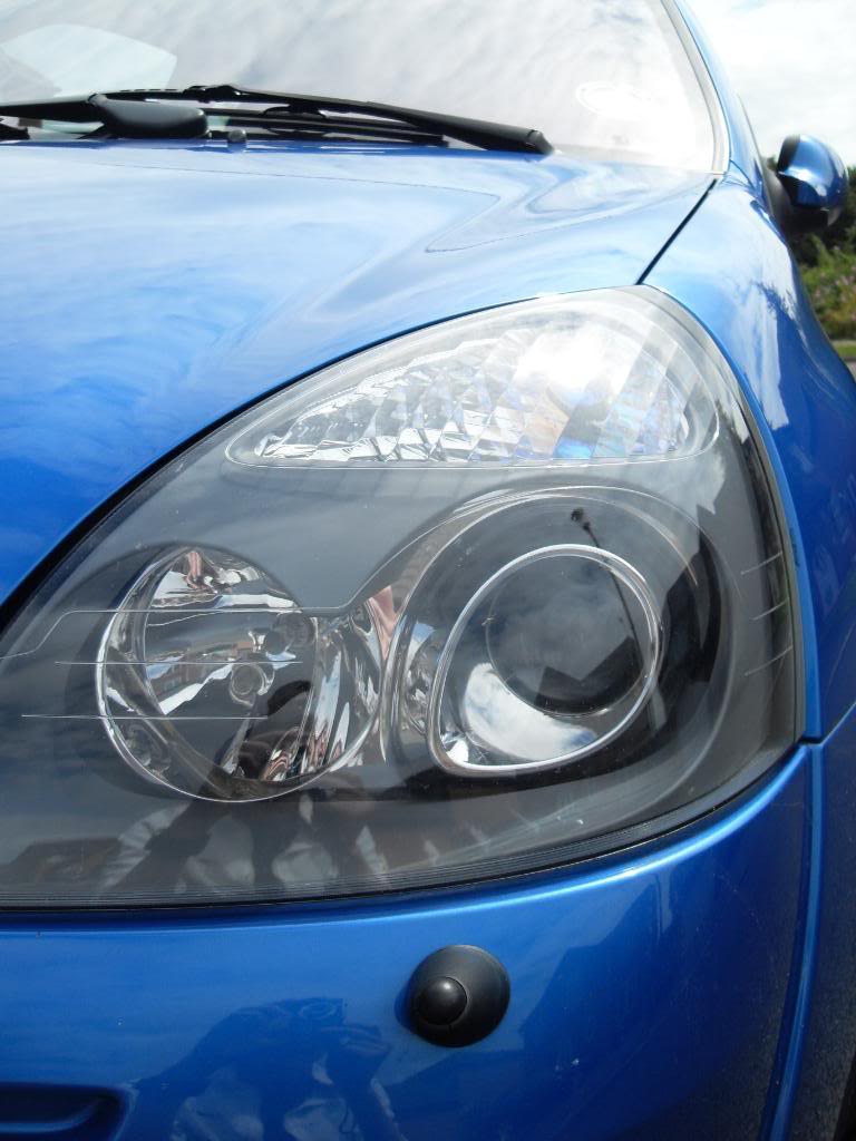

After seeing Ste's blue indicators i decided to invest in some of my own:

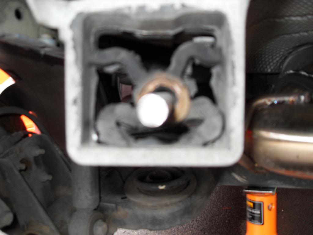

Interesting read mate. If you want to get it to sit more central though, pack the exhaust mounts (x's) with an old socket or small piece of copper pipe on the right hand side of each X. Use a tie wrap to hold them in place, works a treat

Interesting read mate. If you want to get it to sit more central though, pack the exhaust mounts (x's) with an old socket or small piece of copper pipe on the right hand side of each X. Use a tie wrap to hole them in place, works a treat
I will try this Gaz thanks :) an i tried to make it as interesting as possible :) thought i would fail lol

Nice one mate. Use calbe ties to get the exhaust to sit straight. Works a treat.
Cheers for the advice :approve:

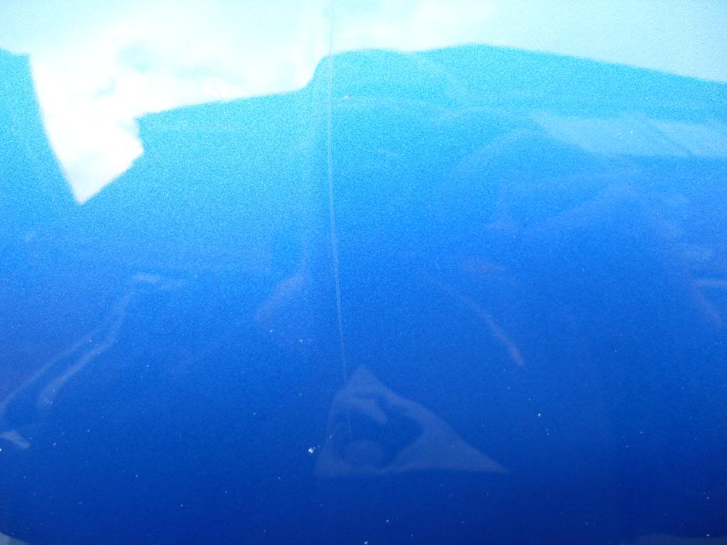

I have quite a deep scratch on the bonnet from a stone and a small dent does anyone know how or who in the NW could get rid of these and the cost? It is really annoying me :mad:
I will post some pictures tomorrow evening.

Yes we did cut it, on the straight pipe just after the first silencer. I believe it can be taken off in one if you remove the rear bumper and you can lower the rear axel enough to get the first silencer over. I would of thought the new ones would have come in two pieces with a bolted joint?

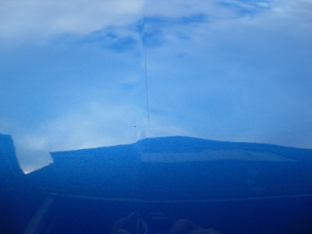

First here is the nasty scratch on my bonnet, if any one knows how i can get rid of it or anyone in the NW who will be able to get rid off it please let me know.

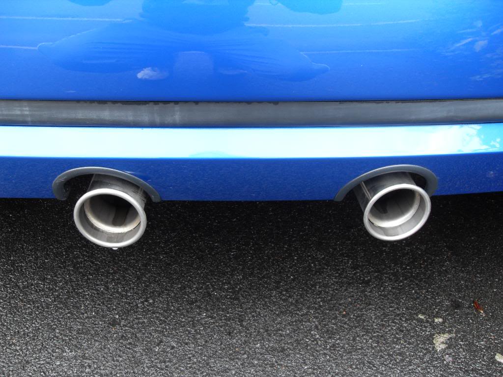

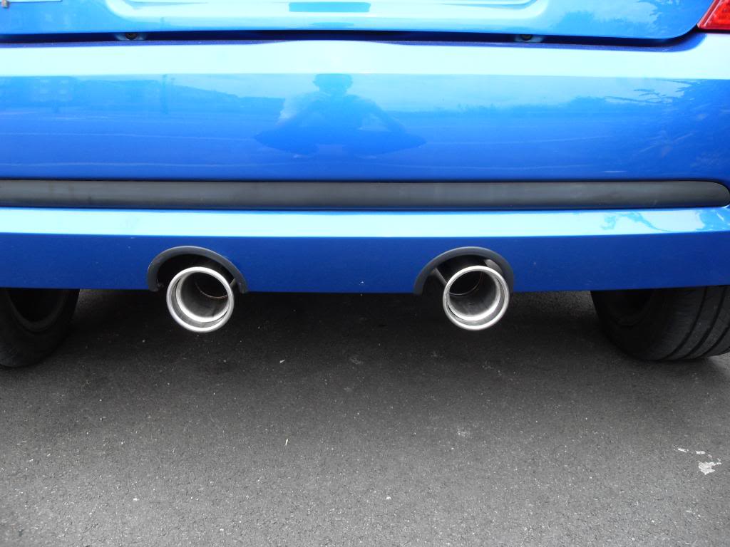

As i got a request for a picture of the exhausts once they had been used here it is:

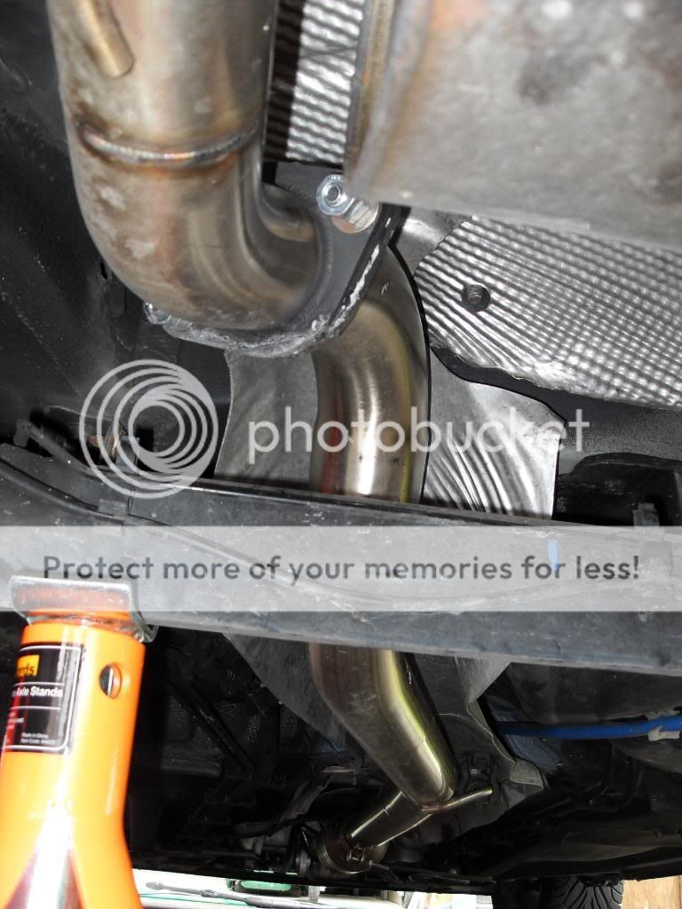

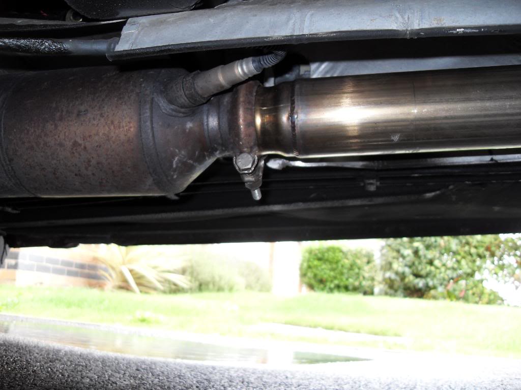

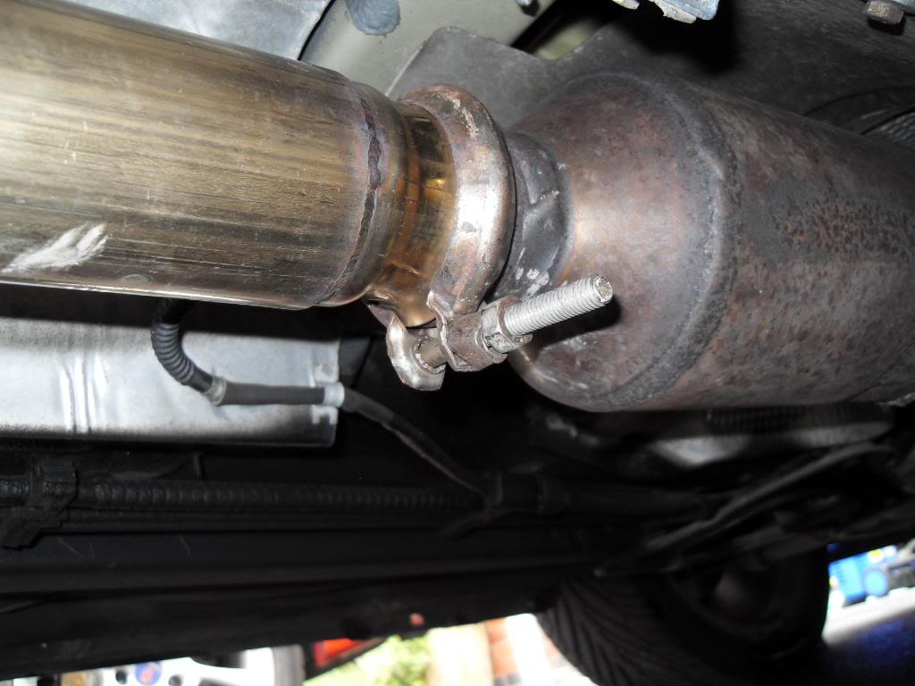

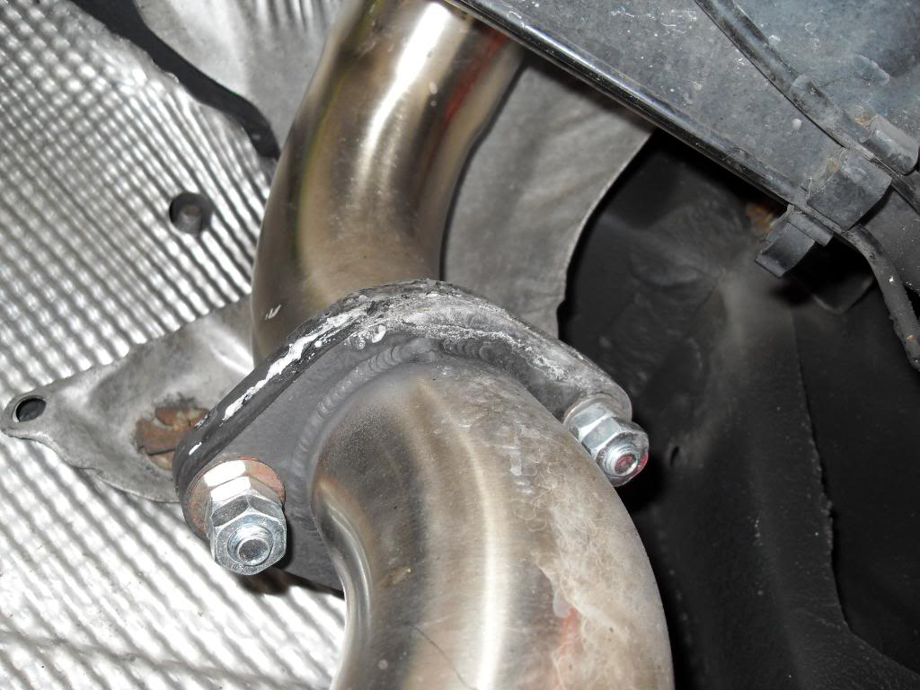

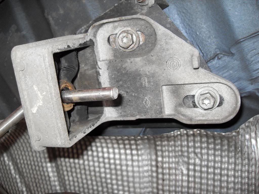

Right here is the bracket that holds the centre section and cat together:

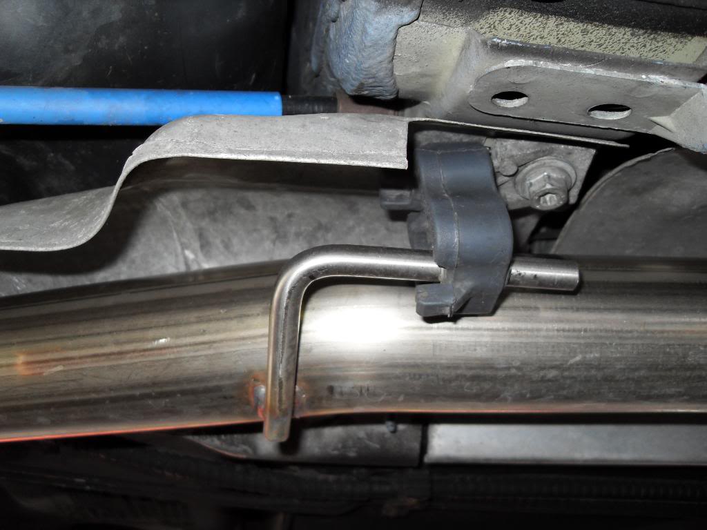

This is pretty much the only bracket that holds up the centre pipe:

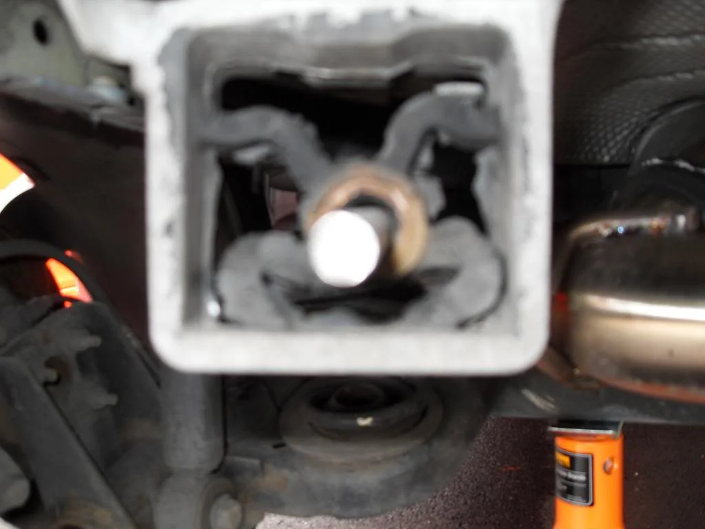

The brackets nearest to the rear bumber also supporting the backbox with the rubber x:
The rubber x looking a bit dead:

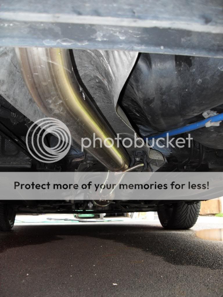

Finally the exhaust once i straightened them:
