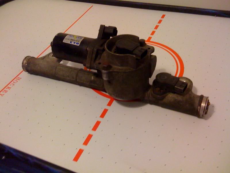

Remapped Super-Hicas controller to get it up and running before moving the whole car onto an SQ6M.

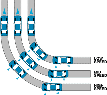

In short I'm going to make the rear wheels of the Clio deal with part of the steering effort.
Here's a useful Super-Hicas diagram:

Should be interesting especially when inside wheel is 3 inches off the black stuff.
And as such has no influence on the directional stability of the car regardless. The loaded wheel will still steer as requried.
If you wanted to really optimise it you'd mount the rack to the boot floor and put a pivot in the centre of the rear beam and ball joint the beam mounts to give a semi IRS setup.
