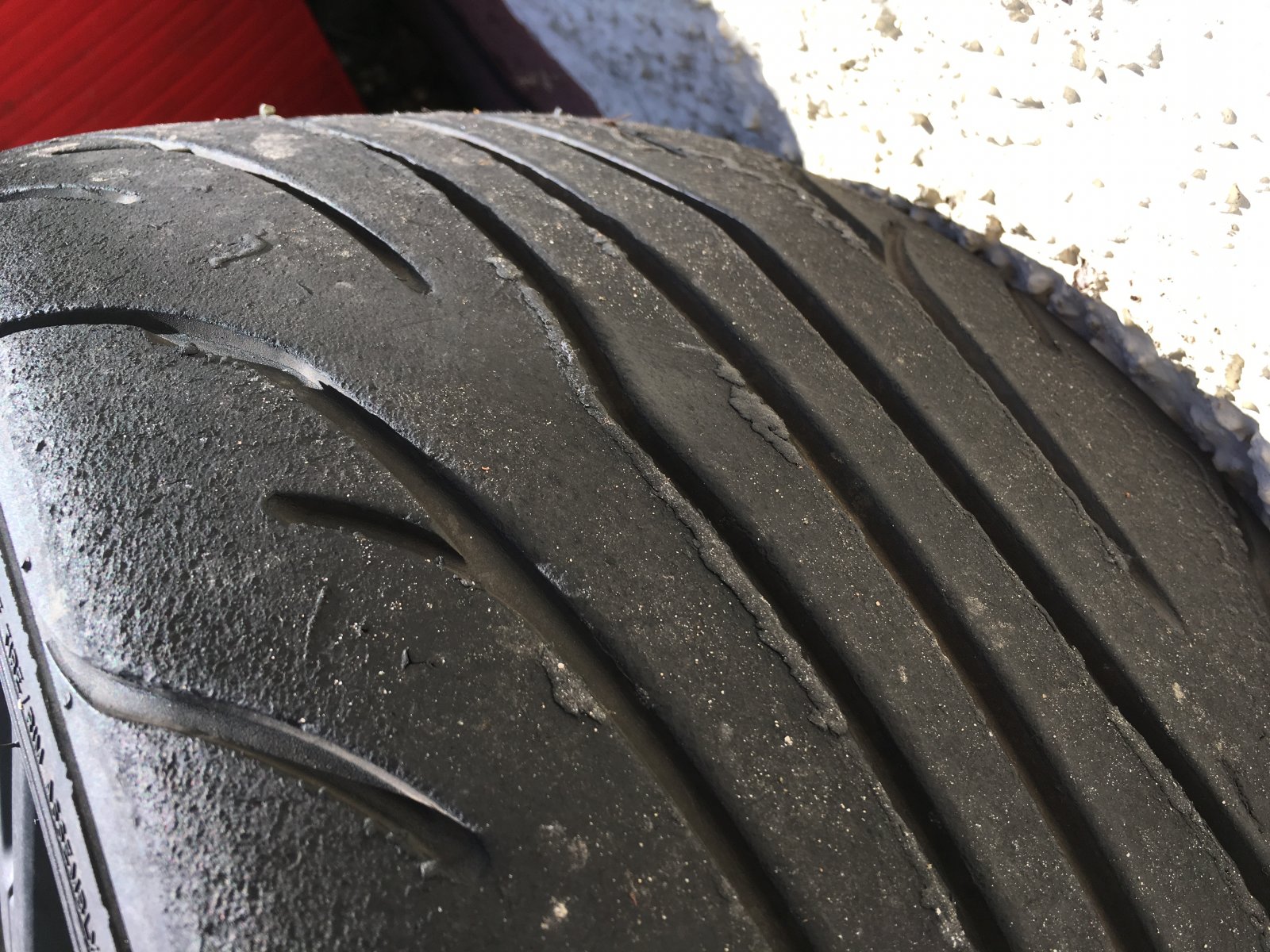

I'm running 7.5" wheels with 225 ns2rs and 30mm springs with no troubles.
@MartinL1993 can confirm its a good combo.
Not the best pic but I'm too lazy to get a new one.
You can see that they didn't roll too far over onto the sidewall. I was running 30psi hot
MartinL1993
Yeah the wear on yours gets to a good point on the edge of the tyre so no problems with roll
going too narrow on tyres is probably not the best but the sake of 10mm it shouldn't matter
