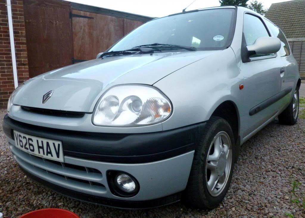

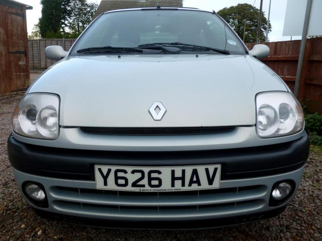

(Old pic where headlights wern't bad)

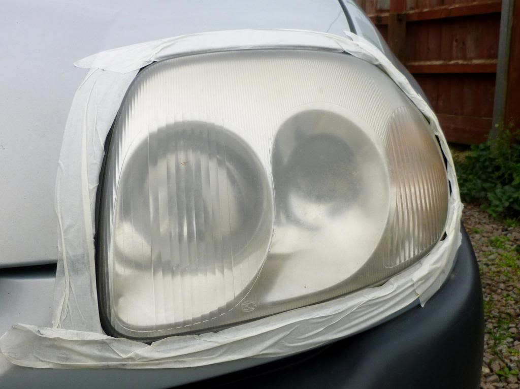

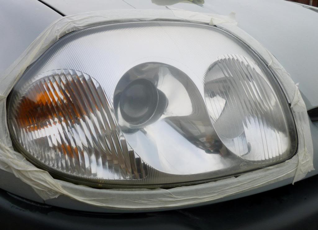

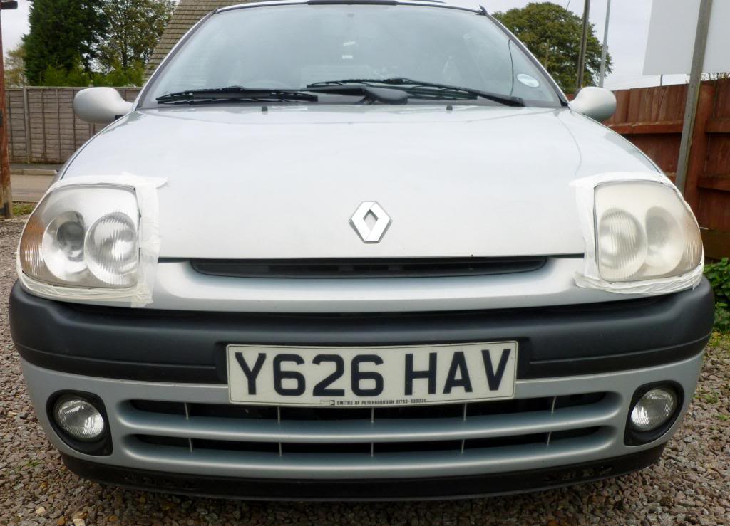

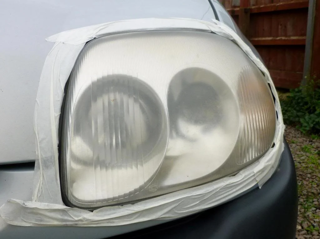

This is what I've done today:

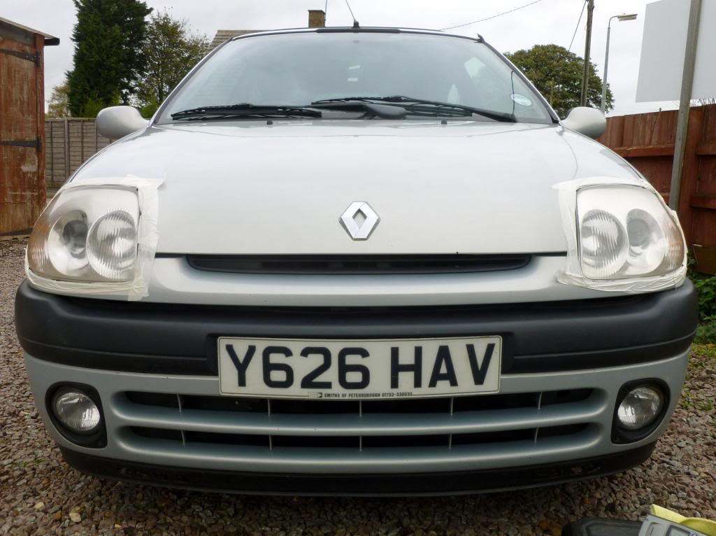

Driver side light before
Passenger side light before

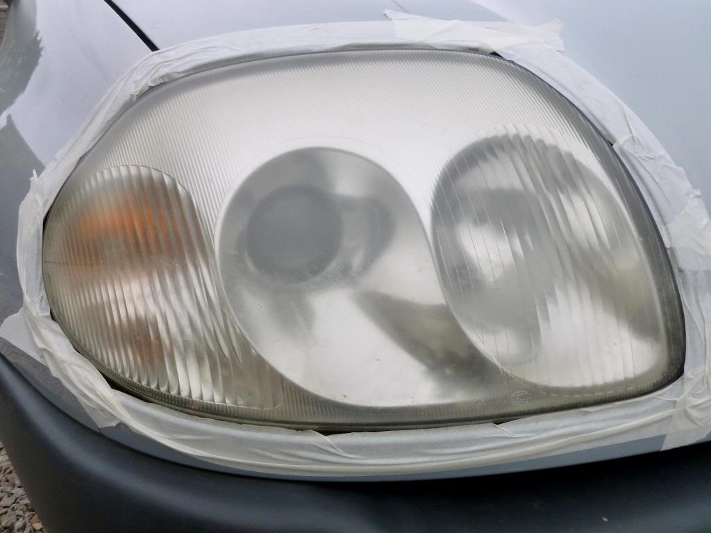

After 10 mins buffing on driver side
After buffing Passenger side for a while
After further Sanding & Buffing

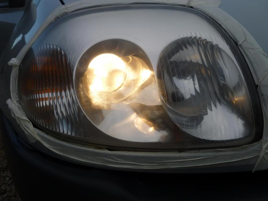

Some marks still that show with lights on that I can't get to go (Maybe Inside?)

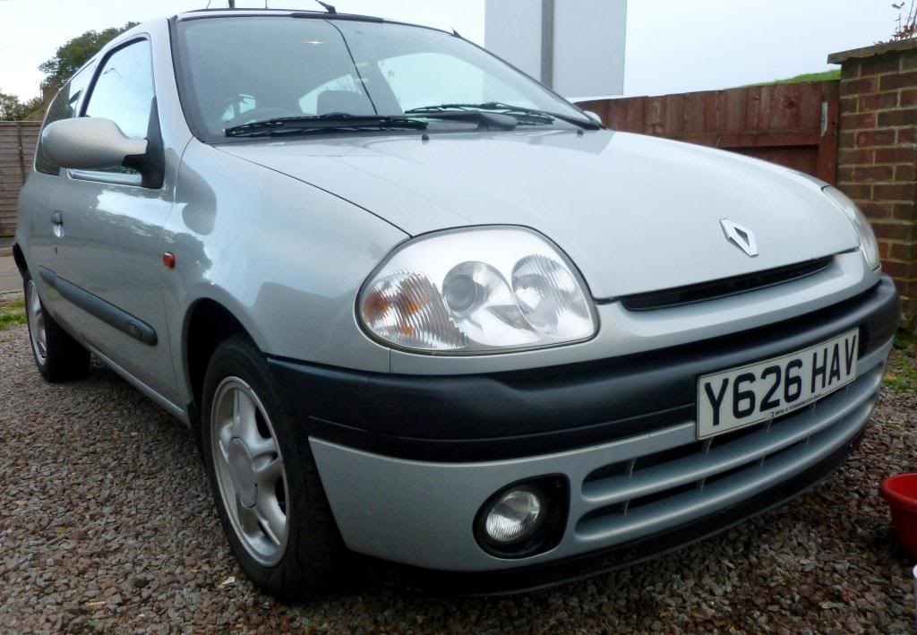

End result.
Definitely a ton better than they were, and hopefully they should pass the MOT this time. There still is some scuffs that show when the lights are one but I'm not sure if they are on the inside or just really stubborn.
I will probably give them a quick rebuff before the retest and then i need to order some sealant for them. I want to get a long lasting one like the C4 that claims up to 2 years or I also found Opti-seal which is cheaper too, is this stuff any good?

Much better, the Clio headlights are terrible for hazing.
What did you buff with? If they're really bad usually some wet and dry sand paper followed by polish will get the really nasty marks.
  2001 Clio Sport 16v
I got the Meguiars headlight kit and sanded with the 4 different grit pads they give you and buffed with PlastX and a buffer on a drill.
Adamm.
Sounds about right then, just have to use more persistence to get every single mark out sometimes.
I can't imagine there will be marks on the inside, if it's on the outside though you should be able to feel it by running your fingers or finger nail over the specific mark. If it feels rough then its on the outside.

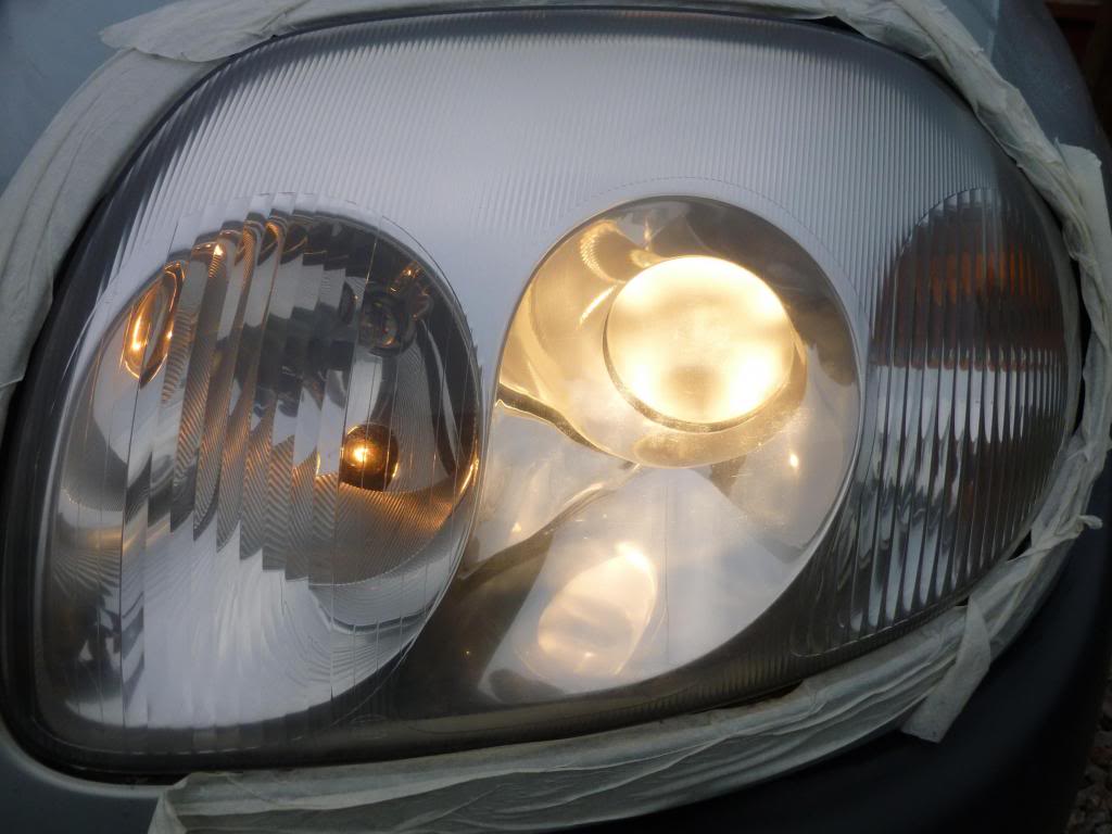

I've noticed that the driver side side light or whatever it's properly called isn't working so I'll need to get a new bulb for it. How do I find what the right bulb is for it to tap online, or I could go down the local Wilcos car parts place and ask them. I typed it in google & ebay and it comes up with a lot of Xenon bulbs and Xenon upgrades, are these any good or should I stick with the originals?
Adamm.
The Osram nightbreaker bulbs are plenty good enough for the original units. Also depends what bulb. It could be side light, dipped beam or full beam. Dipped beam I'm guessing is what you're referring too and those are HB3 fitment on the ph1 iirc.
  2001 Clio Sport 16v
Thanks for the fast reply, If you look on the 6th & 7th pics down of the lights on, its the 7th pic driver side inner little light that's not on. (2 turn clicks on the lights switch lever thing) hehe Such a noob with this stuff :eek:
If I was to remove the bulb will it say on it which one it is? Guessing its probably easy to change myself.
