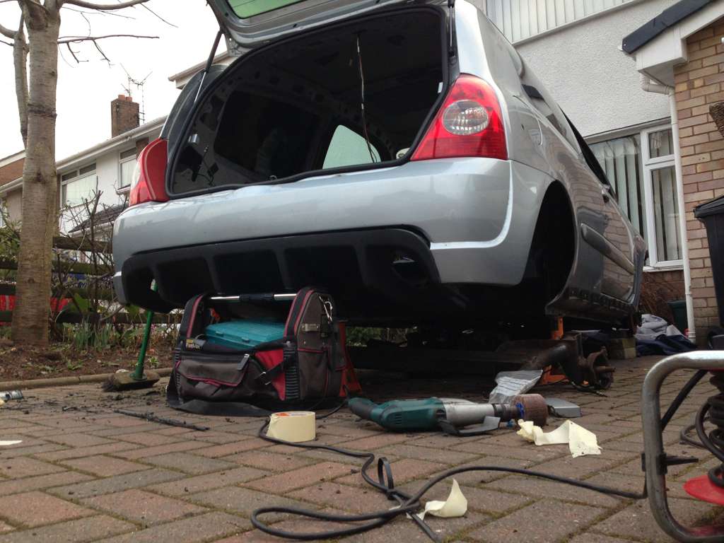

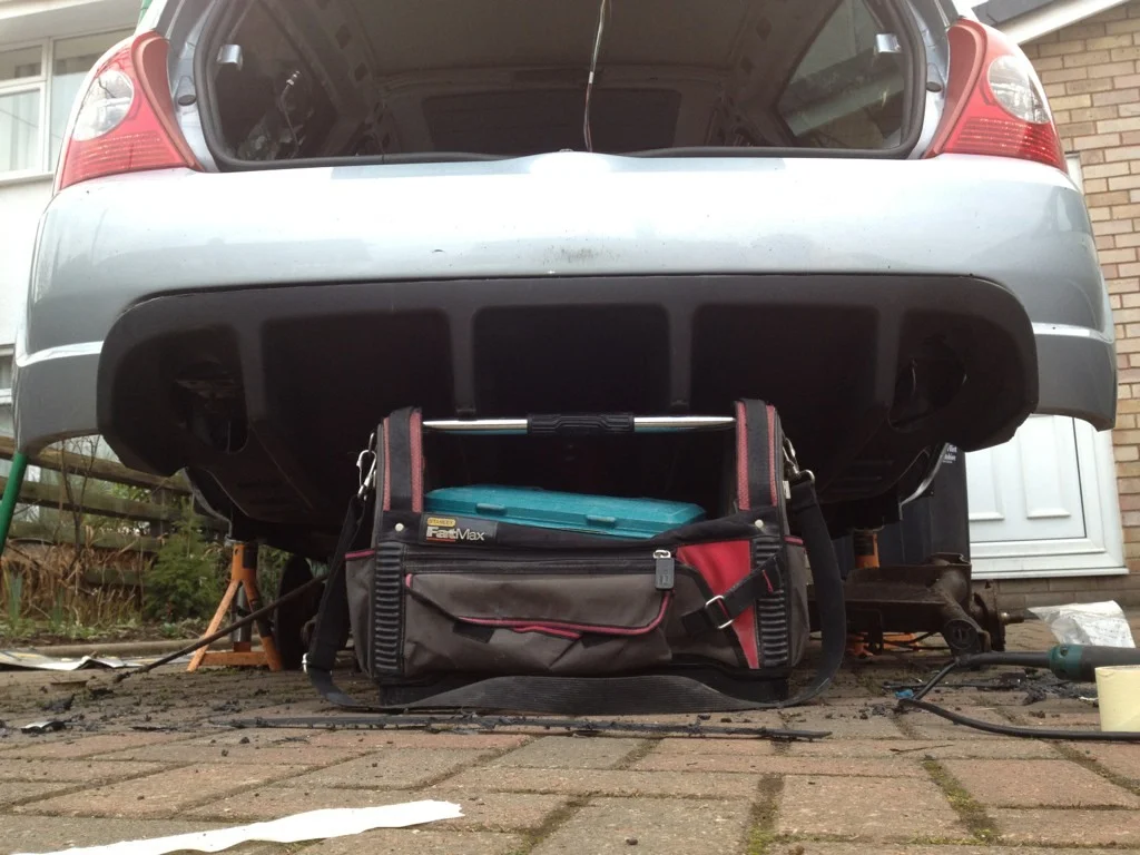

197 diffuser 85% complete lol

Will put up a thread when car is complete but just a few more pictures only cost me £100 so far

Not a fan of how it looks but worth it if you gain an aerodynamic edge by fitting it I guess?
would stick out a lot less on a black car but even still I don't think I could live with the looks unless it really did make a huge handling difference and tbh I'm pretty skeptical.

Not a fan but I would like to see an end result. There is one on a Megane on here, looks terrible.

I think the Megane one looks less out of place than this one, think its the being silver which really doesn't help in this case.

It looks good when finished chip! Although this guy has cut two extra holes for his normal 182 exhaust. Been wanting to do this for a long time to mine, but never found one cheap enough!

I've mounted mine higher in the bump strip as I think it looks daft like above..

That looks more subtle but still a bit over the top IMHO (but I'm an old fart)

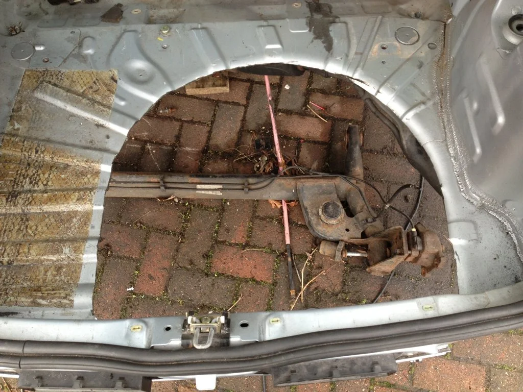

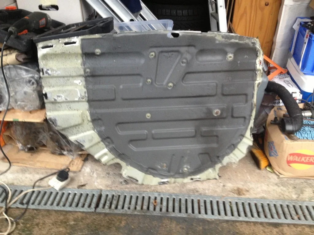

Erm as for fitting the diffuser I will explain later on its not going to be a case of cutting a hole and bish bash bosh.. (I thought it would be lol) and due to being a track car I'm not overly bothered about the finish but it is achievable if you take your time and mark out measure and stuff.
If your wanting to do it and want it looking o.e.m inside go cut a 182 boot floor out and get cutting and stripping was not a easy job trust me.

Ah so youve done away with the wheel well for it?
Is the 197 defuser the same as the 200? As in size?
No way it could be fitted while the wheel well is still in situ?
