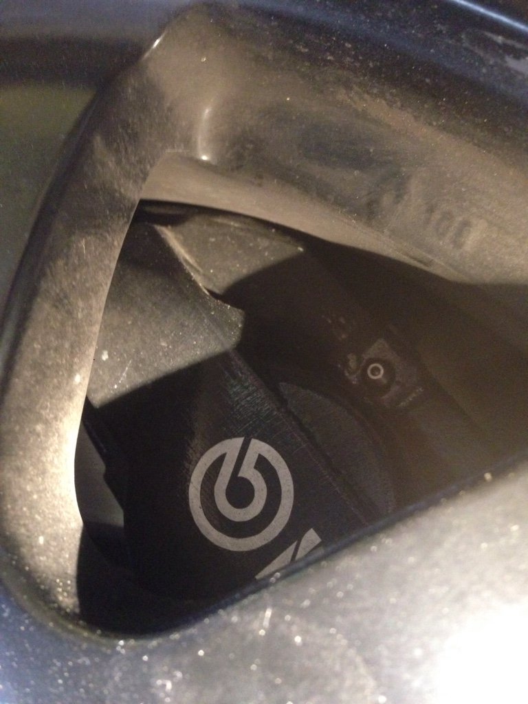

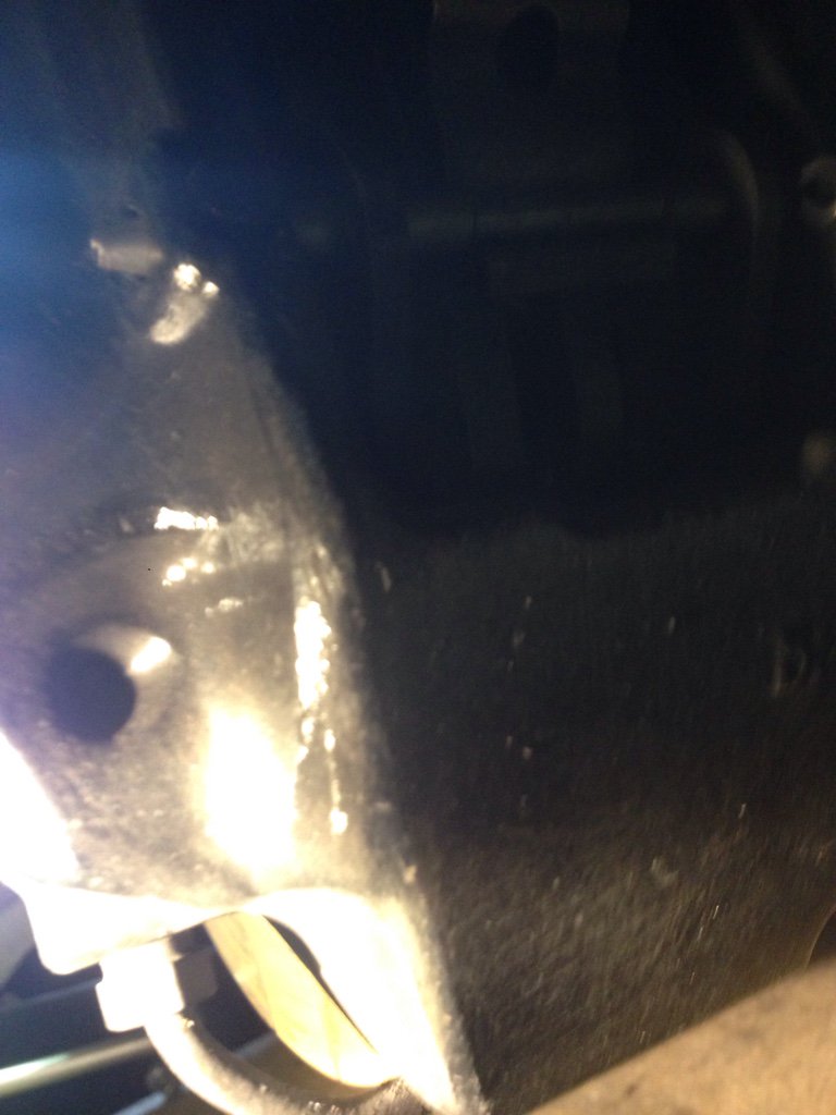

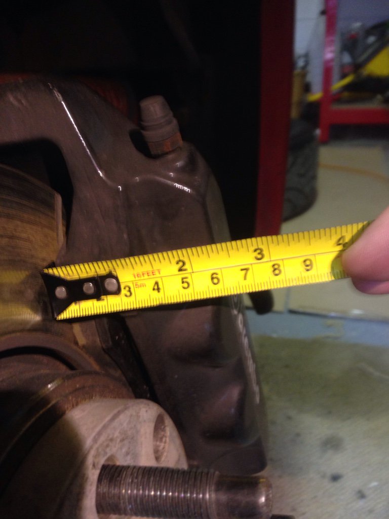

These are Meg 225 calipers (same as 197 I believe) and I run 15s on mine, and they are tight. They are signicantly less tight on my standard 16s;
From measuring disc face to edge of caliper, it seems to be circa 6 cm. I'd allow 6.5 cm to be safe.
It is worth noting though, that I have had the calipers professionally machined down on the outer edges here top and bottom;
And I also had them machined where they mount on the brackets. I need to run 16mm spacers for them to clear on 15 inch Speedline Williams wheels.
I know you can run 15 inch Td 1.2 without problems on lower spacers, circa 10mm I believe, although @Ph1 Tom can confirm.
Hope that helps.

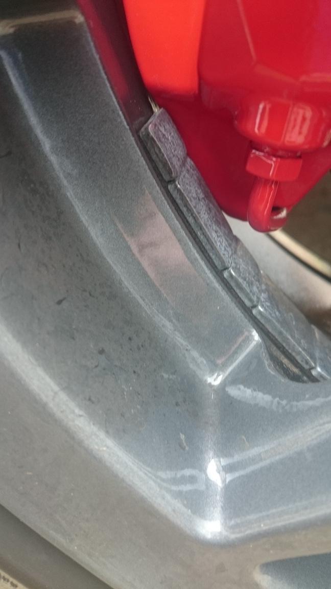

For anyone searching this thread in the future I have found that with 300mm discs, 15mm spacers and Trophy ET45 Turinis the wheels weights foul the caliper. I had to get them rebalanced and have the weights moved onto the center of the wheel which involved many more weights. It would clear if you had 20mm spacers though.

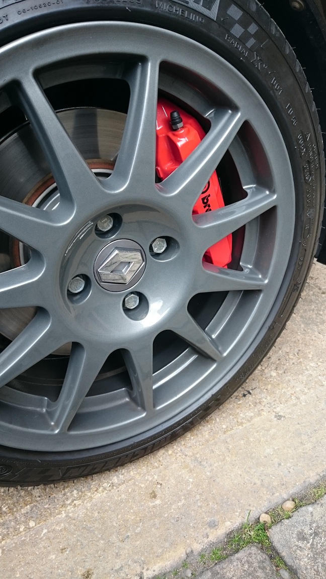

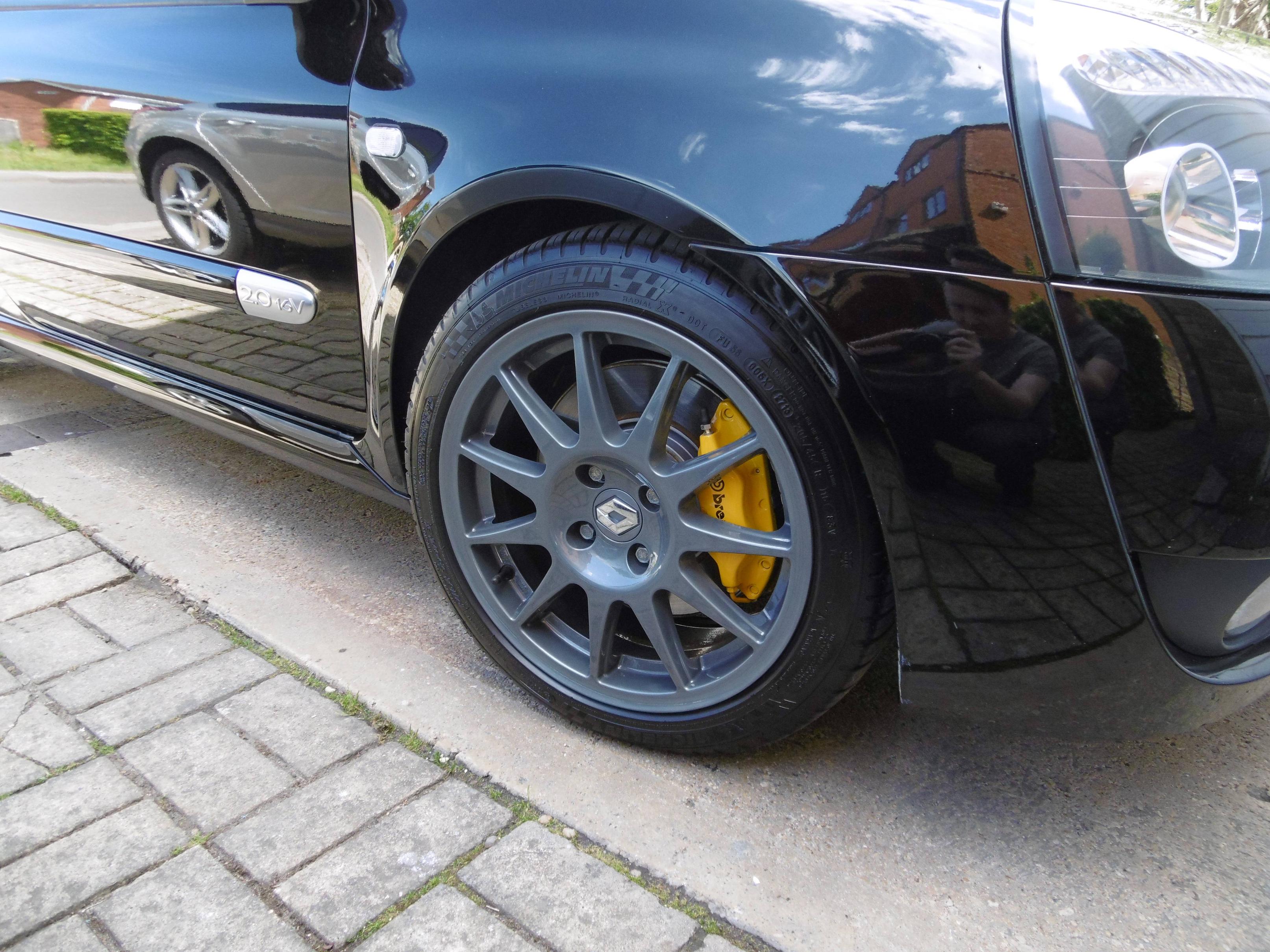

Here are my original 406 brembos with 300mm discs

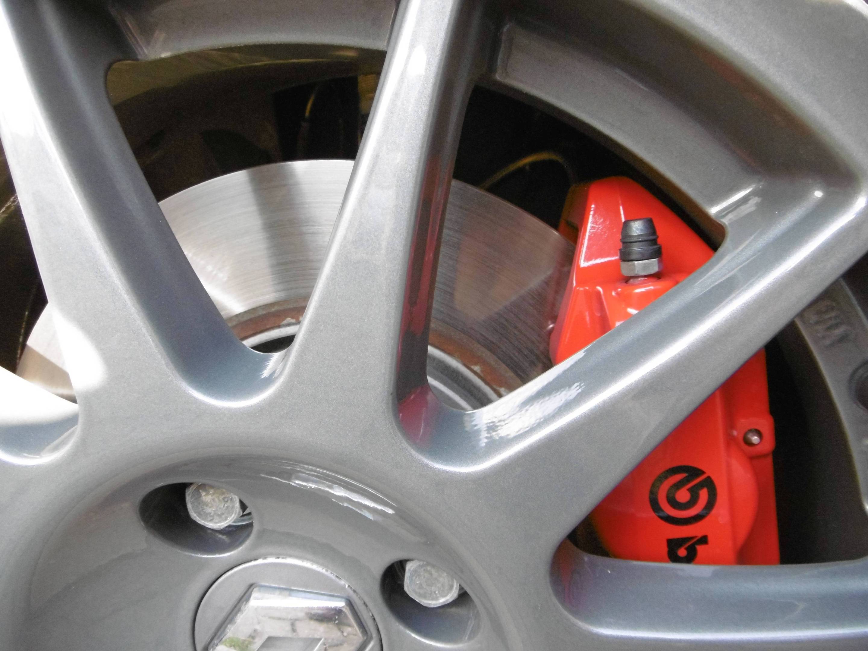

Then decided to buy some brand new 197 brembos as there was a stonking deal I found and went with Pure motorsport mounts (fantastic BTW) and ordered some Goodridge lines off some french retailer which were cheap cause of the exchange rate (£40ish pounds inc del) http://www.optimiz-access.fr/freinage/durites-aviation/durites-aviation-clio-2-rs-etrier-clio-3.html
They look nice I reckon, but i prefer the yellow ones personally. No way of going back as I sold the yellow ones.

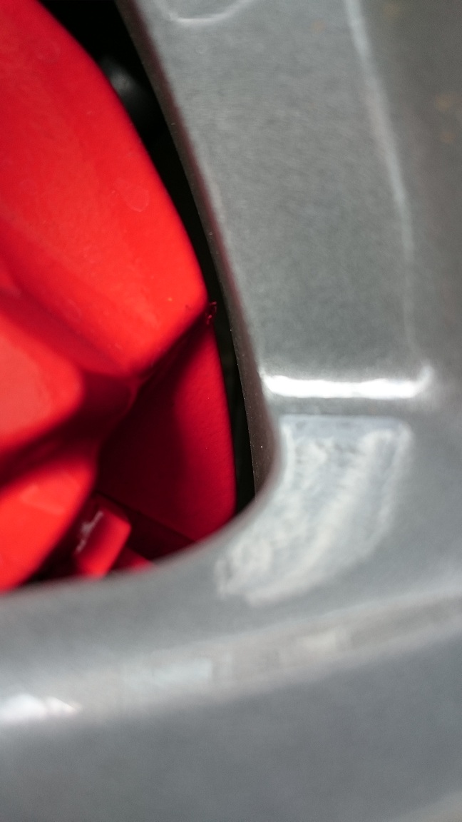

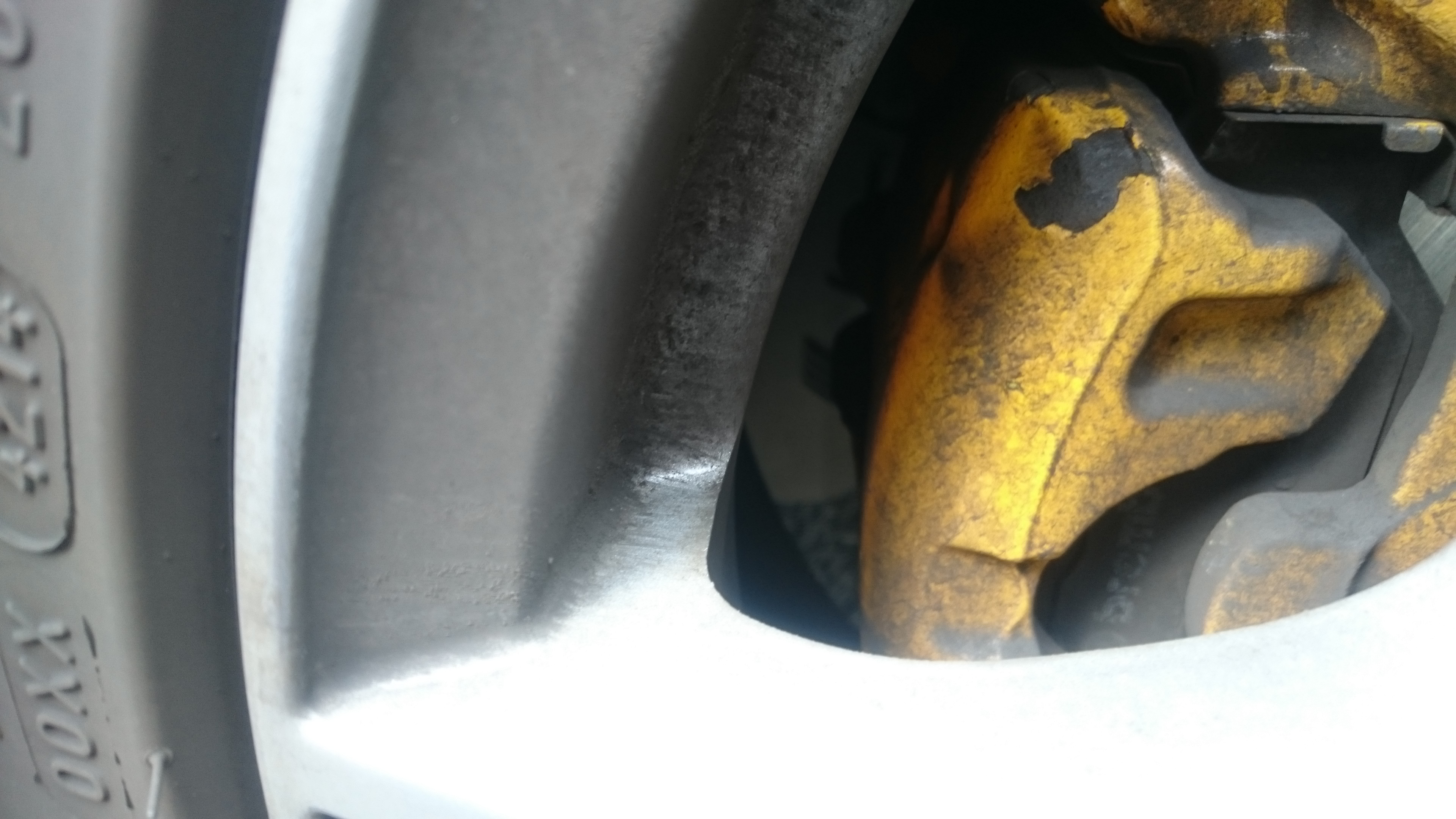

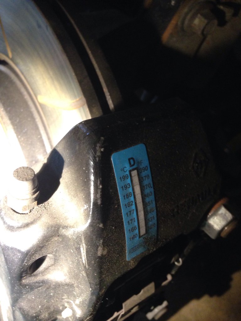

There is no way 300mm discs will work with 15"wheels and Brembos without some machining. Even on my 16" turinis with spacers there is 2mm gap between the caliper and inside of the alloy. I had to get the wheel weights moved as you can see the fouling.

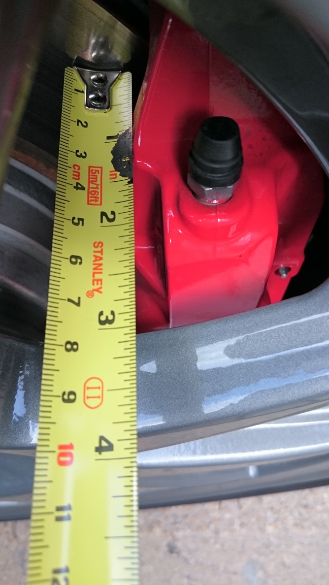

@Panda - if they are 16" wheels then it looks good for you ! As in Cubs pics 60-61mm is correct:
Its really is tight with my 16" et45 turinis + 15mm spacers - look at the black mounting bolt ! not much space at all.

Judgeing by your pictures i too will need to get the wheel weights moved, i am a bit concerned about the bolts but if they sit 15mm or more from the front of the caliper (which im sure they do) i should be ok as the wheels i have get wider after that point.

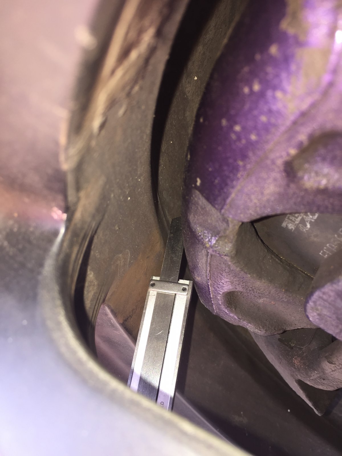

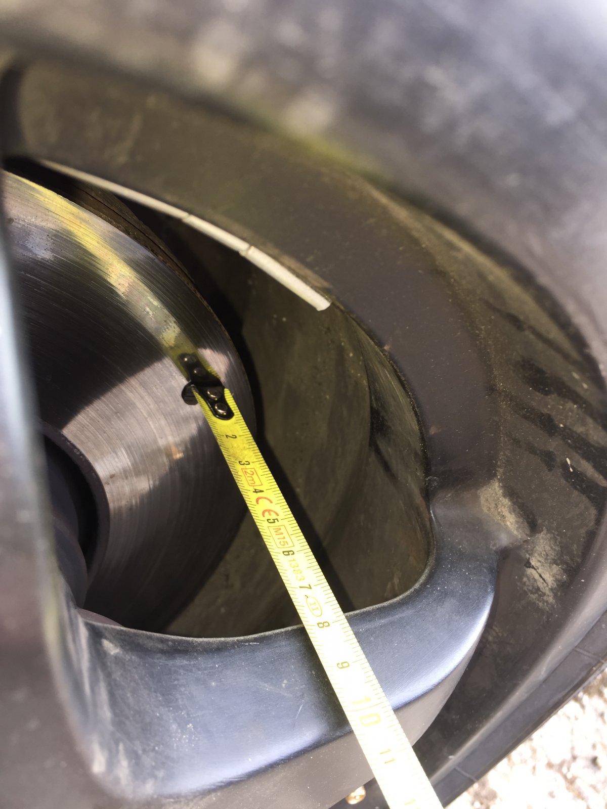

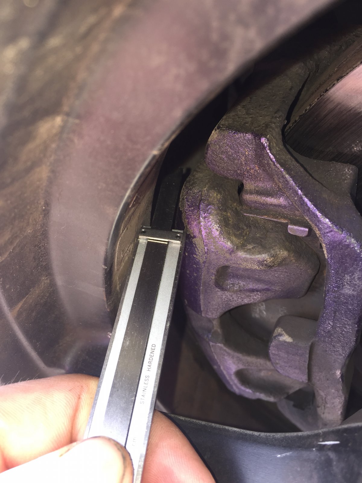

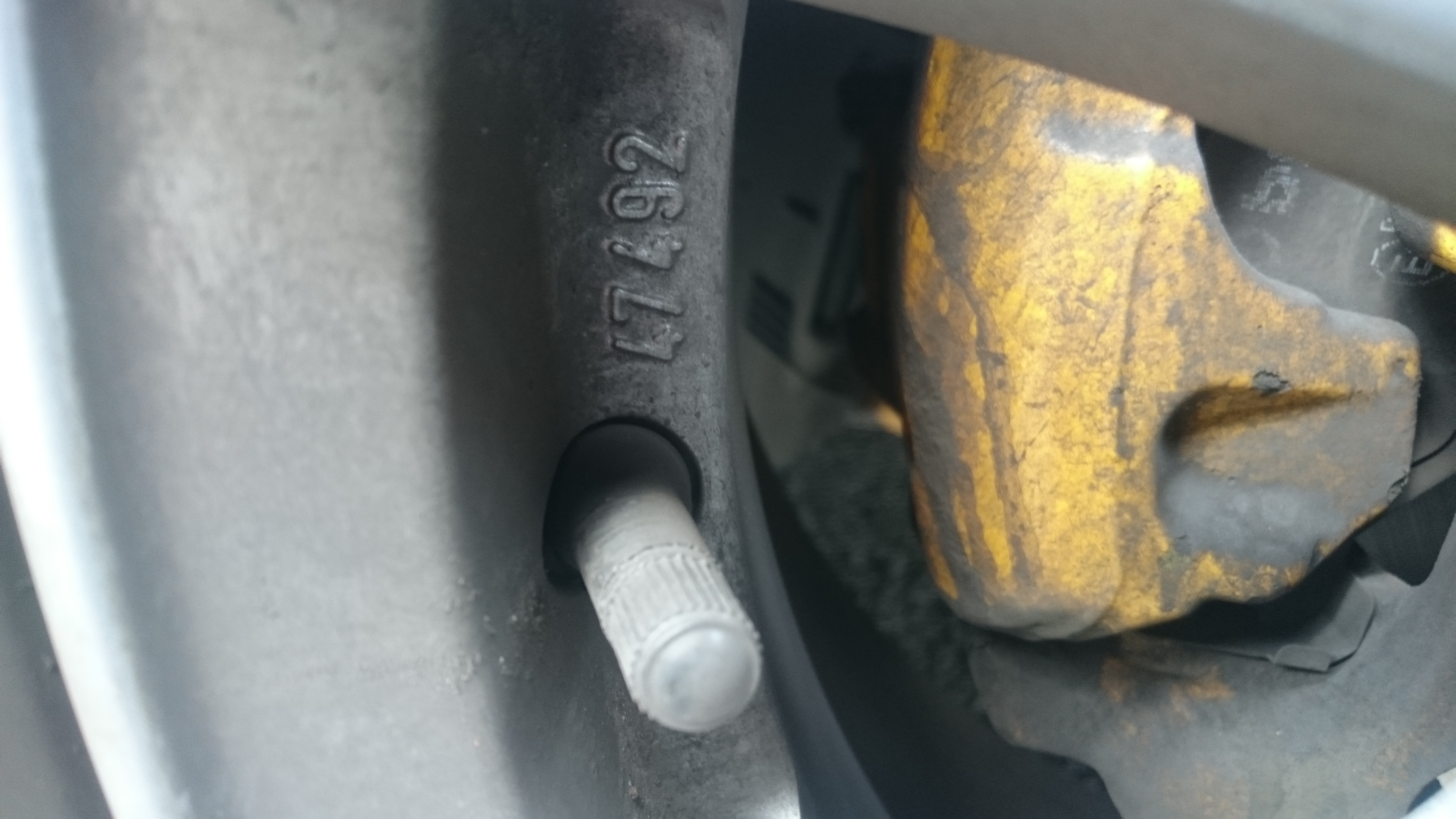

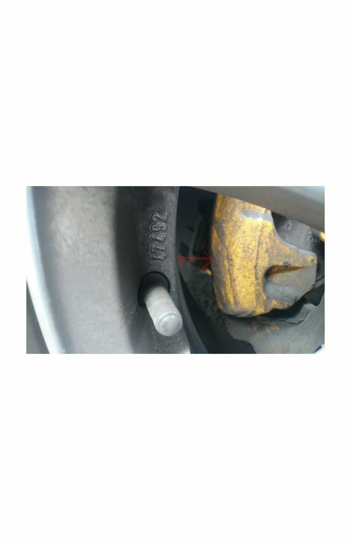

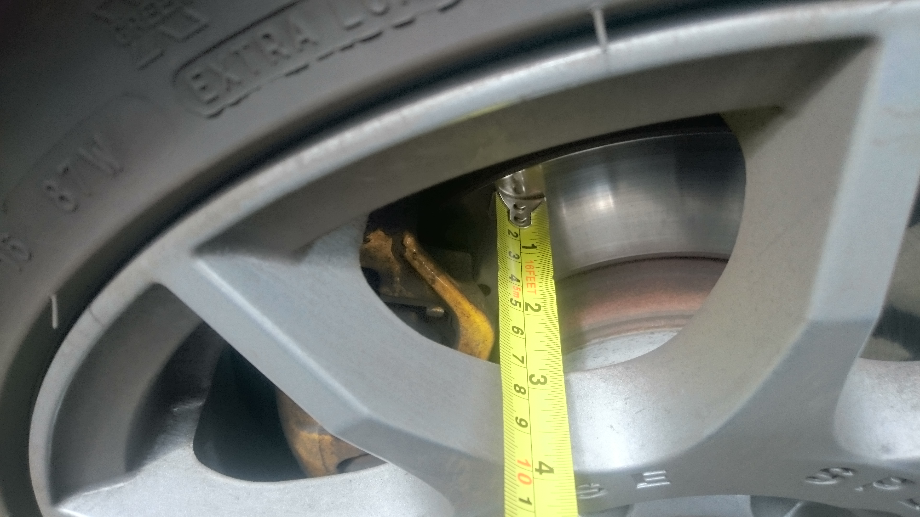

Can some one with 16" turinis and standard calipers measure the gap between back of caliper and inside of wheel just so i can comfirm its the same size gap as mine. Pic of what needs measuring.
Thanks

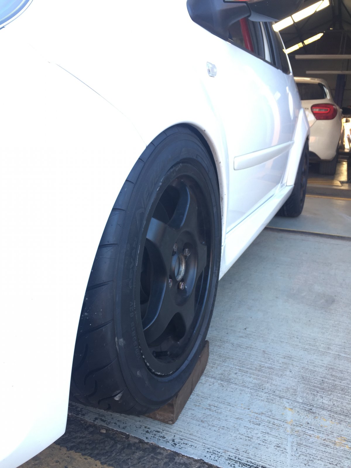

Just give the little bit of info I can share about my conversion. I have cup turini's, 197 callipers with 300mm discs and the pure mounting brackets. Fit is extremely tight, but without the need for spacers! Similar to above however, the wheel weights had to be removed from the outer edge for clearance.
I have since had the weights moved to the centre of the wheel (garage didn't put that many on though) and it seems to have worked a treat i.e. No vibrations through wheel at speed.

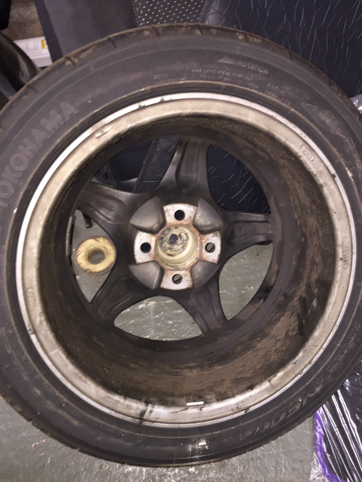

Basically they're 15", and whilst the spokes have plenty of clearance they've got a lip running inside the wheel, which isn't giving me much clearance, since I'm already on 16mm Spacers.
See the photos above, but I think it could be doubtful if you look as close as the standard calipers are! Unless the Brembo's just come out farther/deeper and not so much towards the inside of the wheel rather than towards the spokes?
Do I stand a chance of fitting Brembo's behind them, without having to run stupidly big Spacers?
