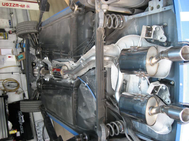

This is a picture of my girlfriends as she bought it last week with a Milltek system, it's no longer on the car as she didn't want a "noisy" exhaust so we have now put on a "quiet" Longlife system on instead.
Her Milltek is up for sale if your looking for one mate???
Have just taken some pics of it and was going to be putting it on Ebay later on tonight.
