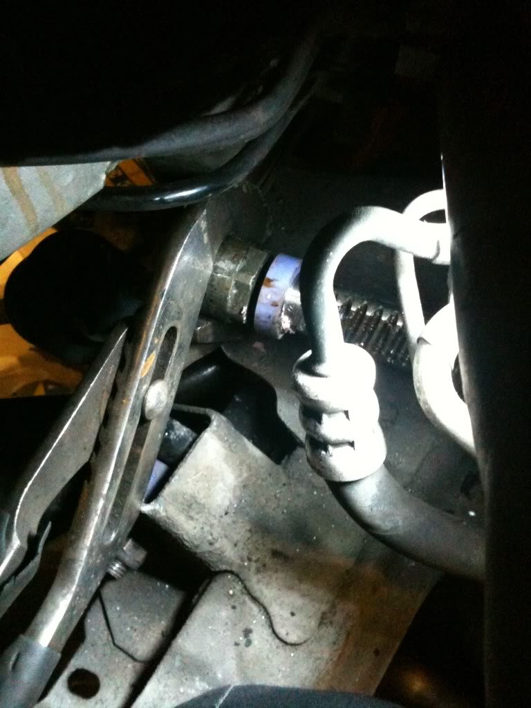

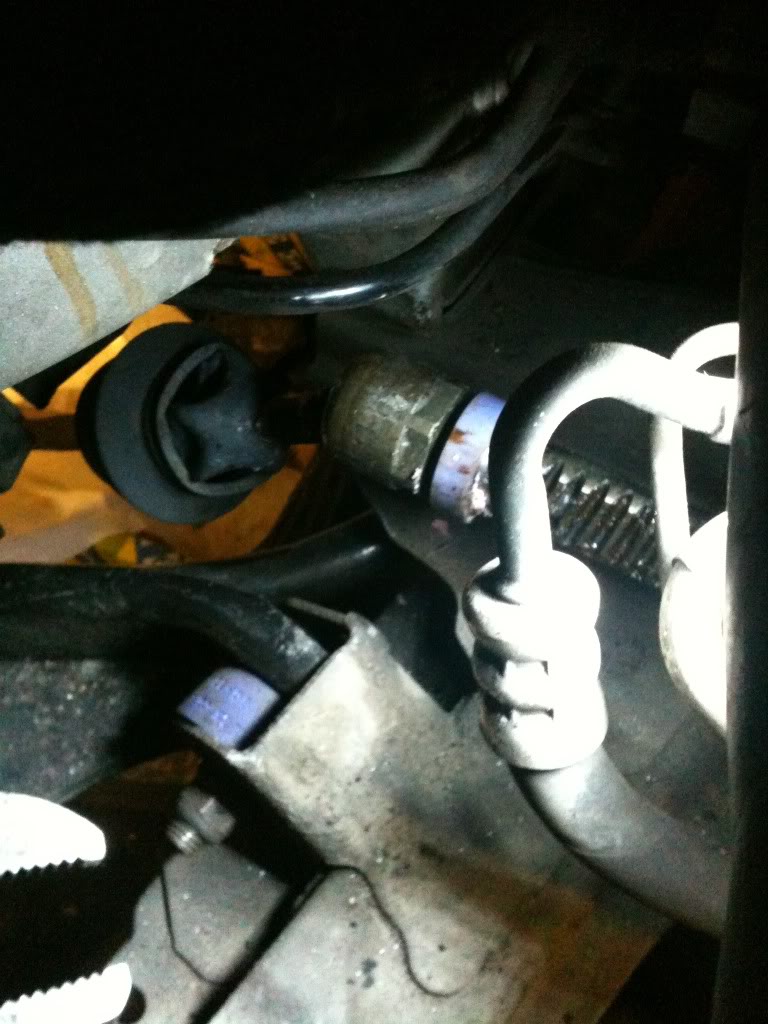

Here you go , i did mine myself relatively easy as i had my engine out
I purchaced genuine renault parts as im in the trade
You know it took renault 4 attemps to get me the
right parts, it was either the length was to long or the thread size was wrong
got their in the end , steering feels spot on now.

EDIT: cheers for the pics and info Barnesautos, Thats another thing im worried about, getting the inner rod out and finding its the wrong one! not as easy as other jobs im used to, Ill probably revert to a garage to do the work.
