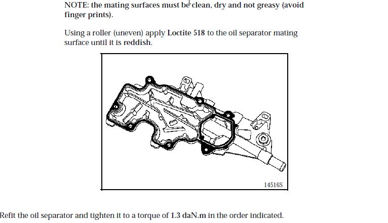

I tried dealing with Renault parts australia but they are under the impression there is no gasket required under the breather plate. They suggest Gasket Goo. A fellow member of the AU forums posted this part number:[FONT='Lucida Grande', 'Trebuchet MS', Verdana, Helvetica, Arial, sans-serif] #8200 106 895. After calling renault they have no idea what the part number is besides saying its a gasket and its $175AU
[/FONT]
Can you guys check if this is the correct part number and let me know how much is costs buying it locally.

Re: 172 oil leak from rocket cover plenum area noticeable worse during hard track dri
from the factory there is a gasket. It costs over £70 for a new one on its own, and they usually leak. Use silicon sealer.

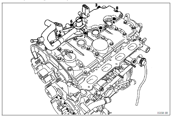

throw the gasket away, just use sealer
There was no gasket on mine from the factory - or on the 182 I was working on
Both just had some instant gasket applied to them
  03 clio sport asc
WOW - What a drama, after taking the intake manifold off i was greeted with a sorry sight! - 7 out of 8 bolts that hold the breather plate down were sheered off! only 1 remained - No wonder it started leaking a lot worse.
Scariest part I found a couple of the bolt heads resting where the intake meets the head.
Now this defiantly wasnt like this last time I checked under there a couple of months ago and I have never touched any of those bolts.
I think this all happened on the last track day at Sandown - Jumping off Apex's and getting major wheel spin.
Ezy out worked well and I replaced all the bolts so no harm done but wow the word Cheese comes to mind!
