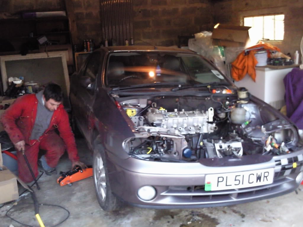

So we set off from my house and arrived early morning to my mates farm place ready for him and another mate to take the engine out...car reversed into the garage and the work began
So finally got the engine out. Struggled with the drive shafts as they were buggers and the down pipe was a b**ch but after abit of play she came out sweet as a nut.

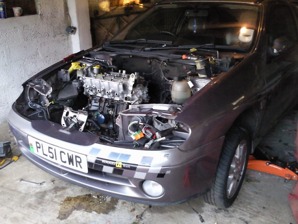

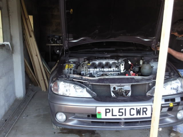

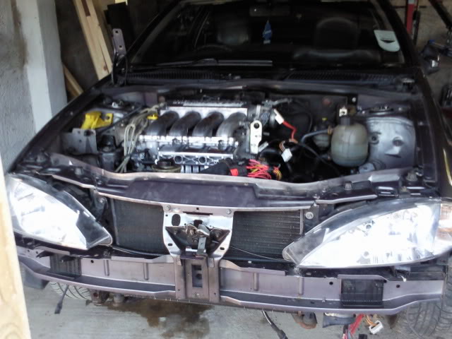

Picture of the bay as it stands

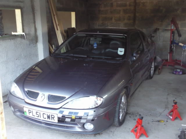

And the car now wrapped up and waiting for the new engine to arrive

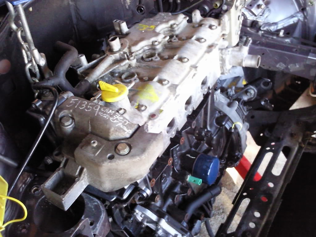

Right so only a slight update. Parts have started arrving. First was the engine block. 172 Phase one on 32k. I only got the block which was a little disapointing and has set thing back abit but thats what i got and have to live with it.
So there it is, engine block including clutch and flywheel. Cleaning her up first to get all the crap off. Considering painting the block to help spot oit leaks but not too sure yet.

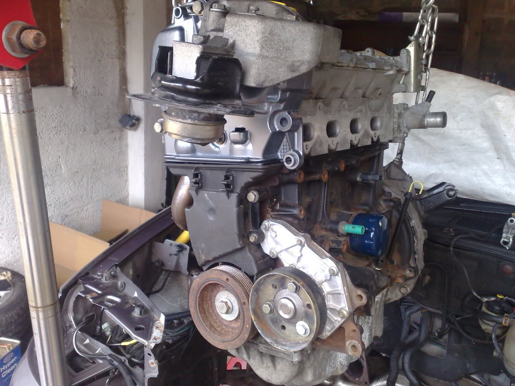

Got rather alot done so i will try and remember to put it all in. We started by putting a few more bits on the engine. Water pump is now on and the cam cover too. We also fitted the mounts into the relavant places.

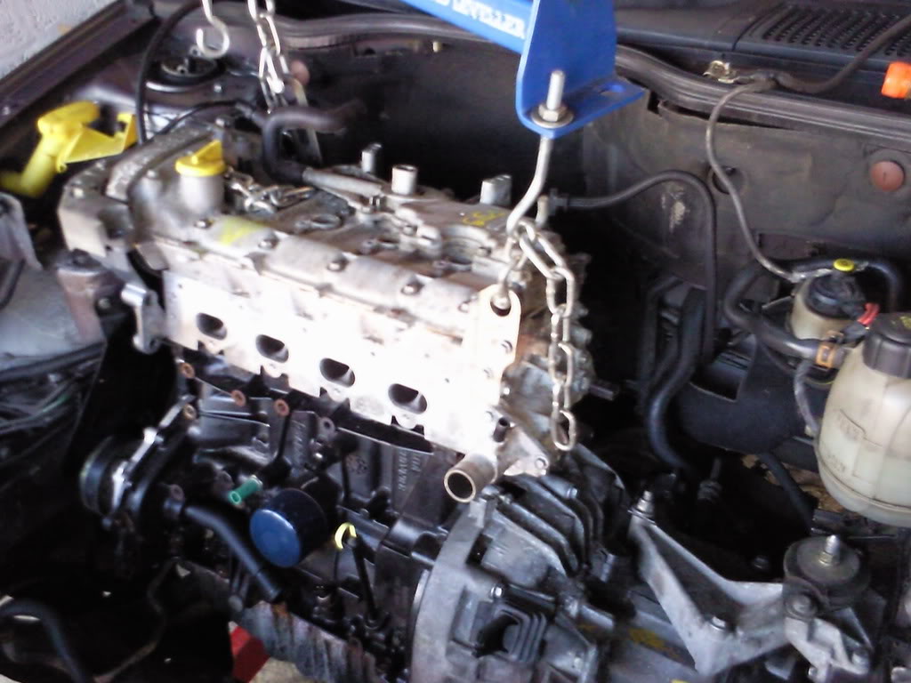

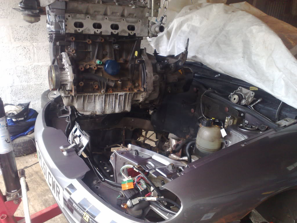

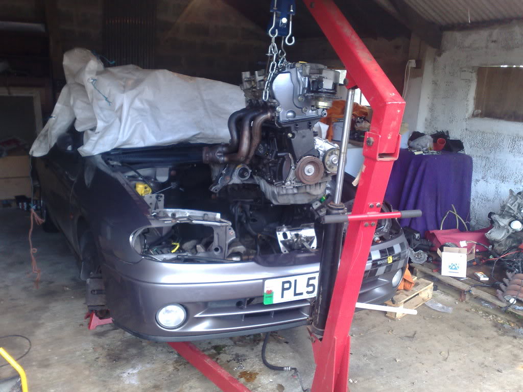

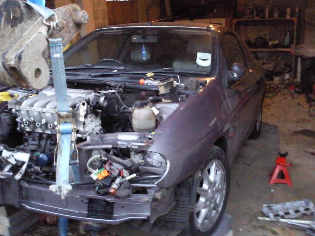

So up on the crane she went and ready to drop into place.

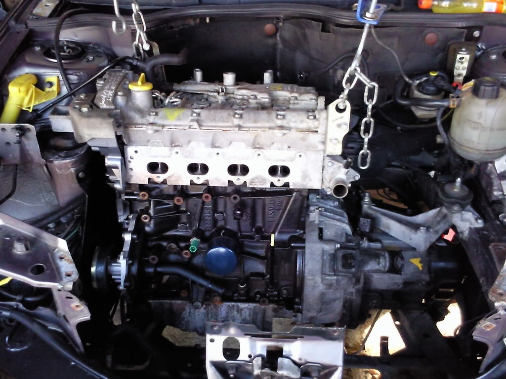

We were worried at fiirst as wether or not the engine would fall into the bay nicley and sit on the mounts. But in she was lowerd to see.
Once the mounts were lined up the block was then bolted in and fits just snug.
Just a trial fit of the top inlet, this is without the lower inlet on.

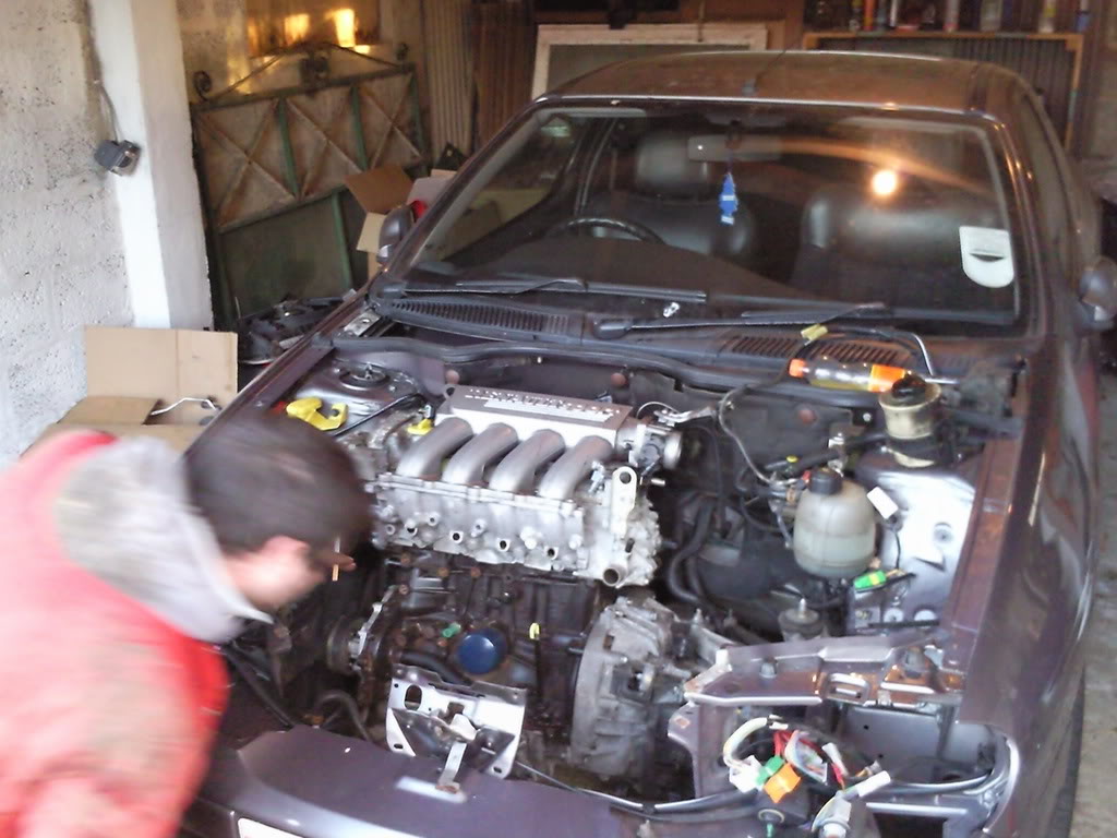

The next thing was to reconnect the gear linkage and put the shafts into the box.
After the car being on axle stands for 6 week it was time to stick the wheels back on and take her off.
Also fitted the lower part of the manifold and gasket.
And now the upper part with TB

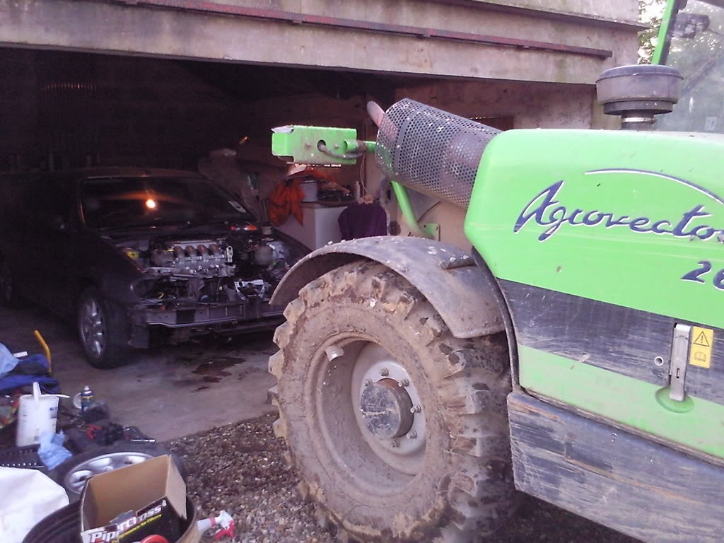

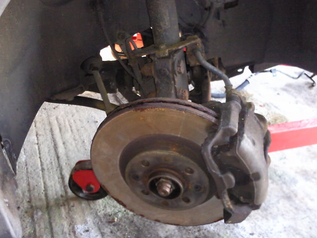

We had to use a digger to tow the car to unseize the callipars from the disks and also lift up the front so leigh could cut my cat off too.

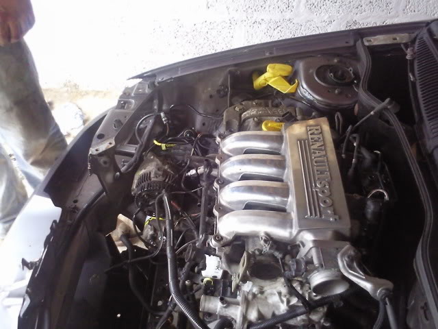

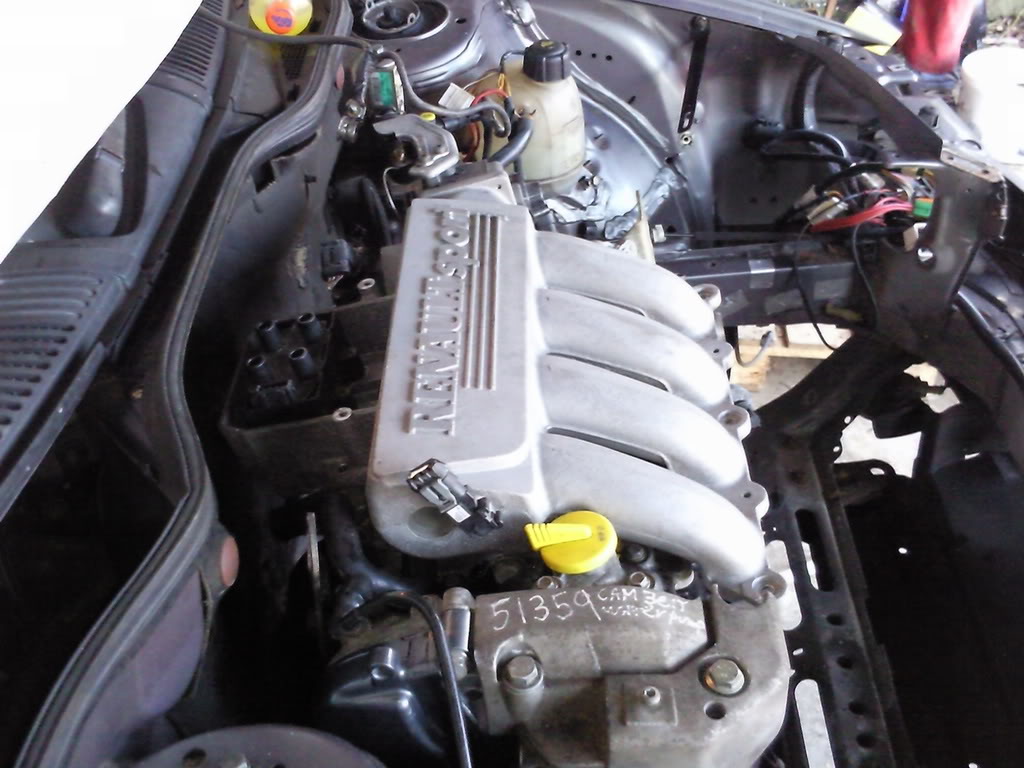

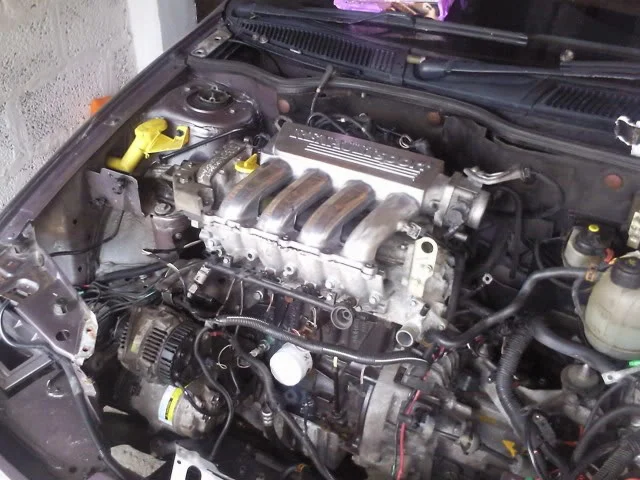

And finally the best engine shot i have so far
Now all thats left is the wiring, cooling system and sort the exhaust out.

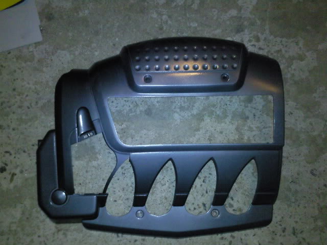

Not a huge update but ive been working on my engine cover the last two weeks so hear is the almost finished look.
And here is the oil cap cover. This is needs to be laquerd still but currently waiting to hear back from Savage on some stencils that will go on there

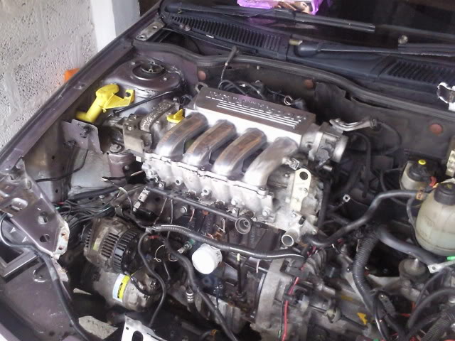

Fit the inlet manifold and HT leads
We also managed to fit the alternator bracket, power steering bracket, the aircon pump, alternator and power steering. We are just missing a few bits and pieces to get the whole Aux belt working. And we also fitted loom and conected the throttle cable so things are really starting to take shape now.

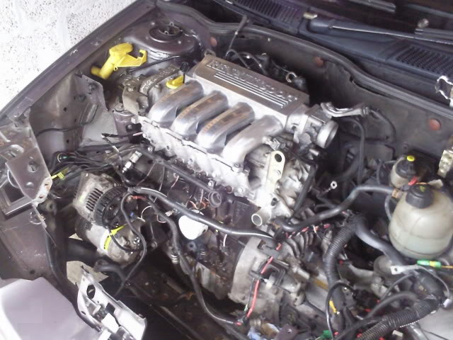

But heres a sneek peek ;)
The inlet isnt finished yet but can be finished up on the car.

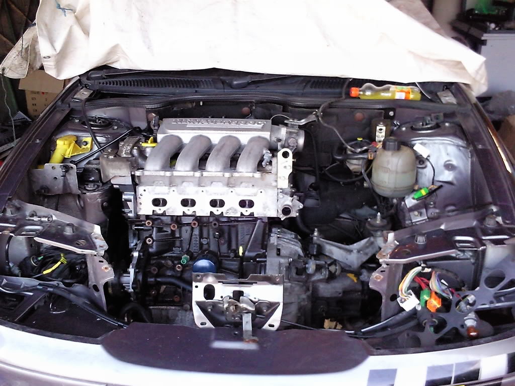

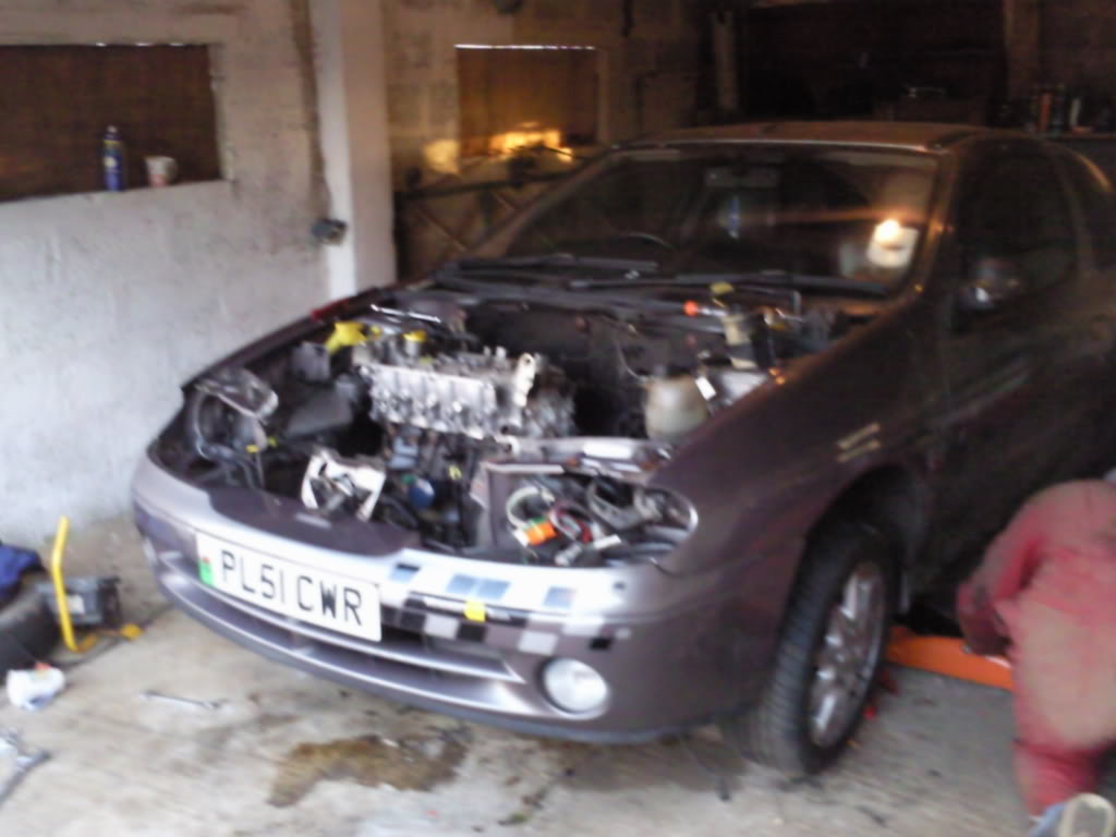

So today was work on car day again. The car now looks like a car once again. Got a fair bit done. We managed to fit the radiator, slam pannel, coolant hoses and also took the scuttle panel off to look at some wiring. We also fitted the head lights back in and bumper on. The bonnet is also back on and lined up.
We also fitted new injectors and the fuel rail guard that is half polished.
Still waiting on my coilovers and decat. Also trying to purchase the top bracket for the alternator.
Hopfully this week decat will arrive along with coilies. Also wanting the alloys refurbed and the wiring will be looked at.
