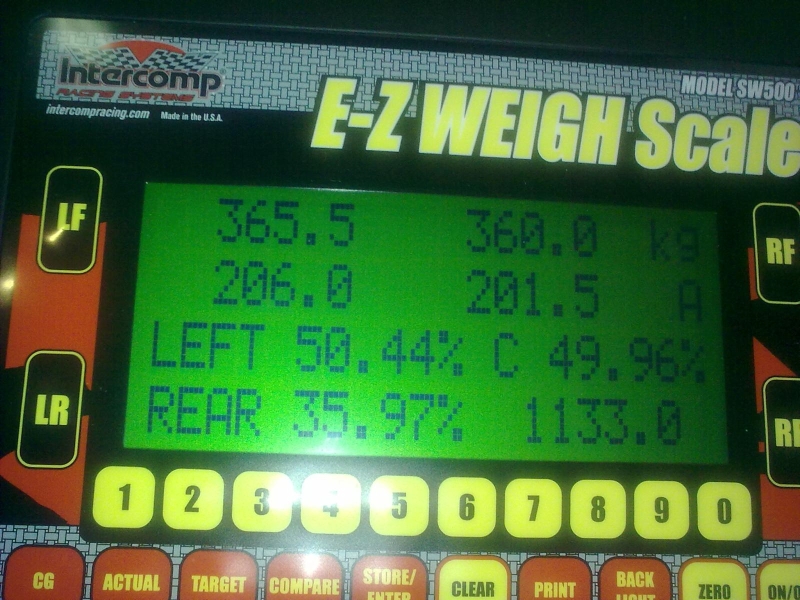

These were mine - ph1 on KW V2, but left hand drive with me (65kg) inside the car

LHD is much easier to corner weight.
set the ride height with a little nose down rake, (dont judge this by looking at the arch gaps) then corner weigh from there. Record how much fuel you have and make sure you are in it or have your equivalent weight in the driving seat. The above is very good but will be hard ro acieve due to the fact yours is RHD
