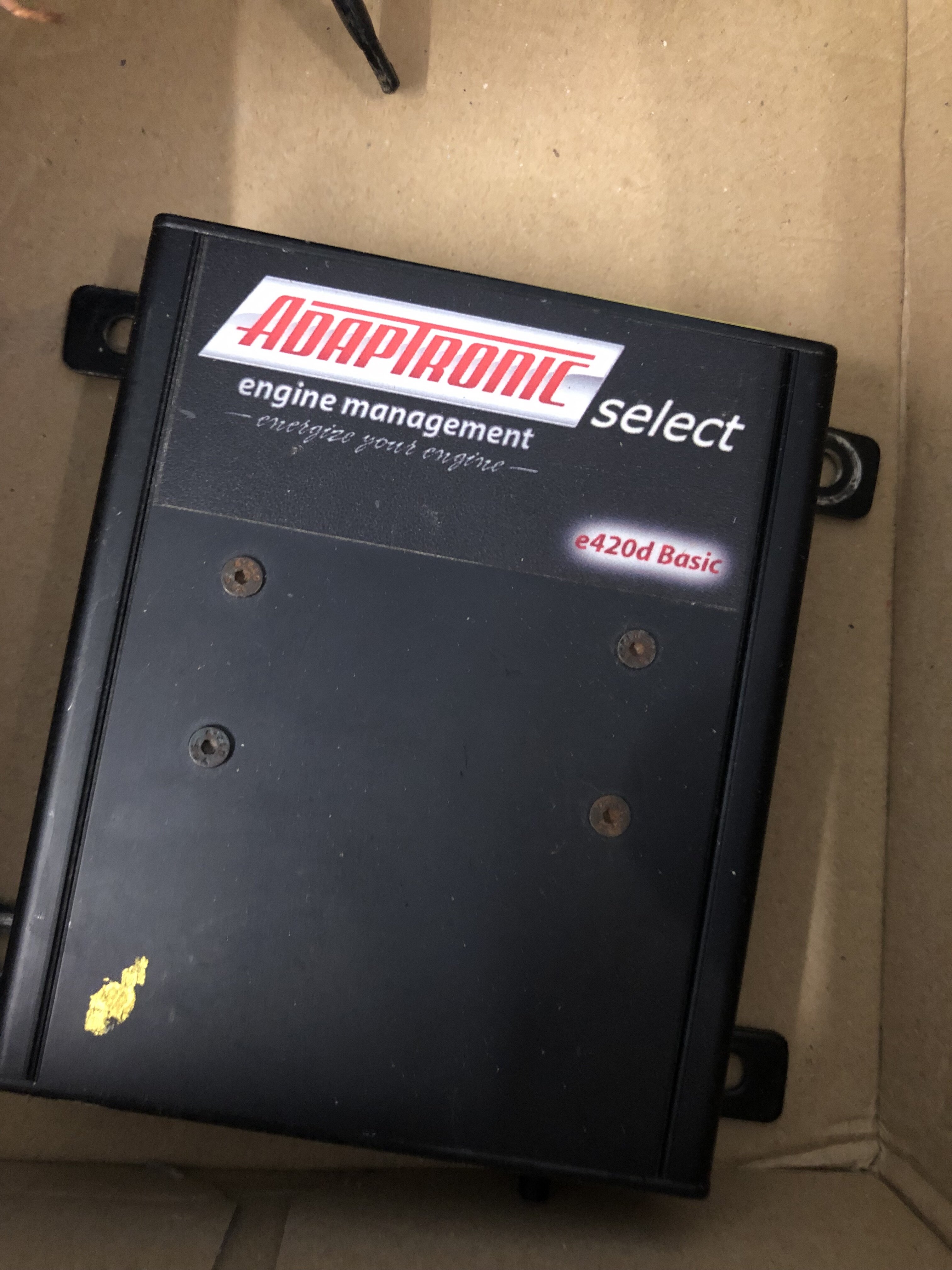

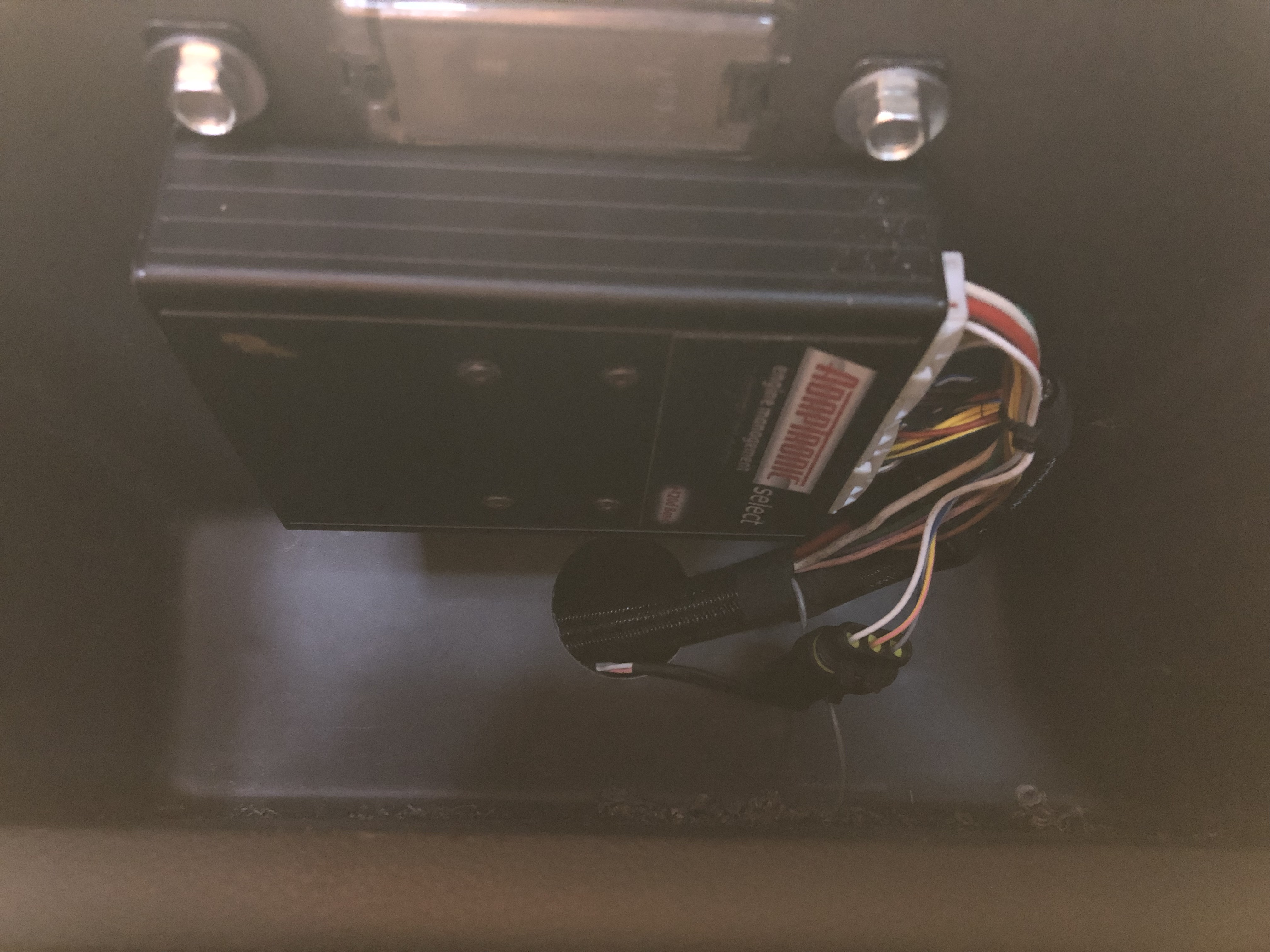

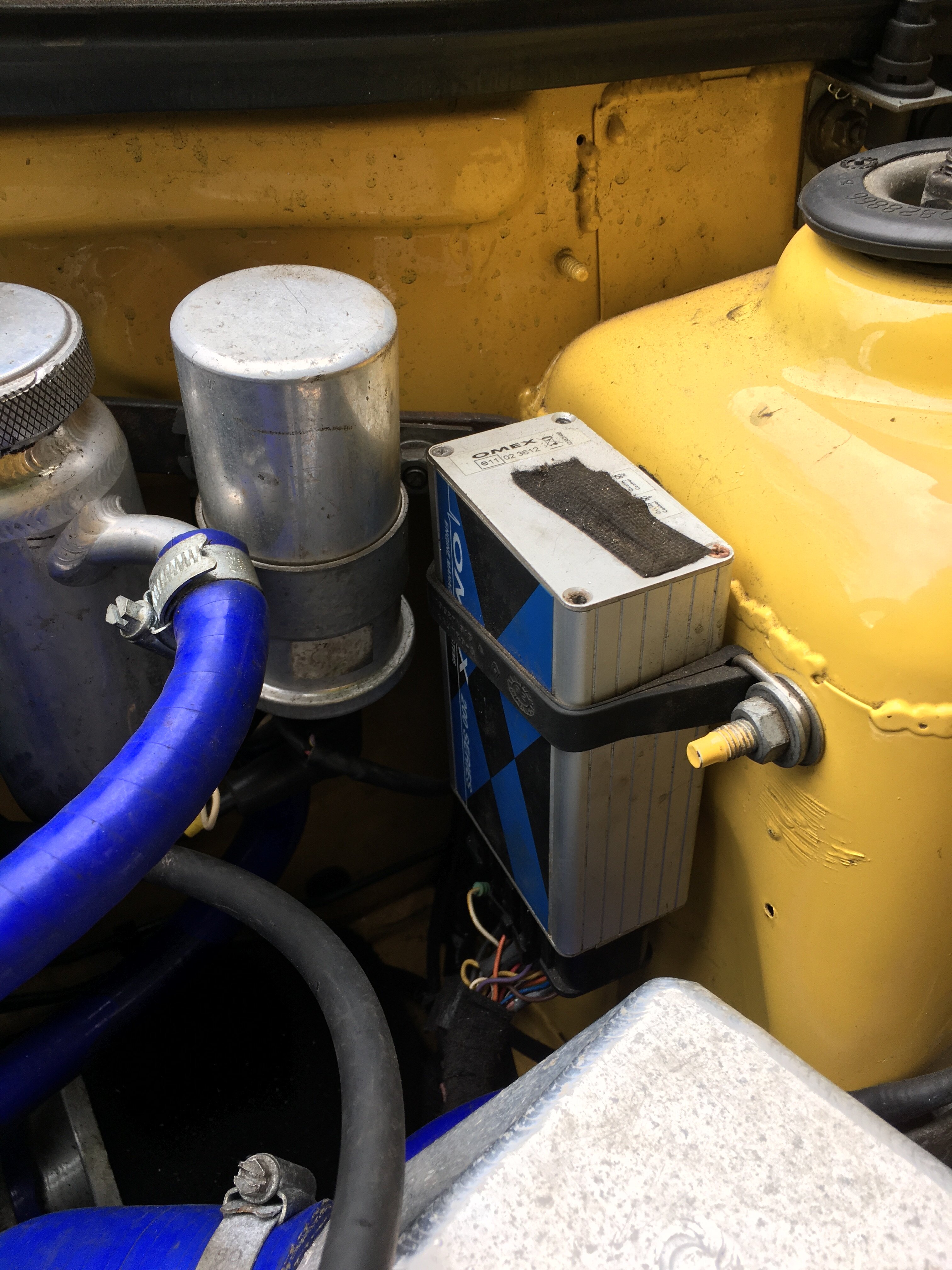

Adey. ClioSport Club Member Clio 200t EDC Mar 24, 2024 #122 What made you switch from omex to adaptronic?
W Williamspaul 197 clio 16v Mar 24, 2024 #123 The adaptronic has a lot more capabilities than the omex

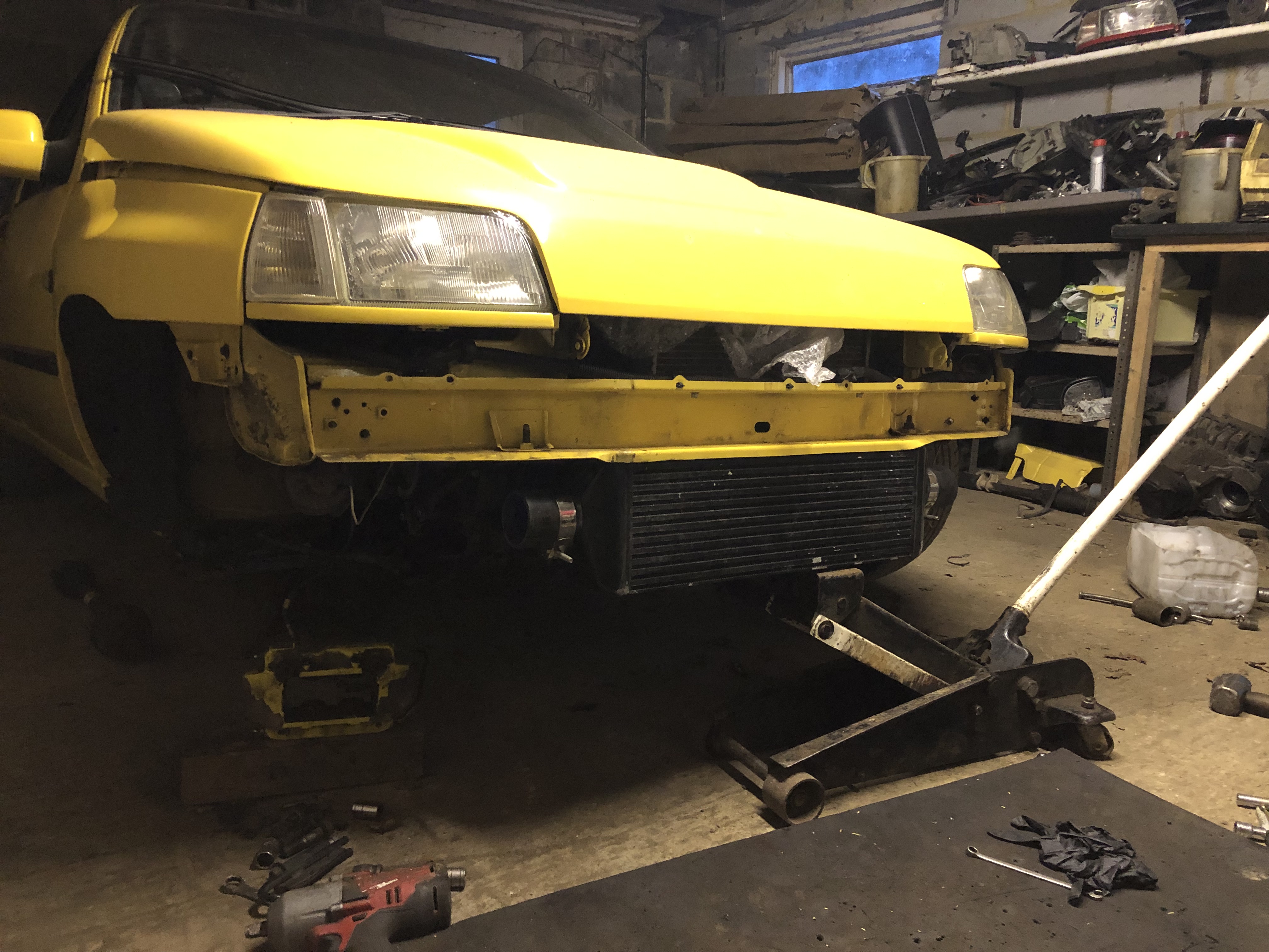

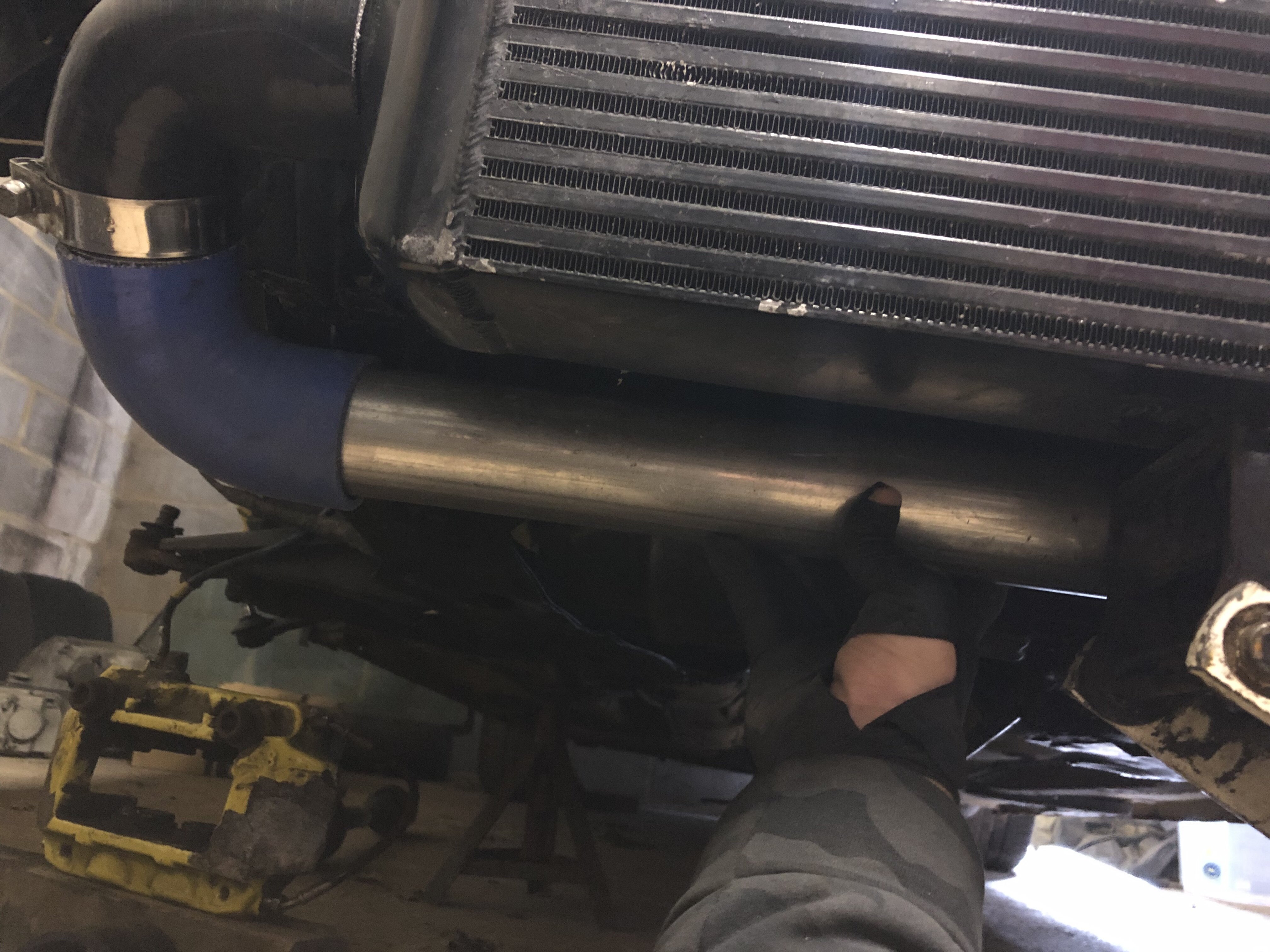

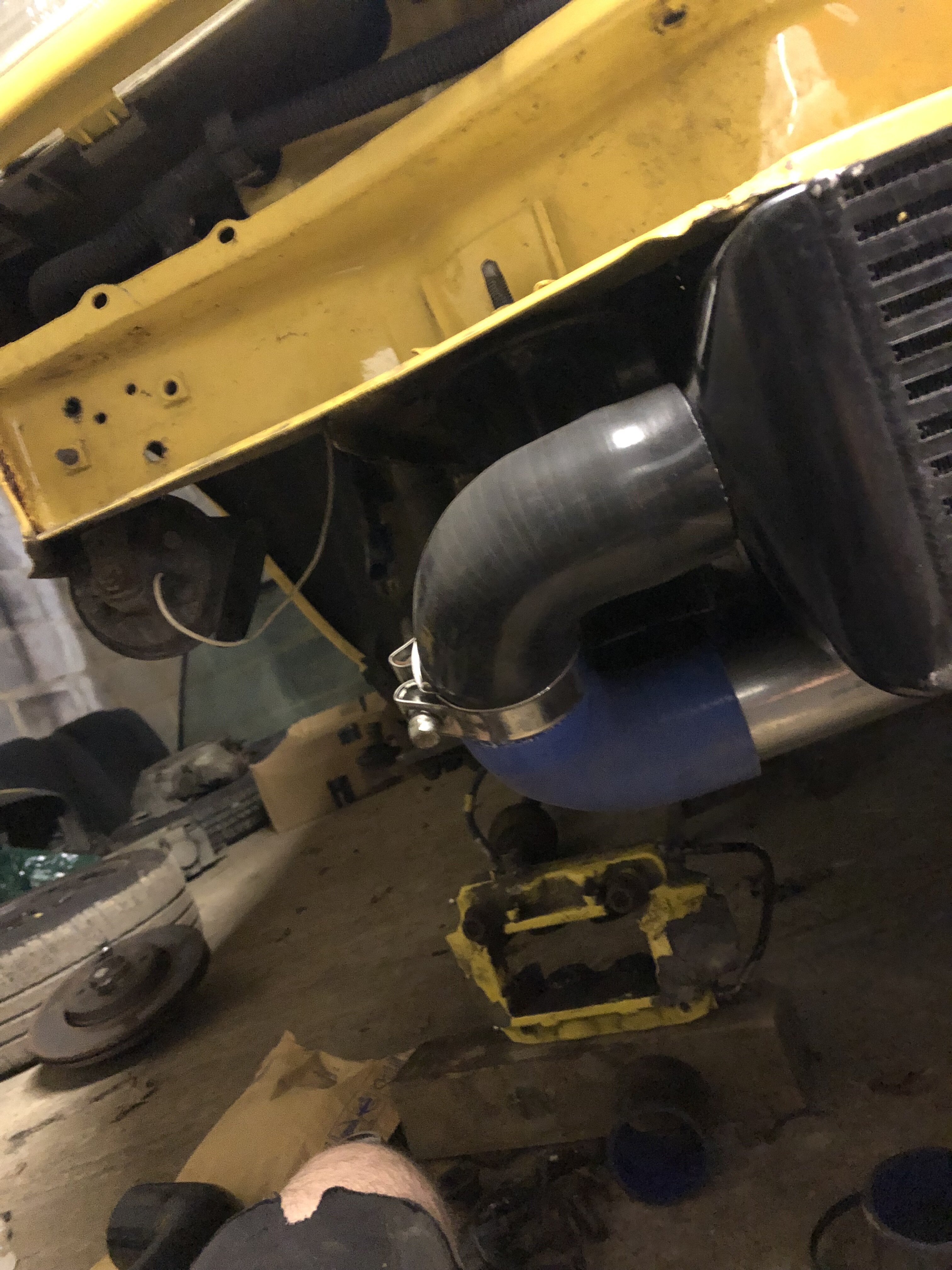

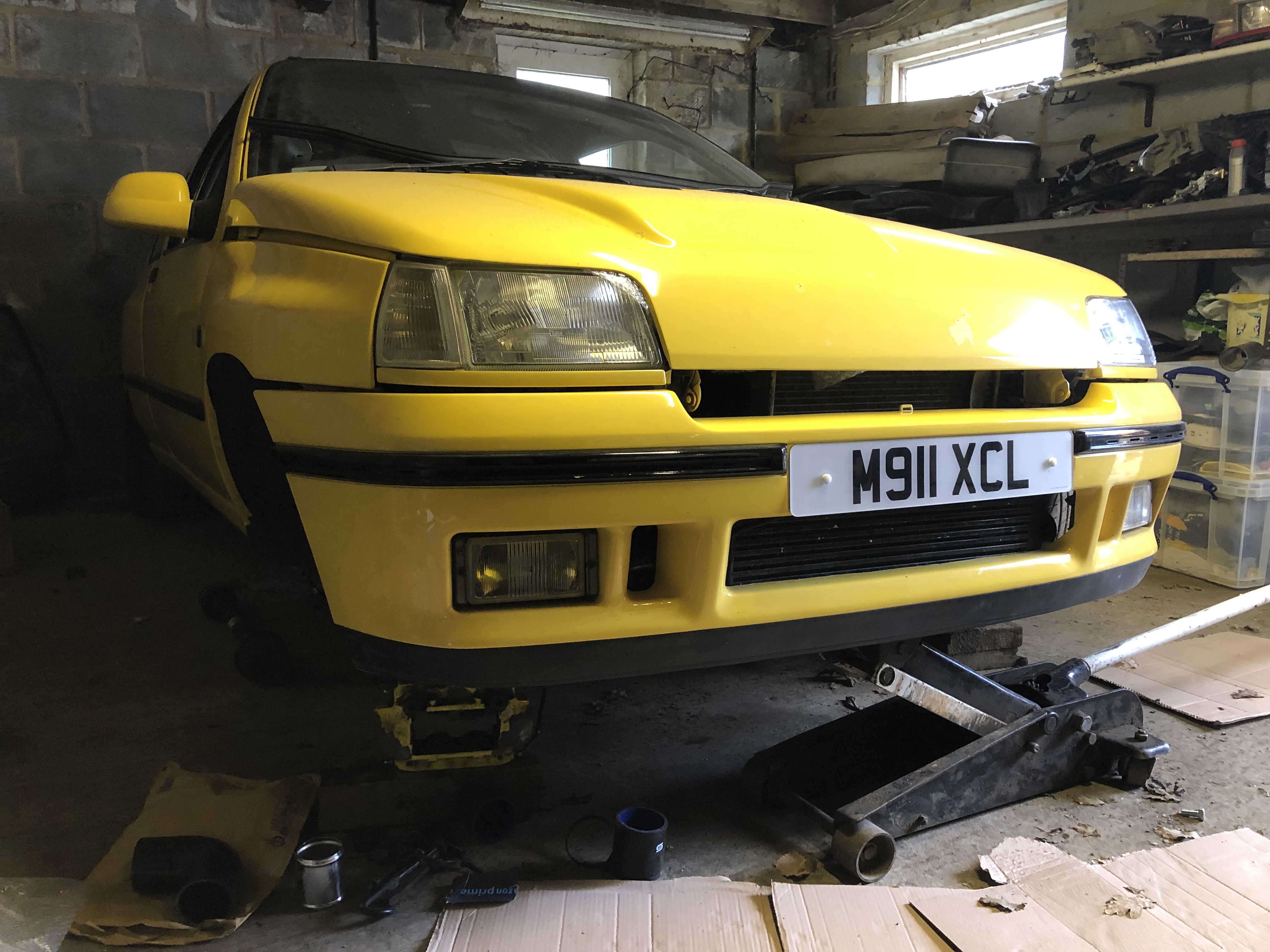

W Williamspaul 197 clio 16v Mar 27, 2024 #124 Charge cooler is gone I’m fitting a mishimoto j line Intercooler instead

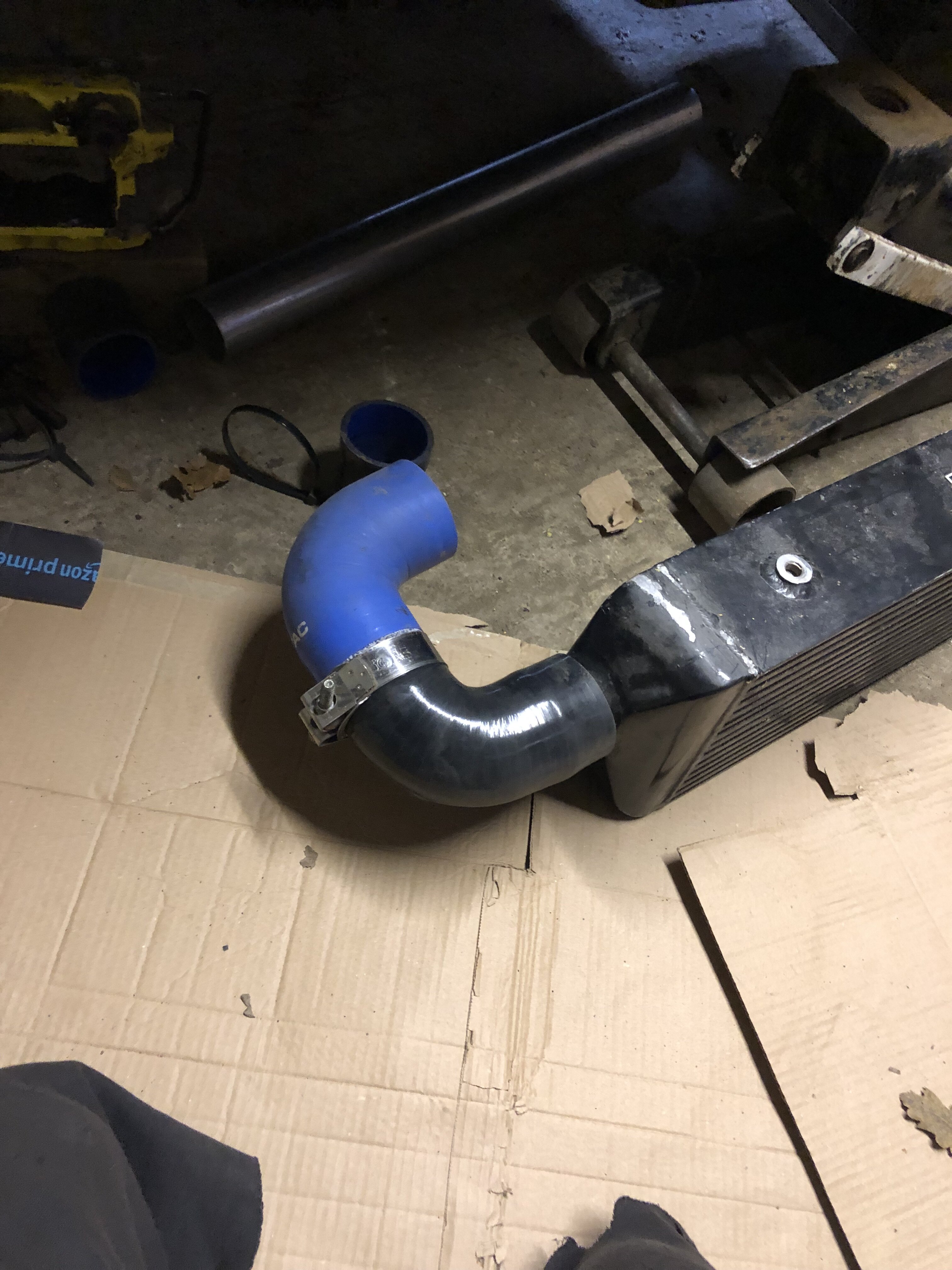

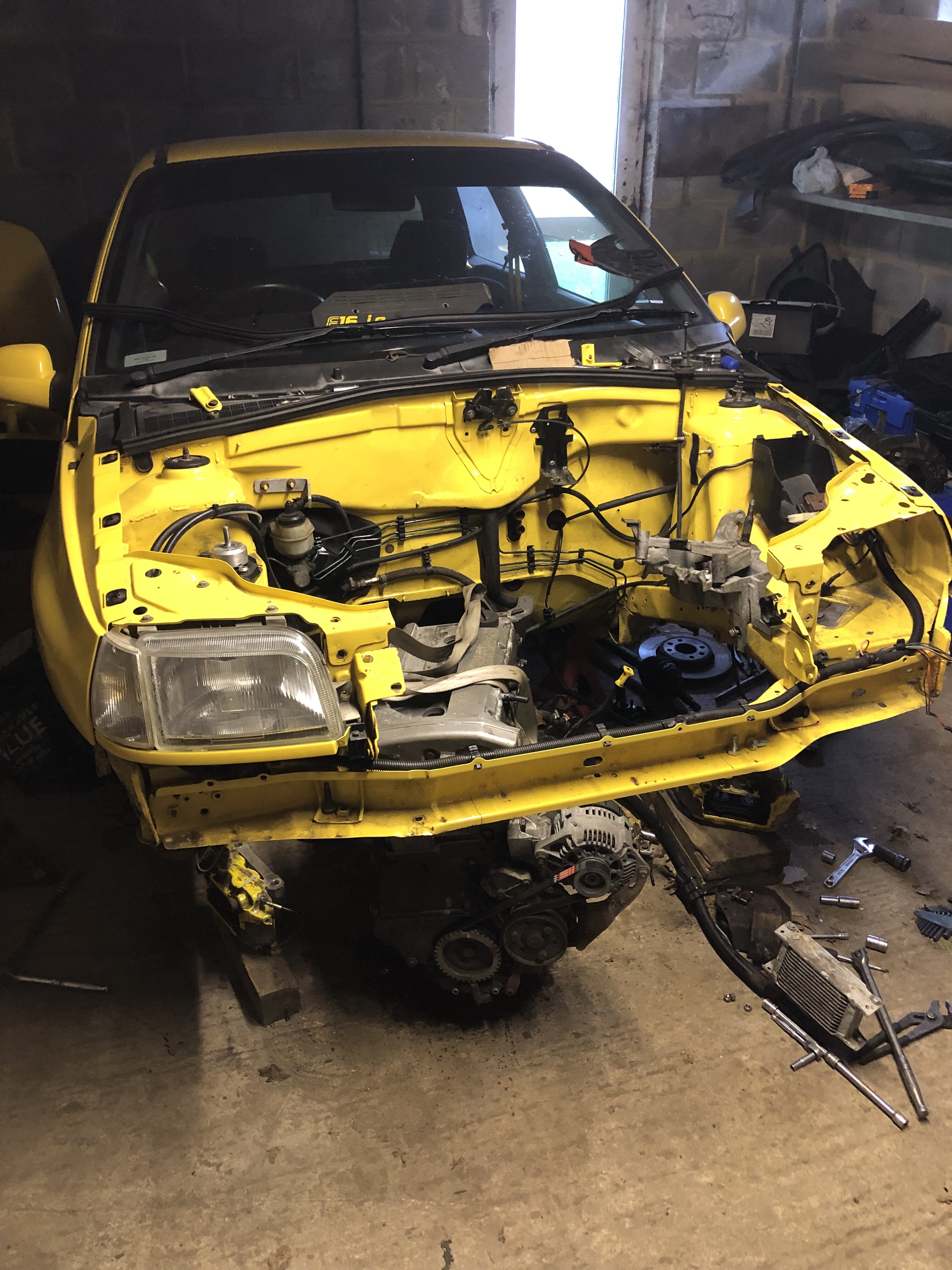

W Williamspaul 197 clio 16v Apr 10, 2024 #126 I’ve been busy making room for the chubby intercooler ✂️

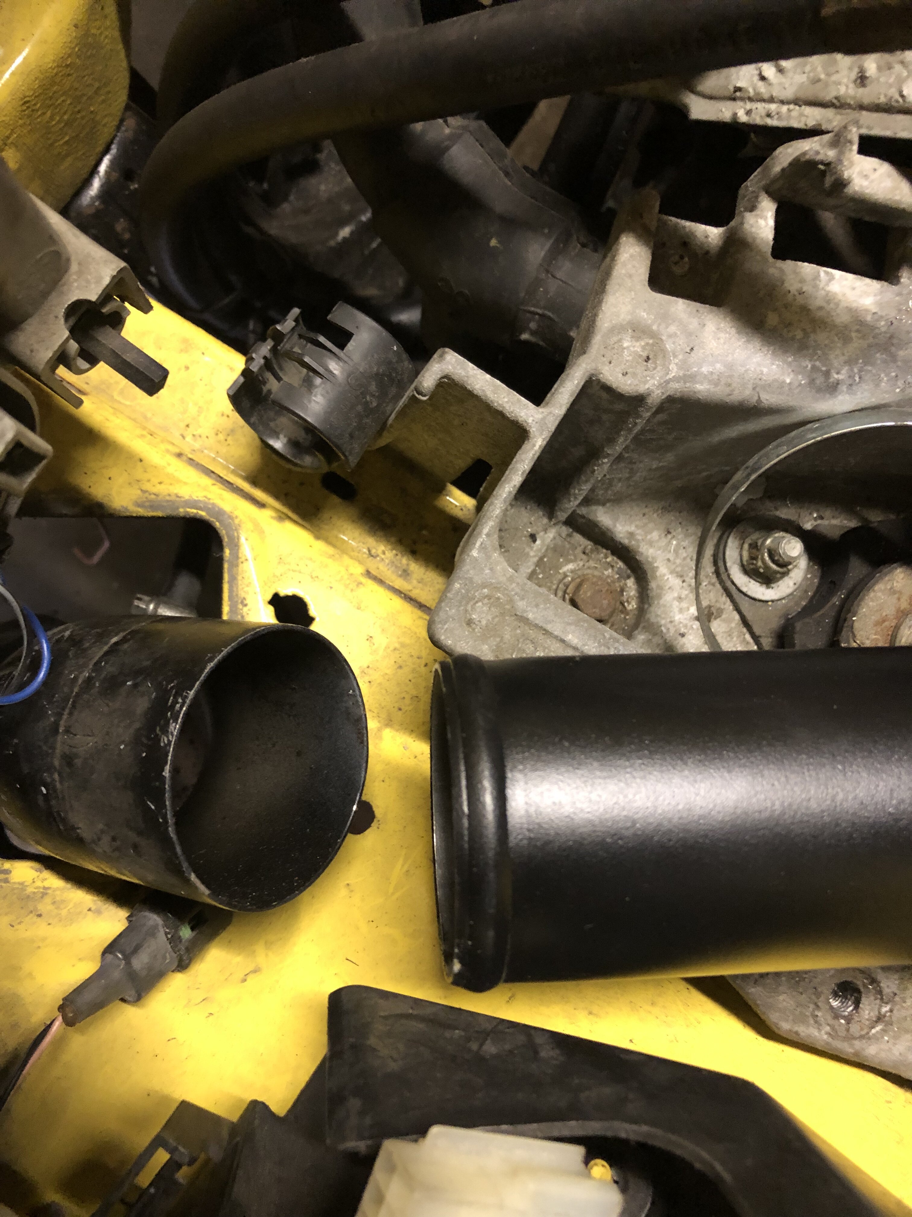

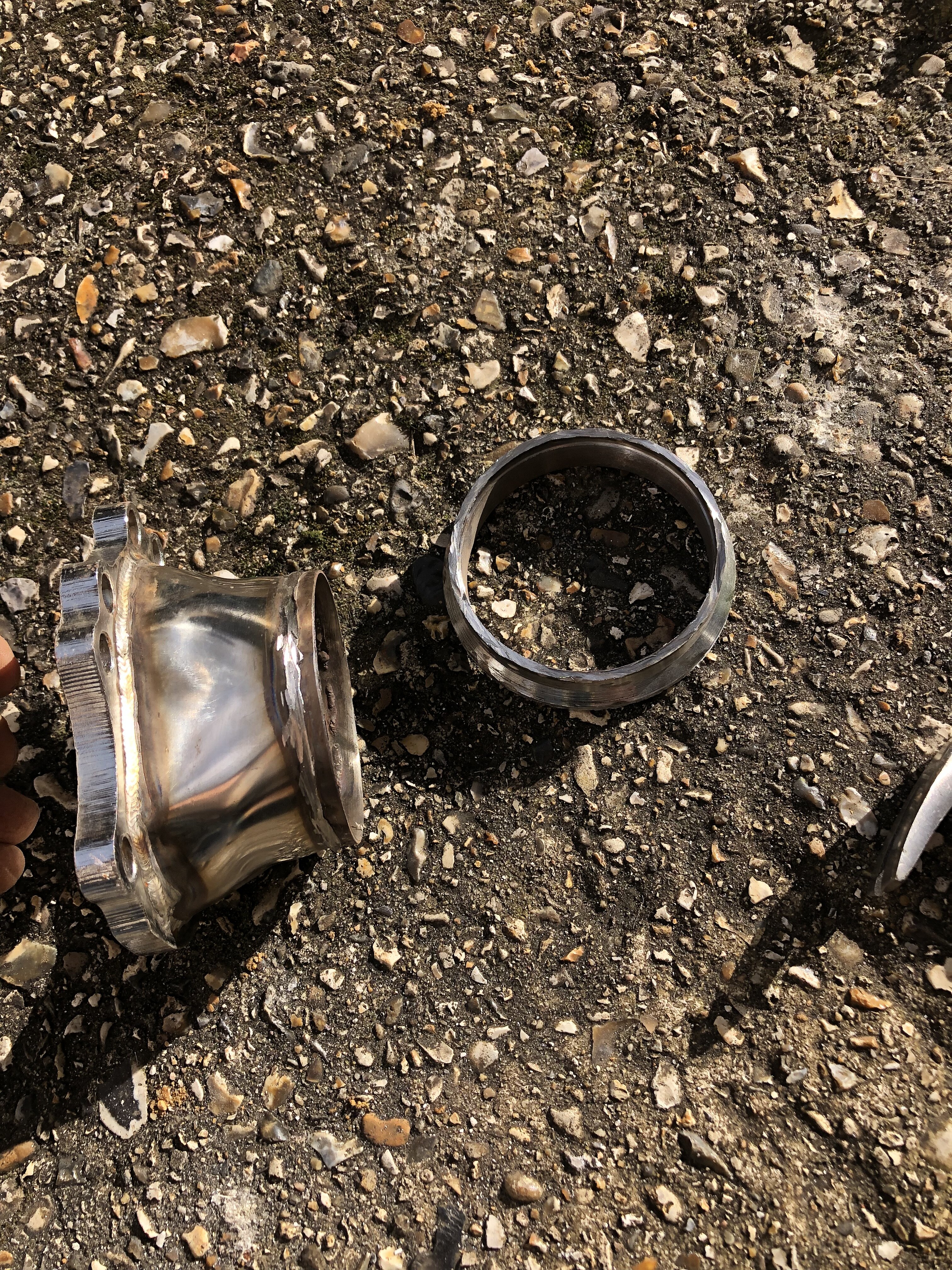

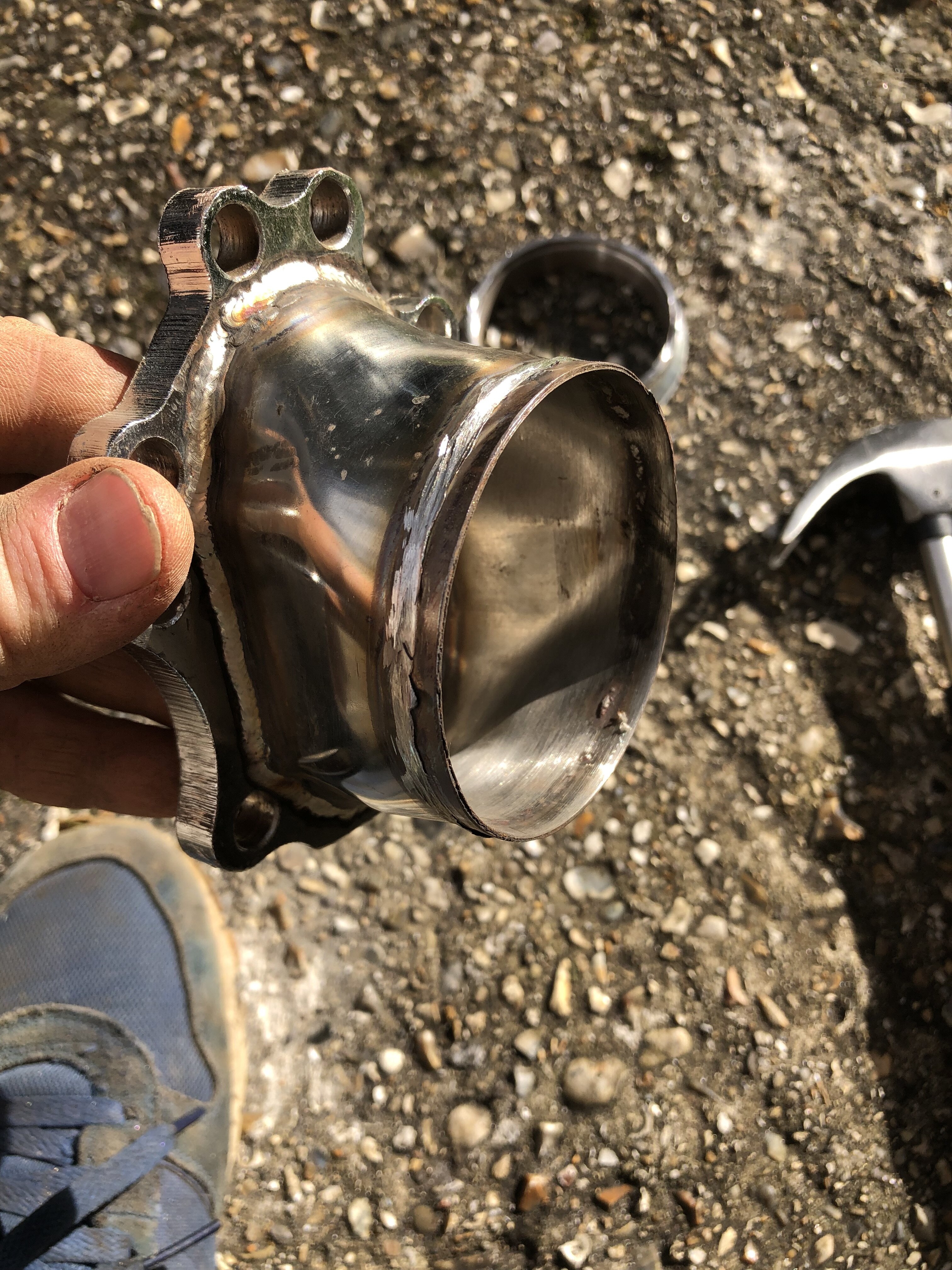

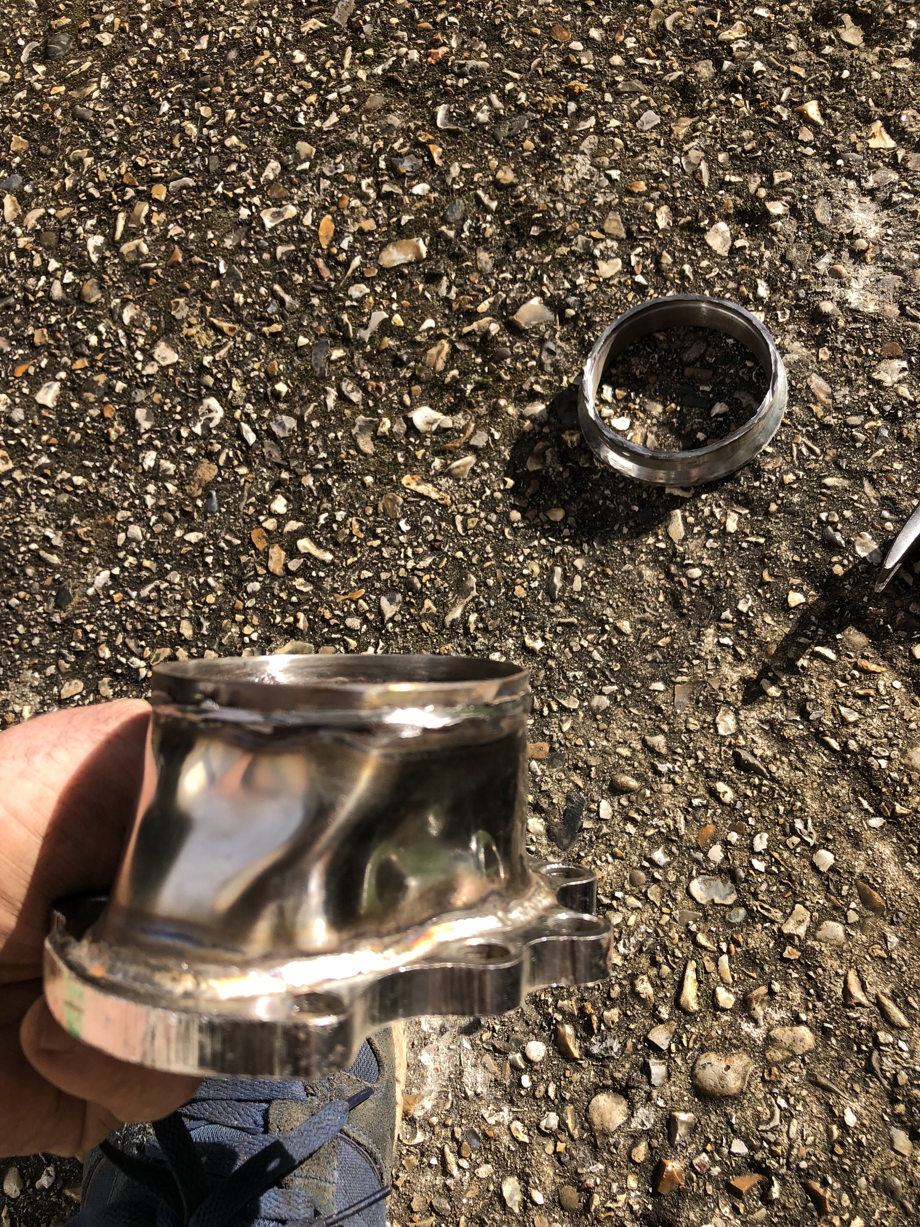

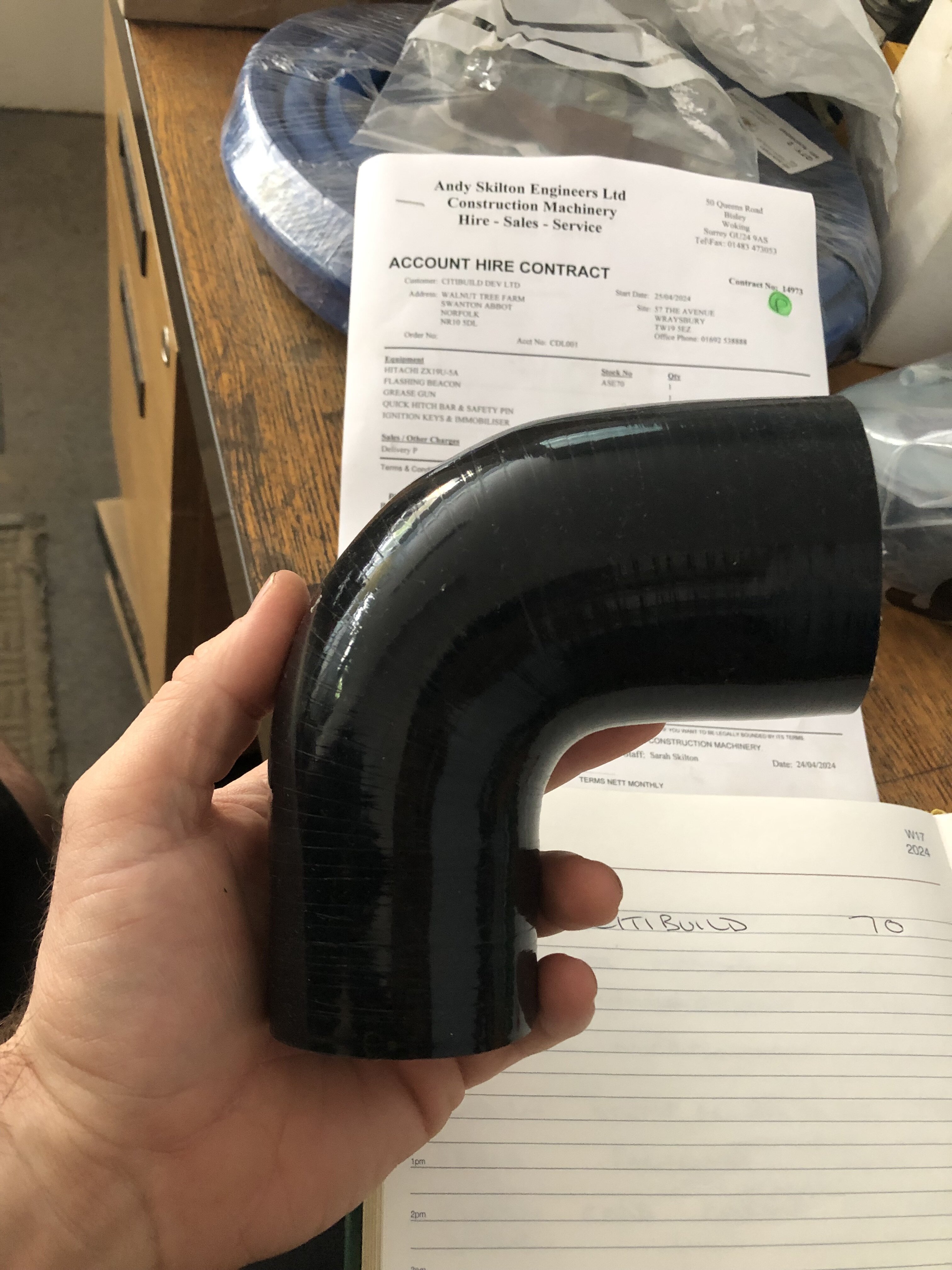

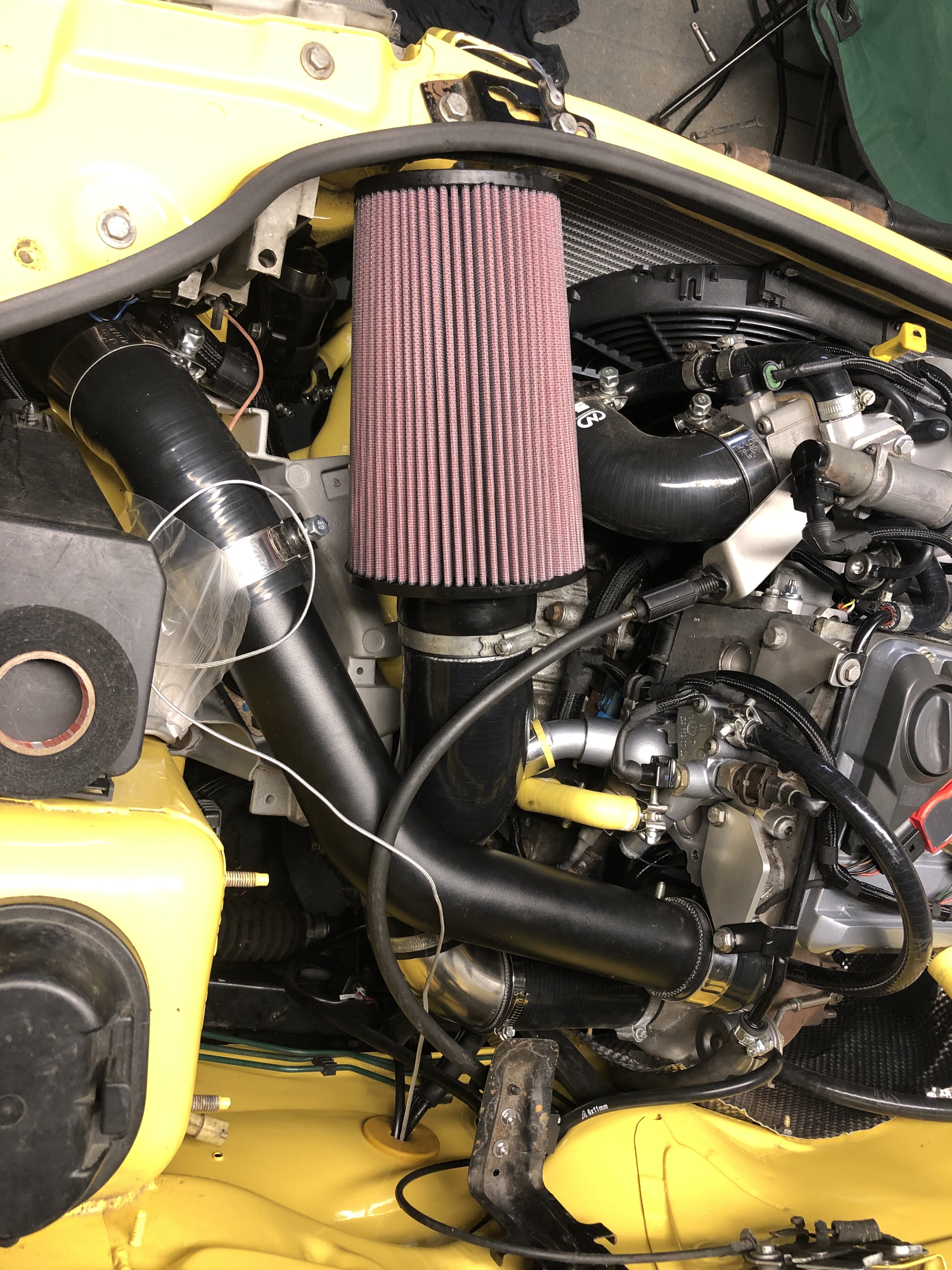

W Williamspaul 197 clio 16v Apr 21, 2024 #127 Butchered a 3 inch v band so I can weld a 3 inch 90 directly onto it

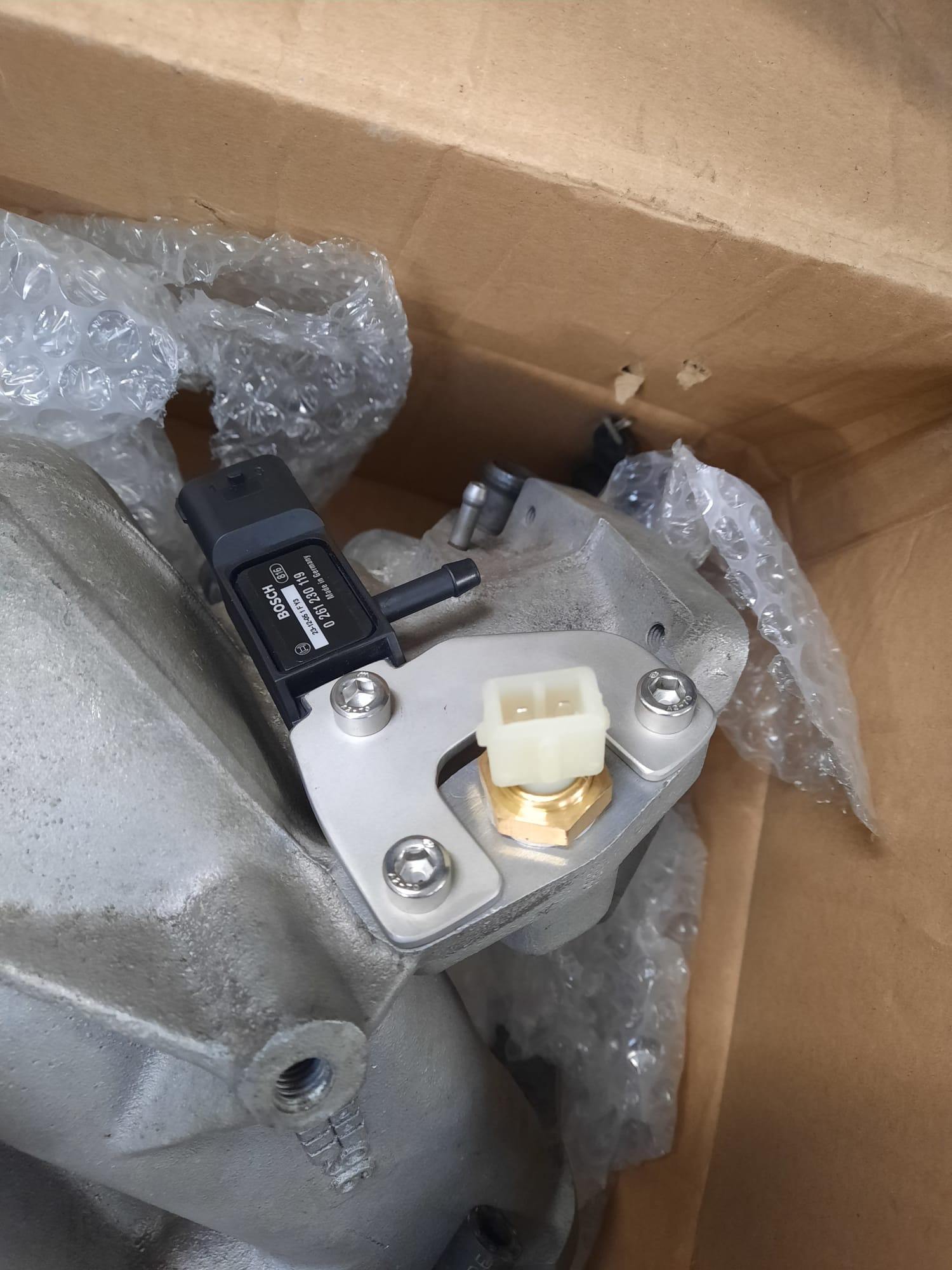

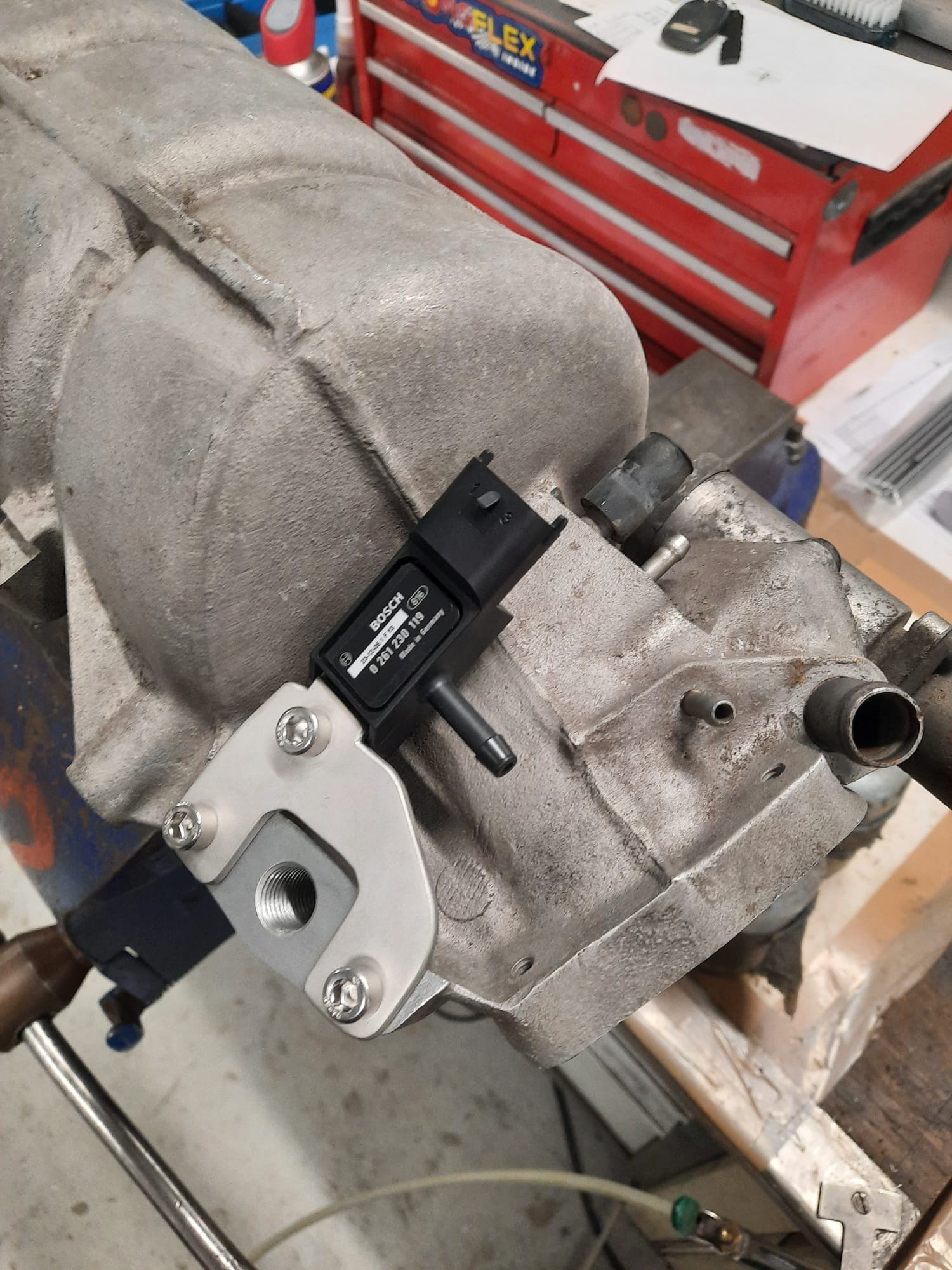

W Williamspaul 197 clio 16v Apr 21, 2024 #129 Throttle body changed for a Renault 19 item so you can attach a hose directly onto it and using factory Renault holes to run the boost pipes

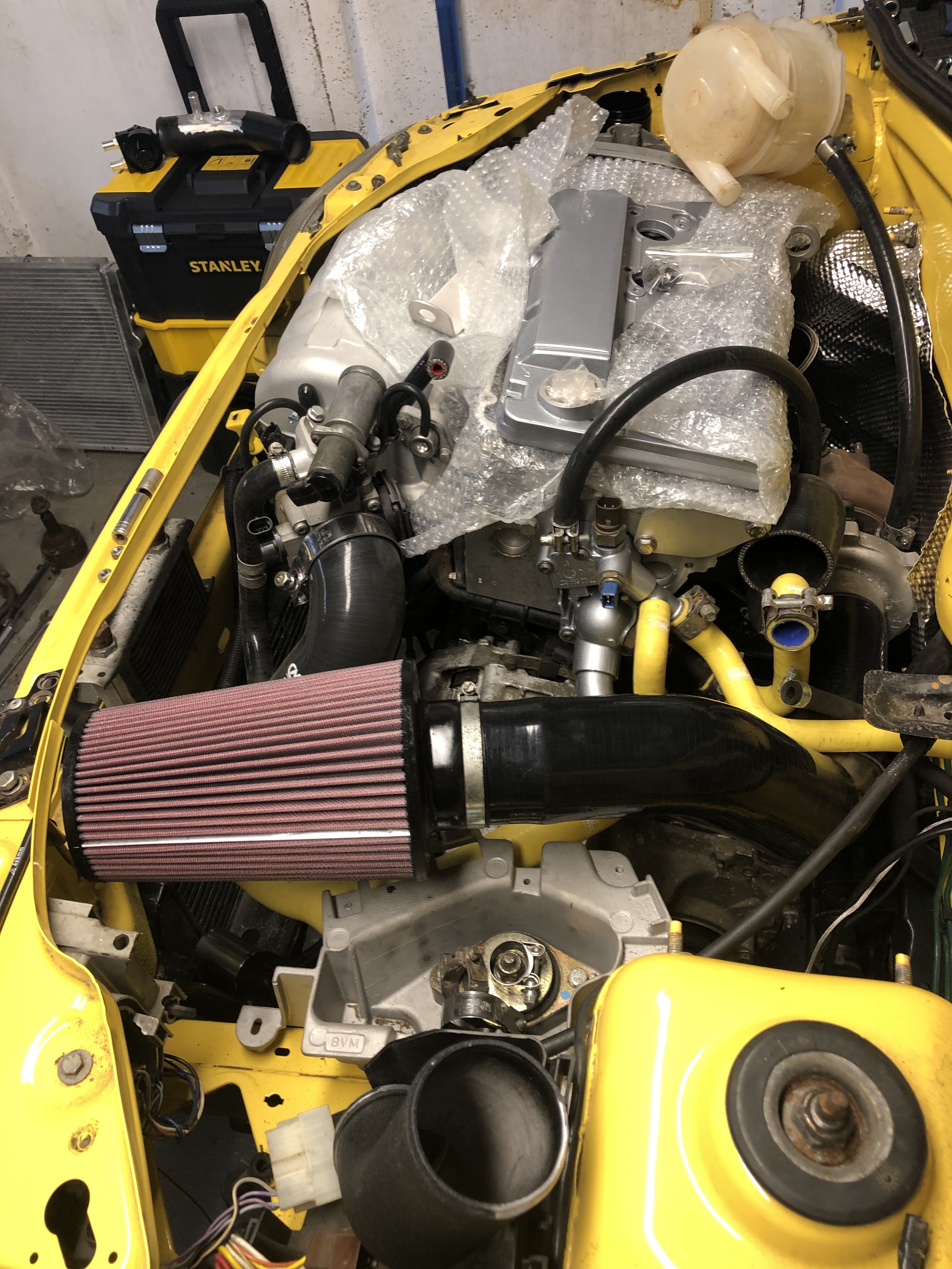

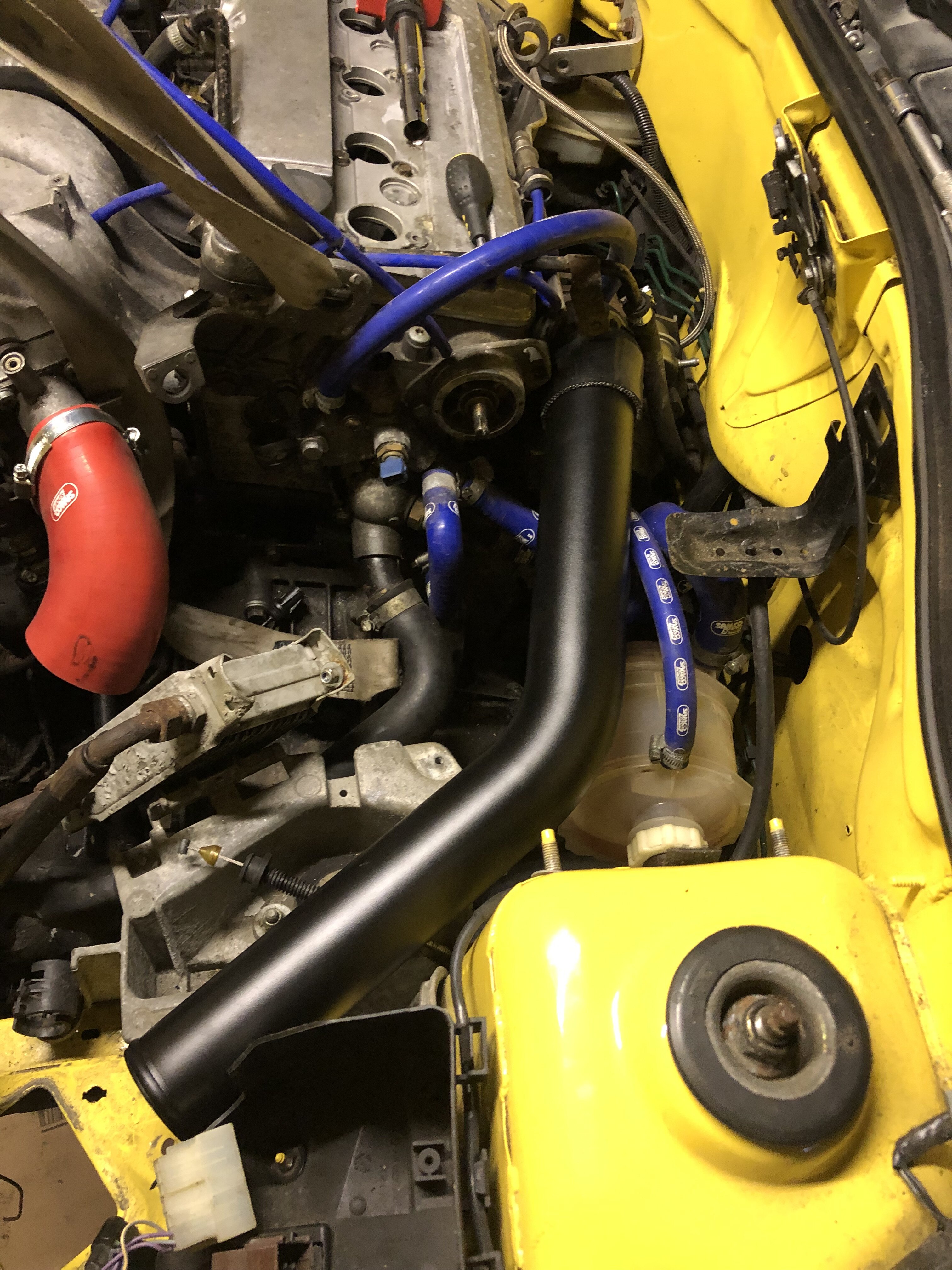

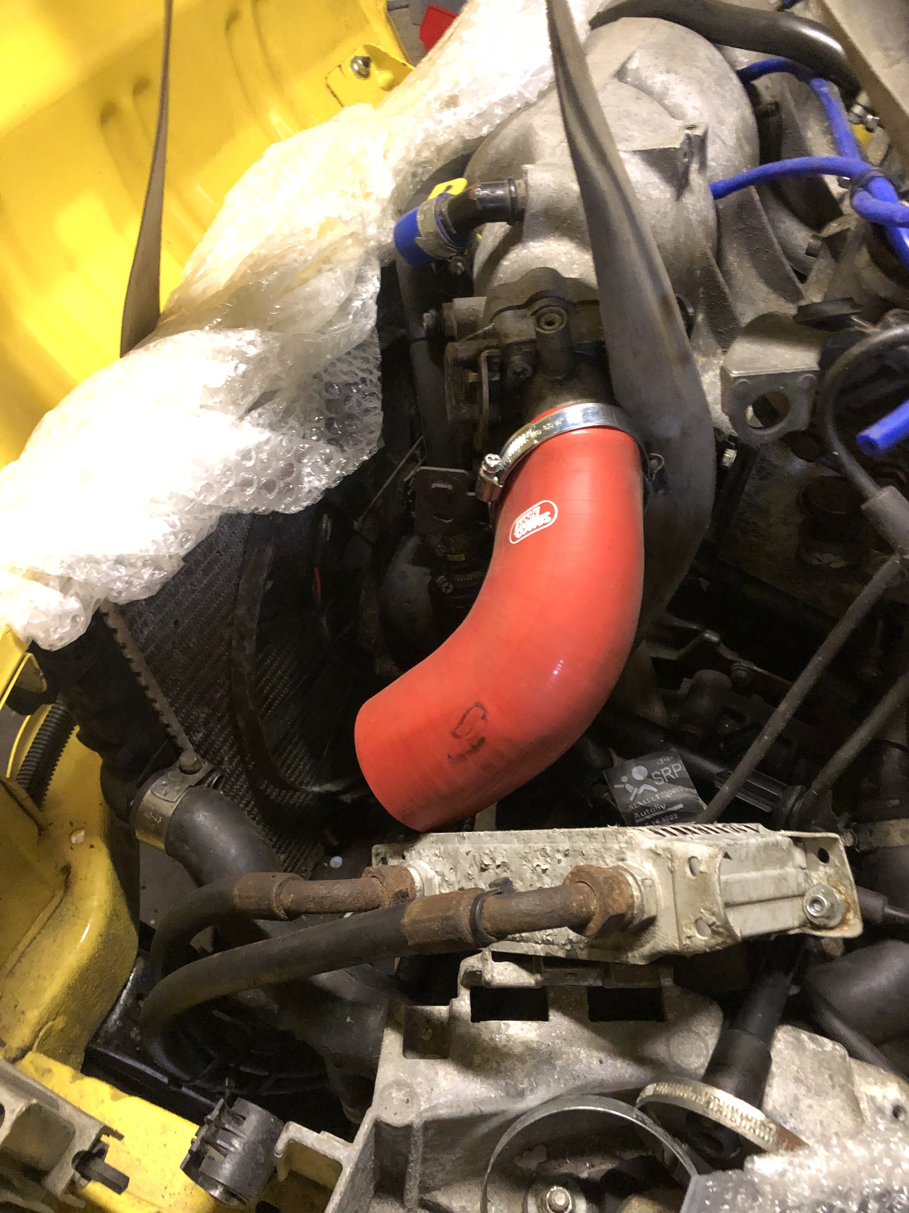

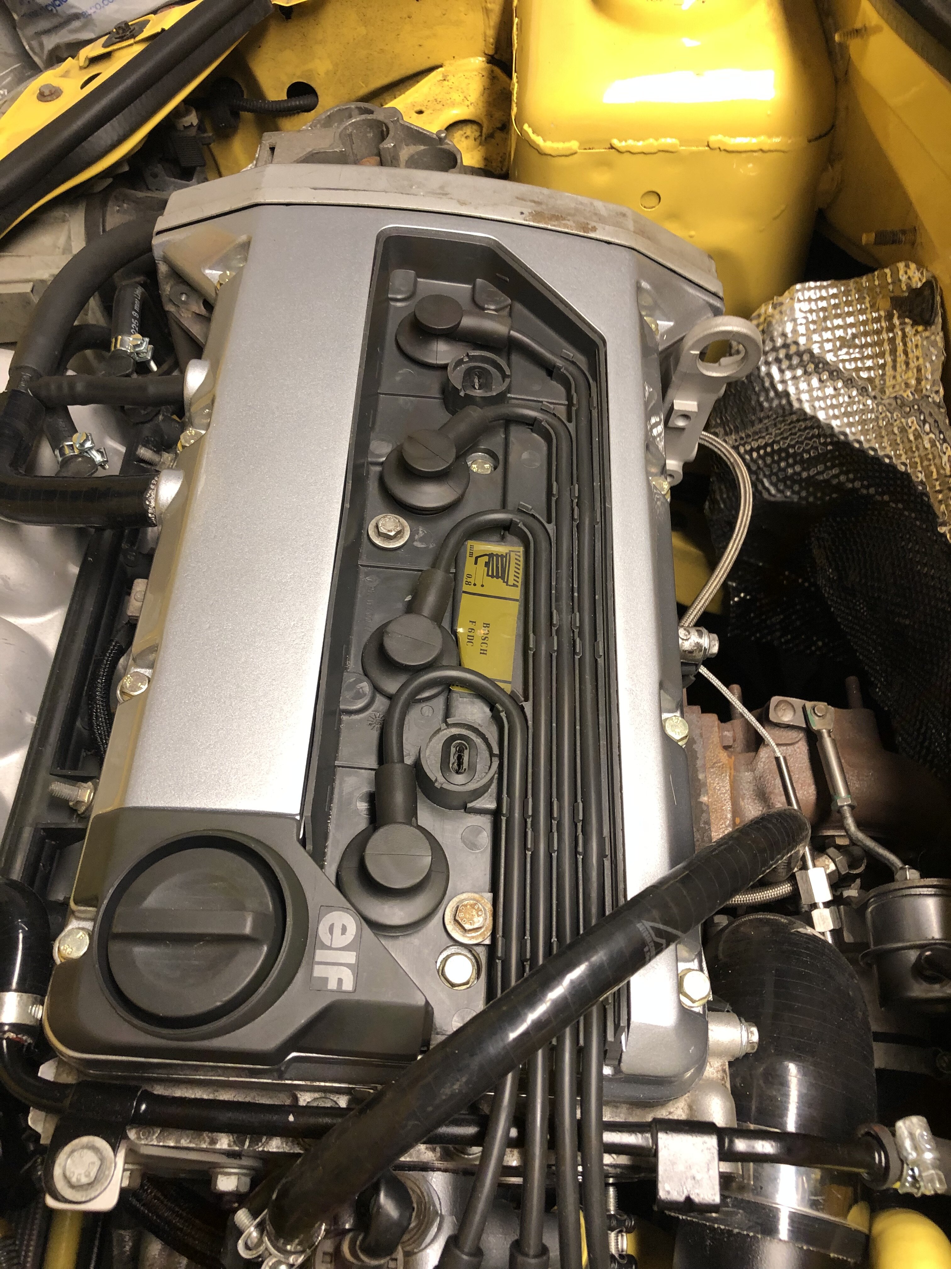

W Williamspaul 197 clio 16v May 2, 2024 #130 Rotated the turbo this morning and test fitted some boost pipes

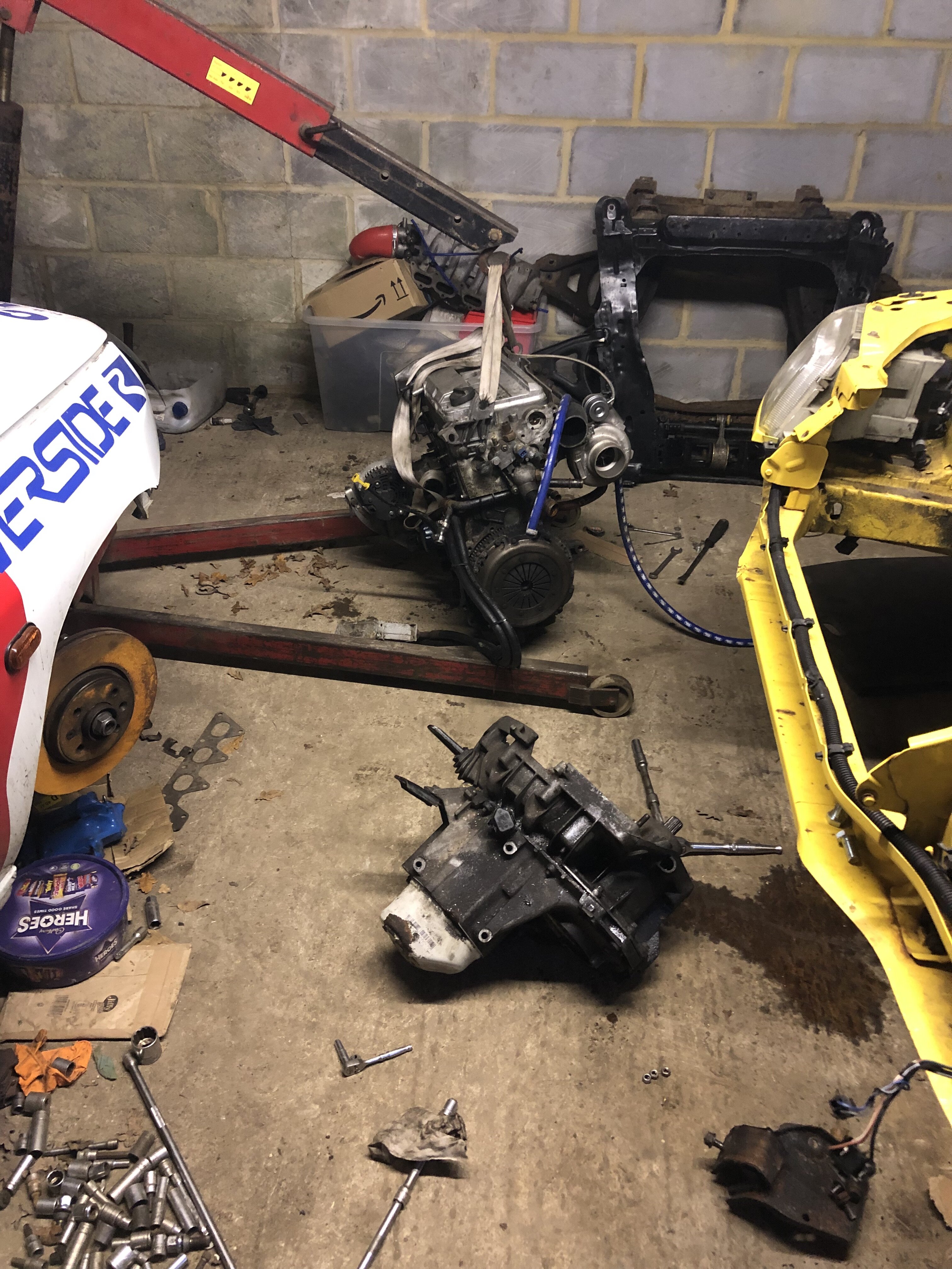

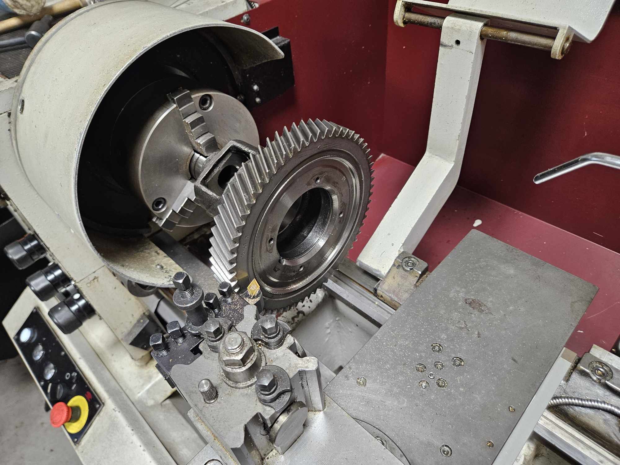

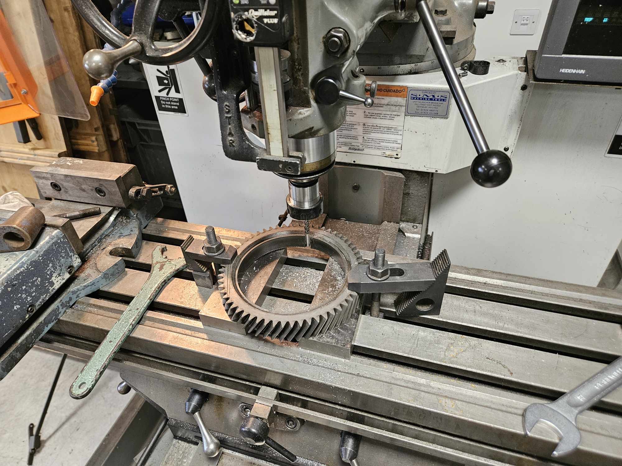

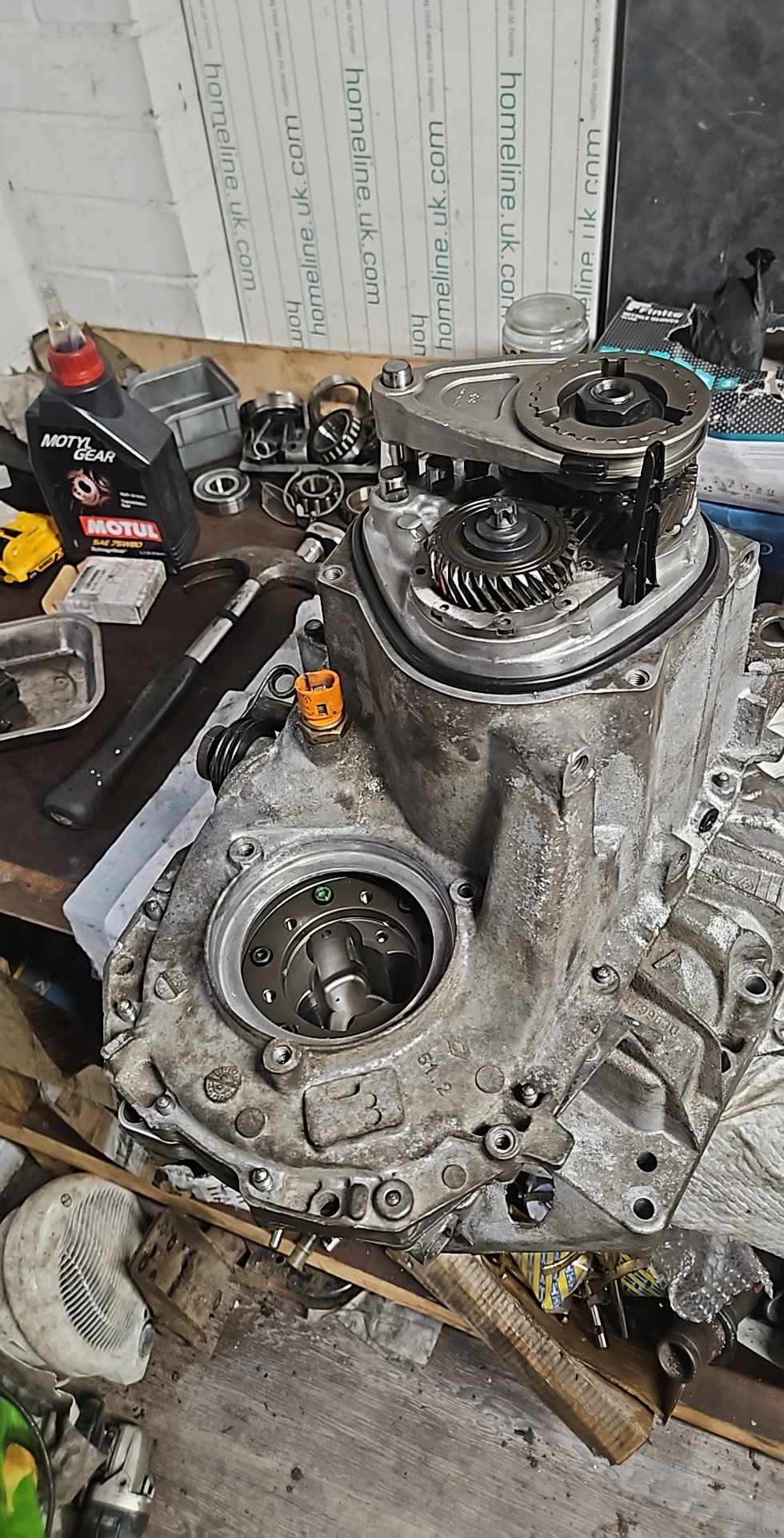

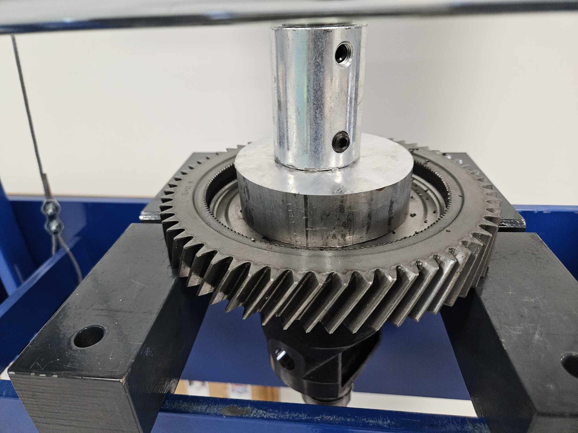

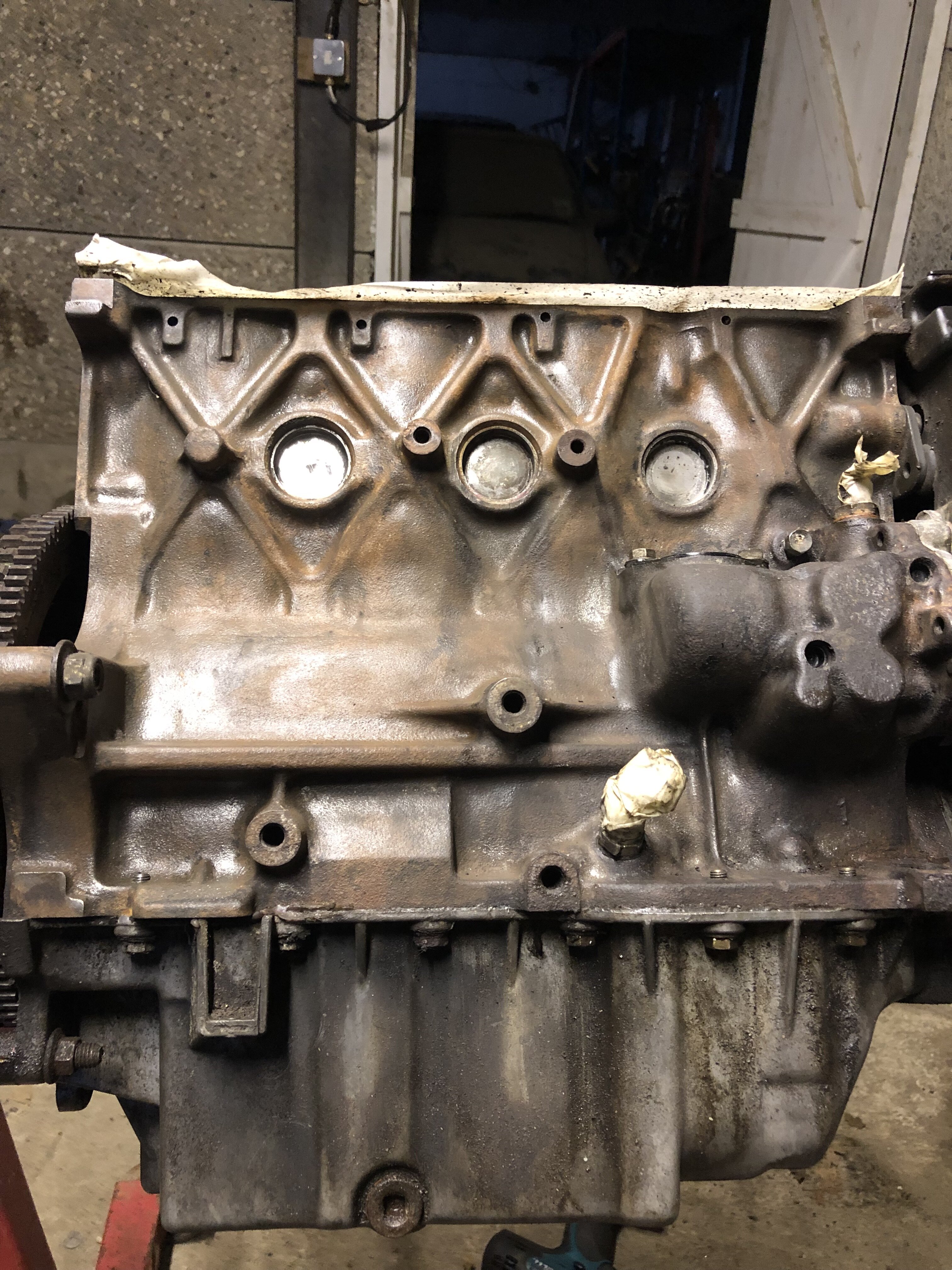

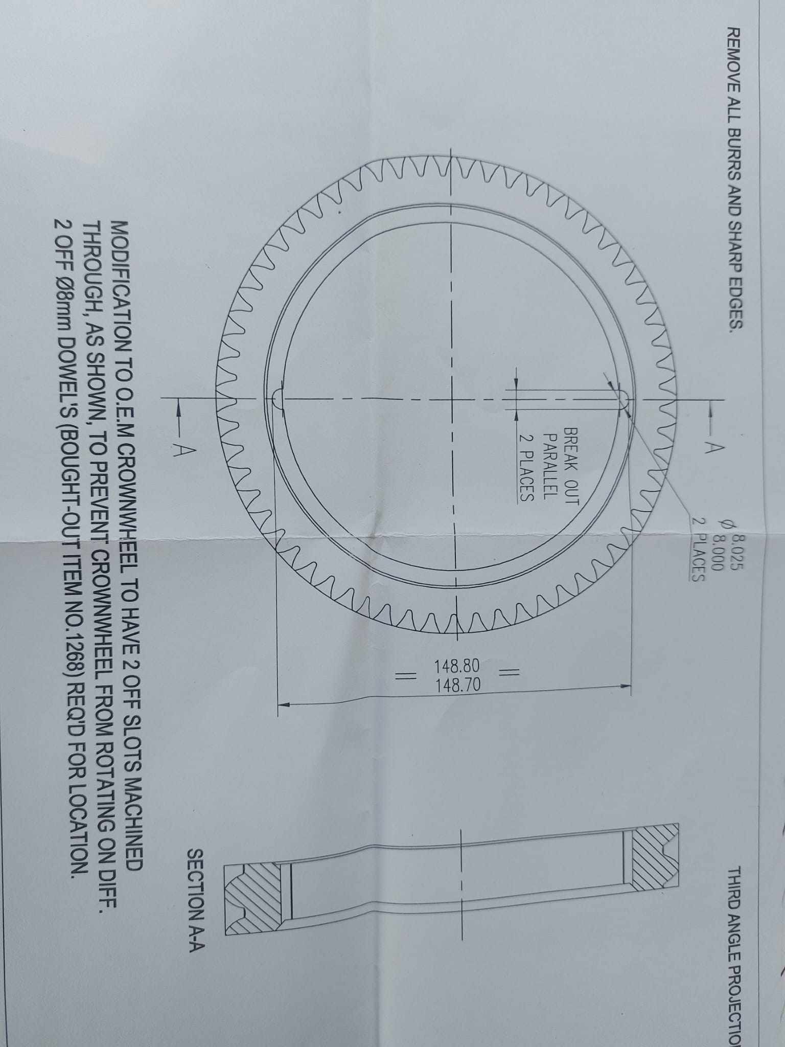

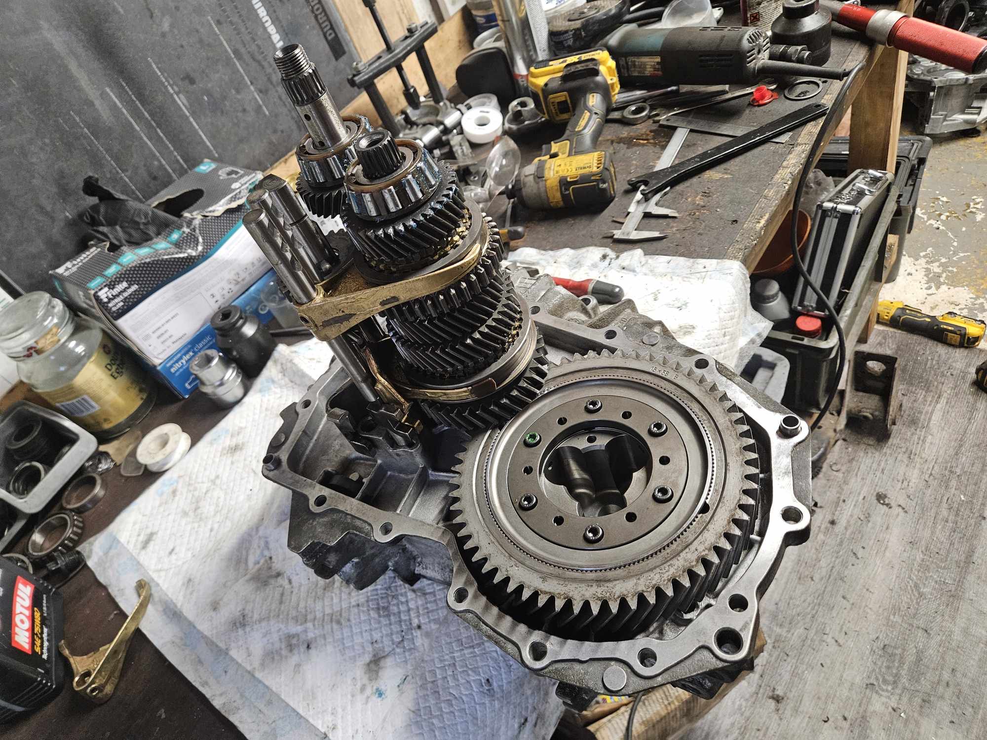

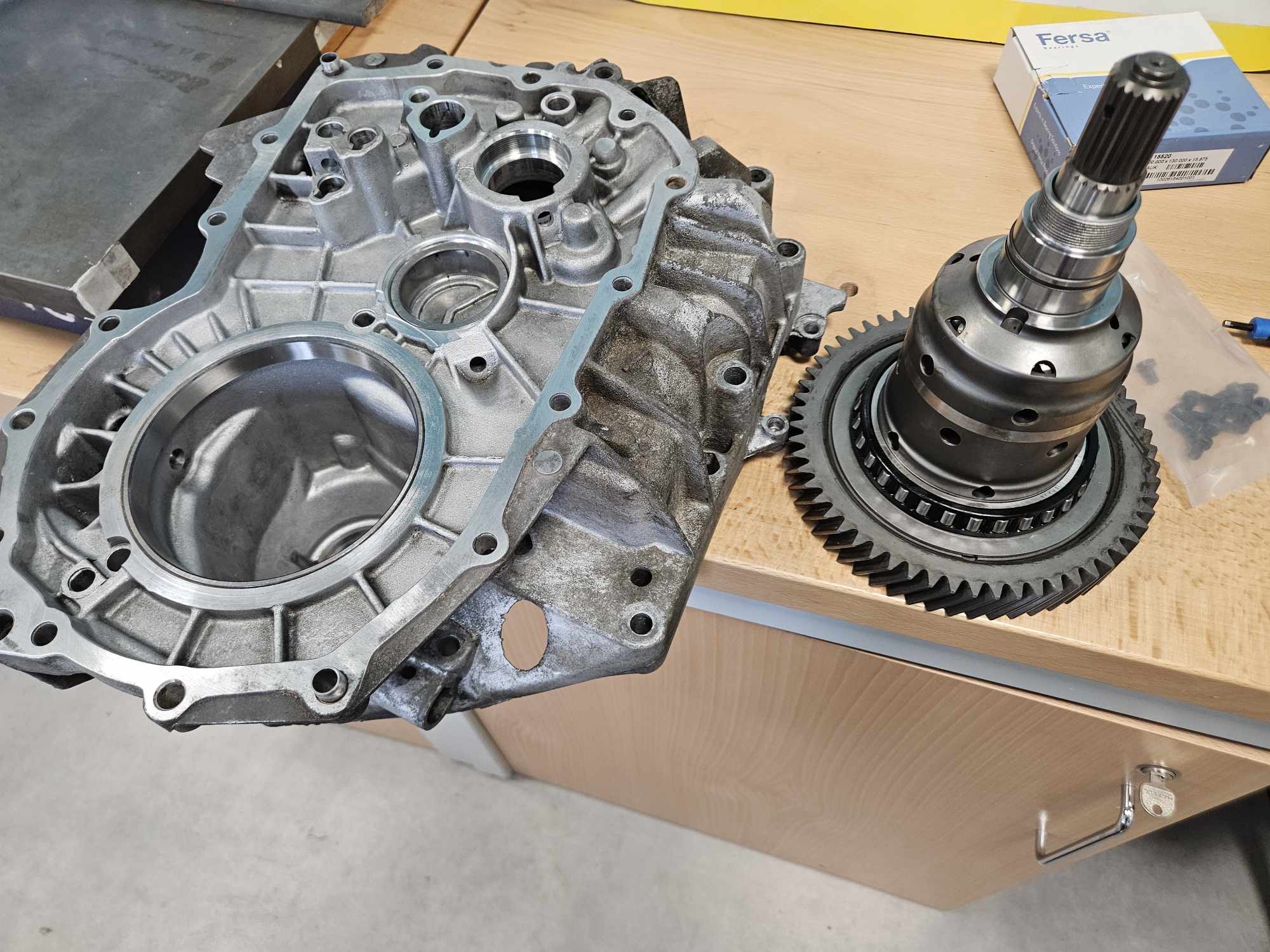

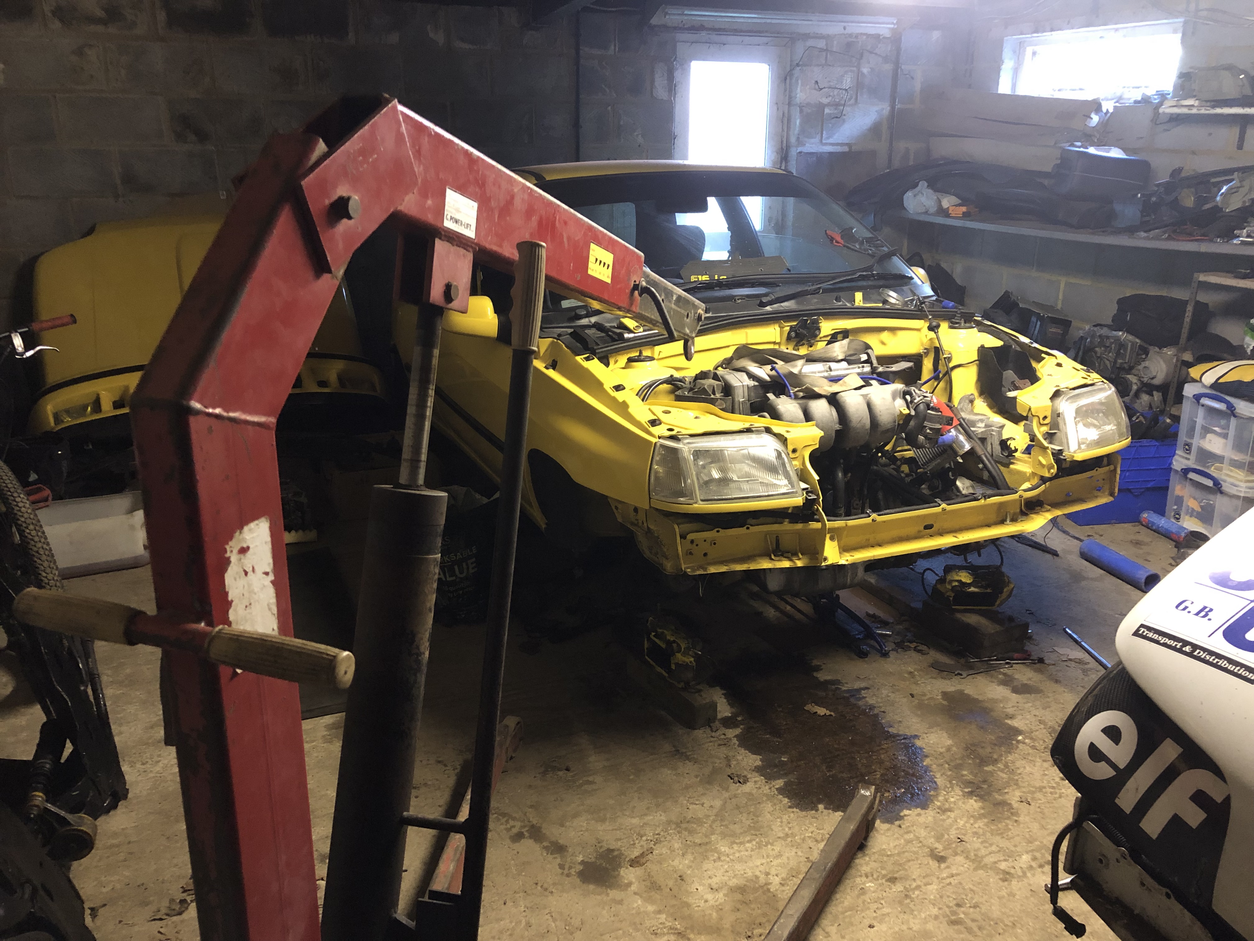

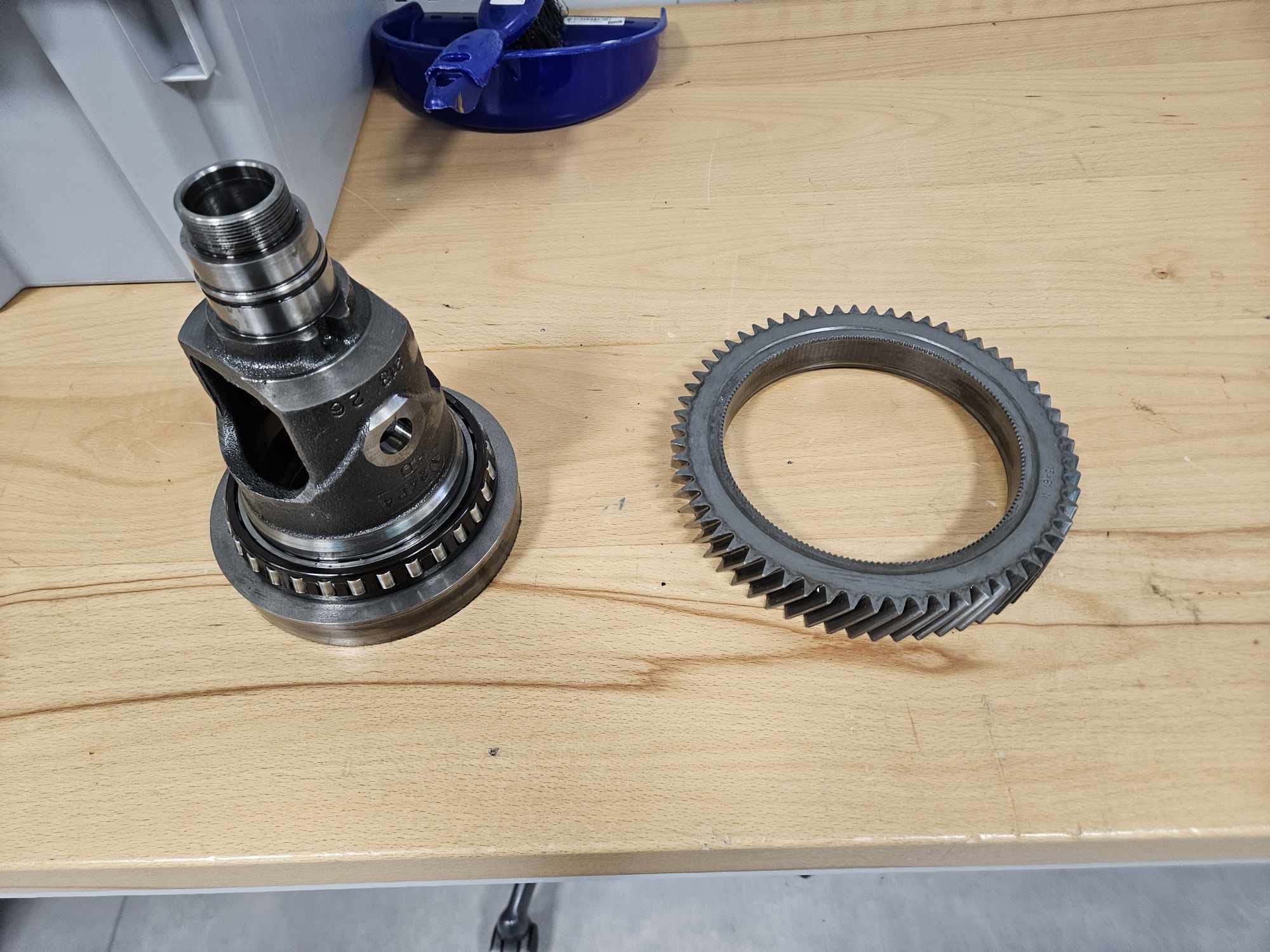

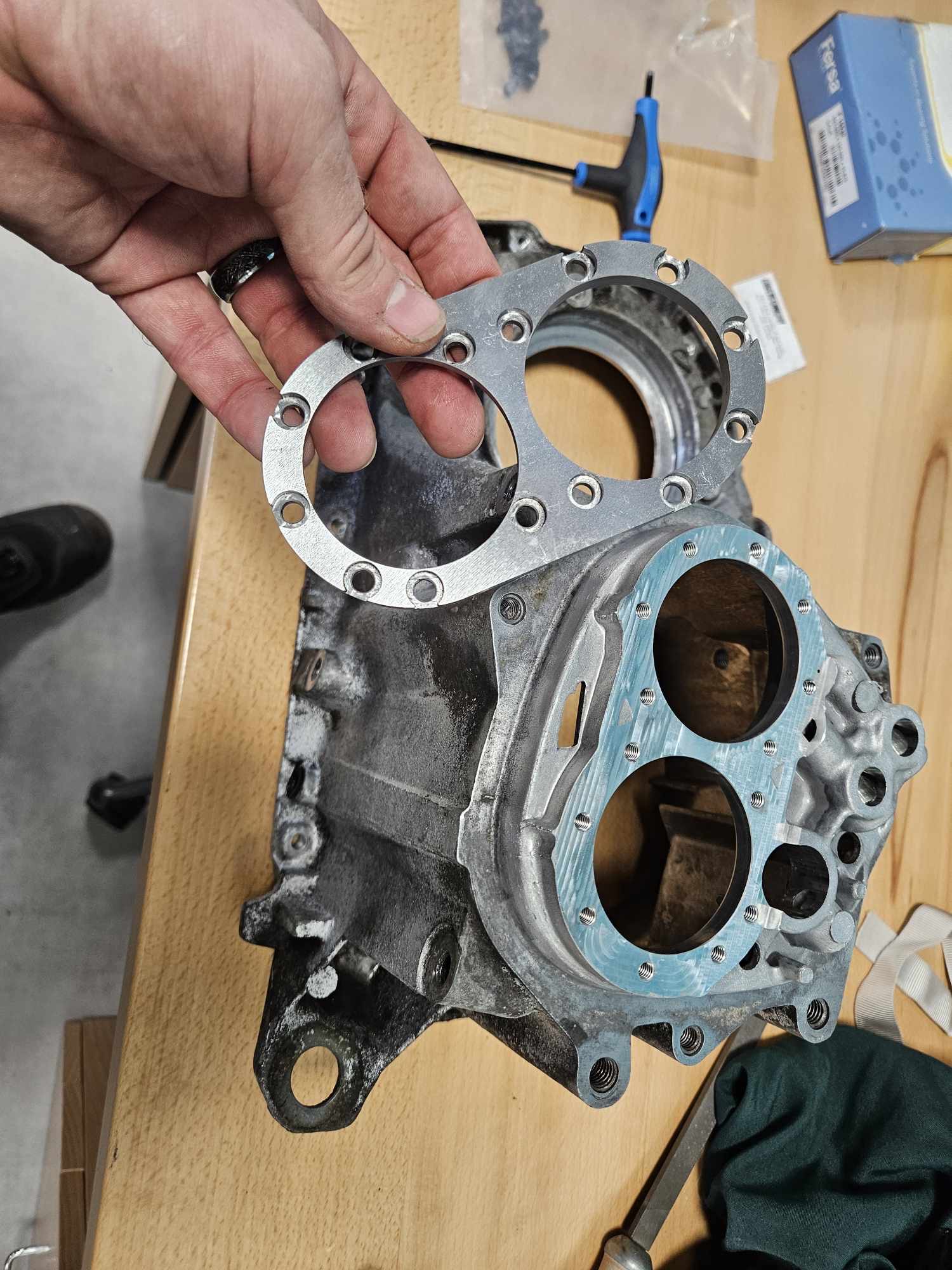

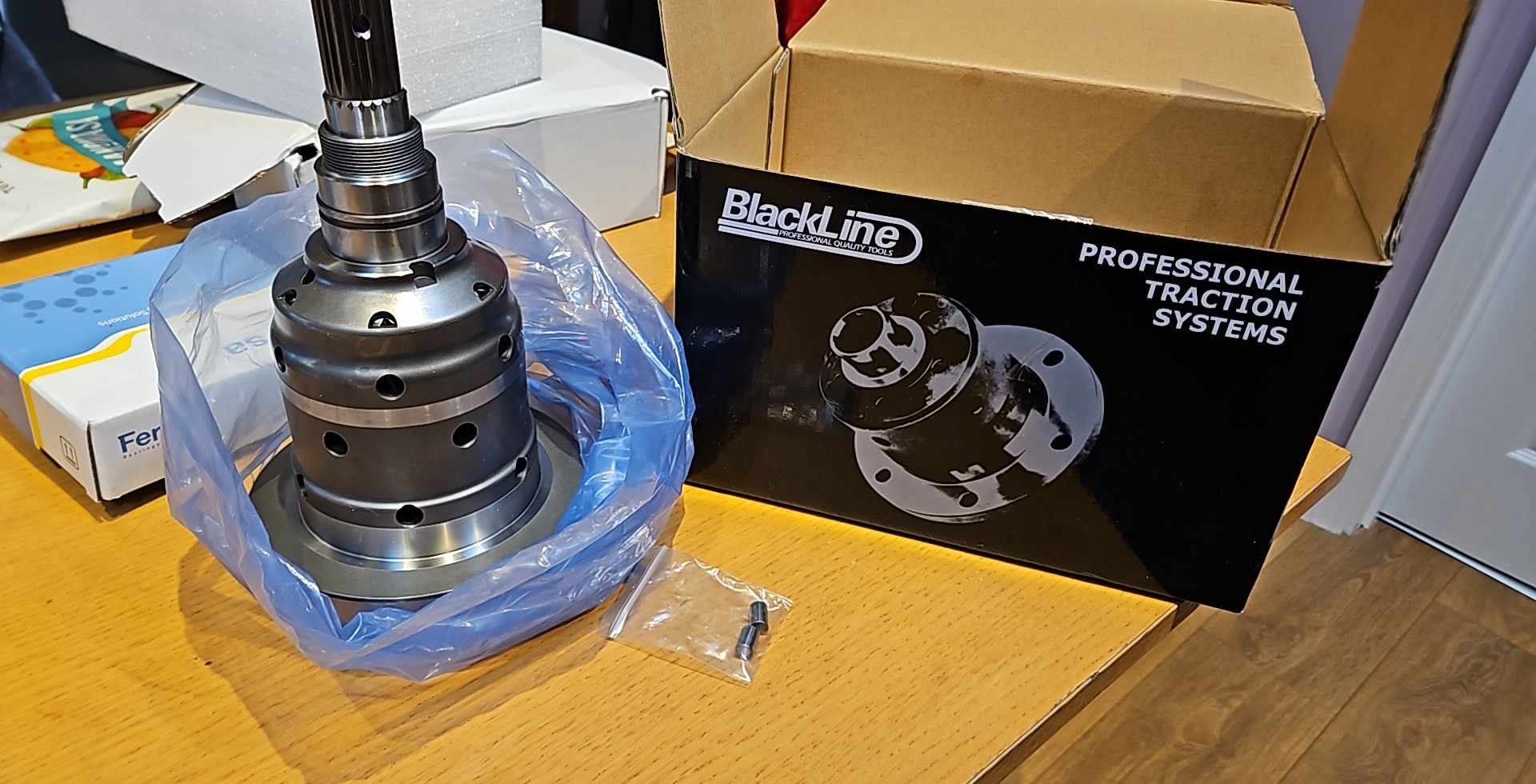

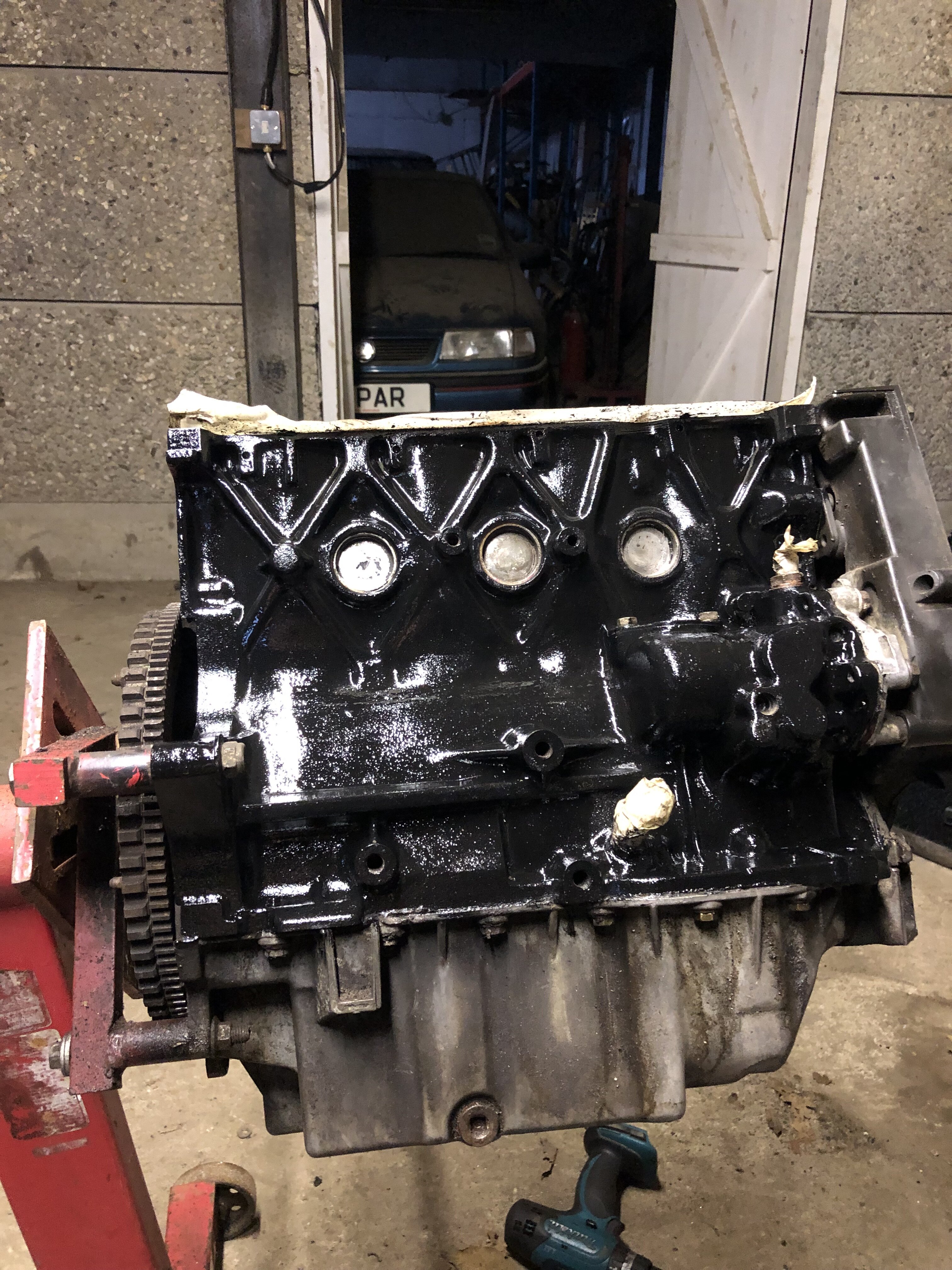

W Williamspaul 197 clio 16v May 2, 2024 #131 Bit more gearbox progress too blakline atb fitted to the crown wheel and pms strengthening plate ready to go on

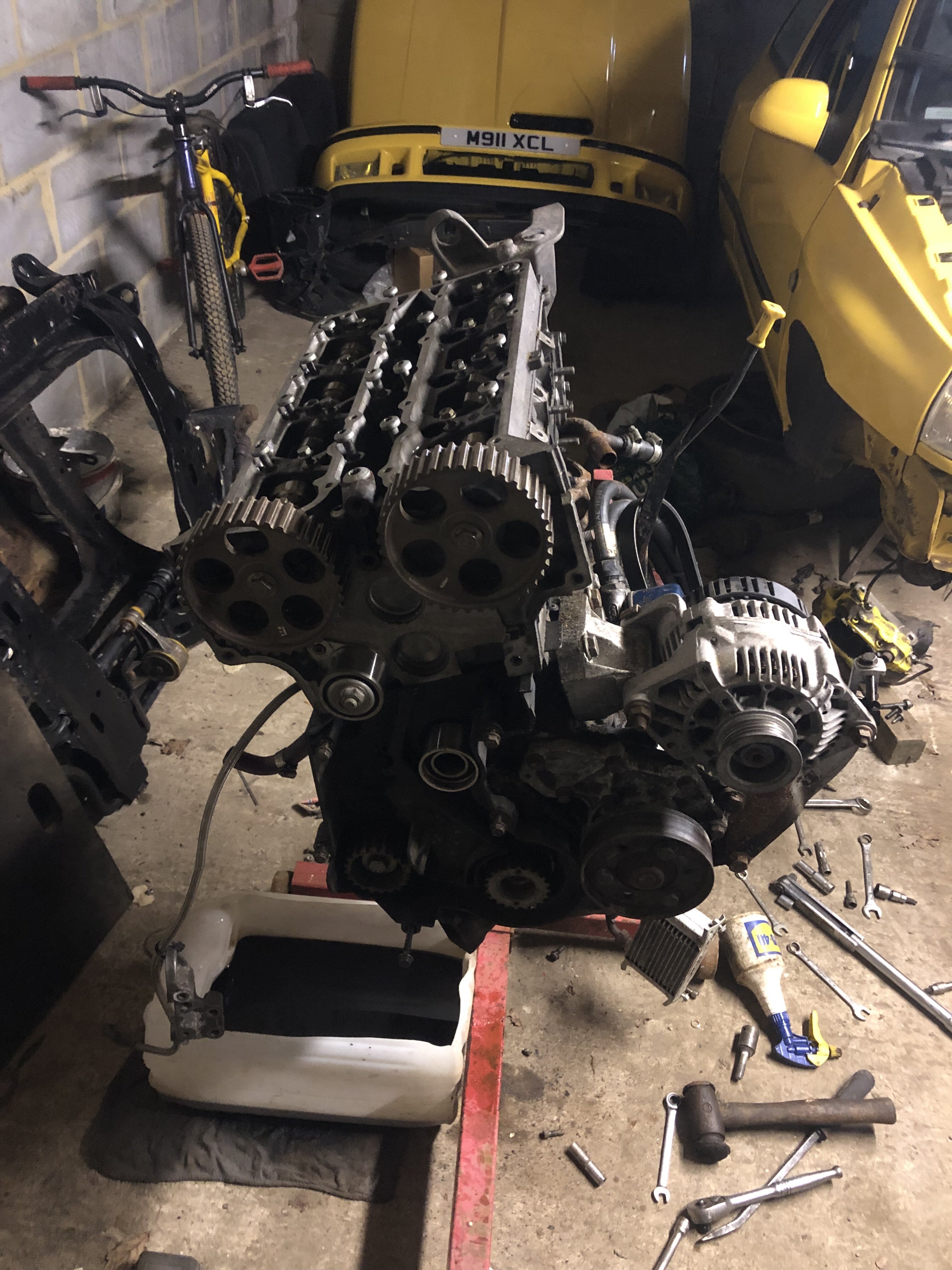

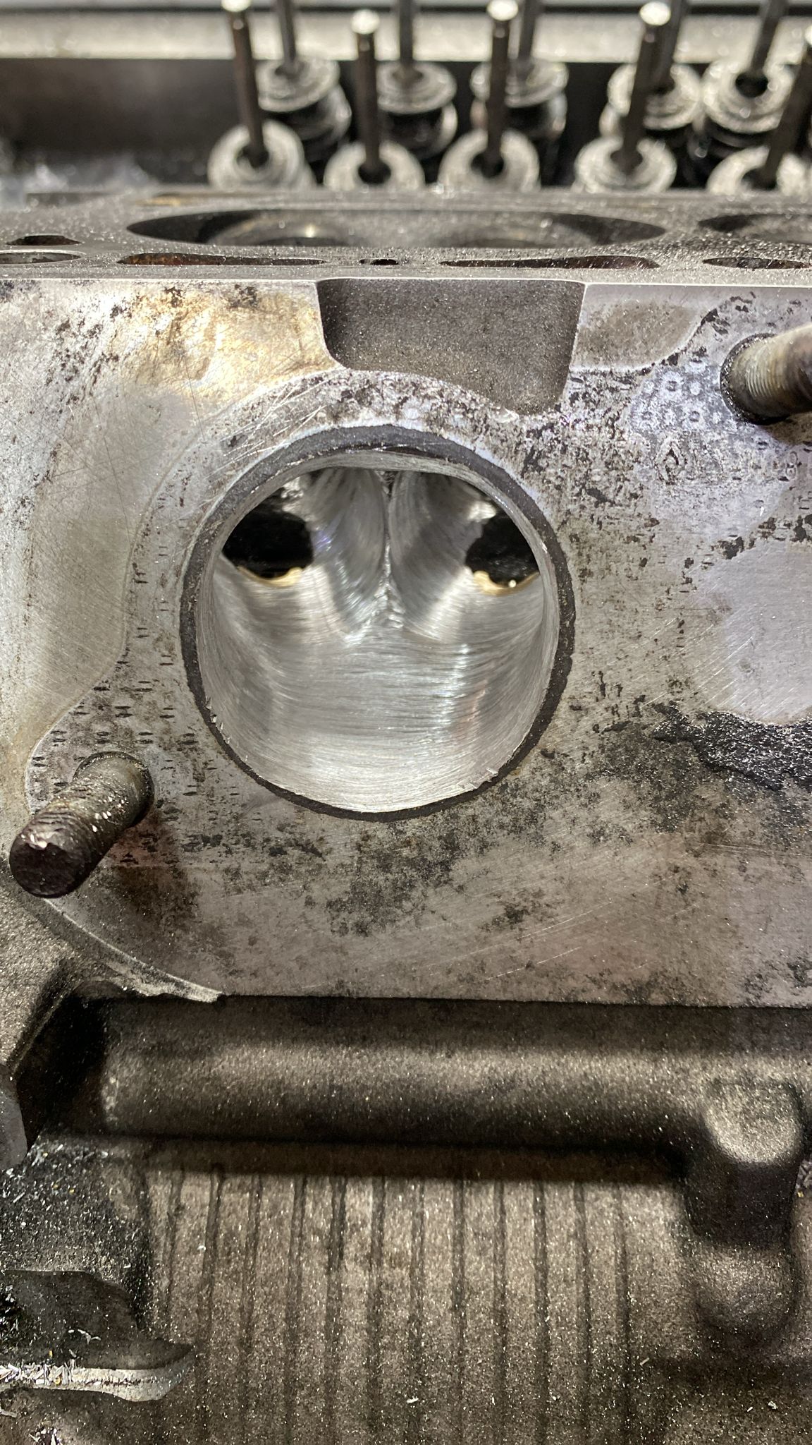

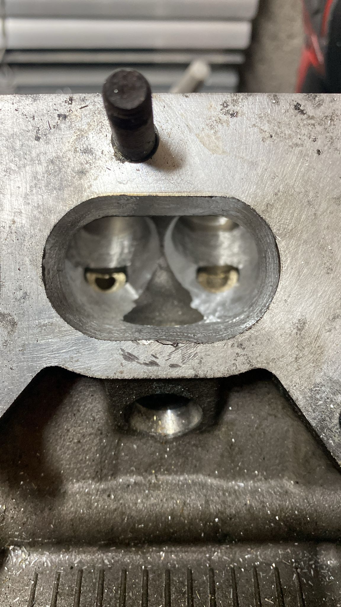

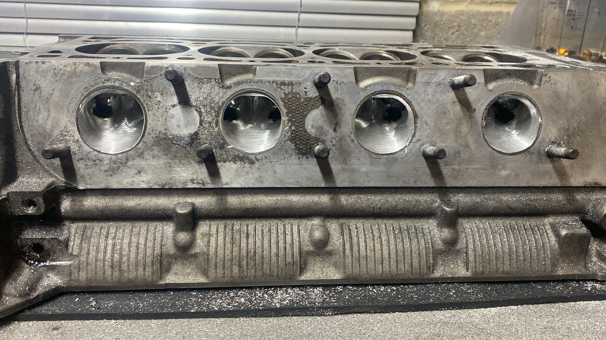

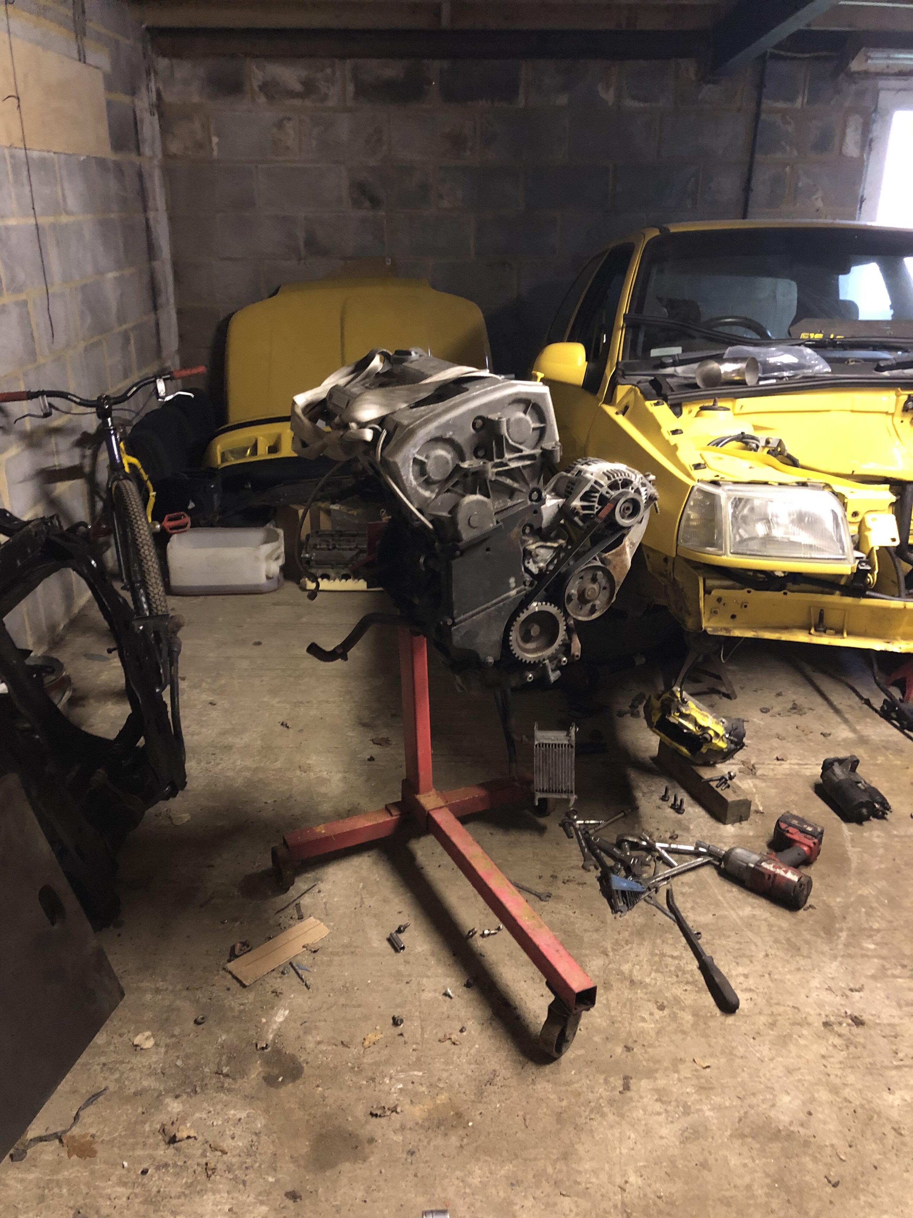

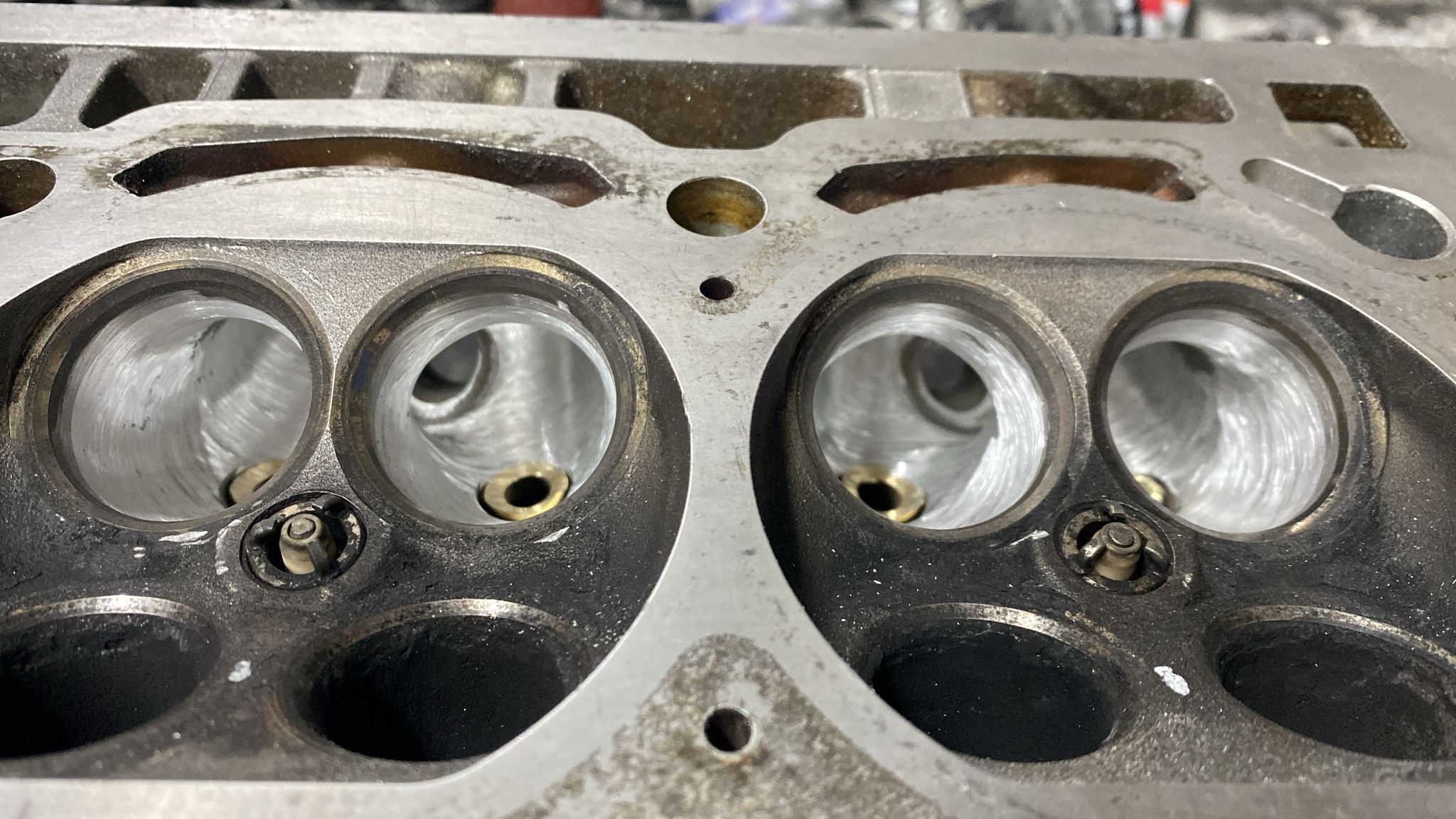

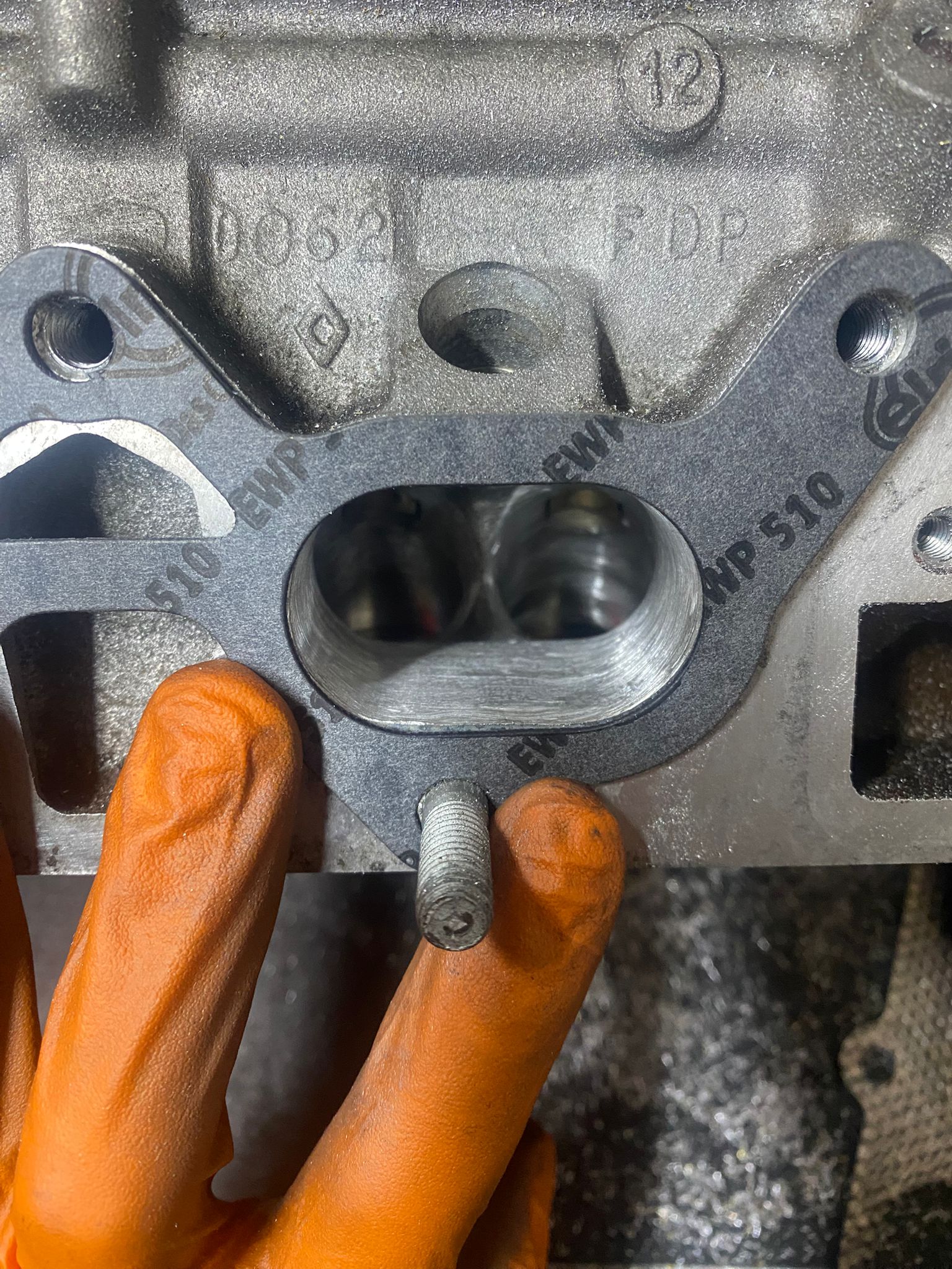

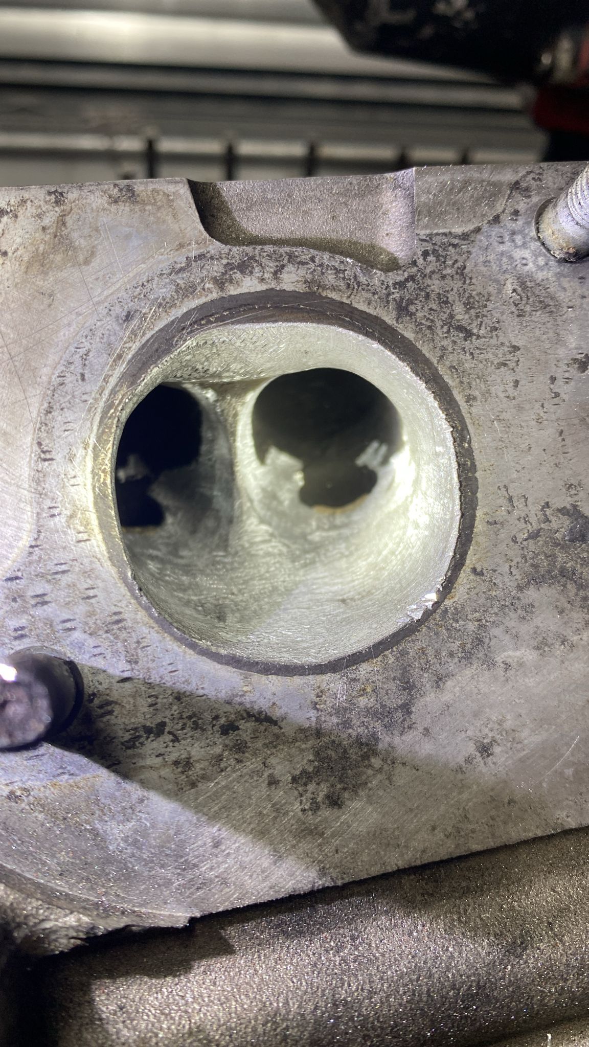

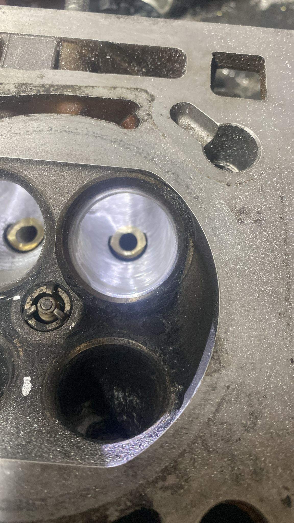

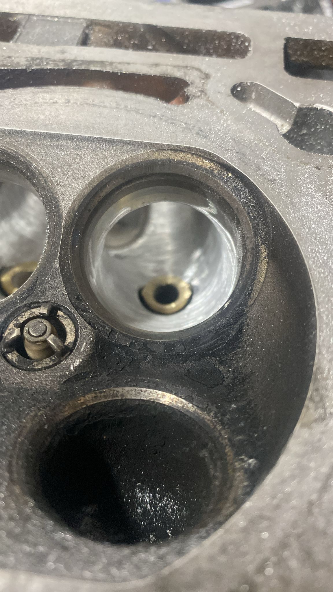

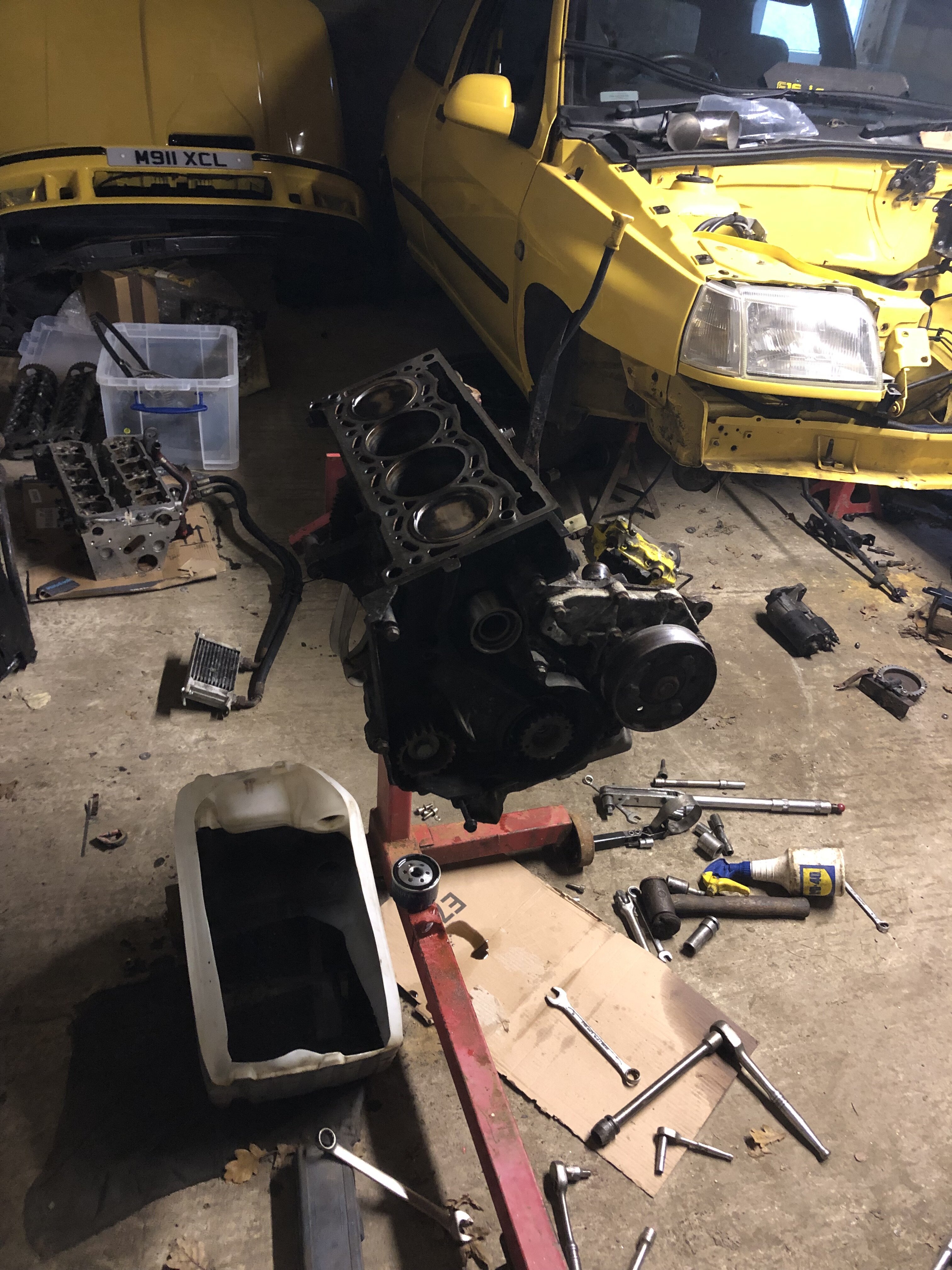

W Williamspaul 197 clio 16v Monday at 9:04 PM #136 Heads off taking it for porting and big valves tomorrow
