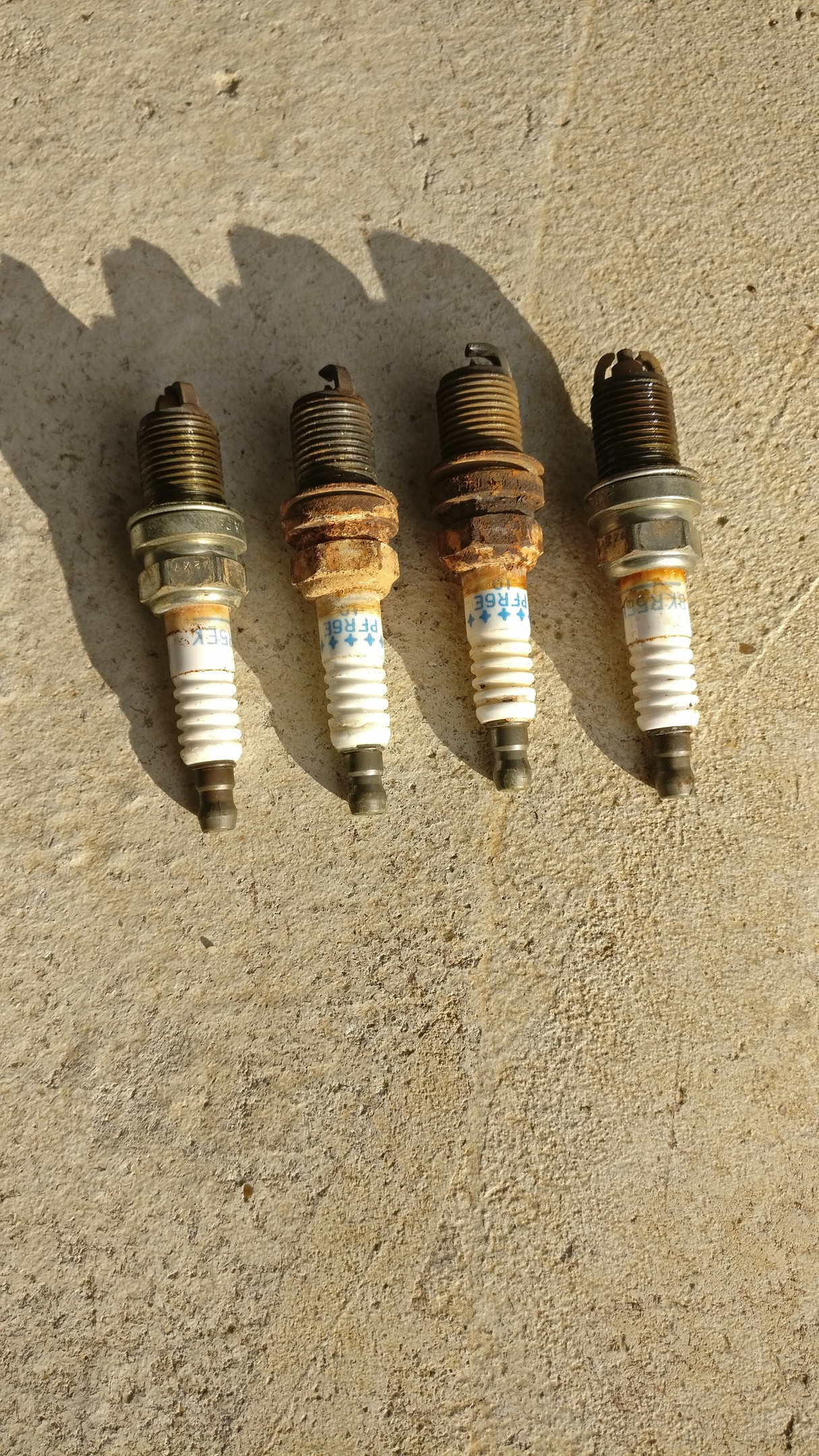

They are very very tight. Are they normally so tight? Im struggling to move them. And one looks like it's rusty. Also there seems to be alot of oil around my rocker? Any ideas thanks.

Be prepared to find them cross-threaded or otherwise completely fucked.
Ali head so they should never be put in particularly tight in the first place.

Use a bigger ratchet and make sure you are turning the right way.
Try nipping the bolts on the rocker up.

Righty tightly lefty loosy. Okay well I just broke my plug tool. So their da mn tight.
  PH2 172
Try tightening the plugs by 10 degrees before attempting to remove them.
And fit replacements with a dab of copperslip!

@STEVE.M @Mr. Plums @R3k1355 thanks for your help, I've finally got them out and well. I've seen better. And they were really cross threaded.

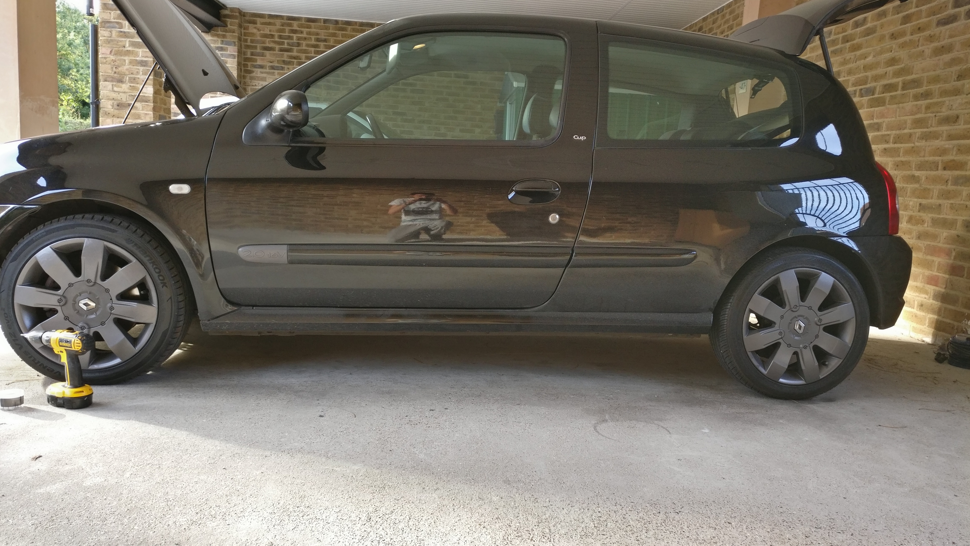

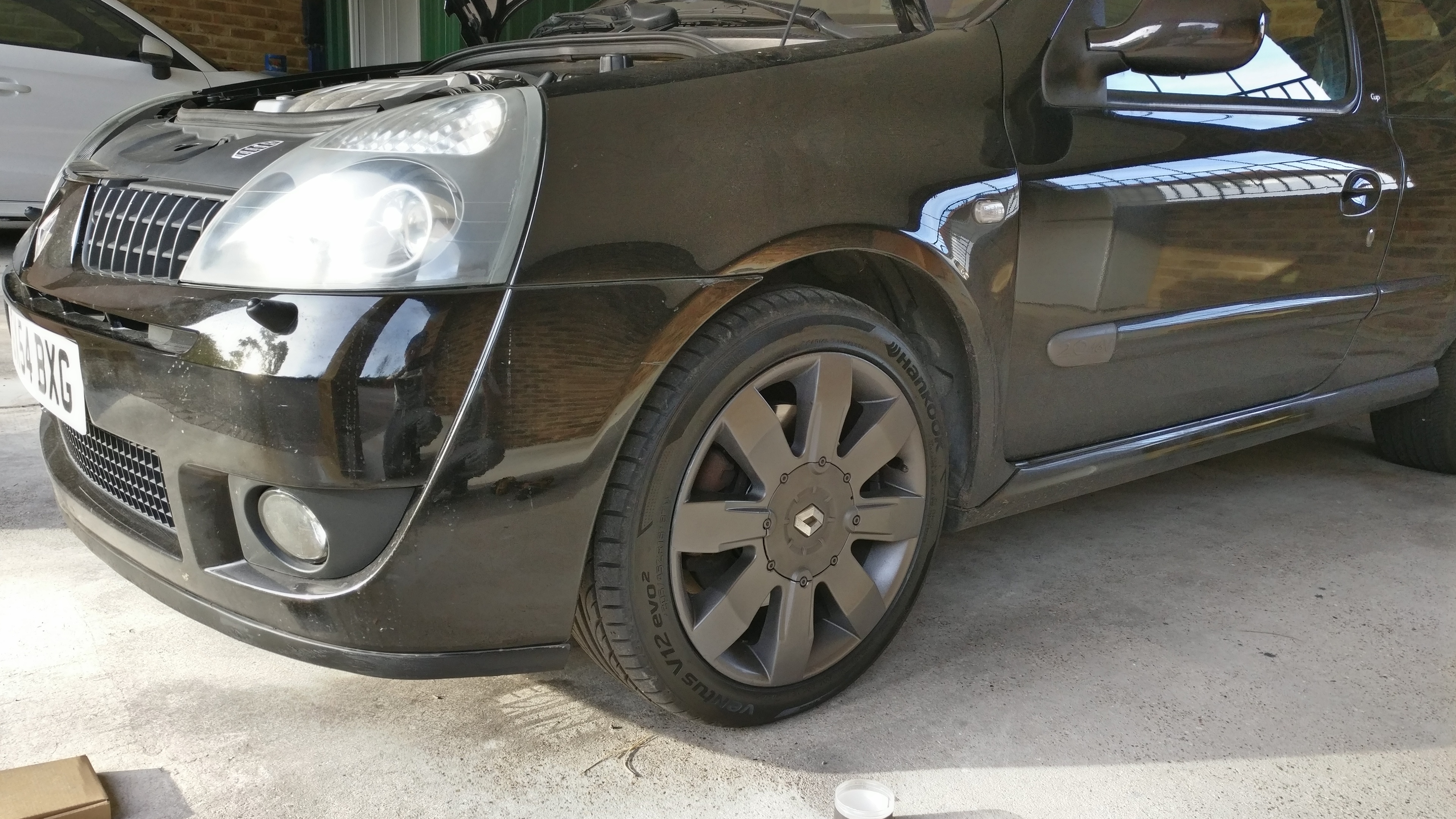

Nice new shiny ones in now. And some pictures of my car.
Trying to keep her stock and cleaned up. Previous owners didn't look after her.

You have two pem plugs and two different ones lol.
I bet your car is buzzing its chops off now it has a caring owner :)

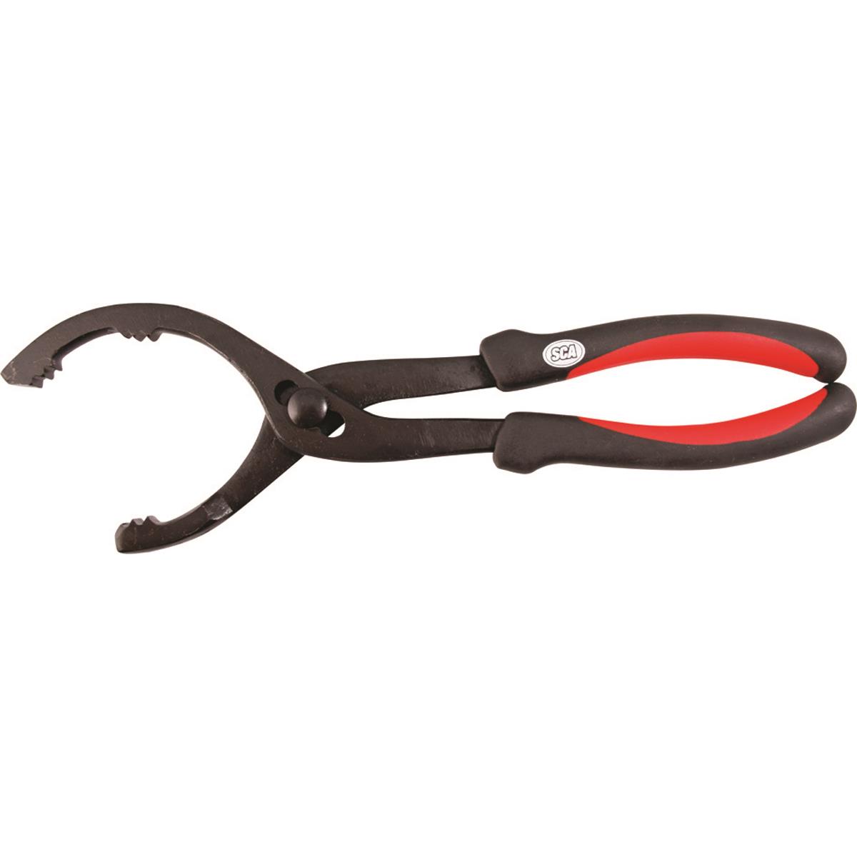

@Knuckles oh right! I'll get round to changing it then next week I should have time. How do you normally change filter? I can't find my tool anywhere had a little thing made my life easier.
I’ve got a little tool to do them
Couple of quid off eBay or a tenner from screwfix etc

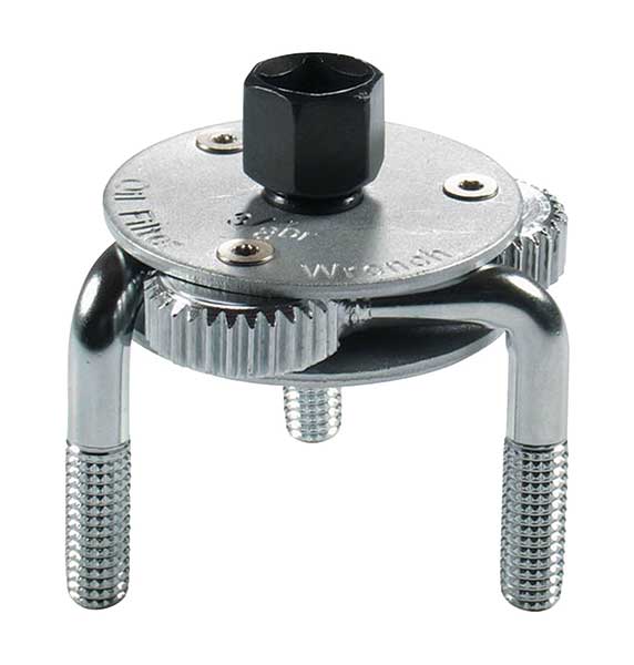

This is the tool I like best

@Knuckles that's what I had! Screw fix thanks. I couldn't think for life of Me what it's called. @R3k1355 that looks terrifying lol. But I think I get how it works? Can attach a torq wrench with a 5mm bit to the black part? Looks familiar.
