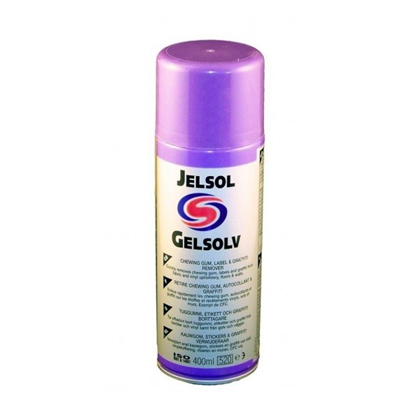

First step... just like everyone else.. HEAT GUN & SCRAPER
You’ll get most of the deadening off this way, but you’ll have plenty of residue remaining.
Then use AUTOSMART JELSOL
I know I’ve said this in a few threads now, but I really can’t stress enough at how good this product is.
I spent a fair while on DetailingWorld and at one point I was addicted to it ? so bought loads of stuff that I really didn’t need and this was one of them...
If you want a cheap and fast way to remove your sound deadening or you badges etc.. this is the bottle to grab

Autosmart Tardis does a really good job too.
It's probably the same stuff just in a pressurised can form.
Similar product, they both have completely different uses though.
I wouldn’t use tardis on anything other than a painted surface.
If you’ve used Tardis on the sound deadening, it’ll take a lot longer for it to dissolve/remove than Jelsol.
However I do have Tardis in the workshop for other services ?

That stuff may be good, but it's over £30 a litre. Petrol does the job just fine in my experience and is much cheaper lol
