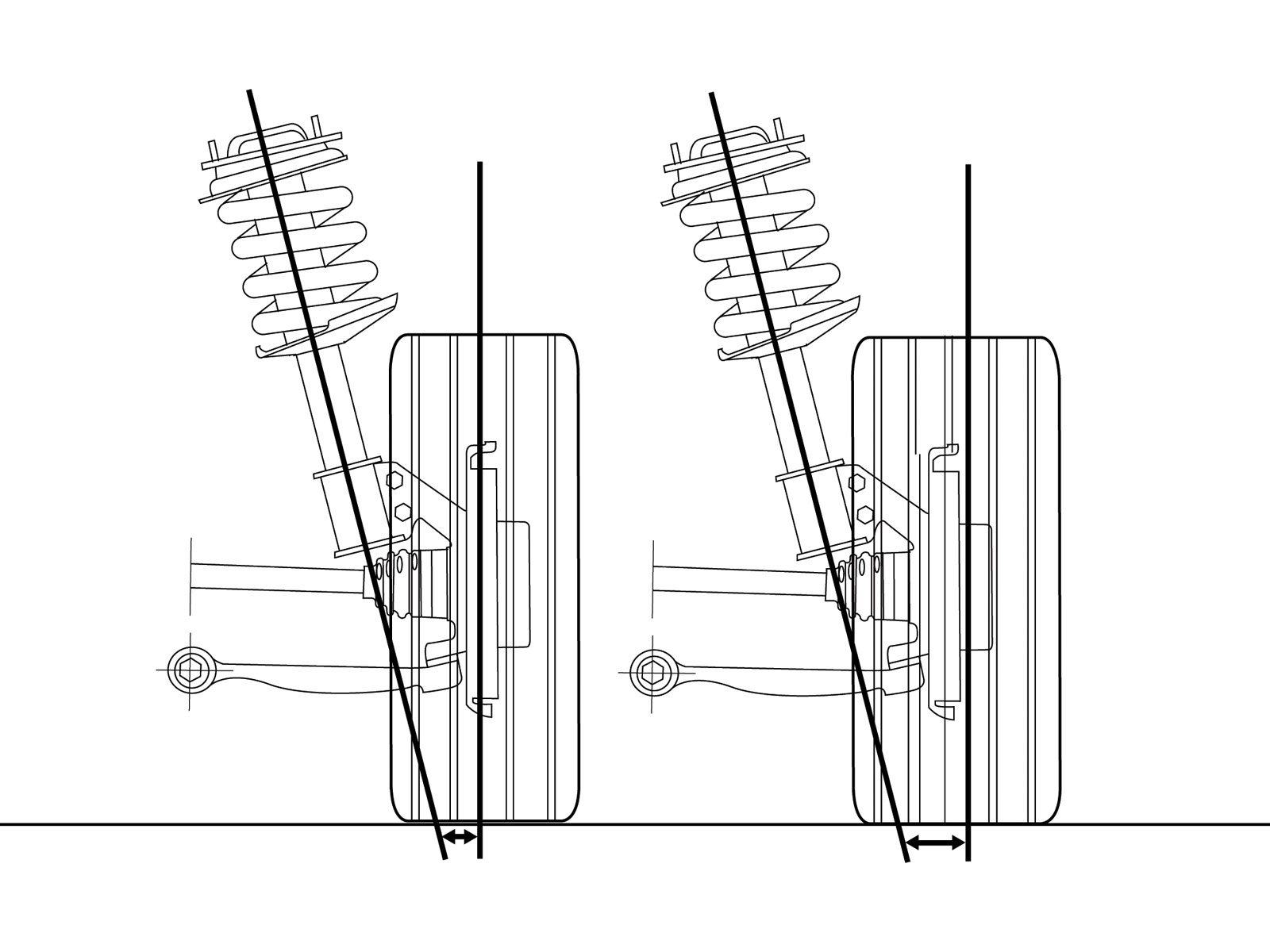

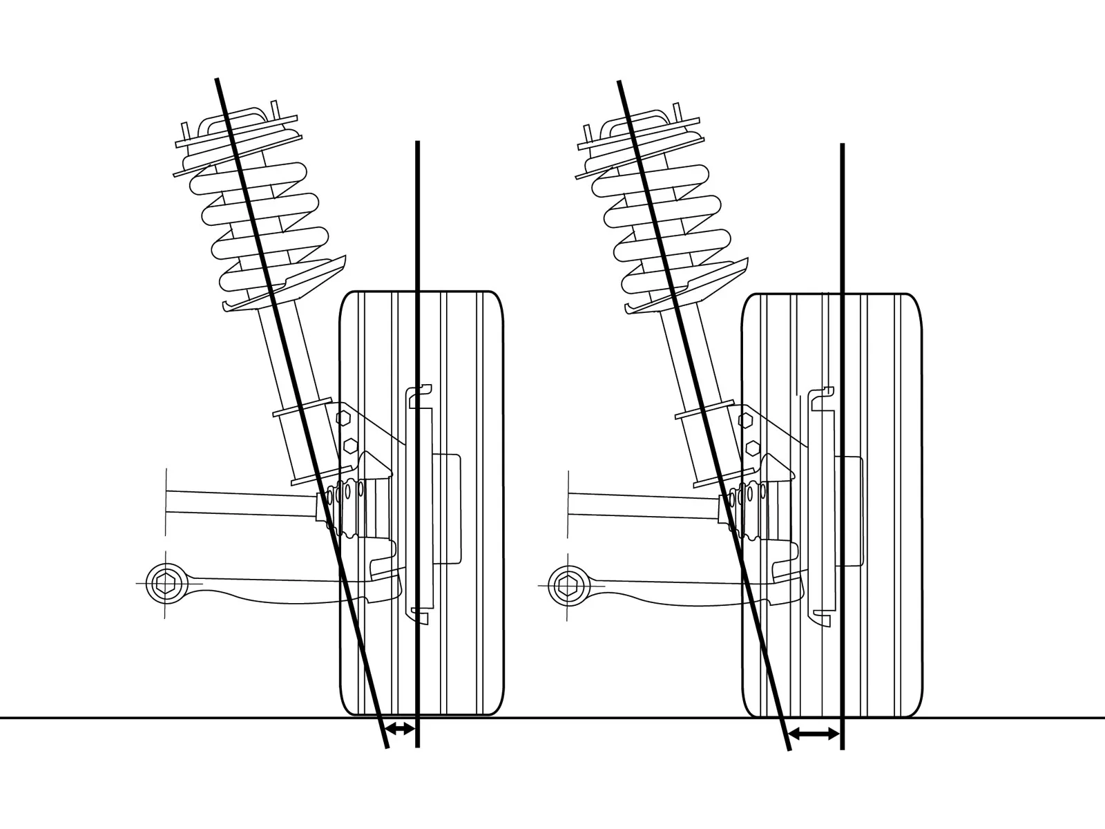

Scrub radius which image is correct?
I take it the first is just displayed more accurate? When you add camber using the strut holes it doesnt effect the scrub radius since its the intercept of the lower joint. But If you were to place the suspension top mount inwards you would effectively being gaining a negative scrub? If it was already completely neutral say.

As said. it's the first one, upper strut mount to balljoint, your kinematics are always to pivot points.

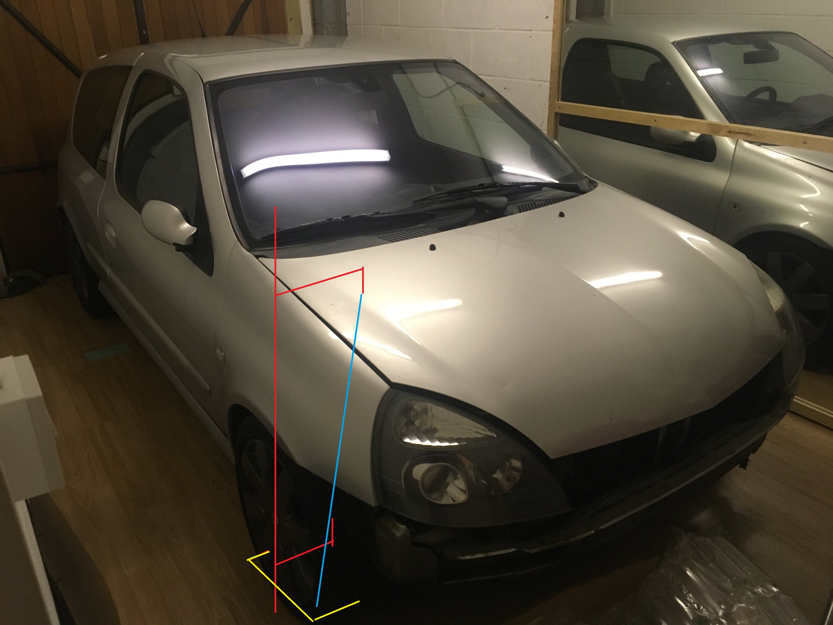

Any easy ish ways of checking what it is? I thought about taping around the wheel and putting a post up aside the car where Ill have a couple of make s**t arms that hover over and under the joints, mark around the post so when I move the car Ill put string or stick along the 2 points touching the ground.

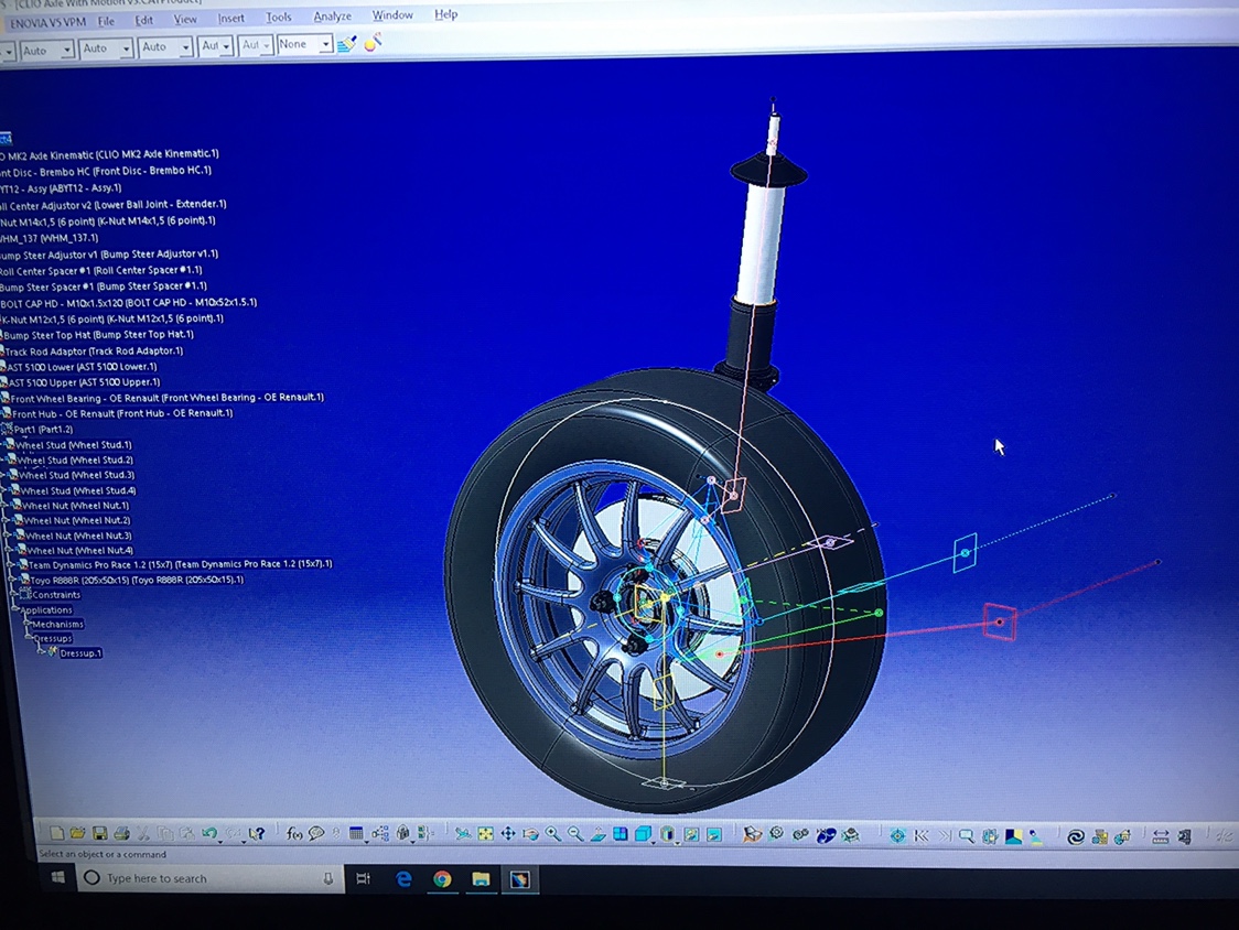

This is no real easy way to measure it.. I’ve modelled the front end in CAD though, so can work out the standard geo, then move the top mount and tell you what it would work out at. [emoji1360]
That looks great! Better than string :S
