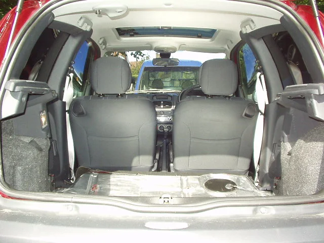

Total cost was £700, £500 for Recaro's from Renault and approx £200 (bought a few things) for the rears from ClioSpares. Very happy with them, tbh the pic does make them look quite mismatched, they are, but not so bad in the flesh :D

I rarely have rear passengers and am not really into 'doing up' the look of cars but they really improve the overall apperance imo. tbh no one has commented on new rears but the old ones had a fair few comments of 'they look out of place/ low spec'.
