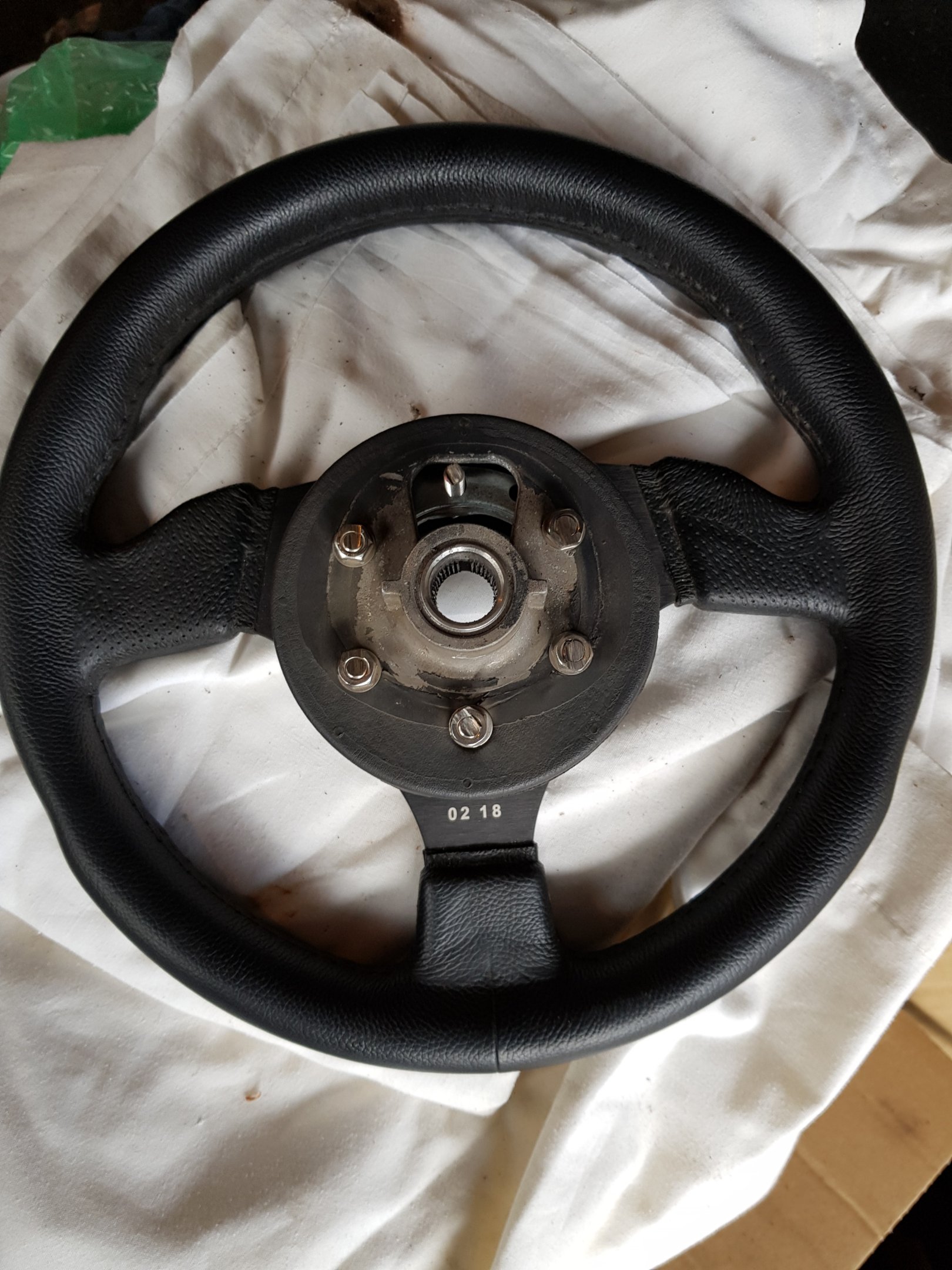

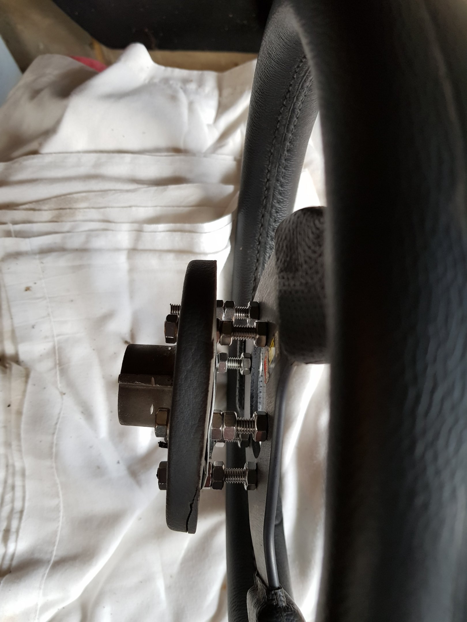

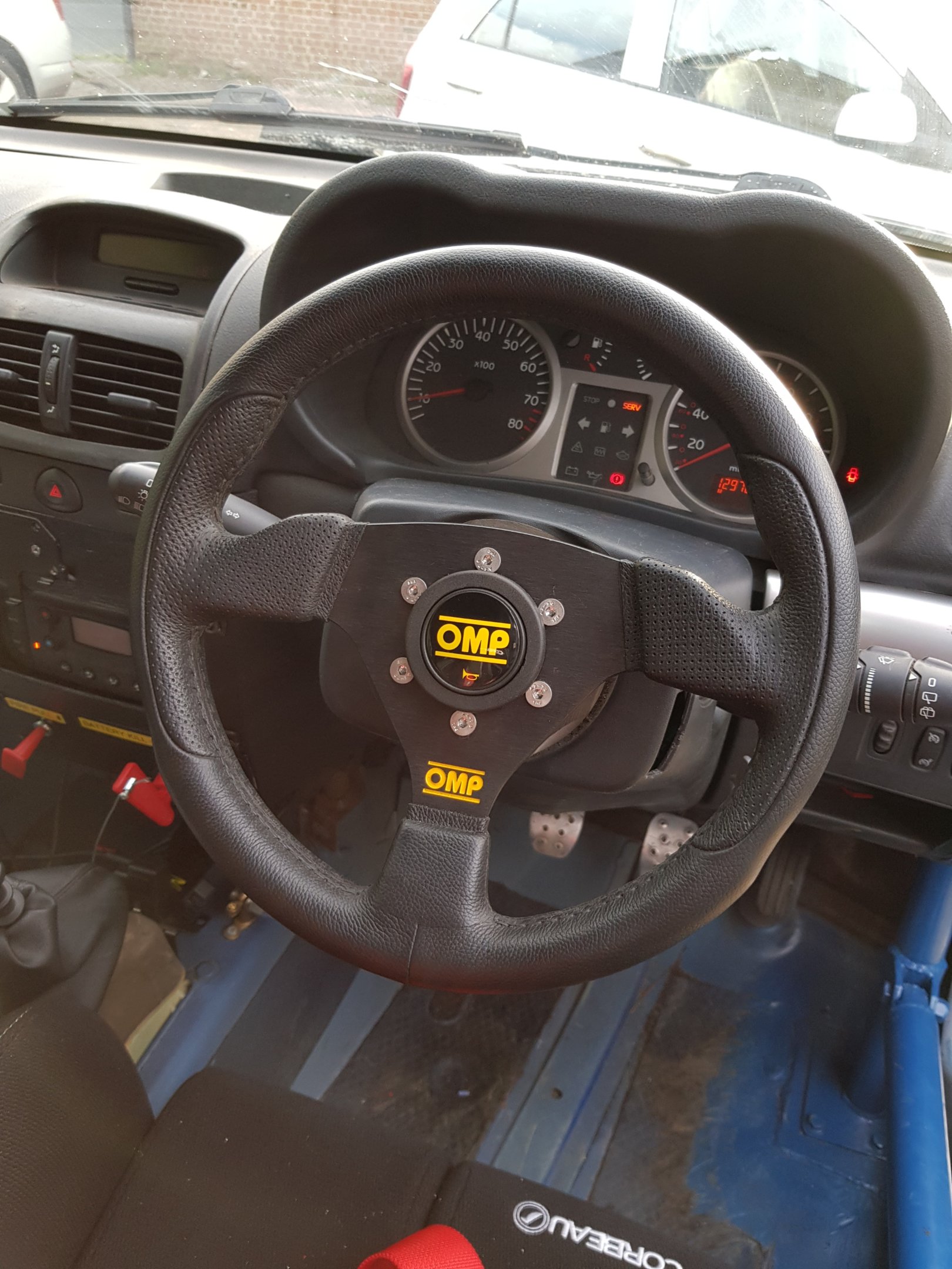

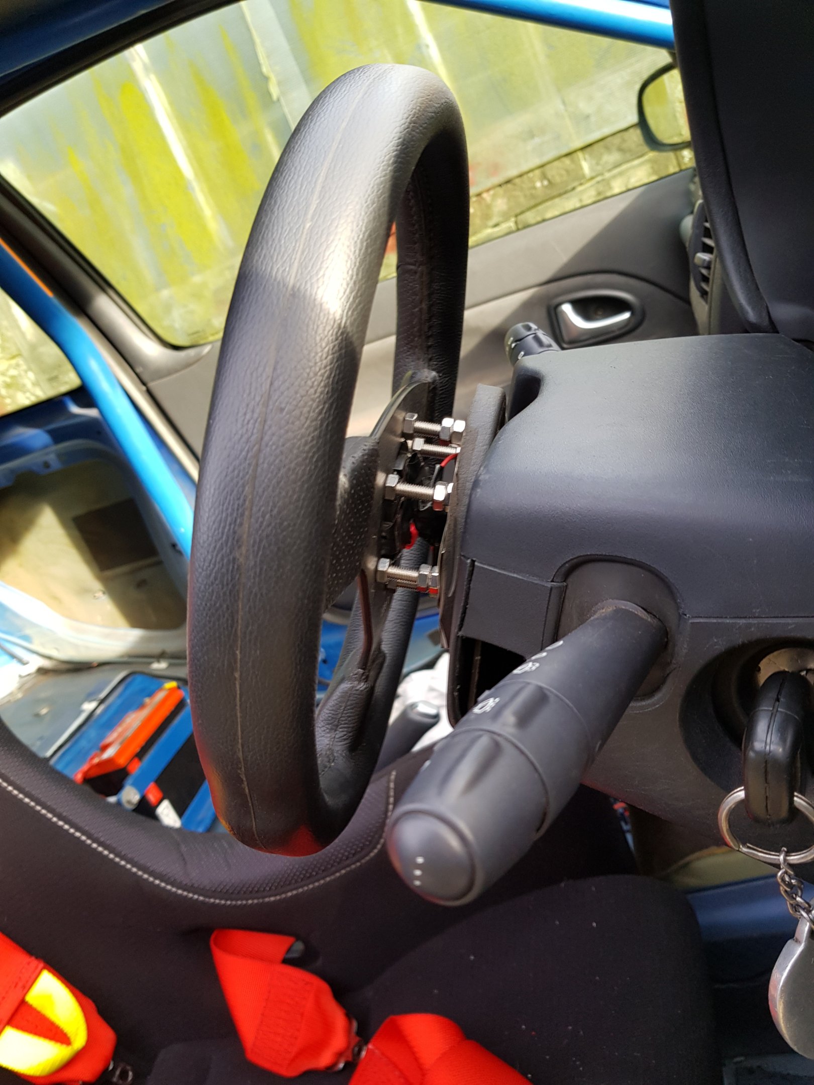

Just to round this thread off I came up with a rather pikey but cheap solution to my lugless steering boss problem.
Surprisingly pleased with how it worked out.
Basically cut out the metal centre of the OEM steering wheel and drilled out bolt holes to match the OMP wheel to make a new 'boss'
Used long stainless countersunk bolts and nuts to both fit the wheel to the boss, and to adjust the spacing as shown in the photos.
I could have ordered black bolts, I had the stainless ones already and looks don't bother me that much if it works.
So if you want to save the cost of a steering wheel boss, and have adjustable reach, but don't mind looking a bit odd !

The bolts are M6 stainless, so a bit stronger than the ones which OMP supply with their boss.
However, always conscious of Health and Safety, particularly my own, I would be really grateful if you could point out the actual issues......many thanks
The M6 stainless are stronger than the omp ones.... How did you work that out?
OMP ones are 12.9 high tensile. The ones you've used will have a poor shear load.
Thank you James, I must admit I was just going on the increased diameter of the M6 bolt, but it probably only has 8.8 shear strength. So not sure how much load a 12.9 M4 bolt will take compared to an 8.8 M6 bolt, but will check it out, unless you can tell me, which would be really helpful.
So if we upgraded to 12.9 bolts what then would be the issues?
In what scenario is the steering wheel likely to take a really high shear load, and how much torque can we actually apply to the wheel?
I would have to have the strength to break those bolts before they fail, nothing else is holding the wheel against the shear applied to the bolts except my hands.
I would respectfully suggest that if such a force was applied back through the wheel it would be ripped from my puny grasp.
Please be assured I am not looking for an argument at all here, and given logical scientific reasons for why this unsafe I will ditch it.
