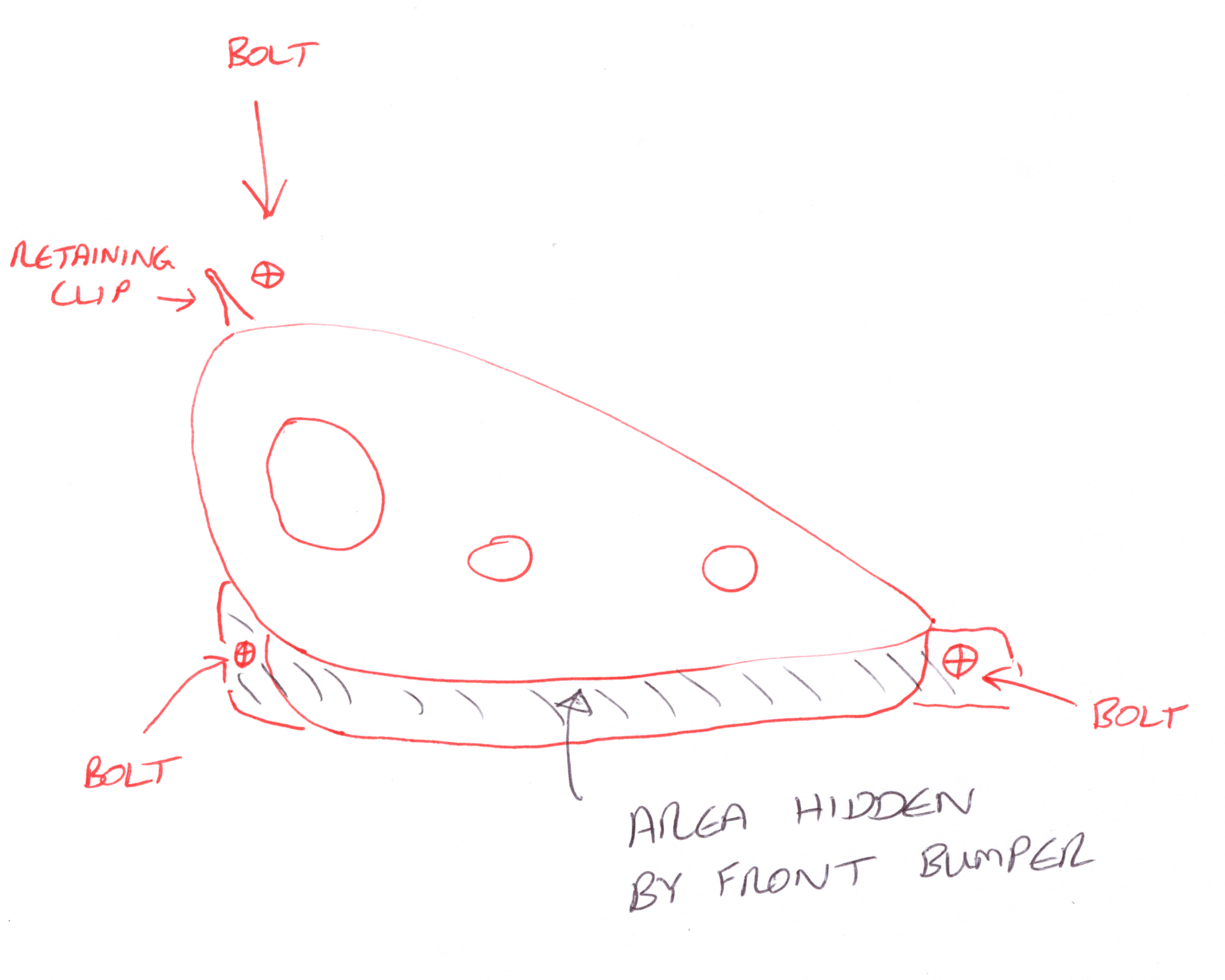

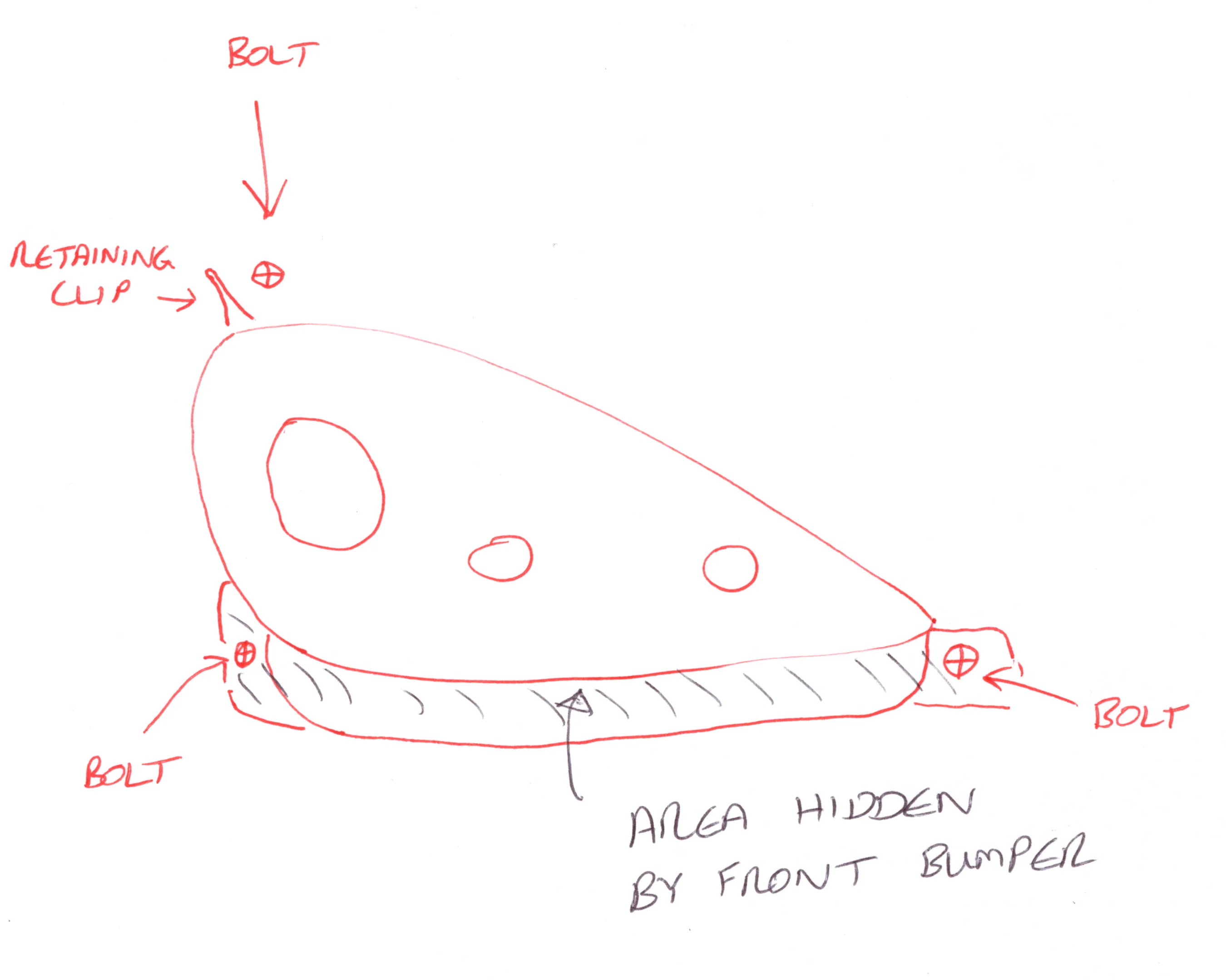

Not possible to drop head light out without removing bumper?
Darren S
Yep - two of the three are hidden behind the bumper. Looking at the driver's side headlight front-on (and wishing I had the drawing ability of @mace) - here's a pizza slice/headlight image showing you approximately where the bolts are.

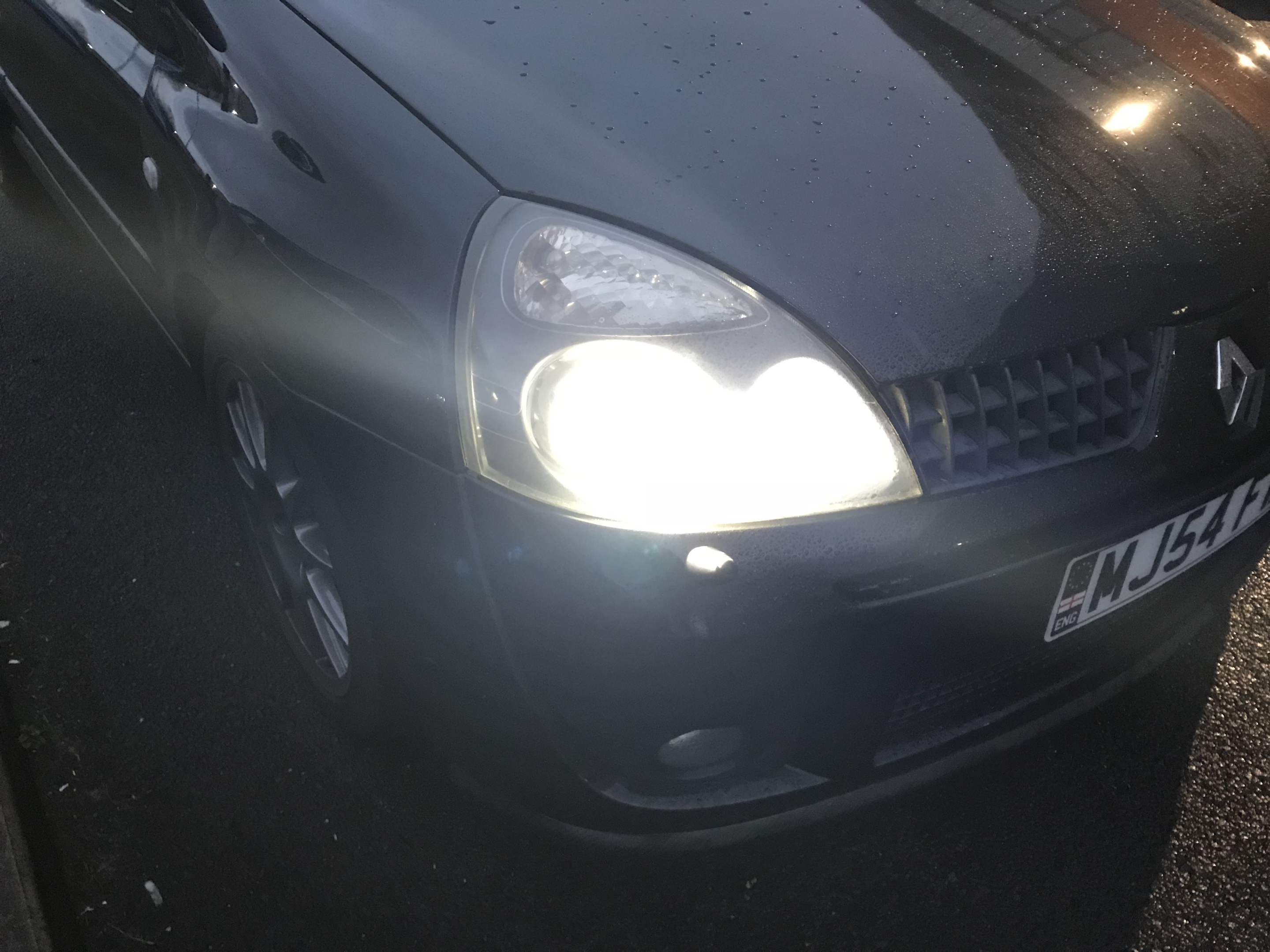

If you go for the 6000k bulbs on that eBay link above - they look like the below. A very (very) slight blue - just more white than anything. Not the best pic, but it gives you some idea.
