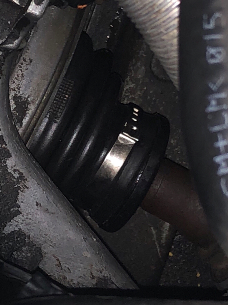

Does anyone find that theirs gets a little oil/grimy around where the gearbox seal/boot is clipped to the bearing on the N/S shaft? It doesnt drip oil but it does seem to have a bit of greasy oil residue on it. ive replaced the boot with a new one and a new clip on the bearing done with a proper CV boot crimp tool. I guess if its not leaking/dripping it'll be fine, probably just me being paranoid.

Think mine is just grime on the back of the disc that sits in front of the bearing on the shaft which gets a bit runny when hot, I guess it’ll subside over time or if I clean it. I changed the seal/boot for a new one as the one I had on the second hand shaft, whilst it was still sealing with a new clip fitted, was however exposing the end of bearing which you could see from above. Comparing it to the new one - the ends that slide over and cover the bearing fully were splayed a bit with age outwards so when fitted it was pulling off the bearing ever so slightly.
A little thing I know but I wanted it right
As you can maybe see in the picture of how it was before pulling off the bearing slightly

Well it was dry for a short while - took it on a 60 mile round trip yesterday and checked the back of the disc on the driveshaft and there was touch of gear oil on it. My thinking is maybe I over filled the box as I did use a large diameter hose to fill the box, I opened the butterfly level nut up today and 200ml maybe ran out but not loads. Very confusing this as the boot and clip on the bearing are as tight as possible and can’t be pulled off or moved and as said the boot is new.

I still get occasional leaks of oil from where the boot/clip is attached the bearing on the shaft.
It can go for days with it being bone dry and I can drive the car very very hard and nothing happens, yet today I had 3 people in the car and was doing a lot of a town driving/ full lock stuff and got home and the ran my finger round the clip ( as doing this is a regular/daily thing for me now) and it was sopping wet with gearbox oil. the clip is on the bearing tight as can be - I used the proper size clips with a crimp tool.
I’ve let a bit of box oil out the filler hole as it may have been a tad over filled but I’ve tried that method before and it doesn’t seem to correlate between the leaks and non leak days? I think a new full shaft from k-tax might be on the cards soon if it carries on causing me problems.

Its sealing at the box end no problem, its the seal on the little bearing that the shaft passes through and how this is clamped. I would doubt the movement in and out is anywhere near 2mm as well
  Clio f1 r27
You maybe better off with a jubilee clip around it rather then the clip they use.
You can only get a certain amount of clamping force with a standard clip. In your case you may just need a little more of which the jubilee will give you.
  Inferno 182 & Saxo
I suppose I could try a jubilee with the insert so it makes a the clamp load around the full circumference but renault use the crimped clips themselves and generally dont have issues. What I find is most jubilees are too wide then they actually make the ends of the boot lip splay apart off the bearing rather than sitting nicely over it with the lip of the rubber boot sitting up against the back of the bearing itself.
