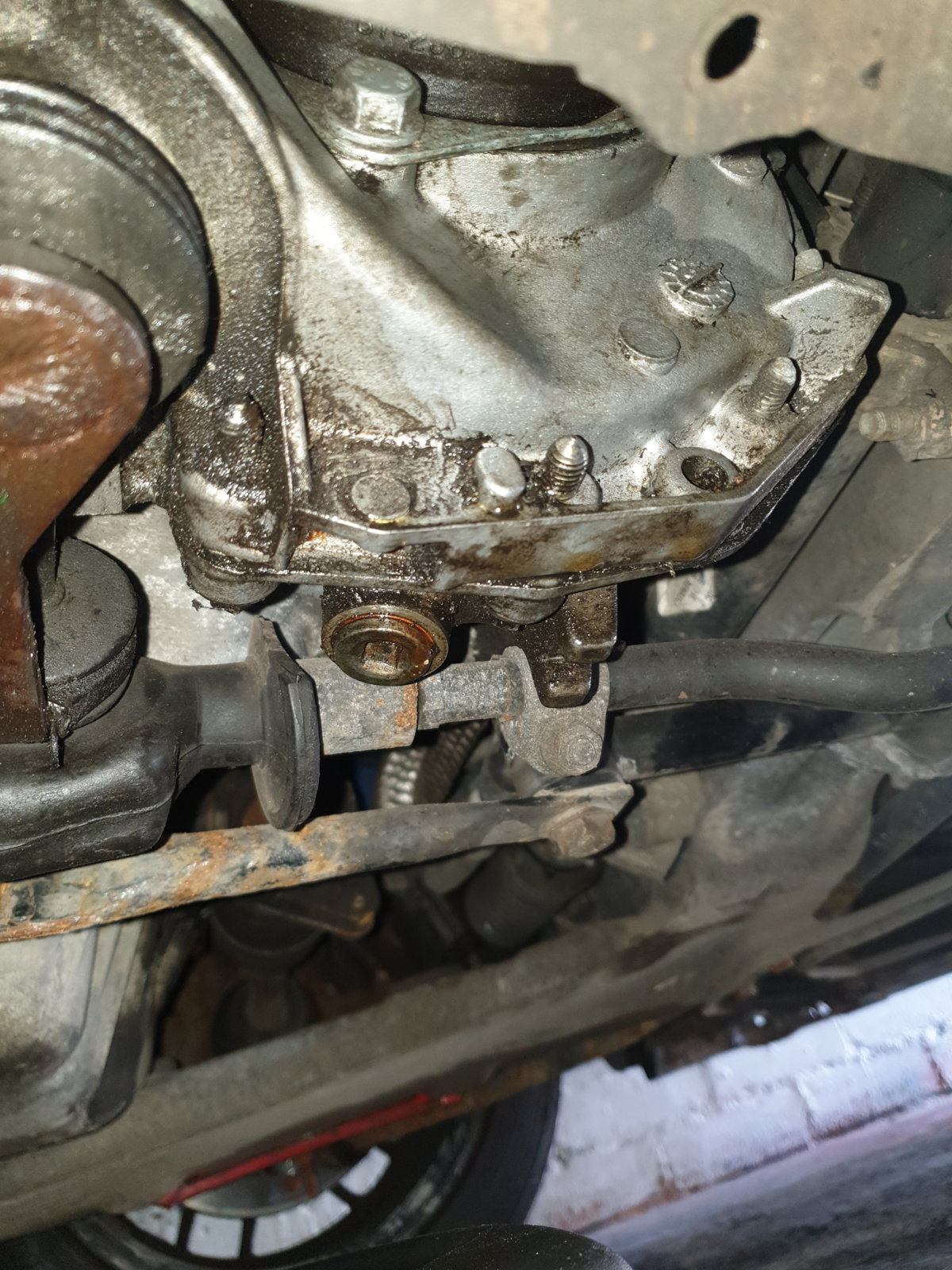

So walked in the garage last month to find the clio had dumped all its gearbox oil over the floor over winter.
It was pretty gunked up under there and i couldnt quite source where the leak was from. Iv cleaned it all up and topped the box back up with some fresh random box oil i had just to find where its leaking from.
Any likely seals etc that it could be? Is it possible that because iv fitted coilovers over winter and got around 3 degree camber on the front it could have the driveshaft sitting differently/with a worn seal and leaking from there?
Im aware without looking at the car yourself its opening an endless box of potential answers but just scratching my head on this one as no noticeable trace of the leak

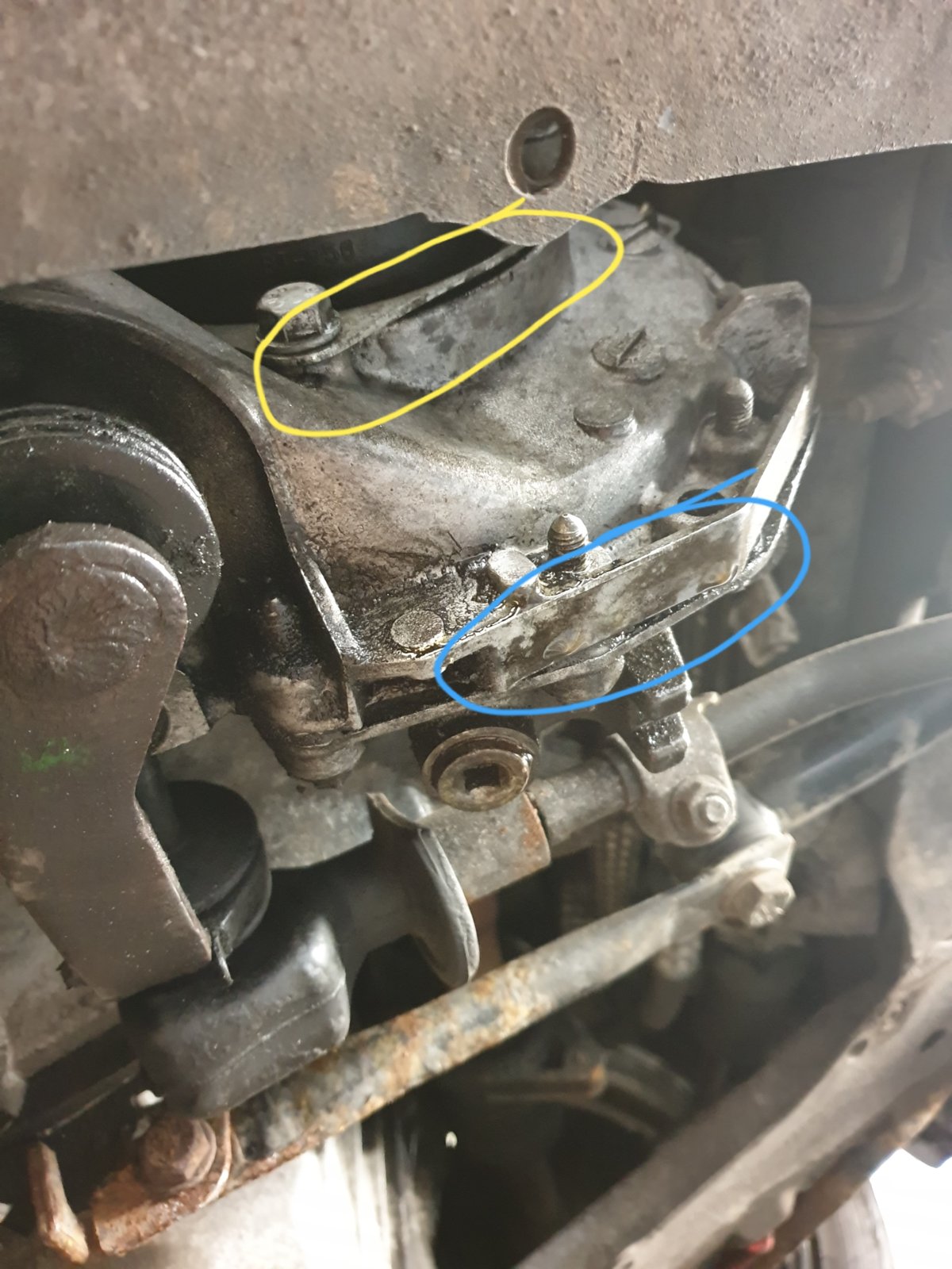

Managed to get time to check it again, its definitely leaking, doesnt look like the selector shaft bit as oil is at a higher level that that is. Theres afew drops accumulated in the blue circle and around the drain plug and seems to have a very light trail from the yellow circle area. Any suggestions on what may be causing it? @NorthloopCup
