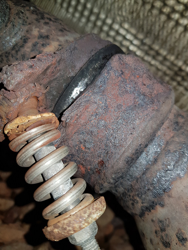

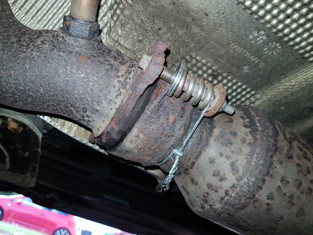

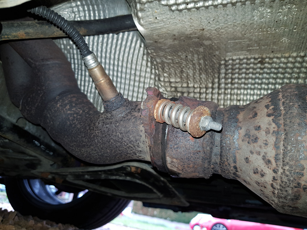

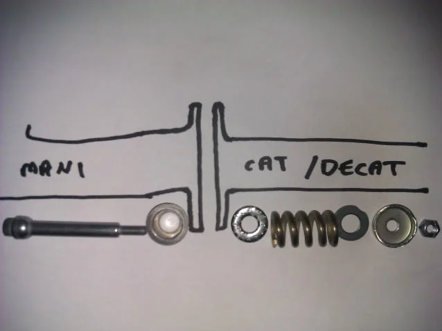

One bolt was AWOL, the other was hanging on. Looks like it has been held on by 1 bolt for a while, then today it gave up. I've bodged it with some wire to stop the bolt springing off to the side. It won't last long though. What are my options? Do away with the olive joint and weld the whole thing up?

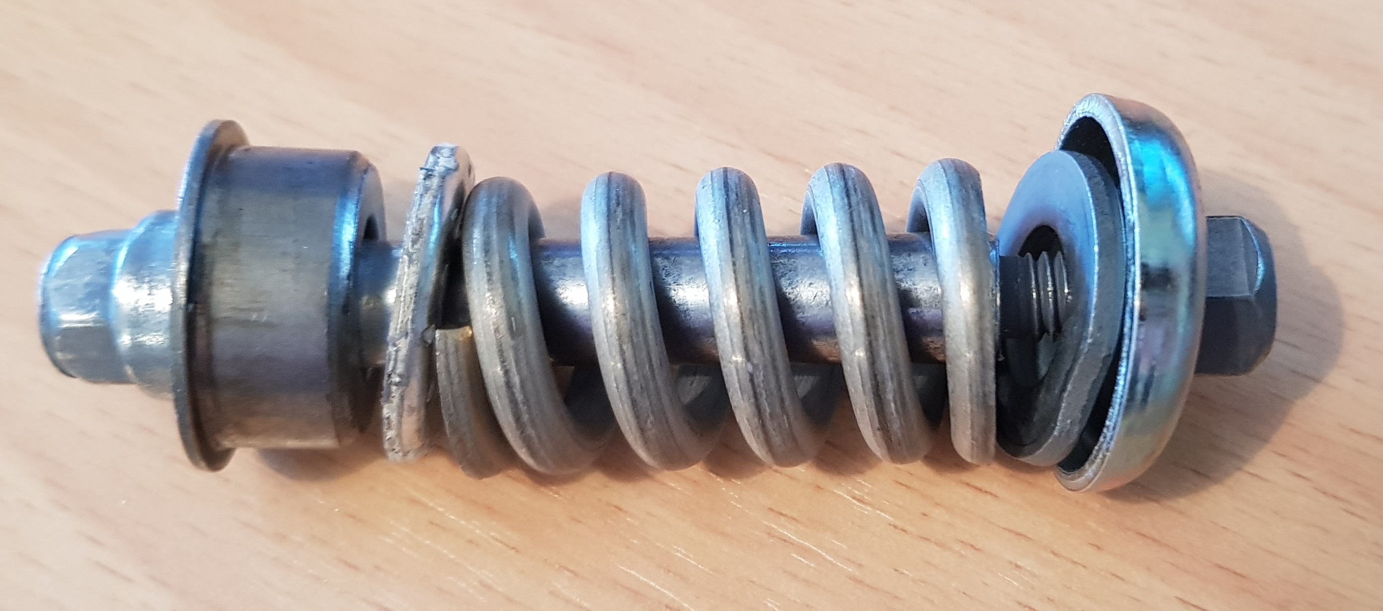

Looks like the little bucket the bolt holds into has gone, you should be able to get a new one in the hole.
Comes as part of the Renault fitting kit I think.
Little bit next to the bolt in this picture

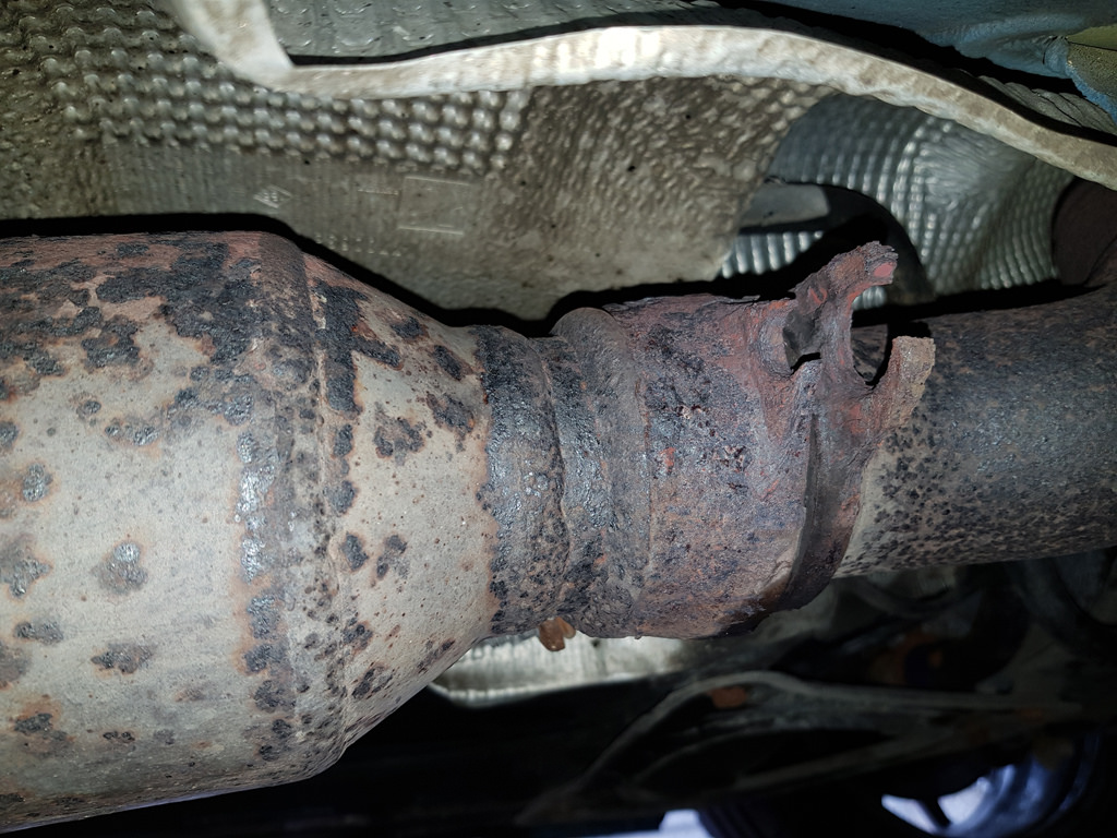

Yeah there isn't much meat left on the lugs. Especially on the cat end. It would be brilliant if a fitting kit would sort it though. Might be worth trying for £20

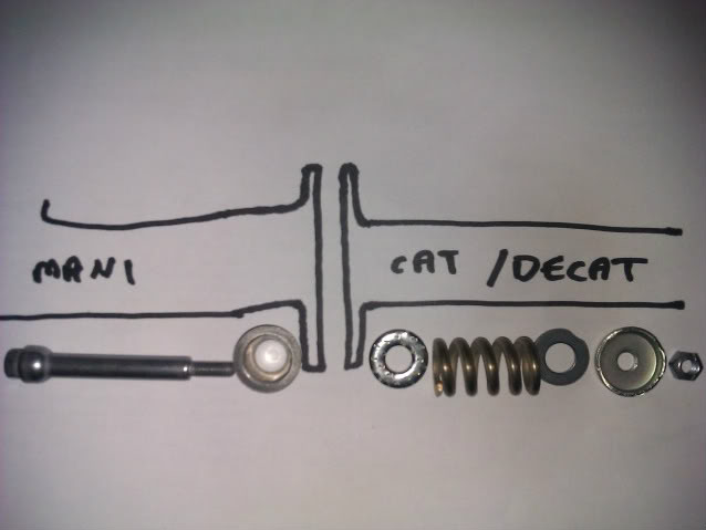

It's worth a try . It's not really driveable the way it is . Have a look at that kit I knocked up . All the parts are available on ebay . You can reuse your springs and the end caps that they sit in .
I'm going to give the local Renault dealer a ring tomorrow because I wanted it sorted ASAP. They probably wont have it though so I'll have a look at the stainless option.
Are the lugs on the cat supposed to be C shaped or an enclosed hole? Just because when I was tightening up that bolt it just wanted to slip off to the side. Which is why I used the wire

People do cut and re-weld the cats so it's possible if you could find a replacement part.
A new decat pipe is less than 50 quid tho, a cheap generic cat is 70.
Should be a hole not C shaped, but they do seem to rust through and become C shaped . They are 12 ish years old now .

Bit late now but mine was like that, I just welded a couple of nuts on to repair it been fine for the last few years.
