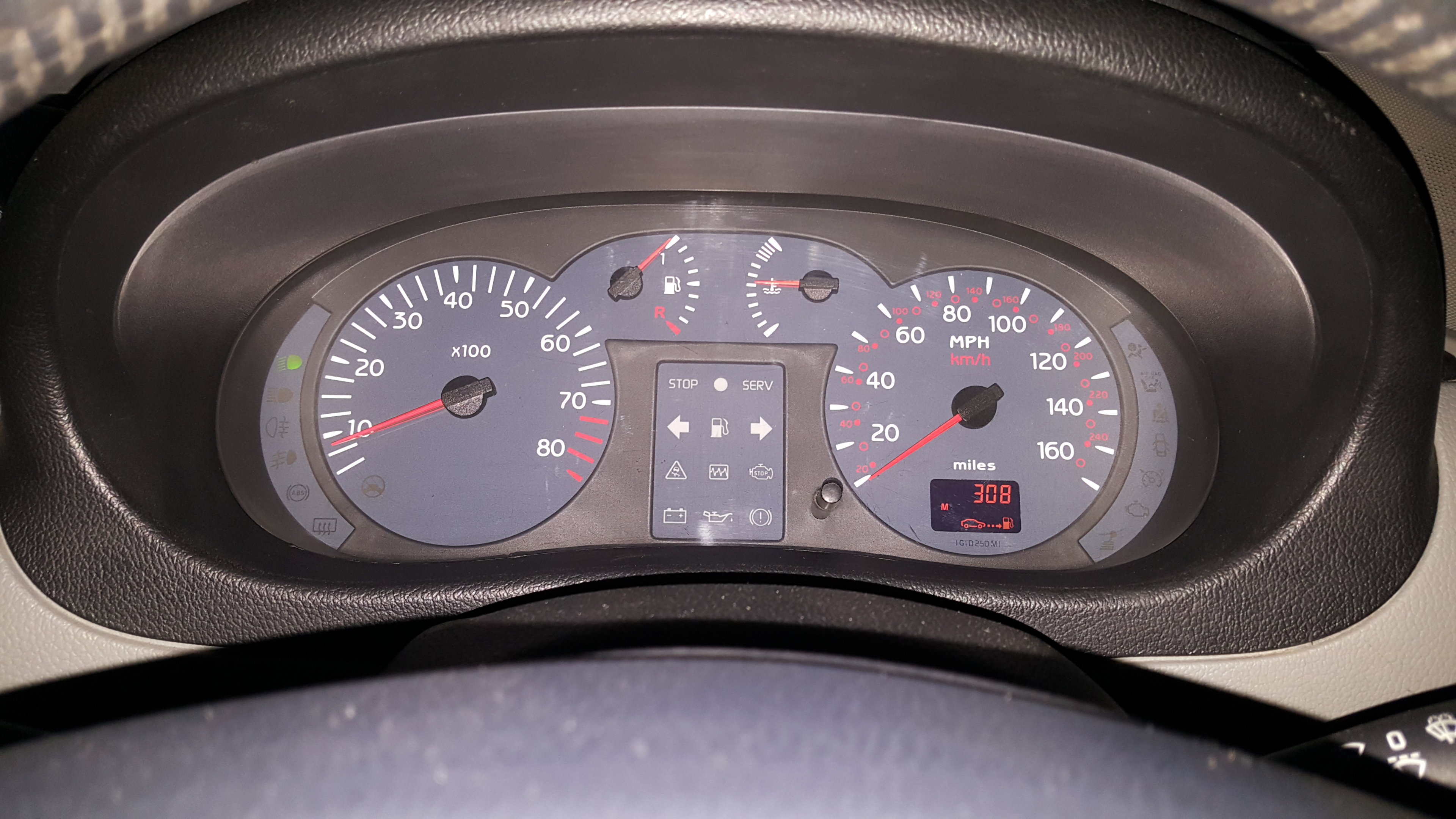

Your fuel gauge makes me want to cry. ?
Yours not sorted yet mate ? I cant believe it still had just over half a tank of fuel left after going on track. Mpg had only dropped to 26? drove home on the fuel left in and still got 50 miles left on the range. Runs on fresh air compared to the meganes !

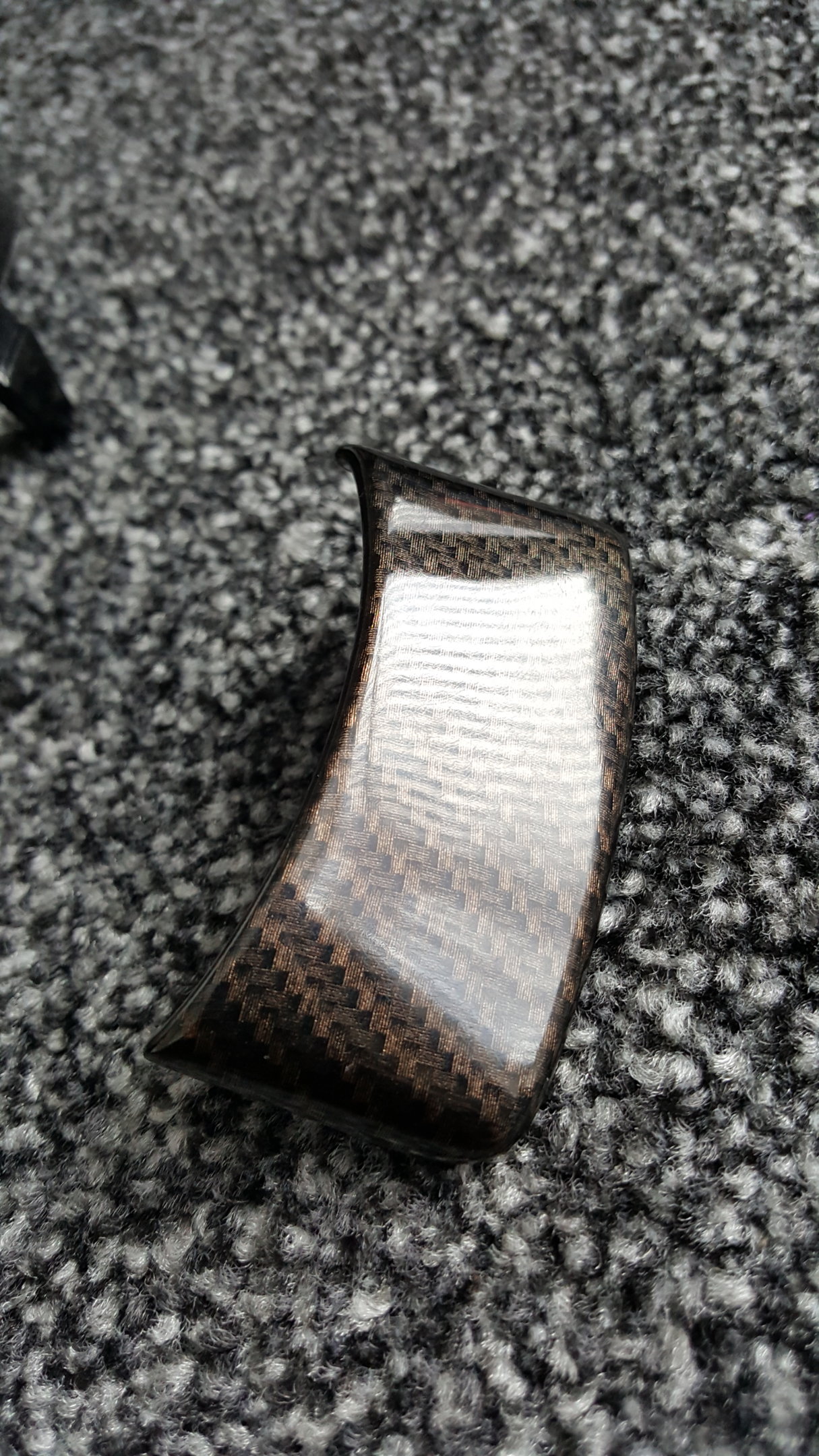

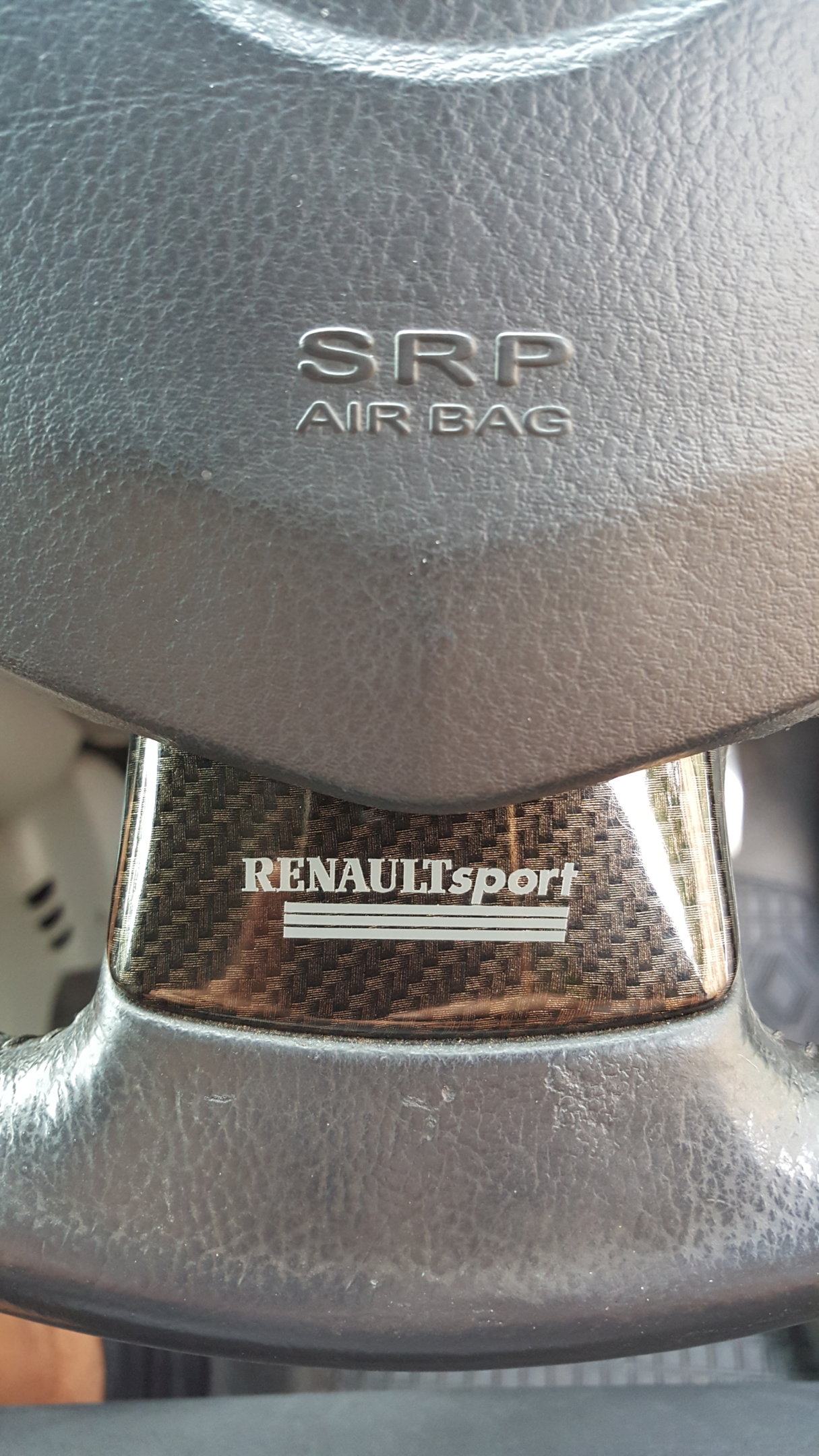

Had the tailpipe trim on the megane hydrodipped so chucked the steering wheel insert in at the same time to tidy it up as was roughly painted black before
Fitted with ebay Renaultsport sticker
Not bad for a daft £5 as already paid for the materials on the tailpipe trim.

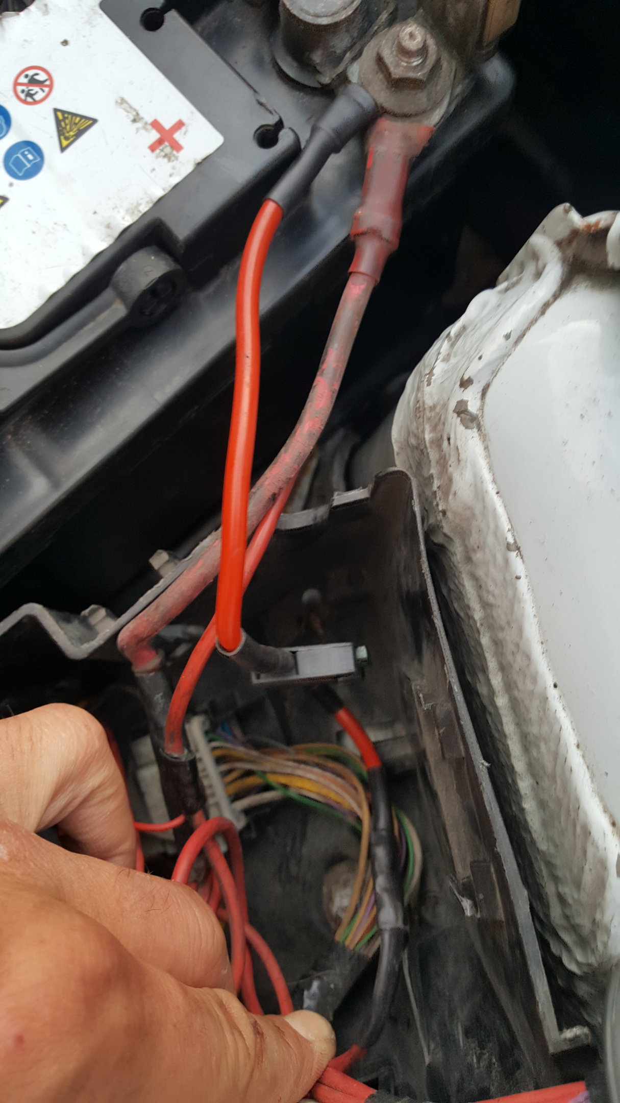

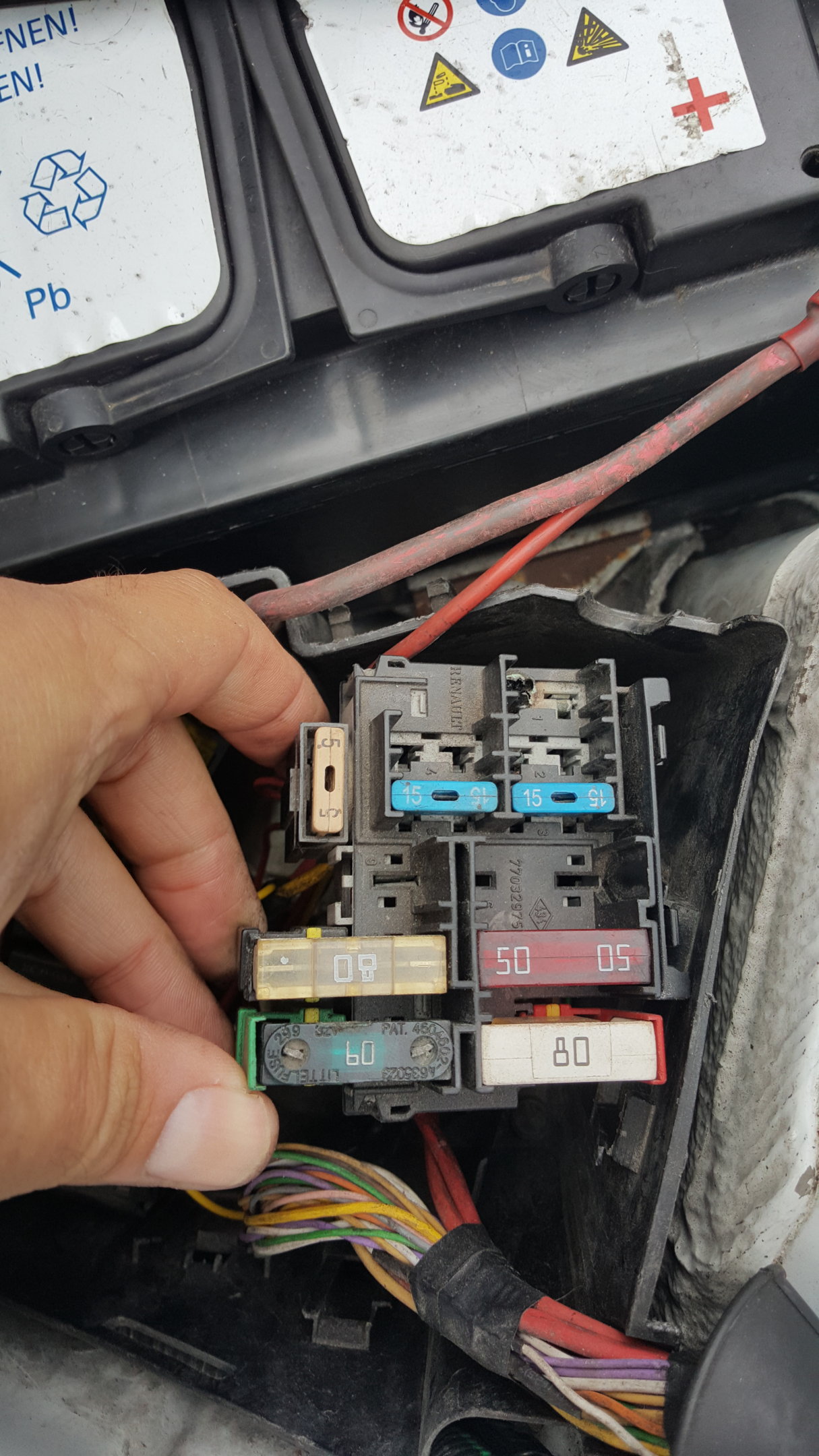

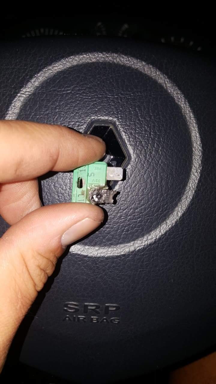

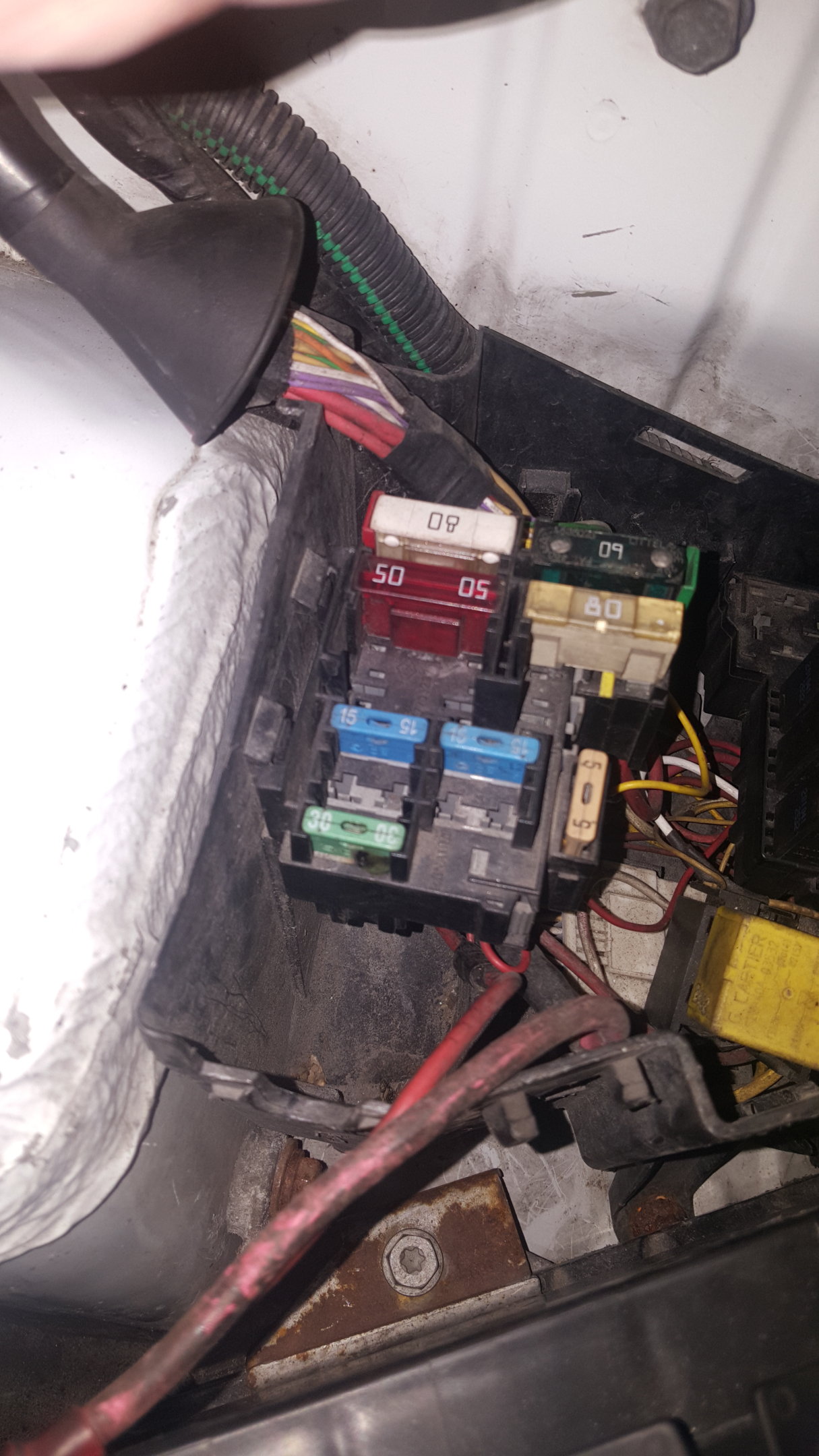

Had a blast out in the Kangoo up to Darlington tonight to drop a gearbox off. On the way back the engine coughed mid roundabout which seemed strange but stayed running so did not think much of it. Pulled up in Tesco at Middlesbrough to discover the 30amp fuse for ecu in engine bay fusebox was melting down.
Fired engine up to try and limp it home and got 50 yards across the car park and it conked out with electrical fault on dash and solid red immobiliser light. Had the tow of shame off Aa to get home !
Aa man pulled fuse which snapped in half.
Going to check Lambda wiring tomorrow see if its shorted out anywhere. Hopefully easy fix fingers crossed.

Wiring fixed
Not sure what caused the fuse to melt - checked lambda wiring and appears to be ok - all i can think is a loose connection on the fuse ?
Fuse box pin is knackered so bypassed it with decent gauge wiring and new 30amp fuse & holder. Had it running for a while on the drive and no heat off the fuse where it was red hot after a min or so prior to repair.
Melted mess before
Repaired

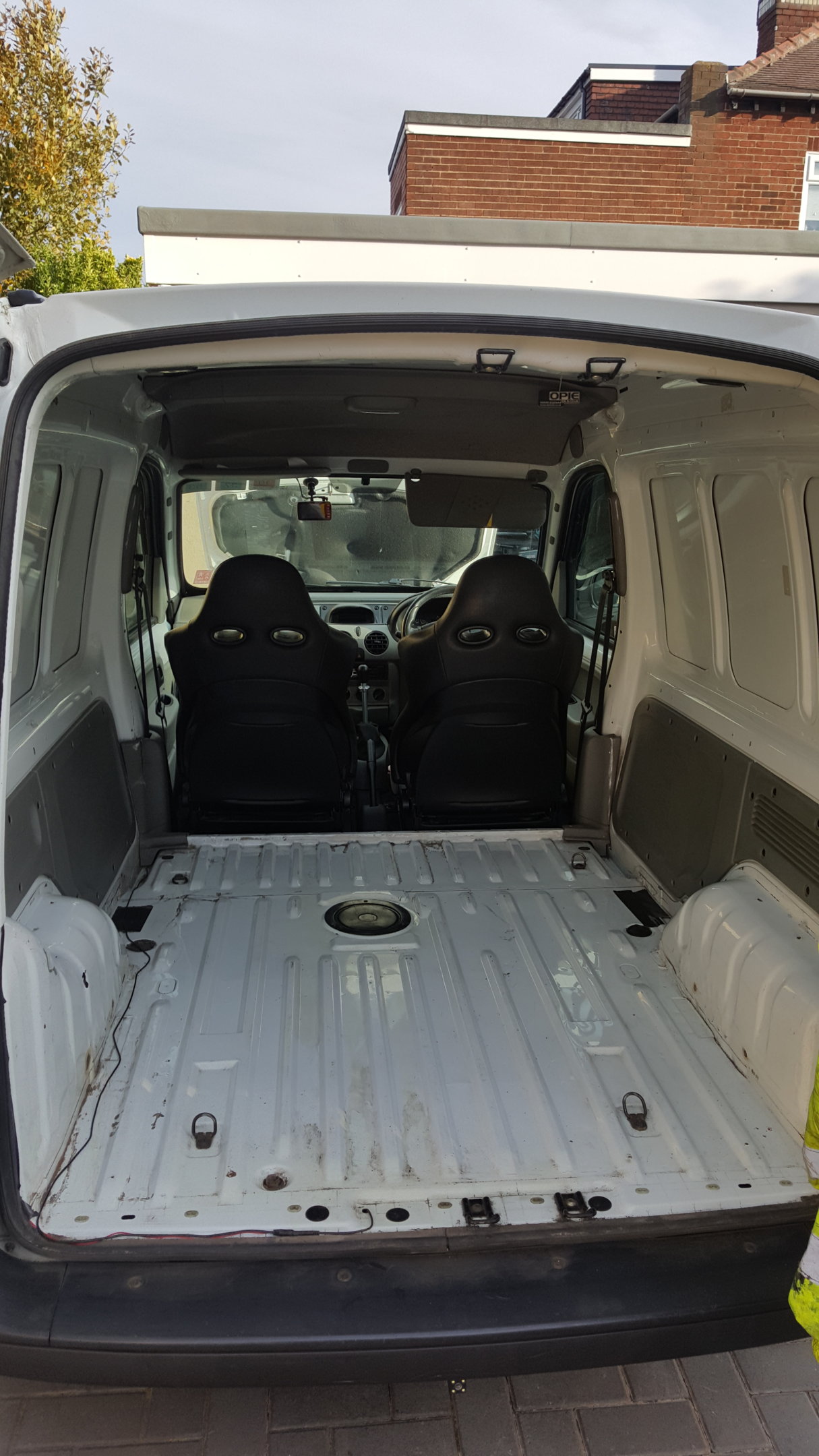

Also swapped my ply lining in the back for oem mat out of my mates Kubistar. Clean underneath ply with original plastics still fitted.
Much better

Seen the fuse melt a few times, has been down to bad connection.
I thought it could only be down to a bad connection as all the other wiring looks ok. I guess the 172's are getting to the age where the wiring is about shot - had to chop fuel sender wiring back 4" to get back to decent wiring as it was all black/corroded under the insulation.
  dan's cast offs.
a lot of the time problems are down to a bad connection, the terminals end up a bit loose so you can de-pin them and nip them up but there are a lot to do if you want to go over a full loom!!!!

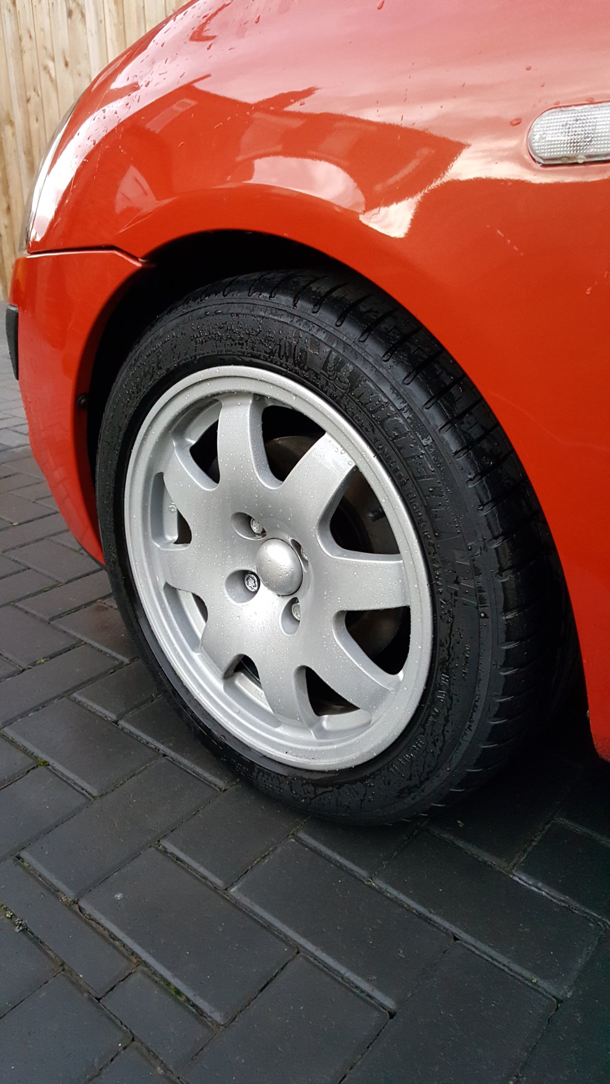

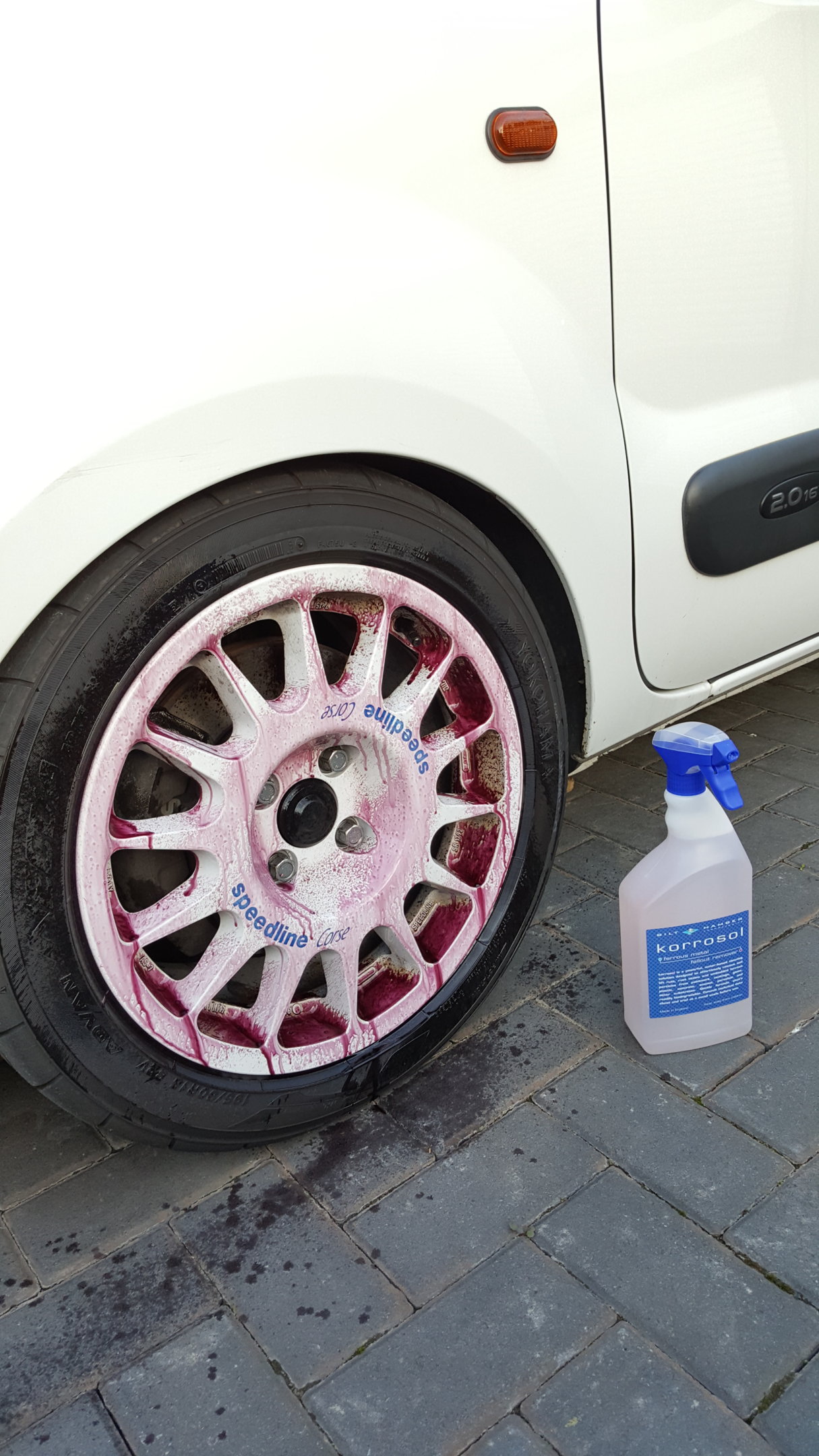

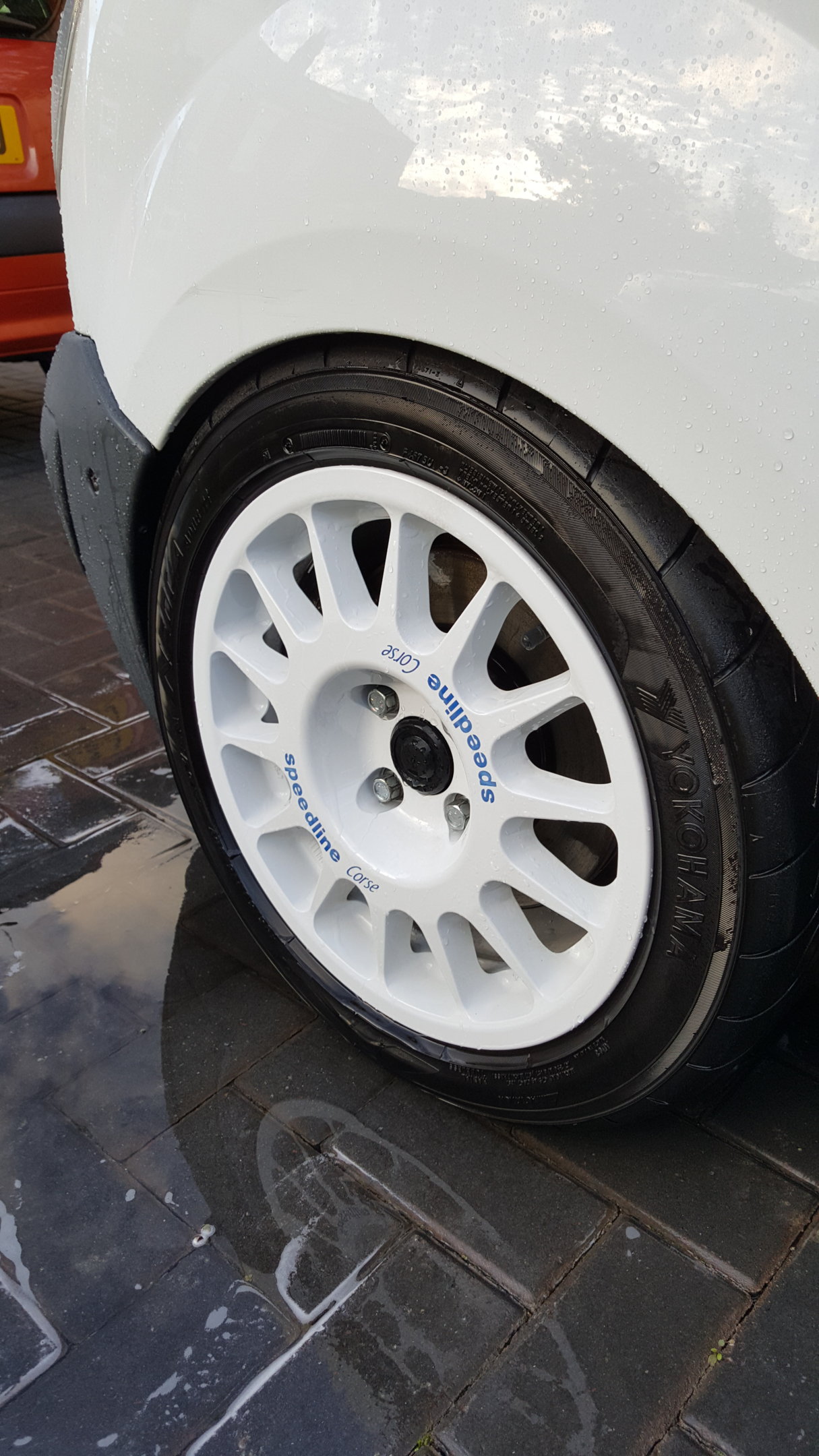

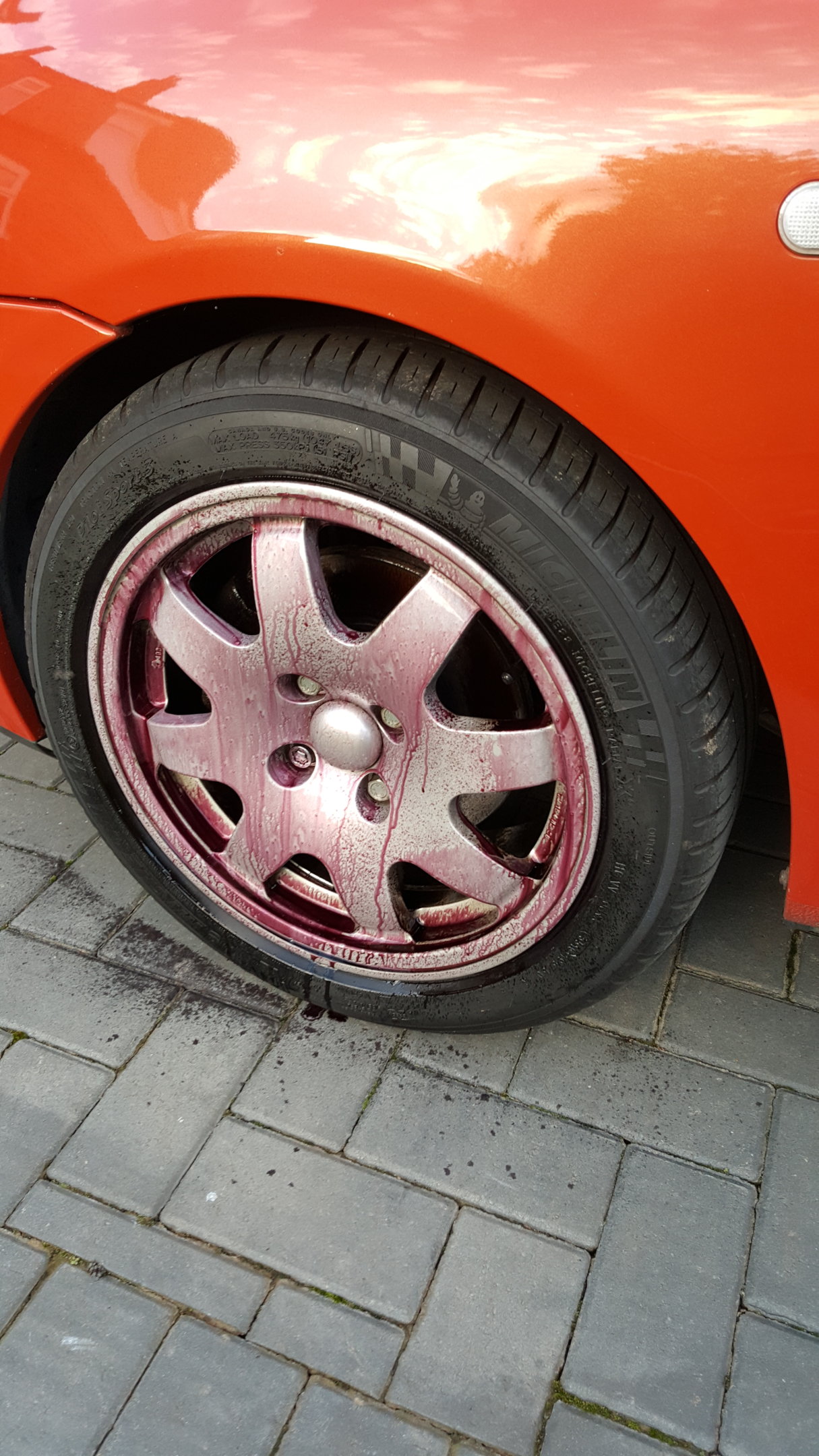

Tried out Bilt Hamber Korrosol on the wheels to remove some fallout after Blyton, great stuff. Really clings to the wheel and does as intended, let it dwell and power wash off job done.
Before
After
I tried it on my williams wheels on the dci which had some heavy fallout on after using them on the kangoo at Cadwell Park last year. Nothing seemed to touch the fallout, i assumed it would never come off. A couple of applications and some agitation and its gone.
Before
After

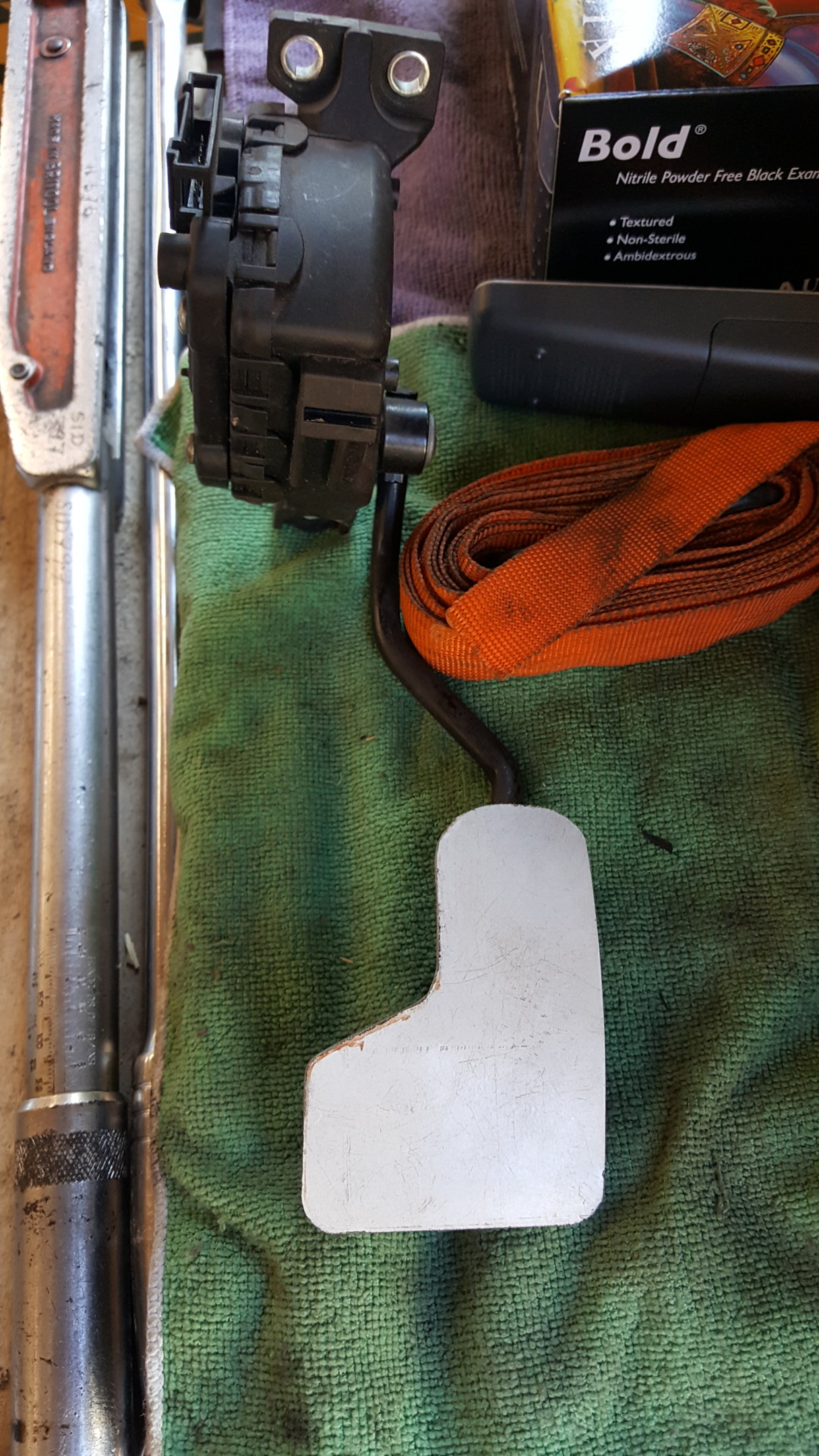

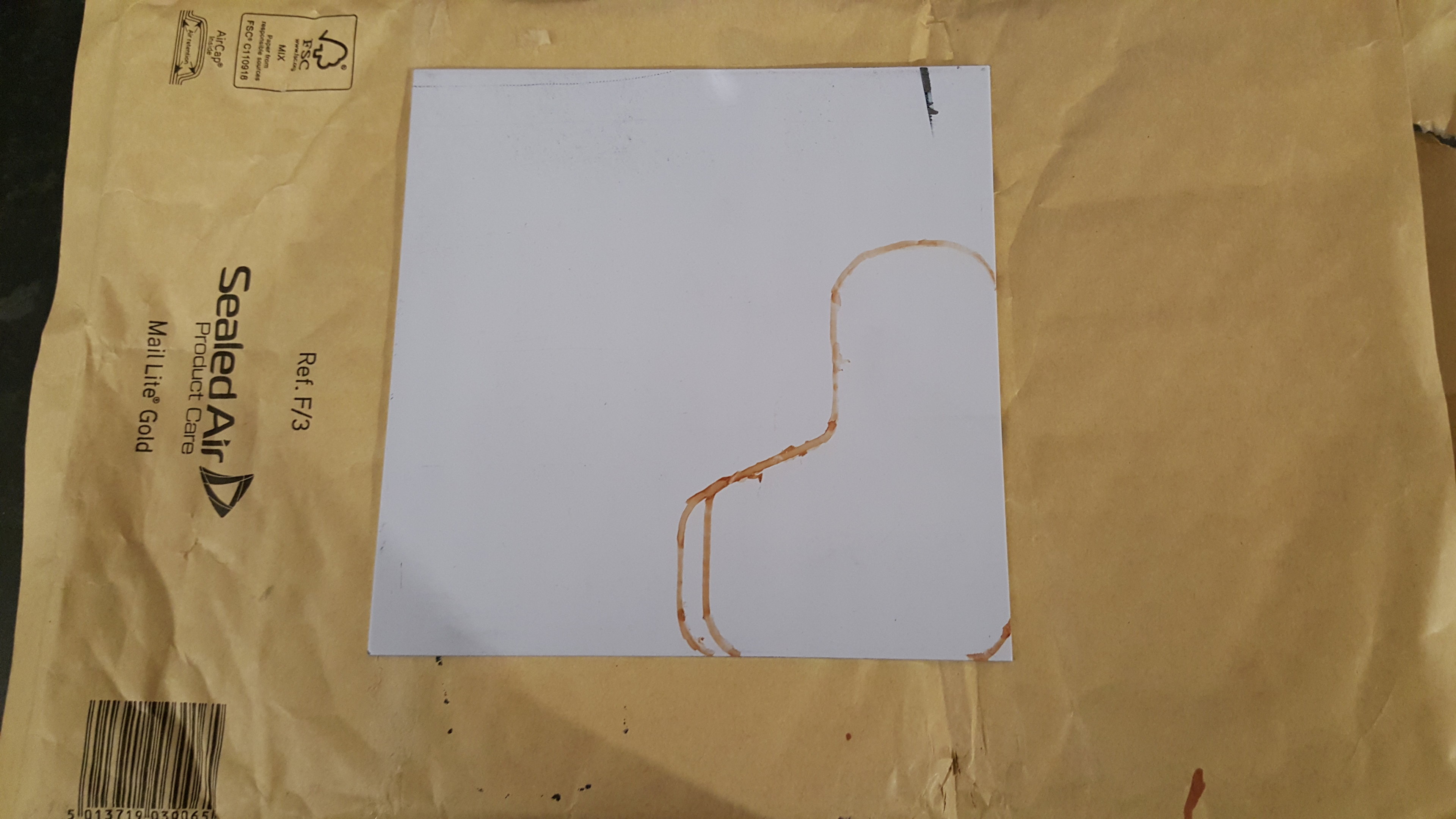

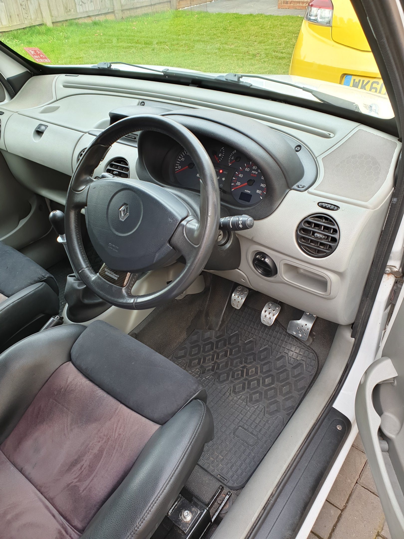

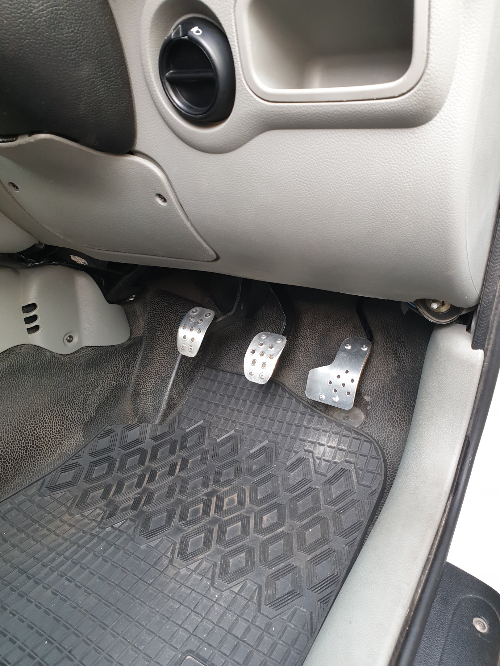

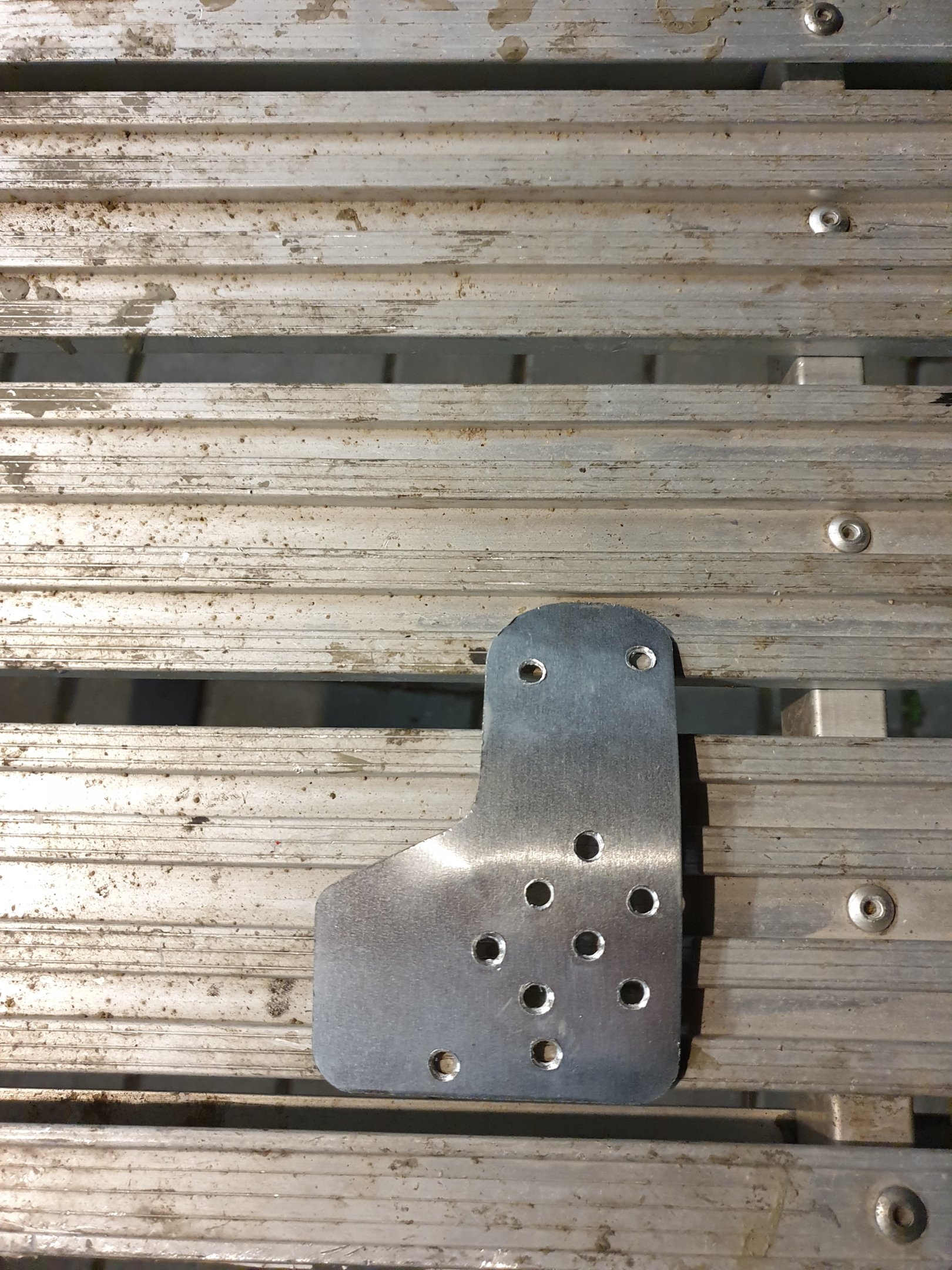

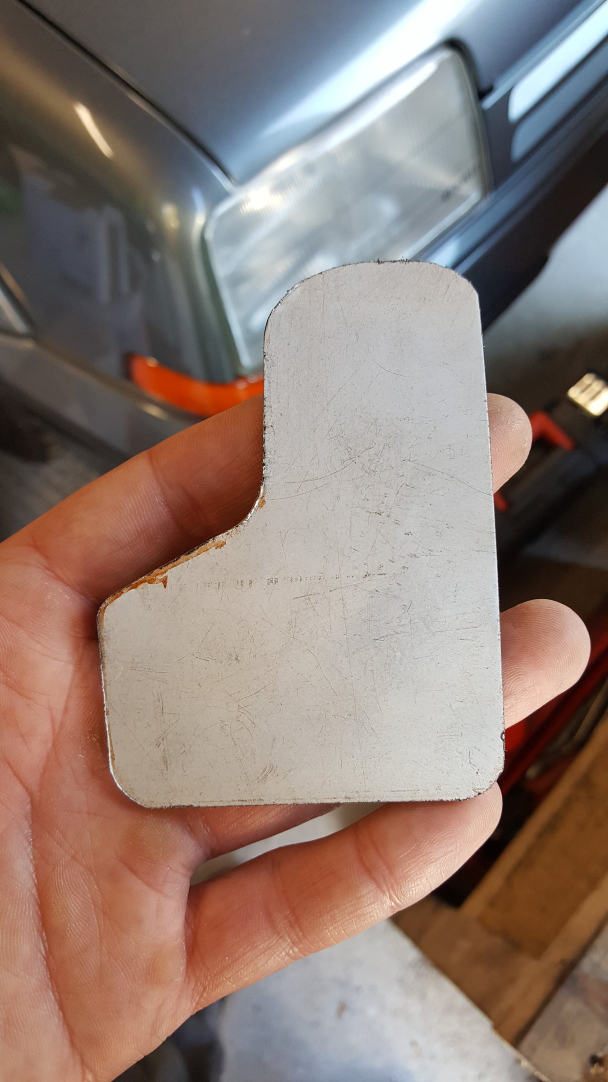

Ordered a small piece of 2mm alloy sheet to make a heel & toe accelerator pedal as struggling to heel and toe even with my size 11s. Marked out and ready to cut at the weekend.

Ordered a small piece of 2mm alloy sheet to make a heel & toe accelerator pedal as struggling to heel and toe even with my size 11s. Marked out and ready to cut at the weekend.View attachment 1389679
Well you know what they say about big shoes....

You got brake ducts? Only thing with steel wheels is that when you get them warm and push on them hard they flex[emoji23]
I have a few bits in stock for brake ducting, hopefully gte it on this weekend. Steels are quite weak, i have ultra rare et16 r5gtt cup car steels on my Extra and they bend for fun with a bit of kerb hopping on track. Ill stick with the heavy but solid 2118s on this as i know they can stand loads of abuse?

I have a few bits in stock for brake ducting, hopefully gte it on this weekend. Steels are quite weak, i have ultra rare et16 r5gtt cup car steels on my Extra and they bend for fun with a bit of kerb hopping on track. Ill stick with the heavy but solid 2118s on this as i know they can stand loads of abuse[emoji16]
At least they don’t crack like Superleggeras[emoji23] Or a turini, amount of them I’ve seen bent beyond belief is just stupid

Great stuff! A while back I was trying to design a couple of blocks to go under the pedal but just ended up with a few washers instead.
Thought about the washers too that would probably do the job. Alloy sheet cost £2.50 will see how this fairs. Might adjust the height of the acc pedal if poss, looks like it can be removed and adjusted. Not sure where the optimum height will be though compared to brake pedal.

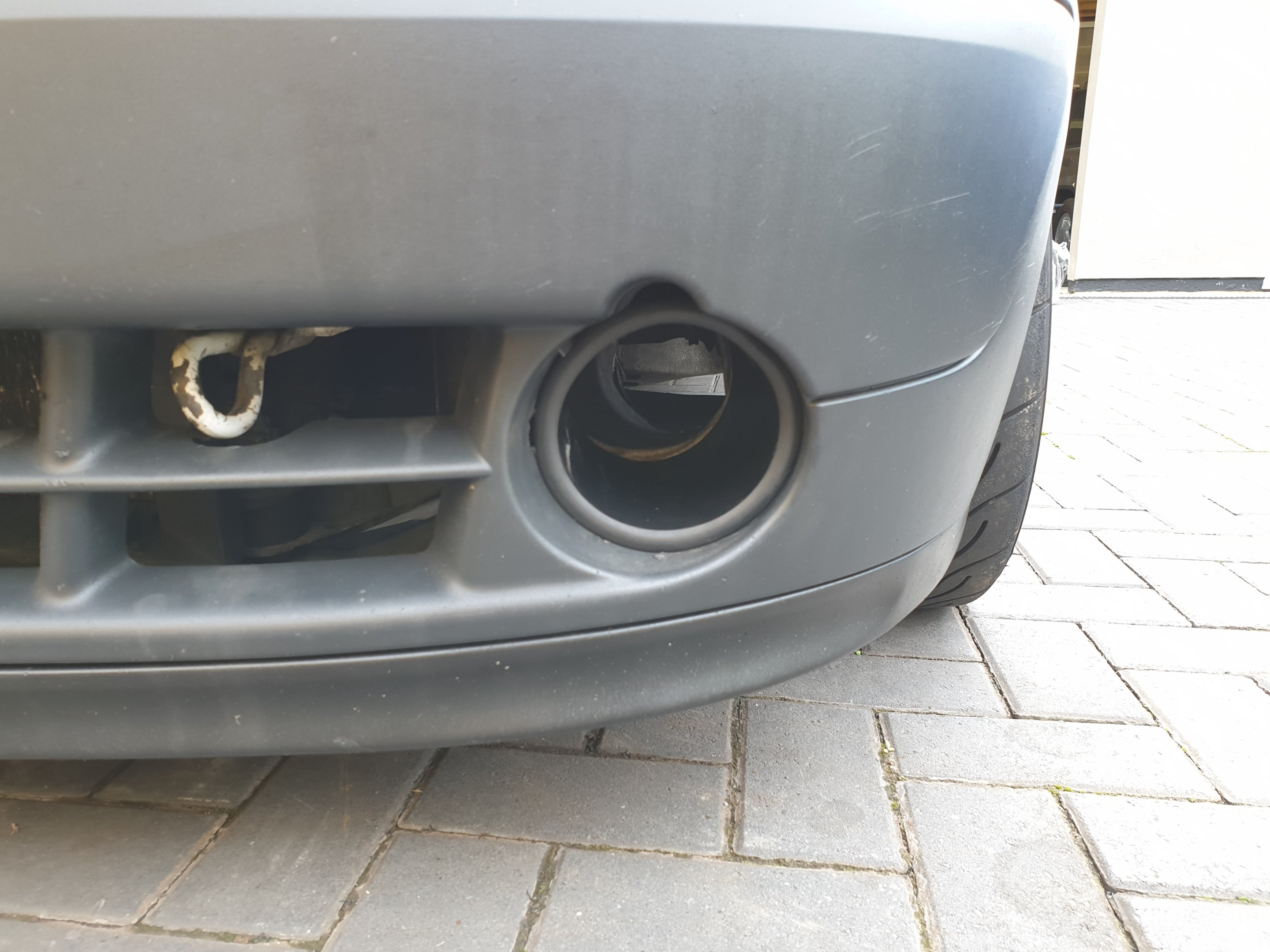

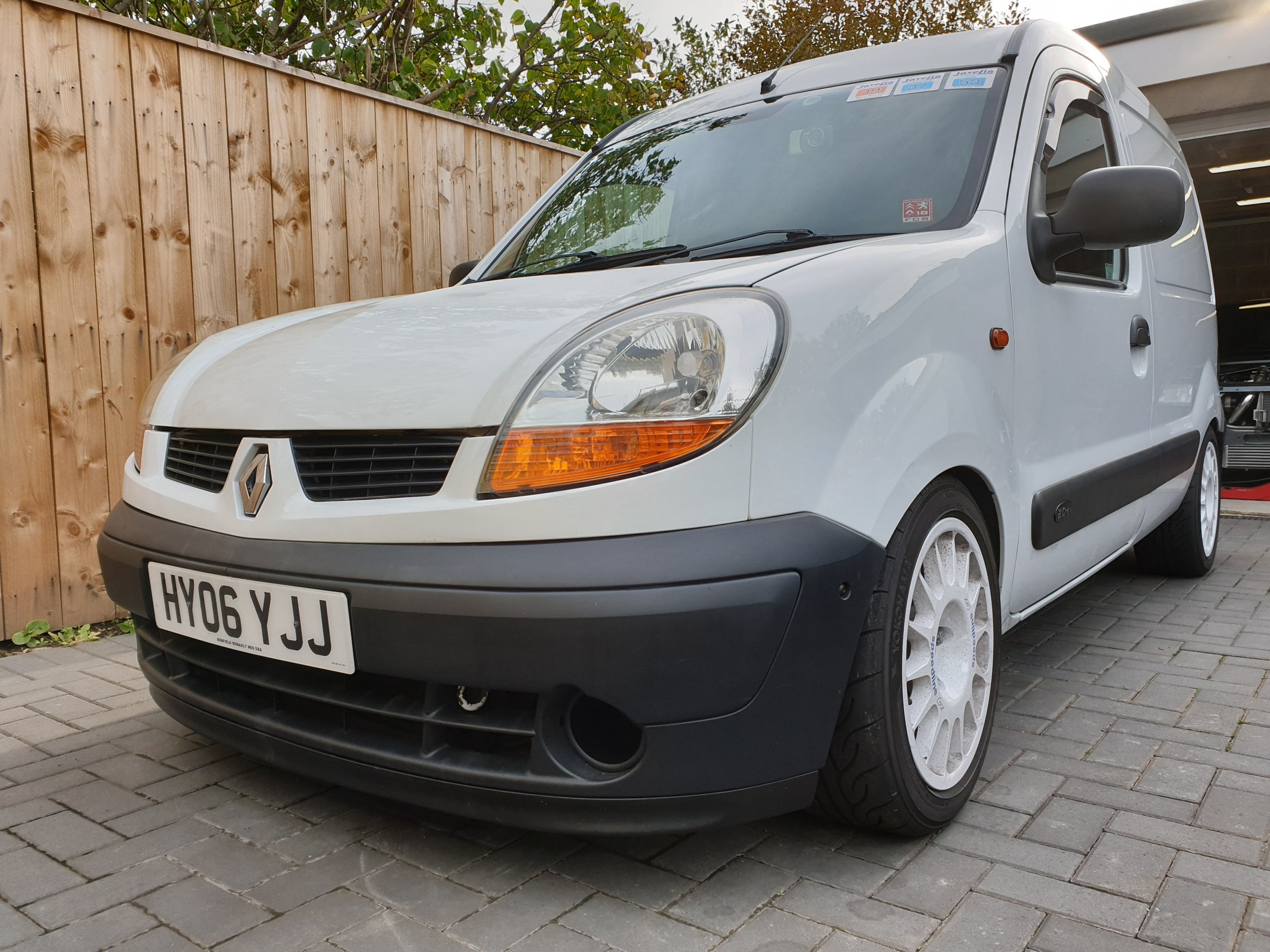

Croft prep continues

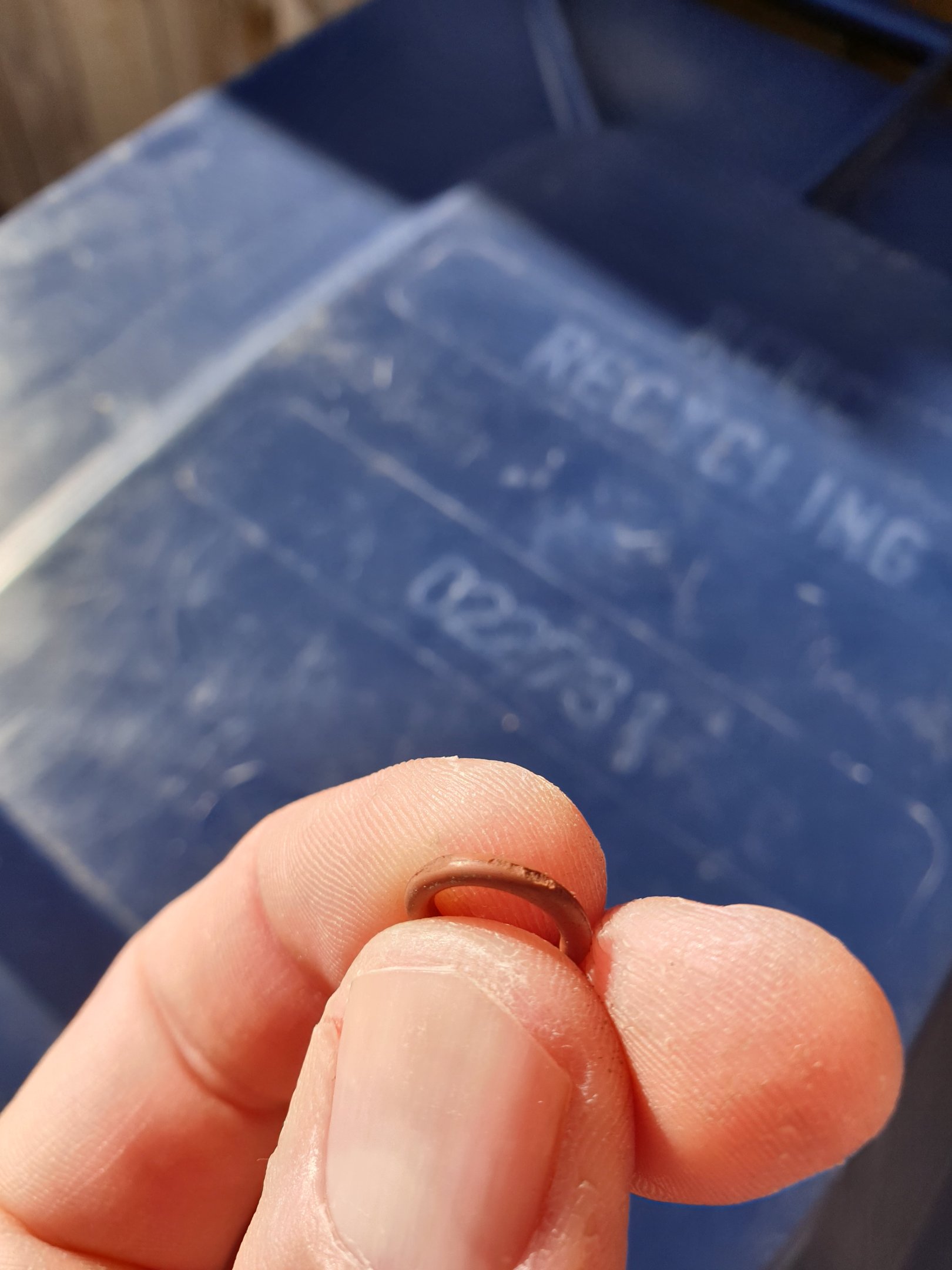

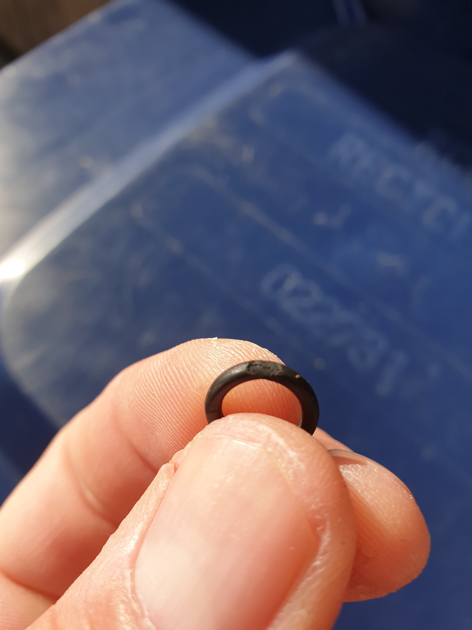

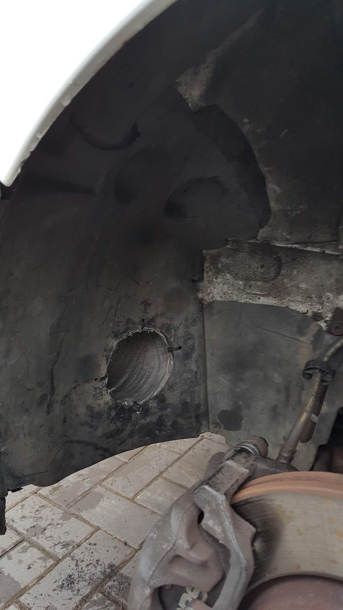

Brake ducts fitted - 100mm bass ports fit nice and tight in the foglight hole, filled inside edges with PU and hose cable tied to inner arch.
Had a bit of a carry on with this as removed the remains of the carbon canister to make room, knocking the fuel line causing it to leak at the rail. I was going to change pipe and fitting but it appears to be fine/solid now, might change o rings as new fittings arrive today.
Need to knock up some deflectors for inner arches next like the cup racer setup. If i get time will sort it this week.
Heel & toe pedal fitted

The ducts look nice and neat. I wouldnt do them on mine as my lights are so dim I use the fogs to get as much help as possible ?
Cheers mate hopefully they will do the business. No fogs in this as pov spec lol
Fuel rail connector issue sorted. Removed it this morning an o-rings not the best, swapped them for ones off the new connector and all seems good.

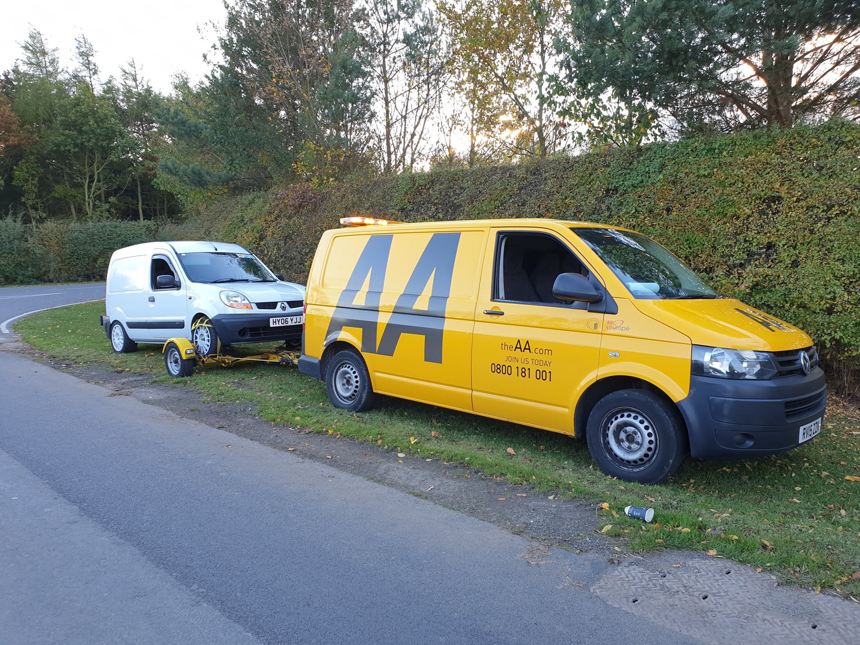

Croft didnt go so well !
Went out for sighting - noise tested 100db static. First session went ok no issues apart from lack of confidence in the pbs pads. Went out for 2nd session and 5 laps in rode the kerb on the lhd side exiting chicane and lost drive. Assume circlip has come off the diff as speedo still going up and getting gears but no drive.
As not many tools with me and no spare gear oil had to admit defeat and call it a day. The question is do i renew the circlip & weld it in - renew circlip and fit plate to diff or whip the box out and fit a bolted diff ?
A few pics
And finally - tow of shame??
