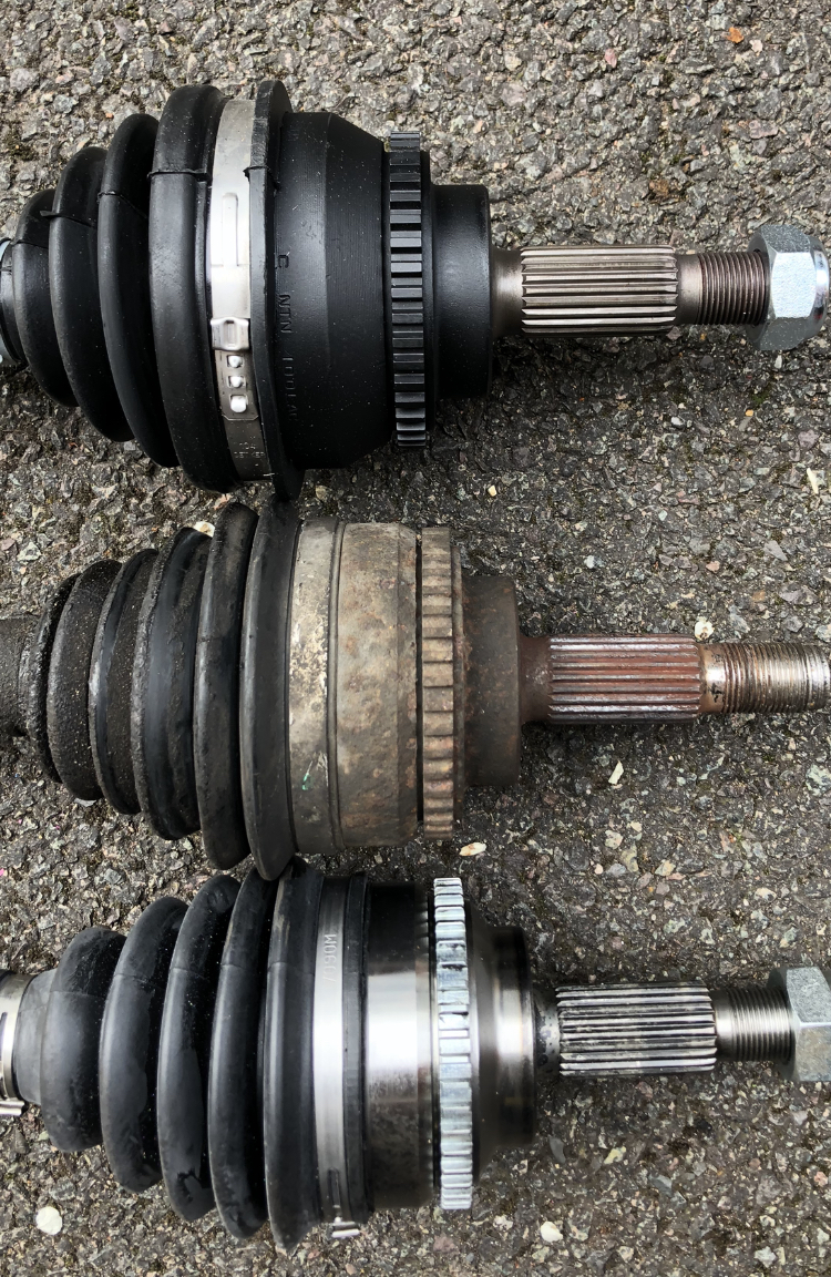

I happen to know the exact solution and the differences. Picture top to bottom
1. Euro car parts GKN shaft 640cm
2. A standard oe 172cup shaft is 653cm
3. A J&R shaft is 660cm.
I had the problem of the Gripper diff knocking inside the diff cup. Problem solved by fitting the GKN shaft.

Excuse my ignorance, so the OEM driveshaft is too long therefore the issue is?

Yea when you fit the Gripper and you lower the car, what tends to happen is the standard shaft at 653mm the tripod hits inside the diff cup. At standard ride height it will not be an issue. My car measures 315mm from wheel centre to arch now. When I was having issues at that height I had to raise it upto 350cm before the knocking went away. I approached Gripper about this problem and they offered a solution of cutting my shaft and reducing the length by 20mm. It was only that i stumbled across Euro carparts website that they listed the shaft at 640mm that I chose to buy a shaft instead of having it cut and rewelded.

I can’t edit the post with the pictures but just in case. I mean “mm” not “cm”. Lol

It seems the definitive answer is to physically measure the shaft. There is no actual specific shaft as Mark and I discovered that all manner of shaft from phase 1 to phase 2 measured similar. When I spoke to Gripper they said maybe 1 in a 100 cars have a problem, and also depending what time of the day/month/year whether it be Franco or Pierre or jean Claude Van dam that built the car, it could have any manner of f**ked up length shaft put on from the factory. And not forgetting that our cars are now 14/15 years old and could have had a replacement in its life so who knows exactly what shaft it’s been replaced by. Long and short of it is, if you have a problem then the fix is Euro Carparts 640mm shaft. Ps, the bonus part is the GKN shaft is hollow and lighter than the Solid steel J&R has one.
