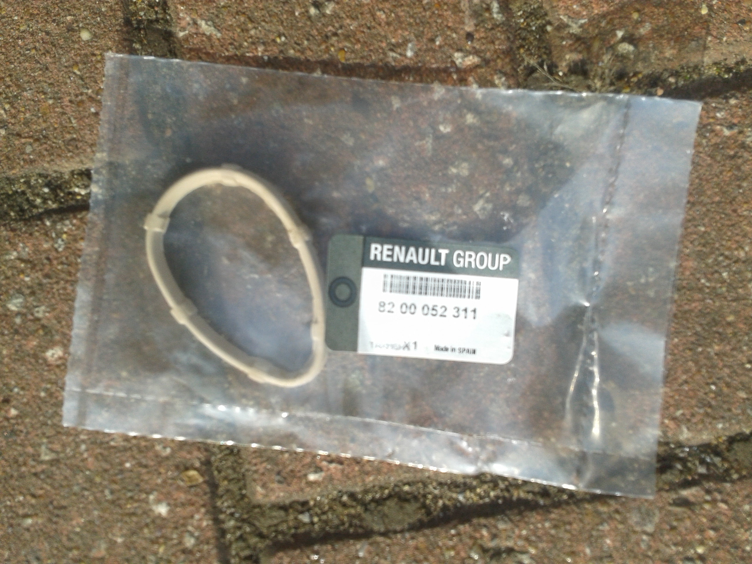

Change the O ring as well.
A new one is soft & compressable, my old one was hard as nails.
Is the car a PH1 ?

View attachment 1394902[/QUOTE]
The car is a ph2. Im not sure where this goes?
Is it the inlet manifold?
Get a new gasket from Renault wolves on here, about a tenner.
Take you about ten mins to fit it.
I'll get one ordered

  PH2 172
The Ph2 throttle body has an elongated "O" ring, which RPD told me is only supplied when you buy a throttle body.
The Ph1 has a conventional gasket, but that`s not relevant to your problem.
A smear of grease should seal it effectively.
