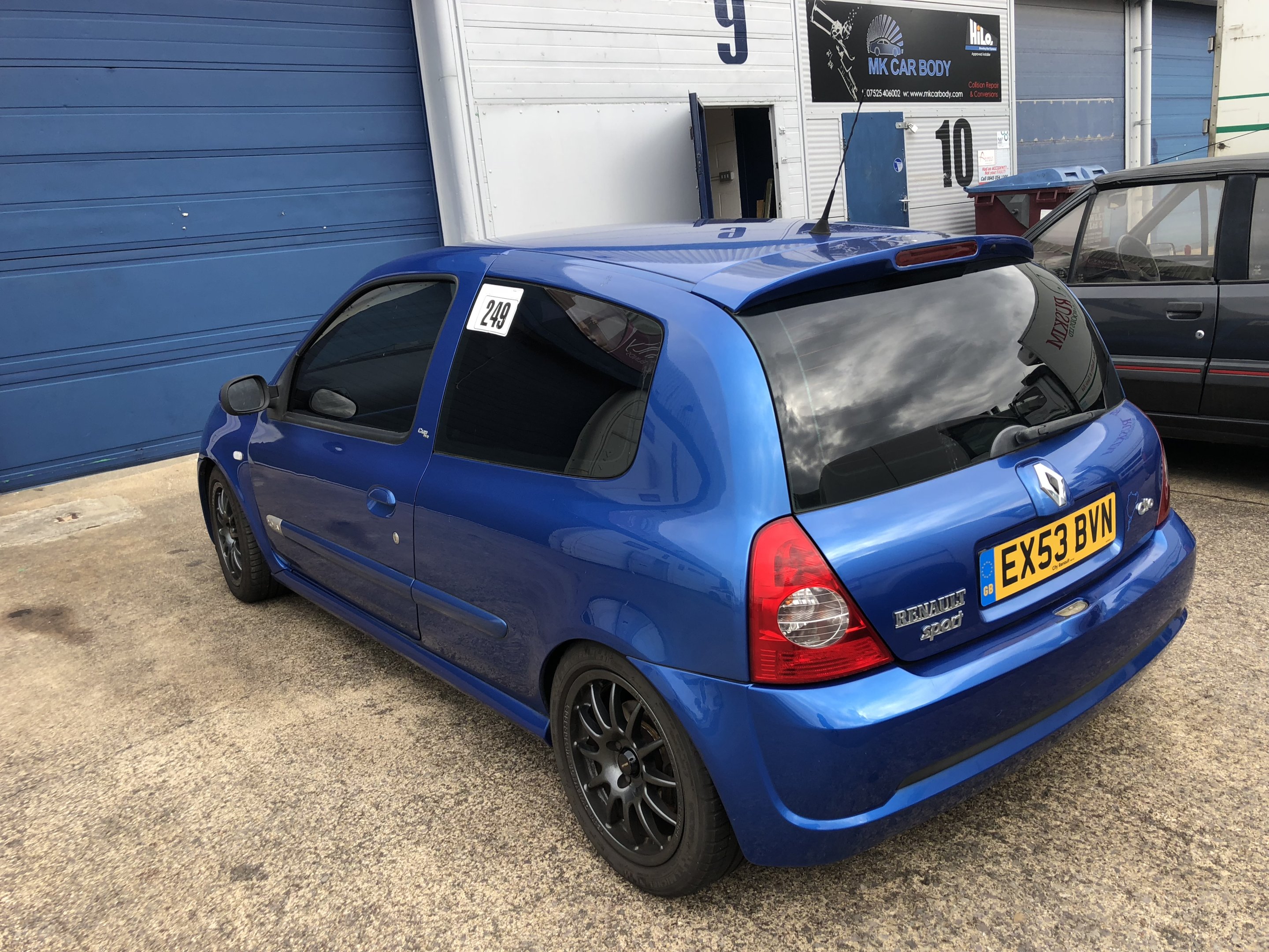

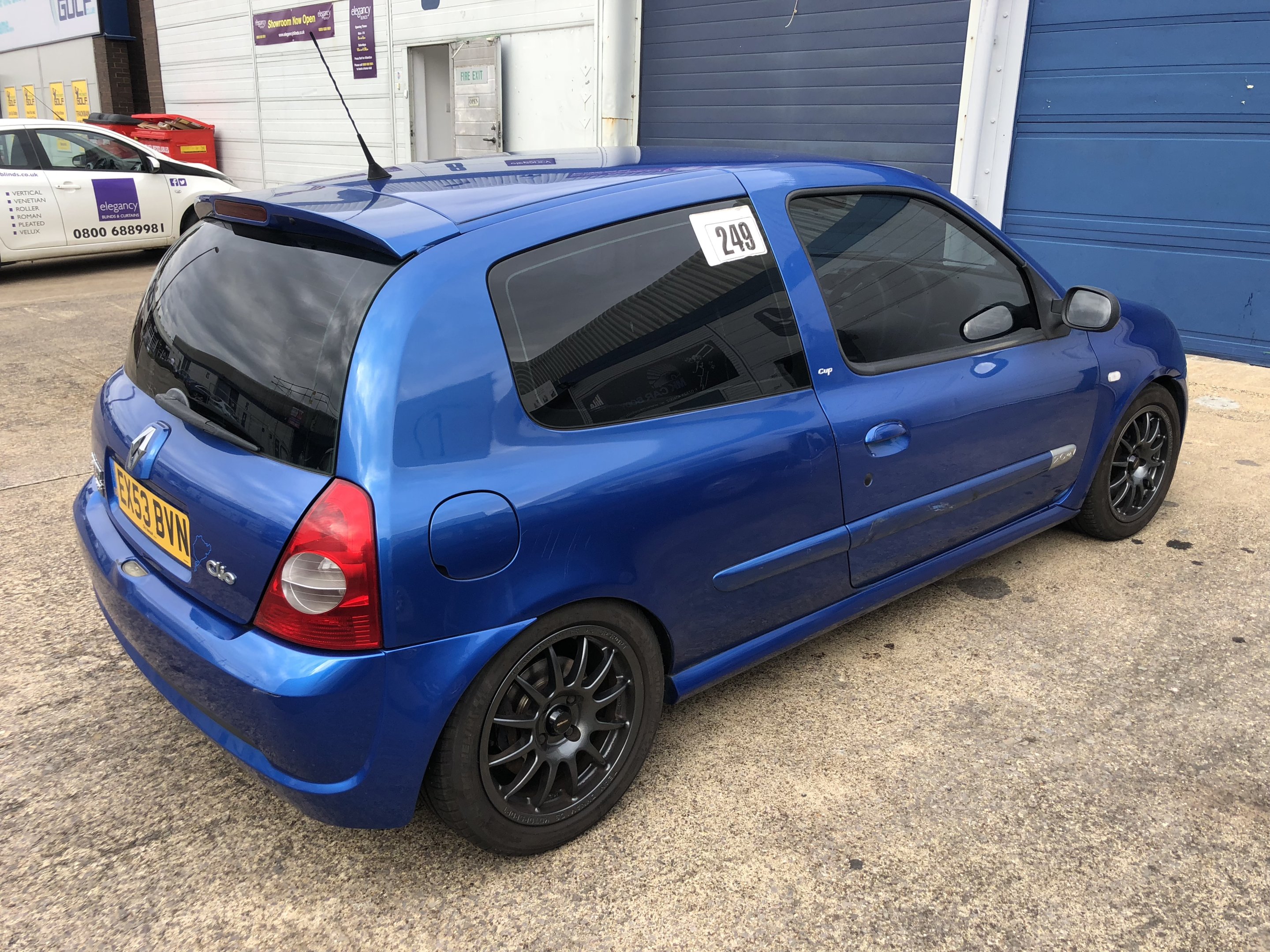

Just saying Hi. New on here. Just acquired off another member ( Cameron ) 172 cup. Planning to use on track only as I have a need for speed. A few jobs needing doing and is currently in at Sean Edwards Renault specialist in Birmingham.
Jobs list in progress:

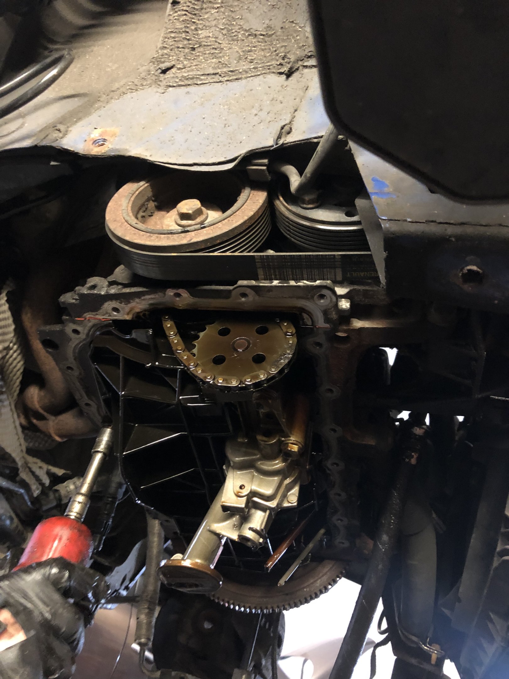

Cam belt and everything related
Oil change
Spark plugs
Brake fluid
K-tec exhaust
Braided brake hoses
Jobs planned:
PBS front pads or Carbon Lorraine
Full cage
Bucket seats
Full harness
Toyo R888
Pink,purple and silver full body wrap (I used to race RC cars and these were my race colours)
The list will grow as I go along.

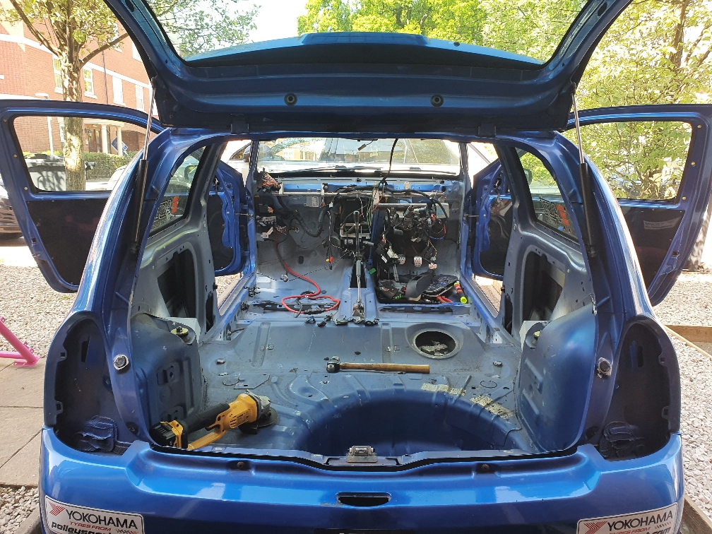

Already been busy and removed some of the interior and tinted windows.

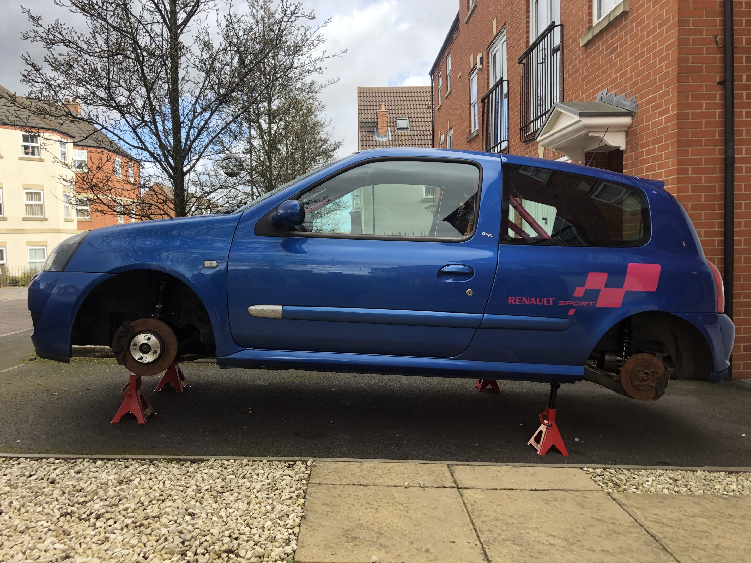

A bit of progress made.
In a bit of a rush to have a play at Bedford I made a rookie mistake and didn’t really have all the mechanicals double checked. I managed only 5 laps around Bedford and on the second bit of the main straight the clutch decided it didn’t wanna play anymore. That was the end of that and I had to get RAC to taxi it home.
My original plan was to have a second gearbox that I have to be rebuilt with a Quaife LSD but due to the time of year and X’mas looming I’ve had to put that plan to the back burner. In the mean time I’ve had the complete clutch replaced with OE for now.

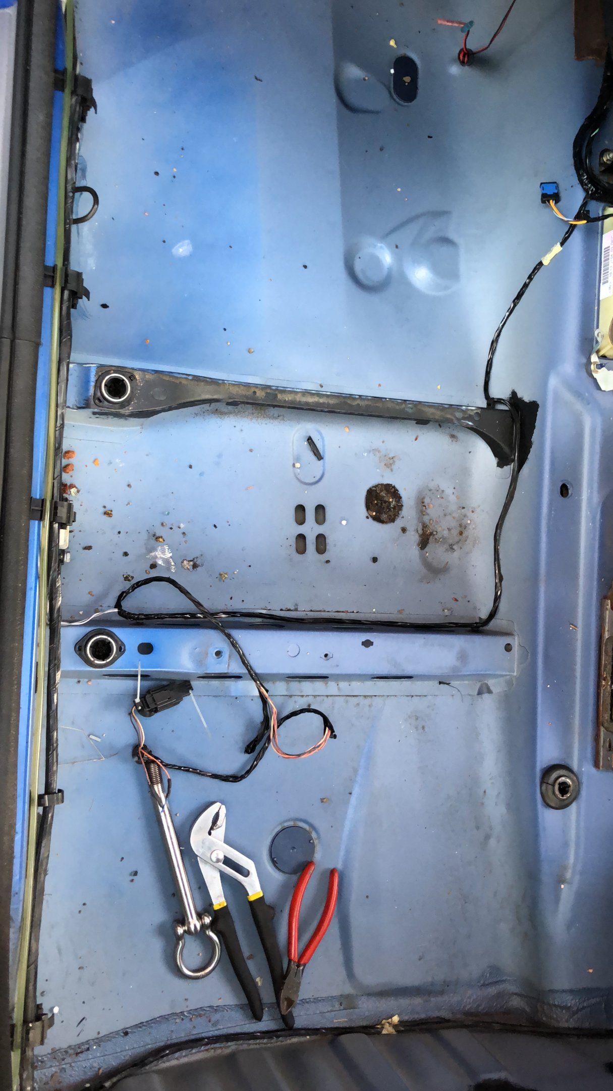

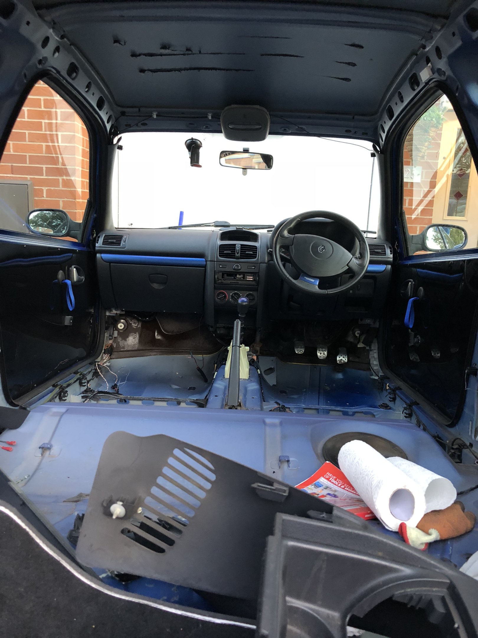

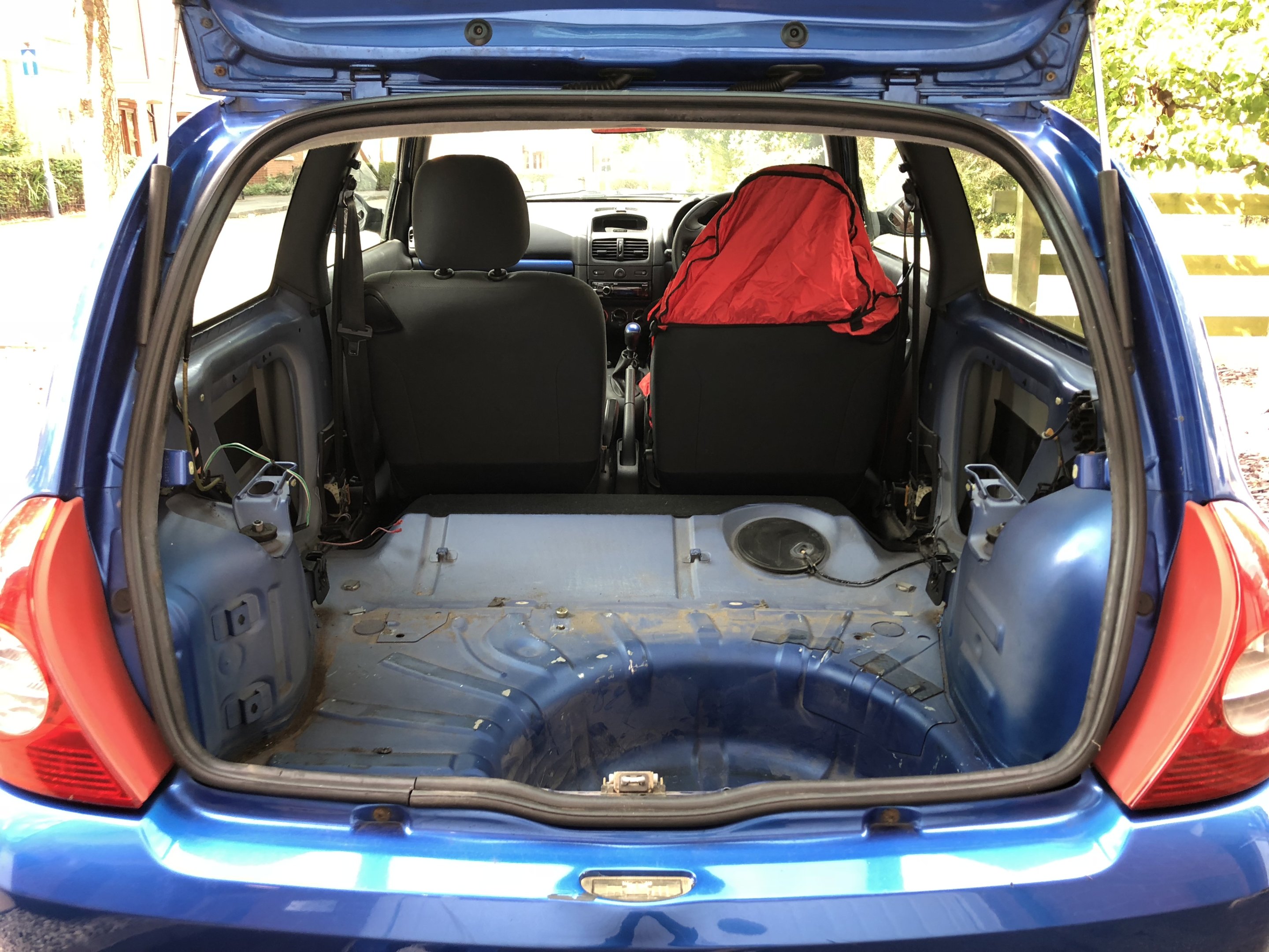

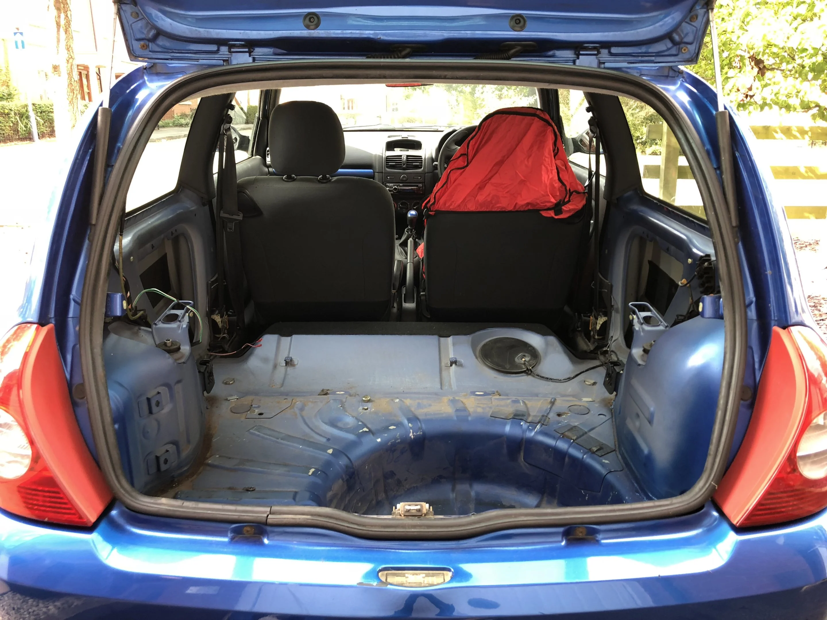

Reading up on the forum and seeing what people do, I really wasn’t looking forward to removing the sound deadening. But how shocked was I when I removed all the carpets and my 172 is naked. What a relief. It seems 172 cups have none? Any ways had a bit of a father and son bonding day yesterday and got round to fitting all my new bits and pieces.

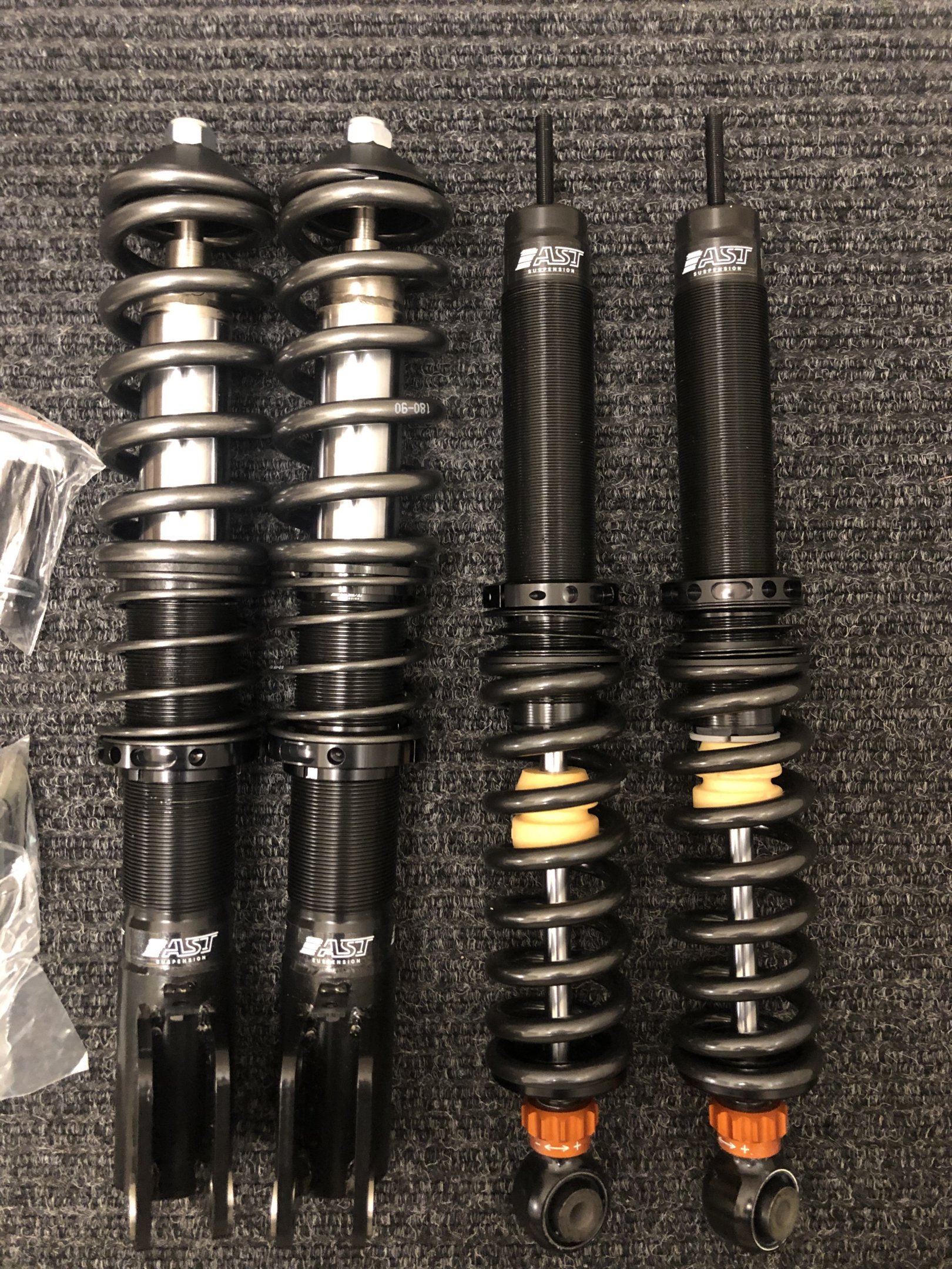

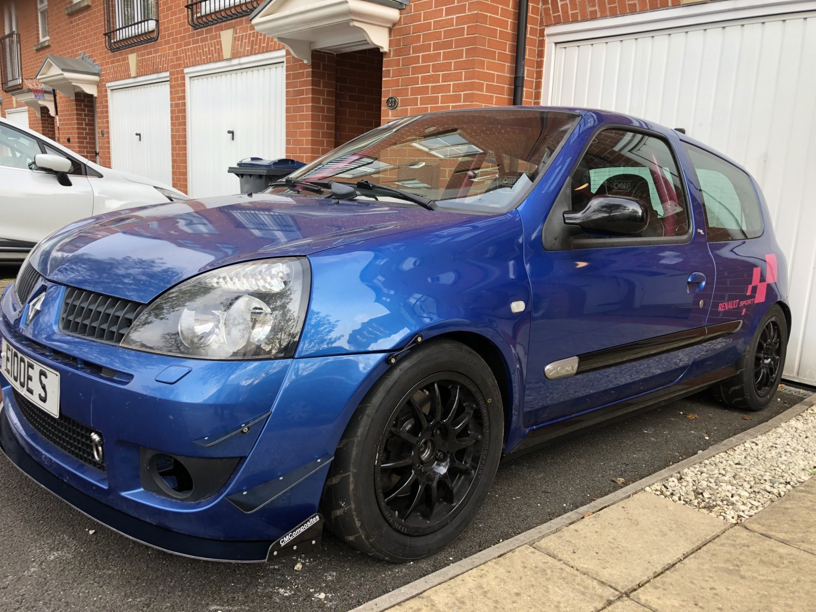

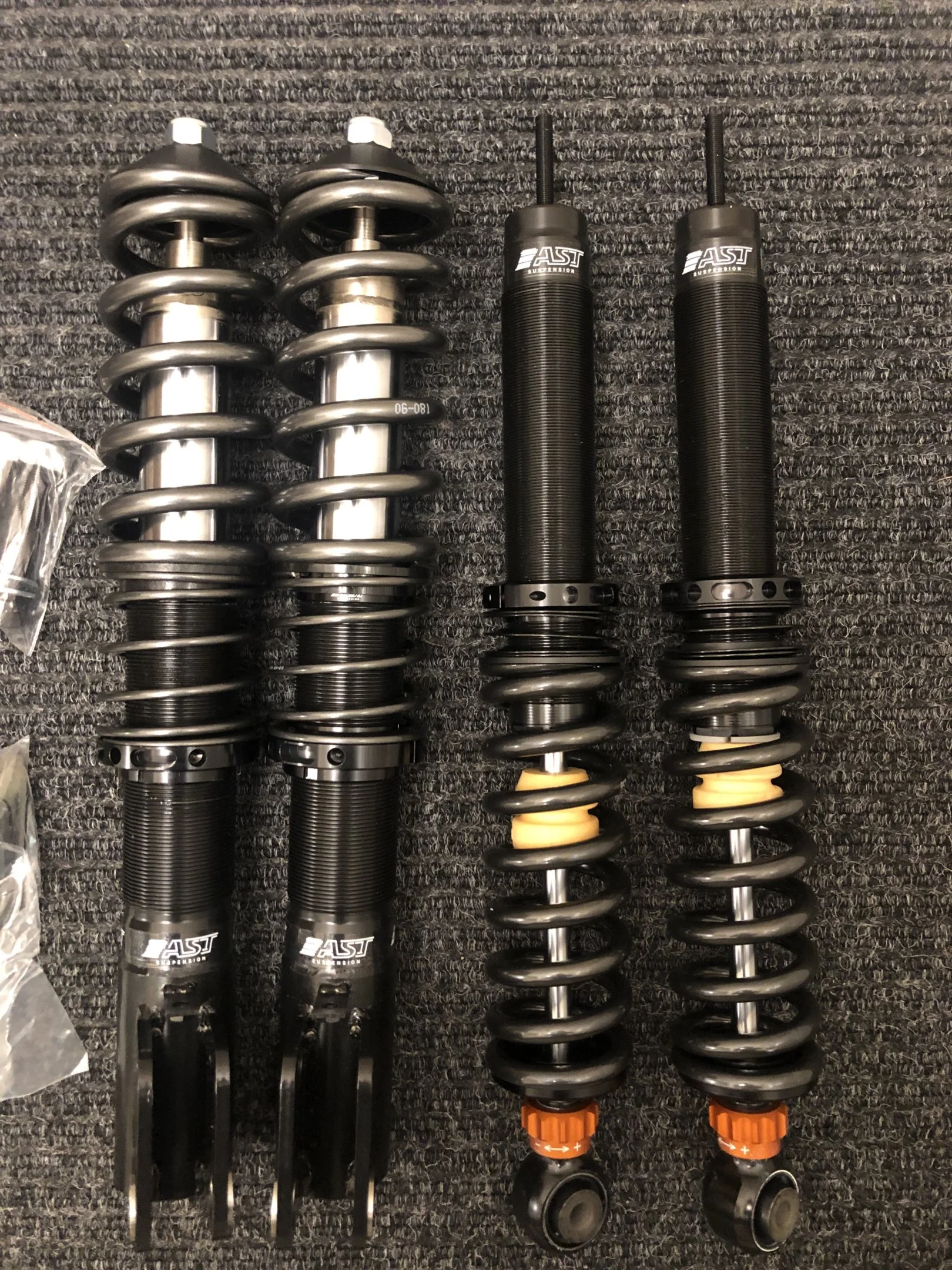

Busy couple of weeks. Removed my AST’s and took them to Cooksports in Bristol to have them rebuilt, only to discover that the fronts are totally uneconomical to be rebuilt. So I ended up buying a complete brand new set of AST 5100’s. Also I collected a complete subframe and rear suspension beam from an Ebayer in Macclesfield. I stripped it all apart and had a few bits powder coated ready for next week when hopefully my gearbox is back from @NorthloopCup and everything will be fitted all together. Spent a few hours on the car the last few days getting all the dash back in.
Eddie555
  Q7 2018 & 172 Cup.
Tuesdays are my day off so time to get cracking again. Started with fitting my AST’s then took a break and went to have my new R888r’s fitted. Finally got the car back on the ground and took it for a spin. Wow just wow. I thought it handled well before, even though the old AST’s were knackered, but now with the cage in, new suspension and 888s the transformation is unreal. It literally feels like a completely different car. Next update is gonna be a biggie. Car is going in on Thursday for totally undercarriage refresh, gripper equipped rebuilt gearbox (big thanks to @NorthloopCup) new drive shafts. Then it’ll be off for a full Geo setup. Can’t wait to get this thing back on track.

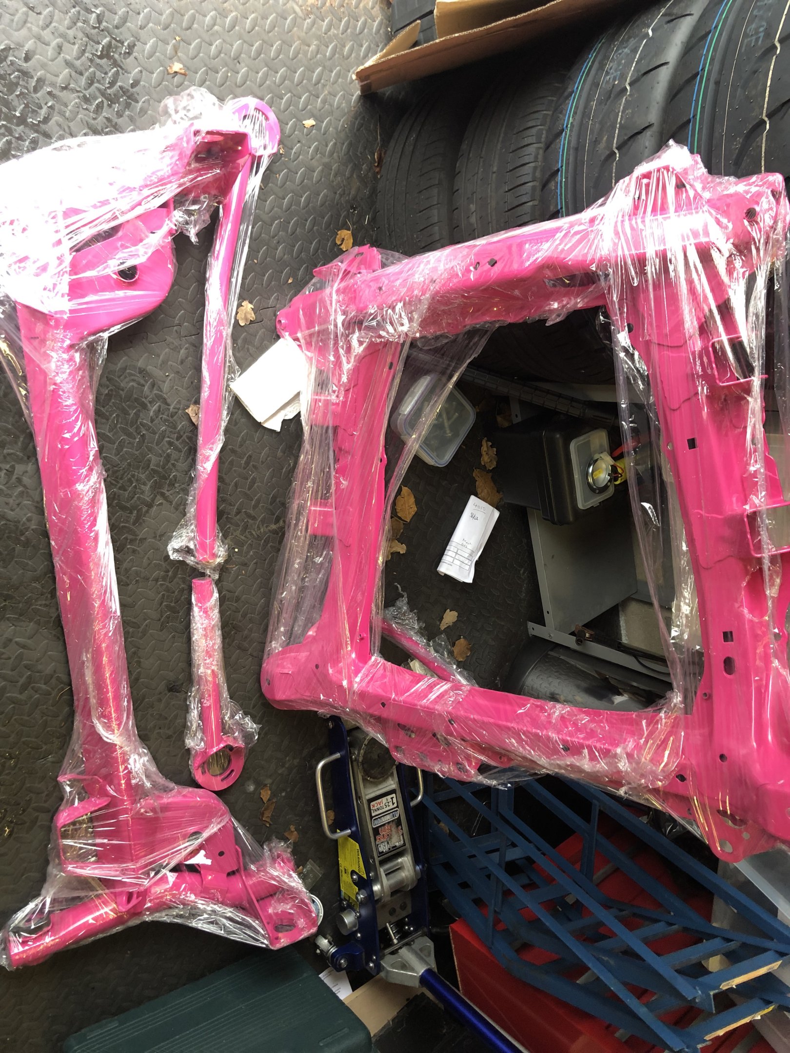

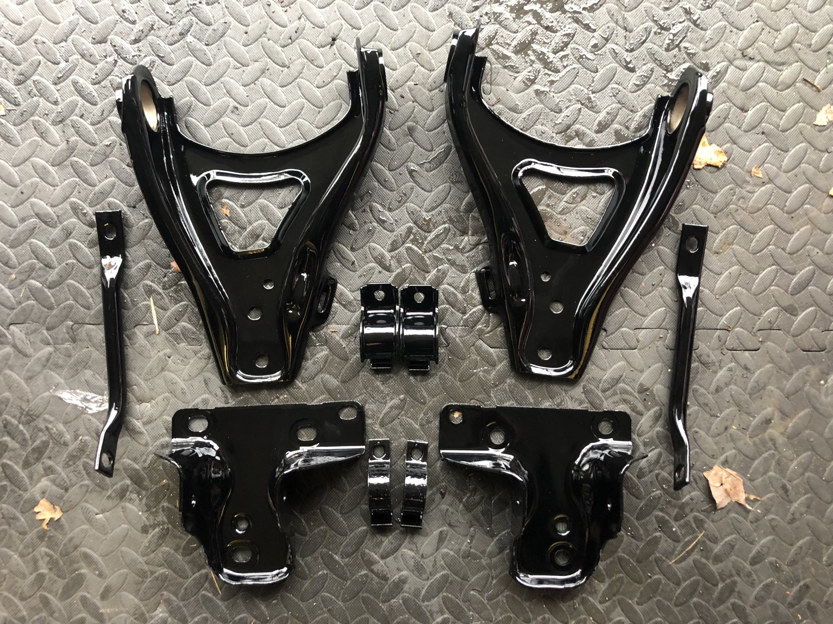

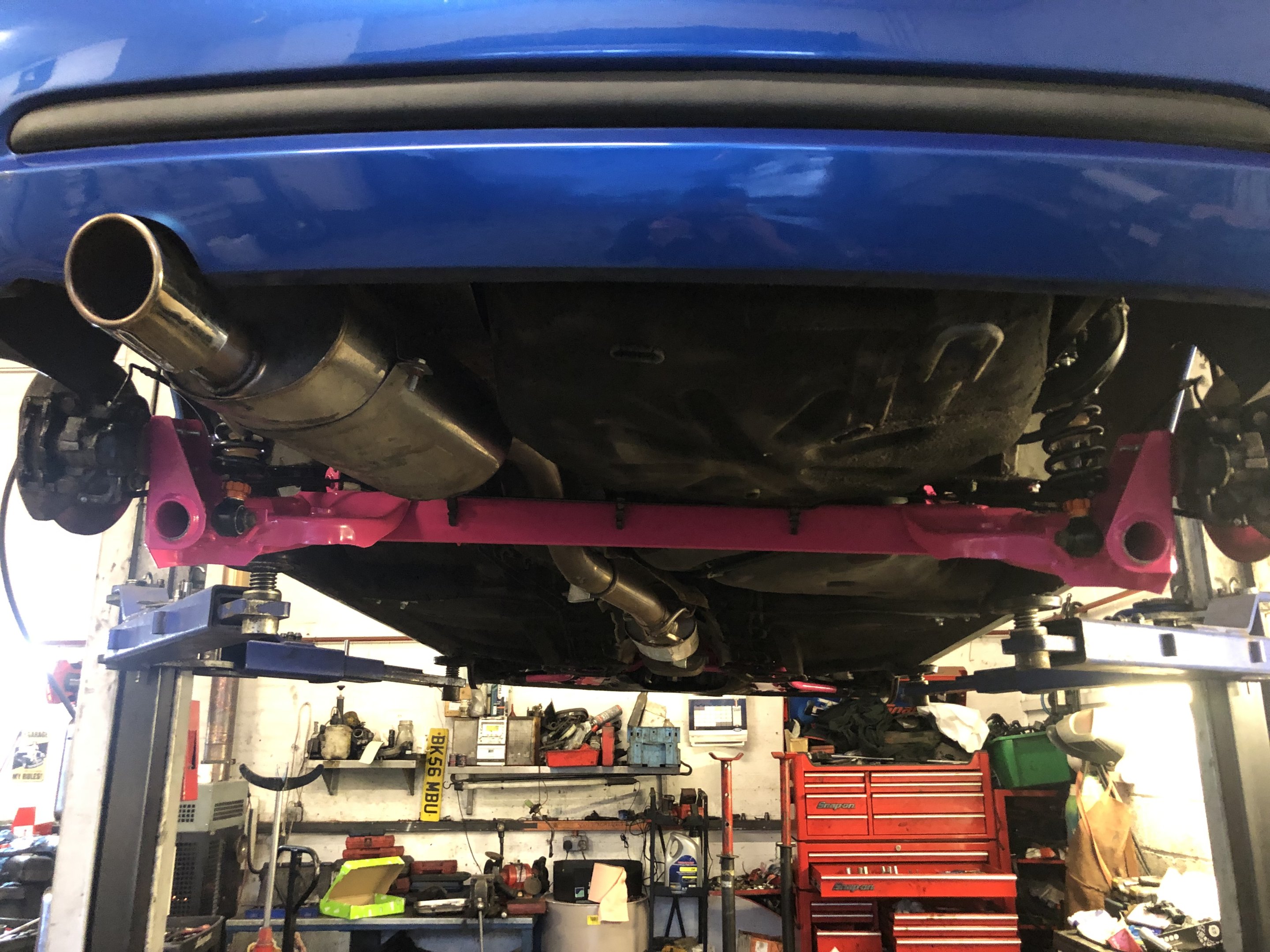

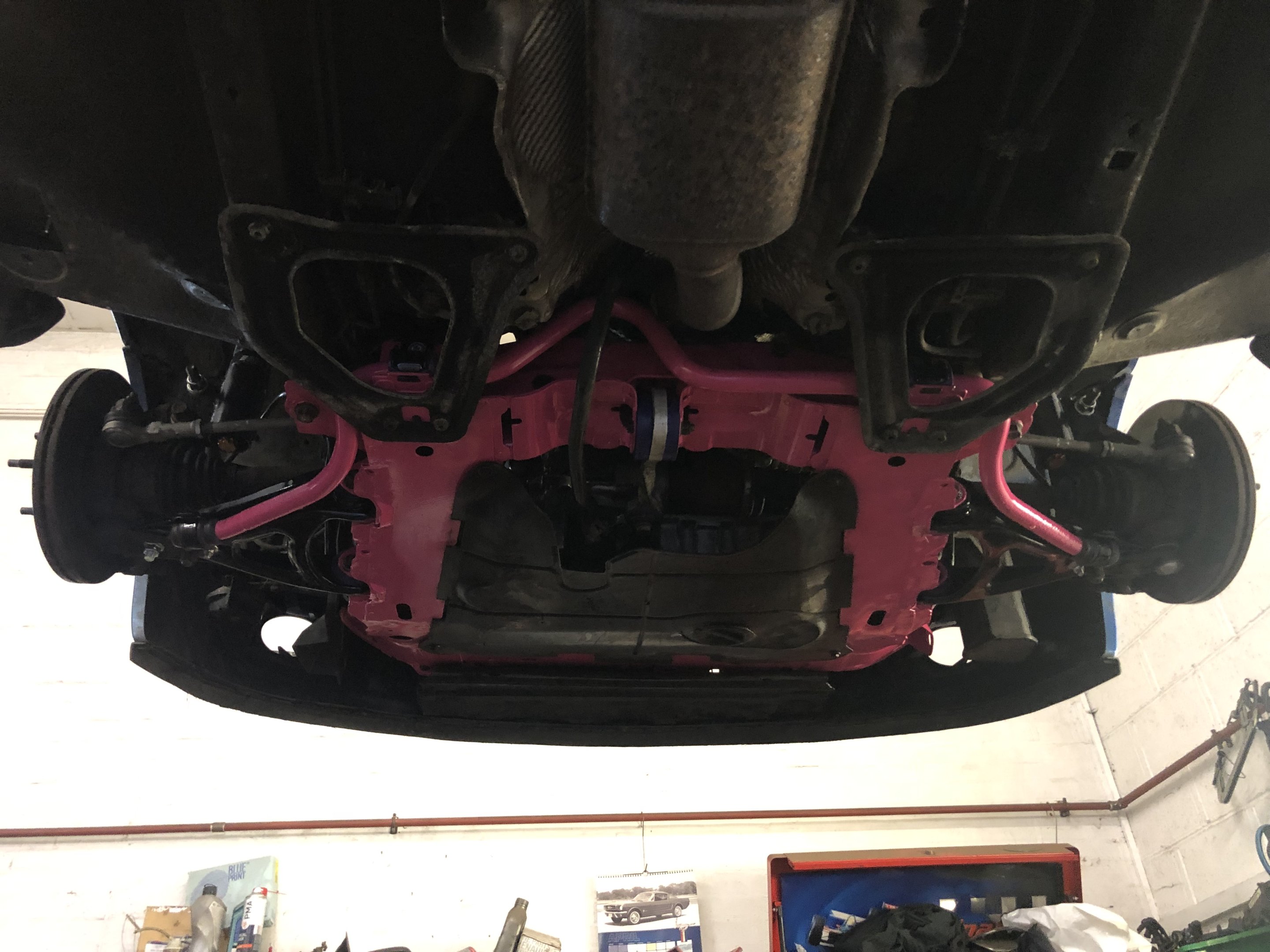

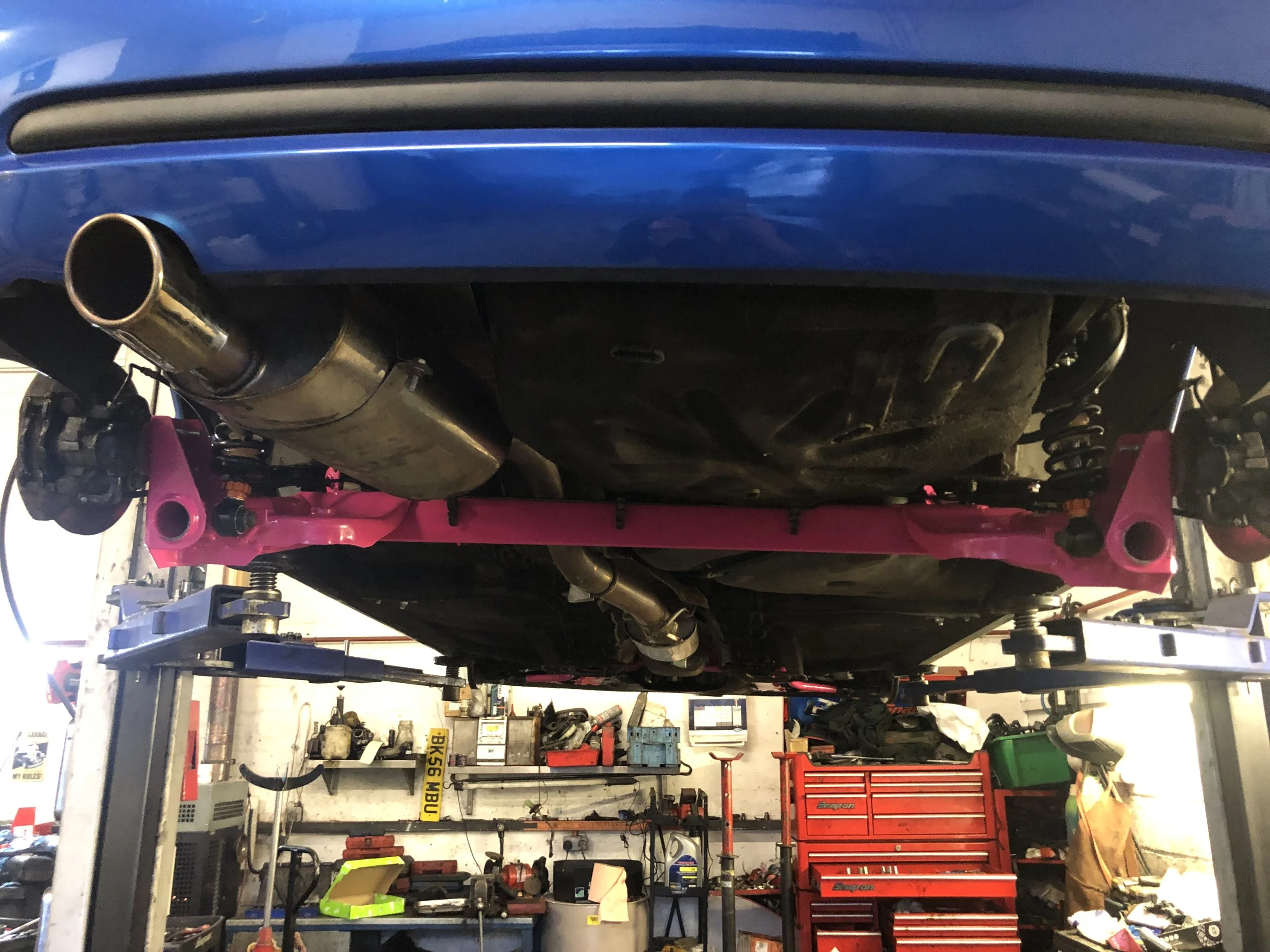

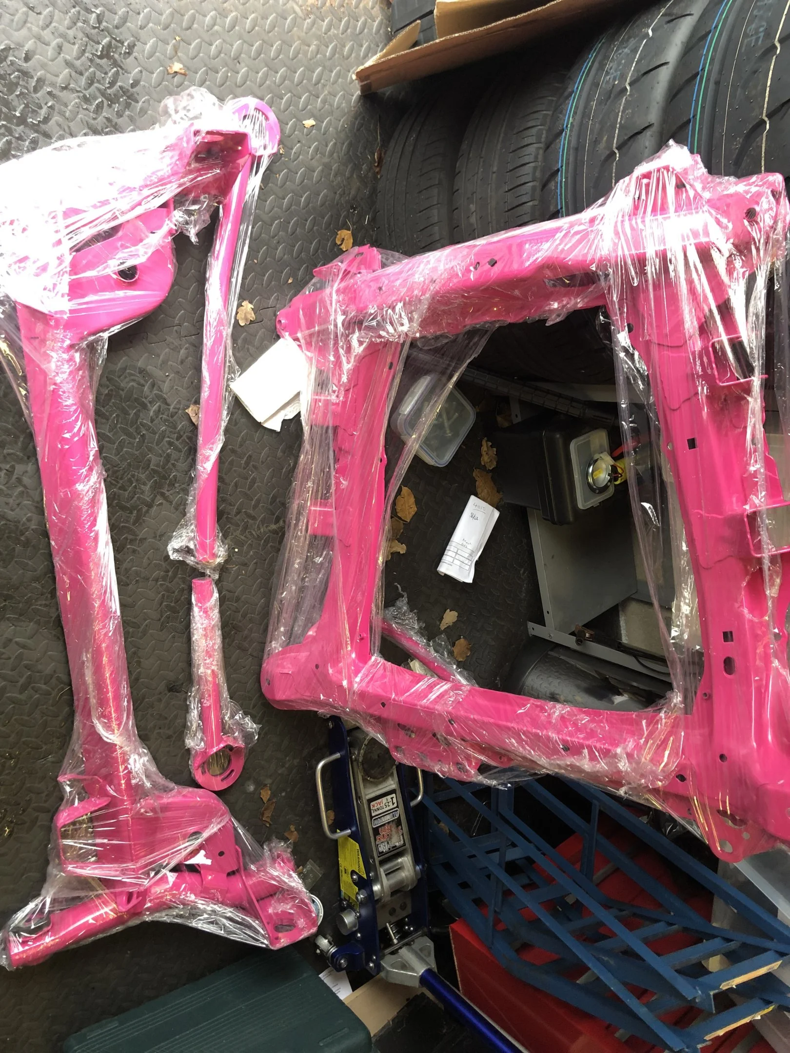

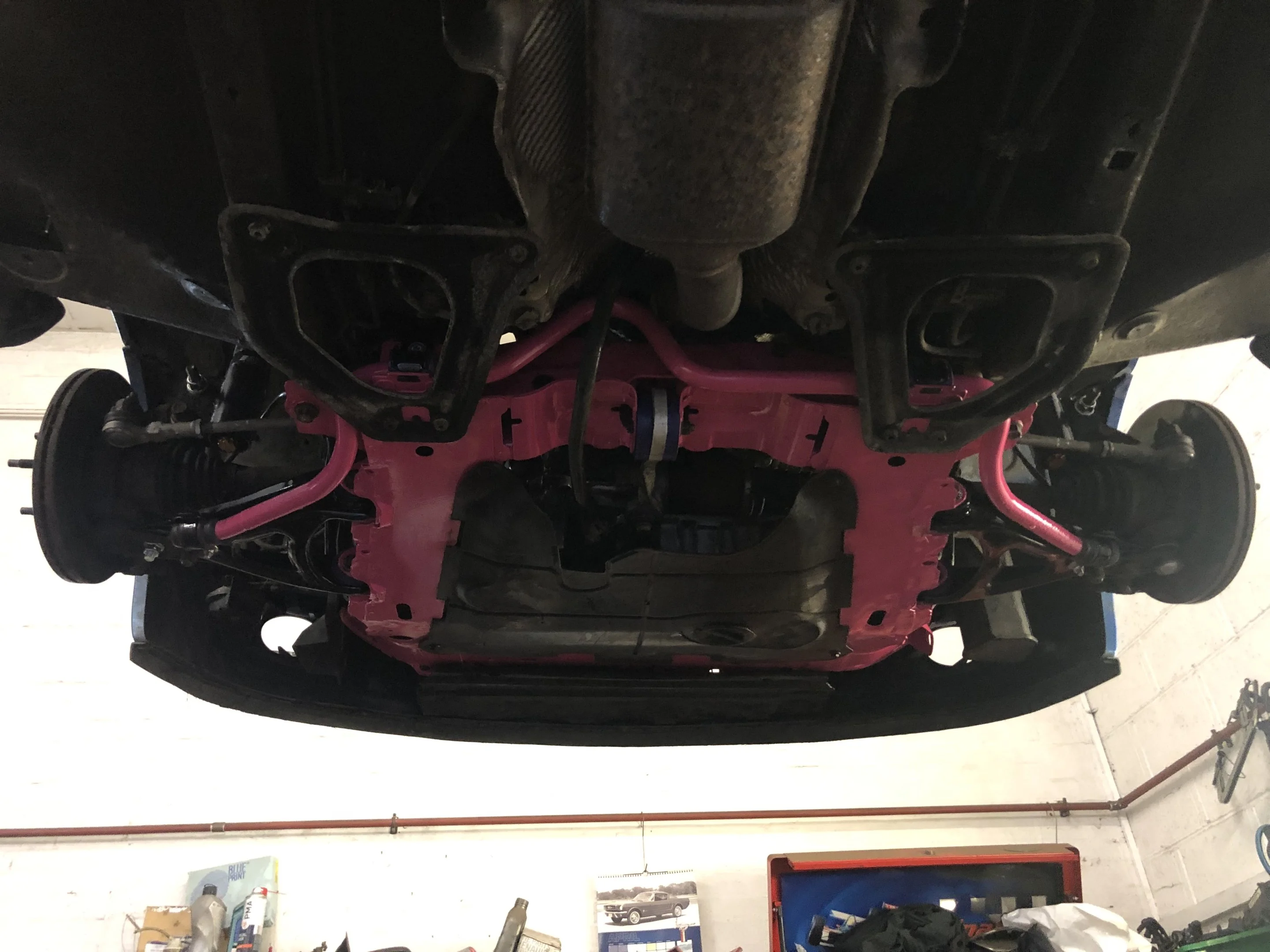

So. The list of things that happened yesterday.
Powerflex polybushes to all the undercarriage.
Freshly powder coated subframe and rear beam.
New PBS brake pads all around
New steering joints inner and outer.
New bottom ball joints.
Rebuilt gearbox with a Gripper diff.
ARP bolts for the Conrad’s.
Brake fluid flush.
New rearbeam brake pipes.
New handbrake cables.
Something my mechanic stumbled upon by accident was, if you have a 172 then order rear brake pipes and handbrake cables for a 182. For some strange reason the 182 items, which are the same, are £10 cheaper per item. 4 items = £40 savings.
Last week when he was working on another 172 the Renault parts supplier didn’t have any 172 handbrake cables so Sean (My mechanic) said what about for a 182. Boom yes they did and they’re £10 per side cheaper. Same thing happened yesterday when it was discovered my cables where buggered. We then asked about the brake pipes and same thing happened with the pipes. So there’s a hack for people.
The Diff is so so better than I expected. Excellent traction even in the wet weather and brand new R888r.
Next is a full geo setup and I can book a shake down track day. I CANNOT WAIT.

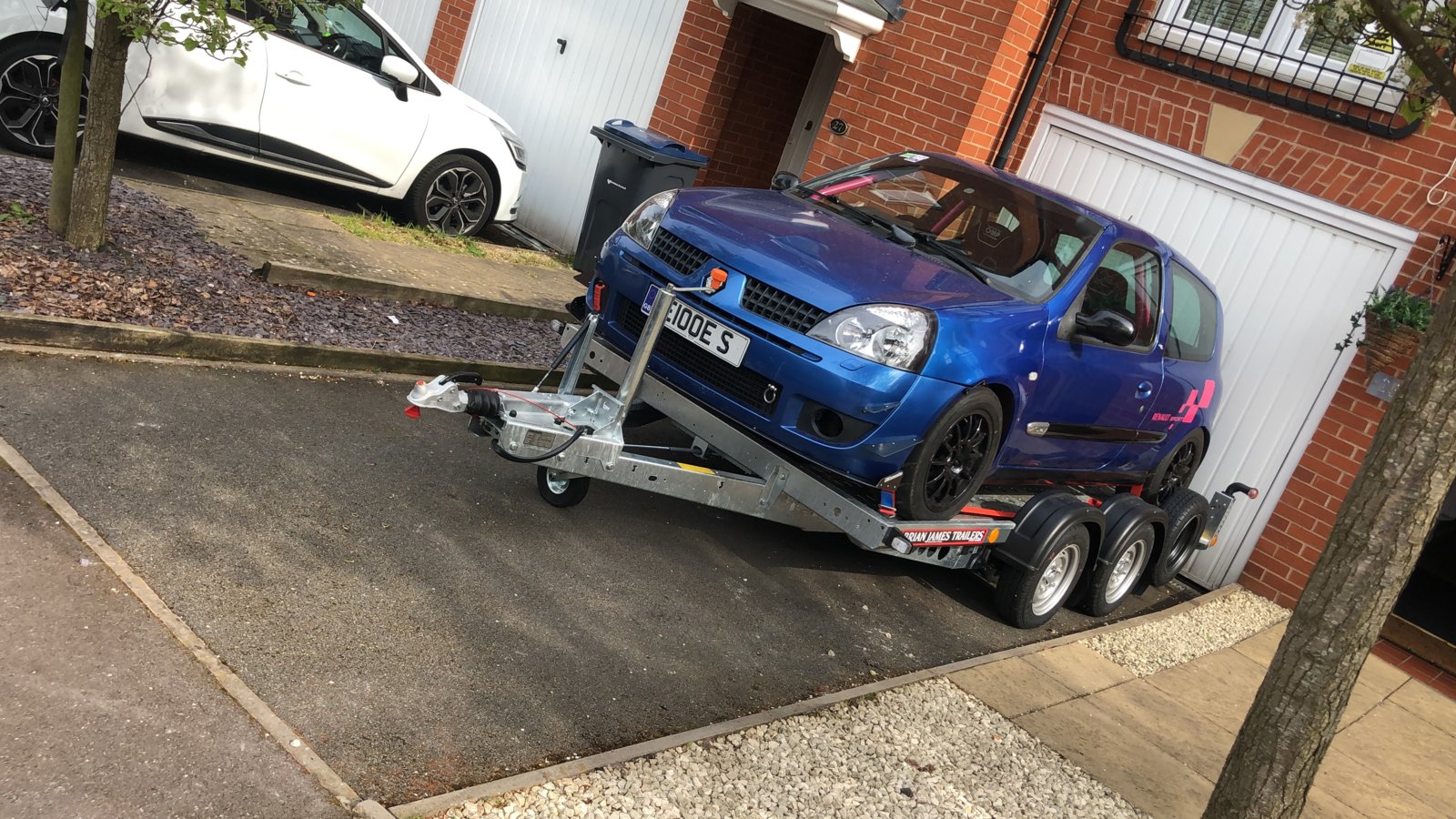

Decided to get myself to an early Birthday present. A nice brand new Trailer from H&T trailers. Highly recommend them for a cracking deal. All locked and loaded ready for the Nurburgring next week. I can’t wait.

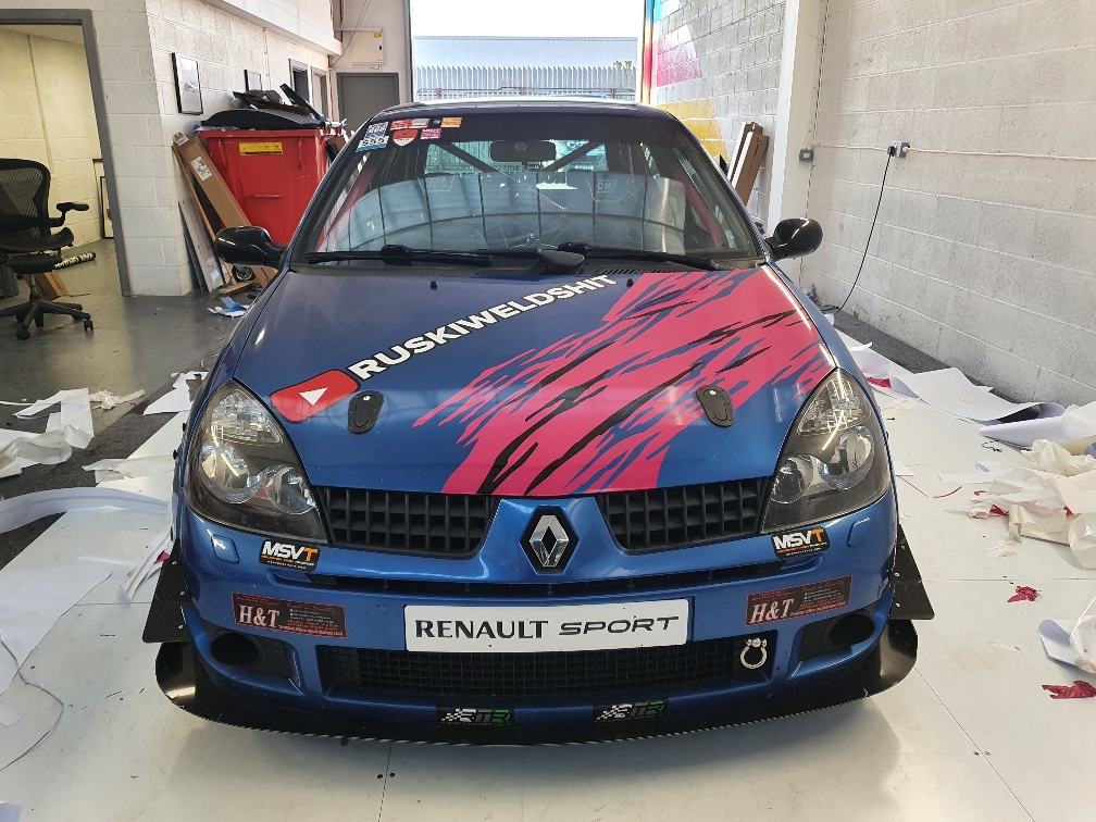

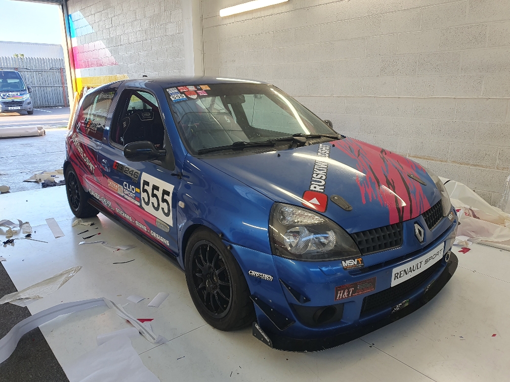

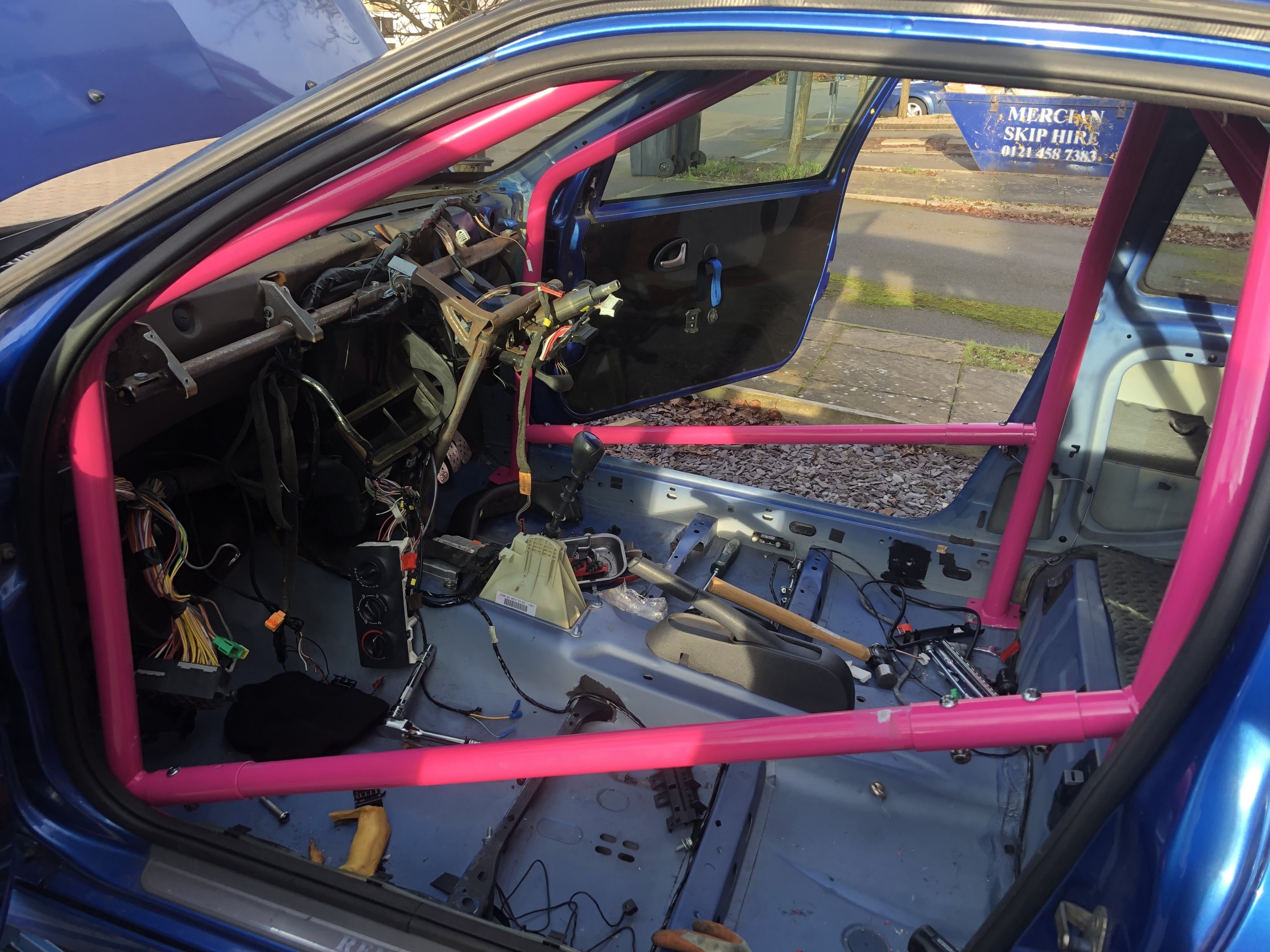

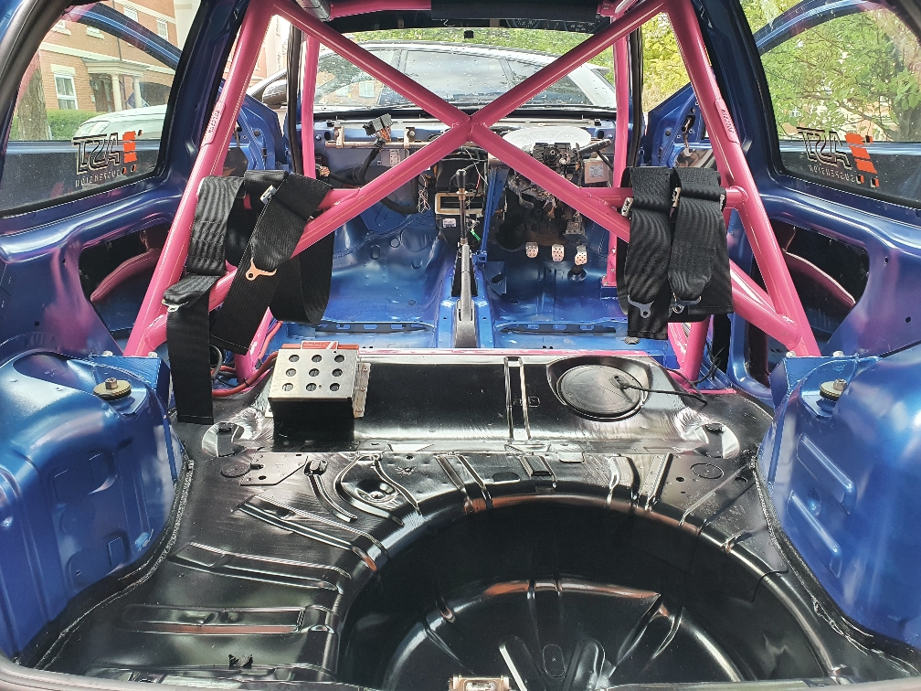

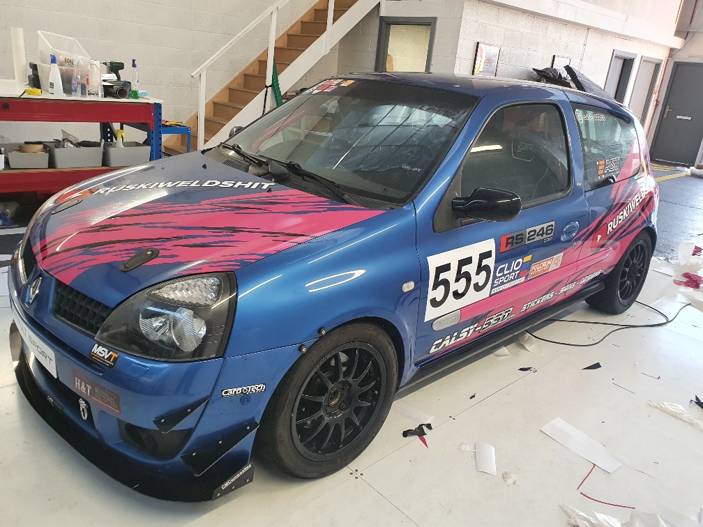

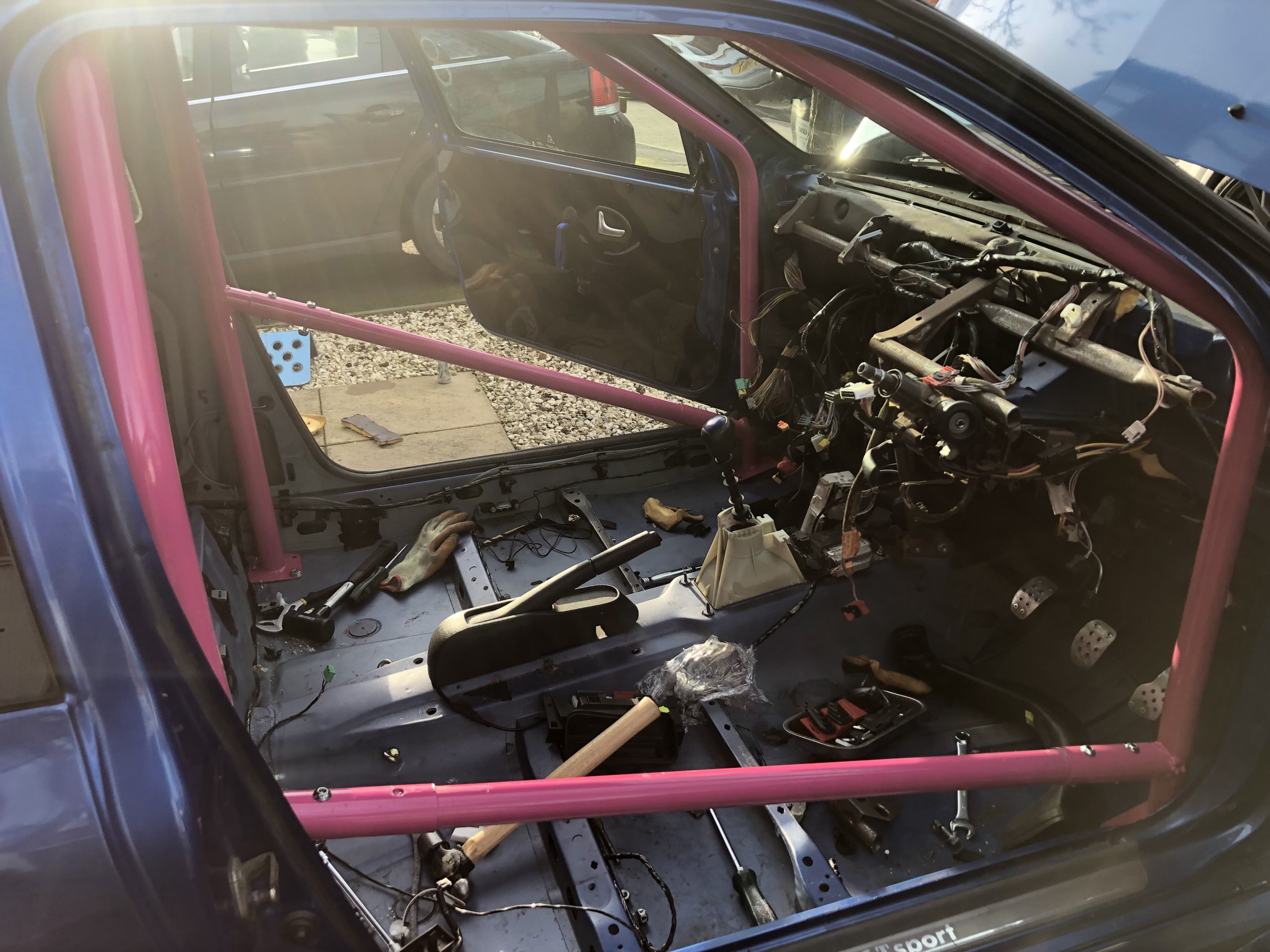

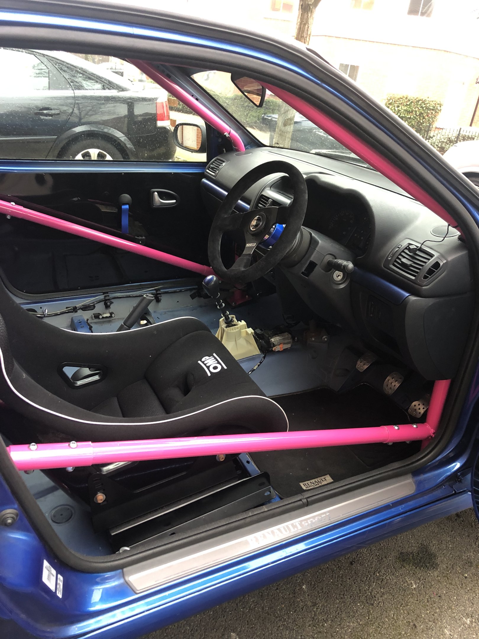

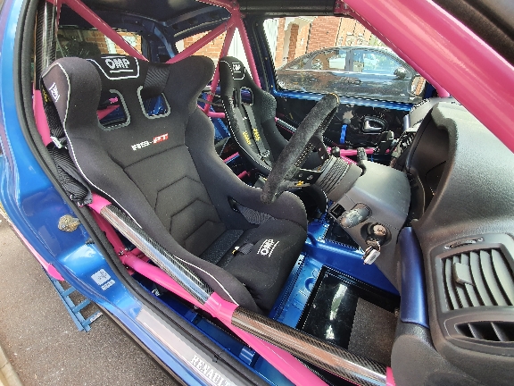

Wow.. Where did that year go.. Lockdown boredom made me come check back here..
What can i tell ya.. Done ALOT of trackdays last year.. Also done a load of "Cheap" upgrades. New things..

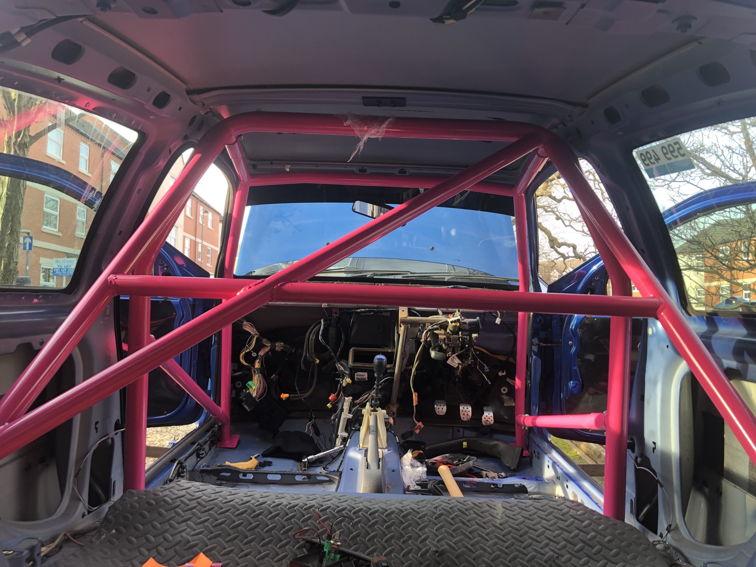

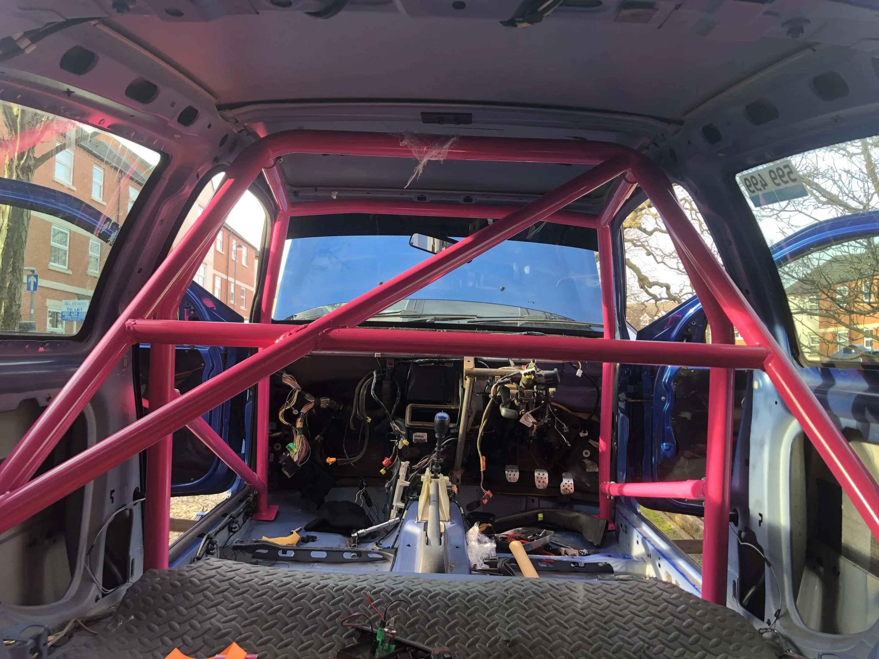

[emoji830]︎Custom built full cage by Fulcrum_motorsport.

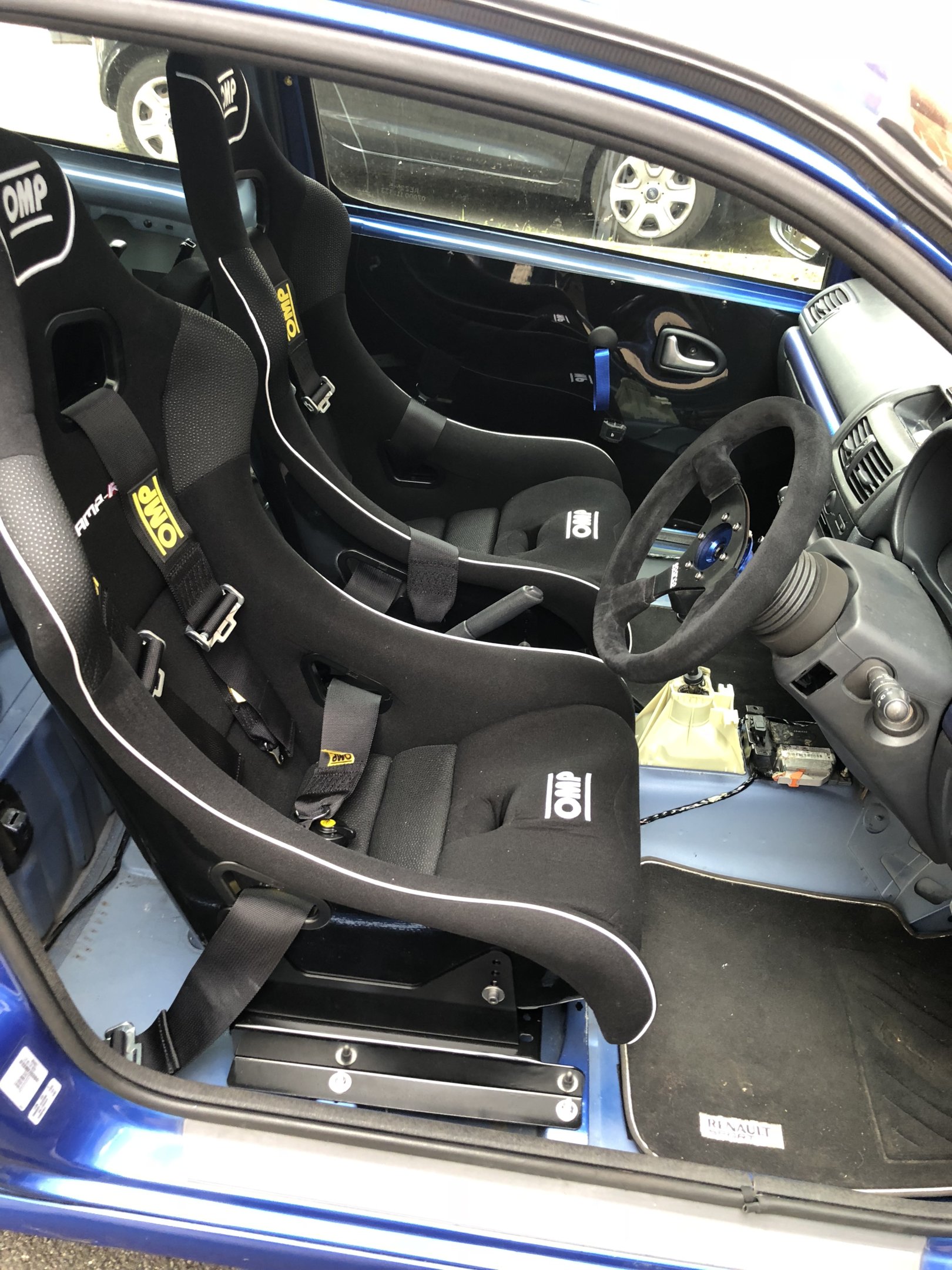

[emoji830]︎Wrap round OMP RS-PT bucket seat

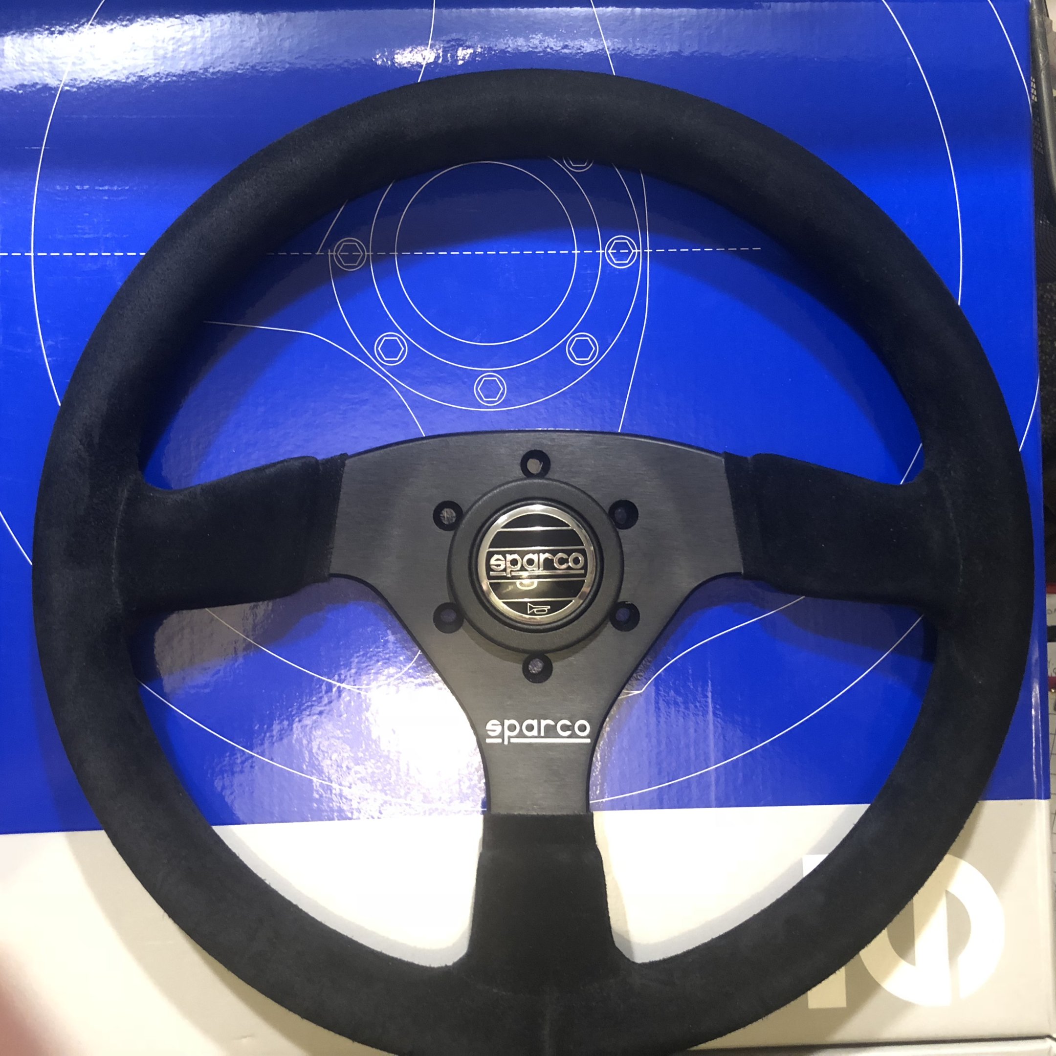

[emoji830]︎OMP Corsica 330mm x 90mm deep dish steering wheel.

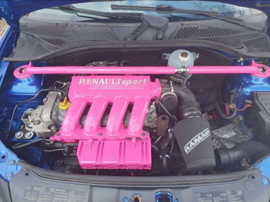

[emoji830]︎197 cams with 8 degree inlet advanced timing.
[emoji830]︎Port matched inlet manifolds
[emoji830]︎Remapped by EFI PARTS to 189.3bhp and 162lb
[emoji830]︎Ramair induction kit
[emoji830]︎Rollcentre correction kit by Northloopcup
[emoji830]︎Strengthening plated front wishbones
[emoji830]︎K-TEC Solid engine mountings
[emoji830]︎Evol dogbone
[emoji830]︎EPAS and BRT motorsport quick rack
[emoji830]︎Complete interior painted
[emoji830]︎Complete wiring loom stripped of all none essentials and reloomed in Tesa fabric tape.
[emoji830]︎Rear track door cards
[emoji830]︎CM composites foot plates
[emoji830]︎CM Composites front splitter and canards
[emoji830]︎Aero quick release bonnet catches
[emoji830]︎Also a load of remedial work done to the chassis to future proof any rust issue's.
[emoji830]︎Painted a few bits here and there in Pink
[emoji830]︎Gone through a couple sets of tyres.
[emoji830]︎Gone through a few sets of brake pads
[emoji830]︎3 oil changes
[emoji830]︎2 brake fluid flushes
[emoji830]︎1 gearbox oil change
[emoji830]︎Lightweight battery relocated to behind passenger seat.
Probably loads I've missed off.. This car has kept me sane during this lockdown period.
Just waiting for unlock now so we can get back out on track cause i really do miss driving this little Pig..
