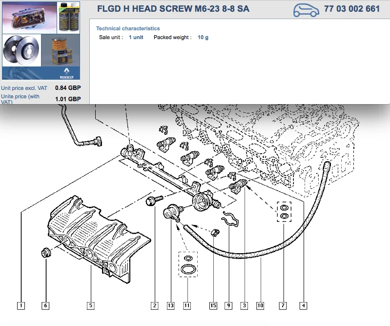

One of my injectors failed so I was just swapping it out, put the fuel rail back on and sheered the bloody bolt connecting the rail to the rest of the engine. Any idea what I need to replace it with and if I can get one from Screwfix or something tomorrow?

Item Number 11.

Thanks guys. They are indeed M6.... M6x20mm if anyone ever needs to know. Got a bag of loads of them from screwfix for about 4 quid and job done.
