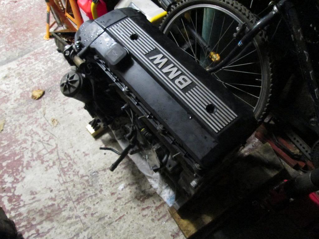

M52B28, same as whats in there now. Although, a steel lined block, not Nikasil. Unfortunately the amount of hassle the turbo conversions are (especially on RHD) it just does not interest me. If the exhaust manifold was on the other side it would make sense, but not with how it is. It would be easier to drop in a 6pot Jap engine with the turbo on the right side! More below..
So as mentioned previously in the thread, the engine likes to breathe oil quite a bit, and the compression is slightly down. If oil consumption wasn't increasing I would probably leave it and not bother, but it is slowly getting worse. The block in there at the moment has Nikasil bores (Aluminium cylinder coating) which were a known issue with these cars when they were released. The high sulphur content in fuel back then wore the bores out even quicker, and many were replaced under BMW warranty. The block was replaced with one which had steel liners.
I got hold of a low mileage steel lined M52B28, approx 70k miles, without any ancillaries. I could have just put it in 'as is', but decided for the cost of parts I may as well rebuild it so its the best a stock motor can be. It came with a few other useful bits, another set of coils, a metal thermostat housing, spare crank sensor, etc etc.

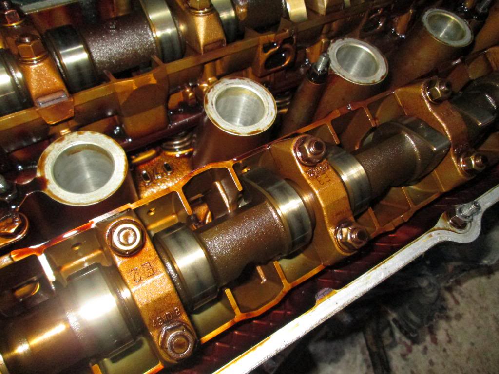

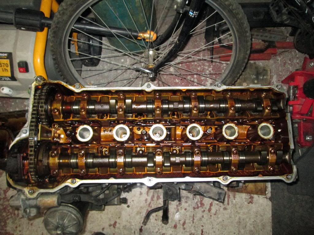

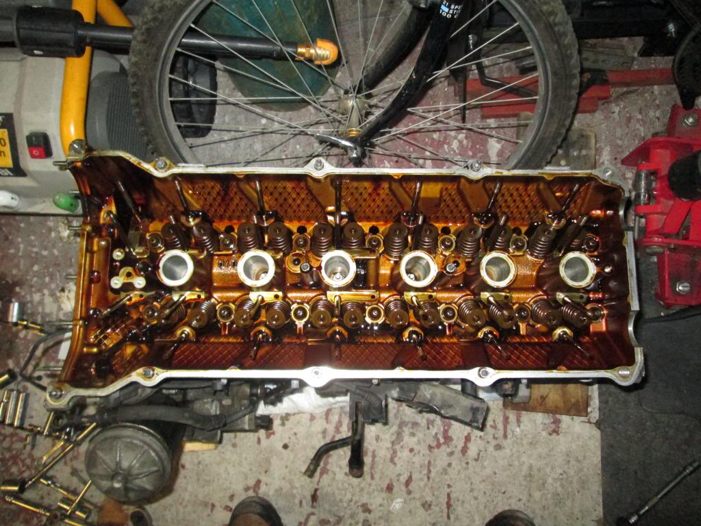

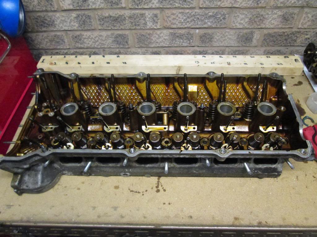

Removed the sump, oil pump and baffle so I could sit the block flat on some blocks of wood. Then removed the rocker cover..
In rather good condition with minimal wear..

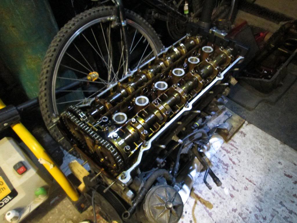

Put the engine to TDC and locked the cams. Removed the Vanos unit (which was in good order with minimal play, not like the one I previously rebuilt)..
Then removed the upper chain and tensioner, de-tensioned the main chain and removed the pulleys. Removed the cams, carriers and tappets..
Finished by removing the 14 headbolts in order and lifting the head off the block.. for a simple task there are many parts compared to an F4R!
The head gasket looks to be in good condition, as do the bores with honing still visible..
Next job is to remove the valves from the head, then strip the bottom end down so both can go to the machine shop. More soon!

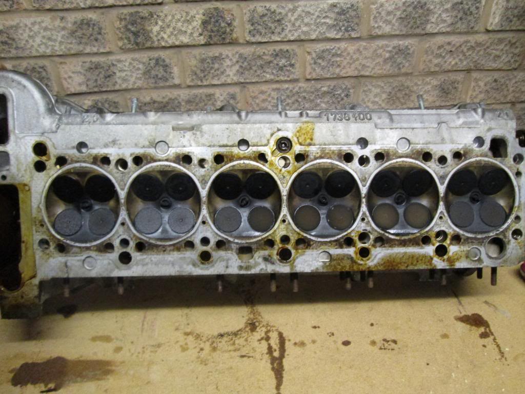

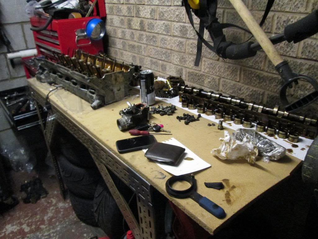

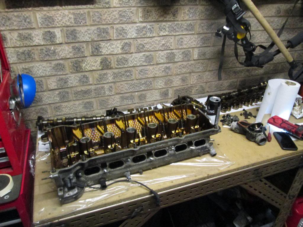

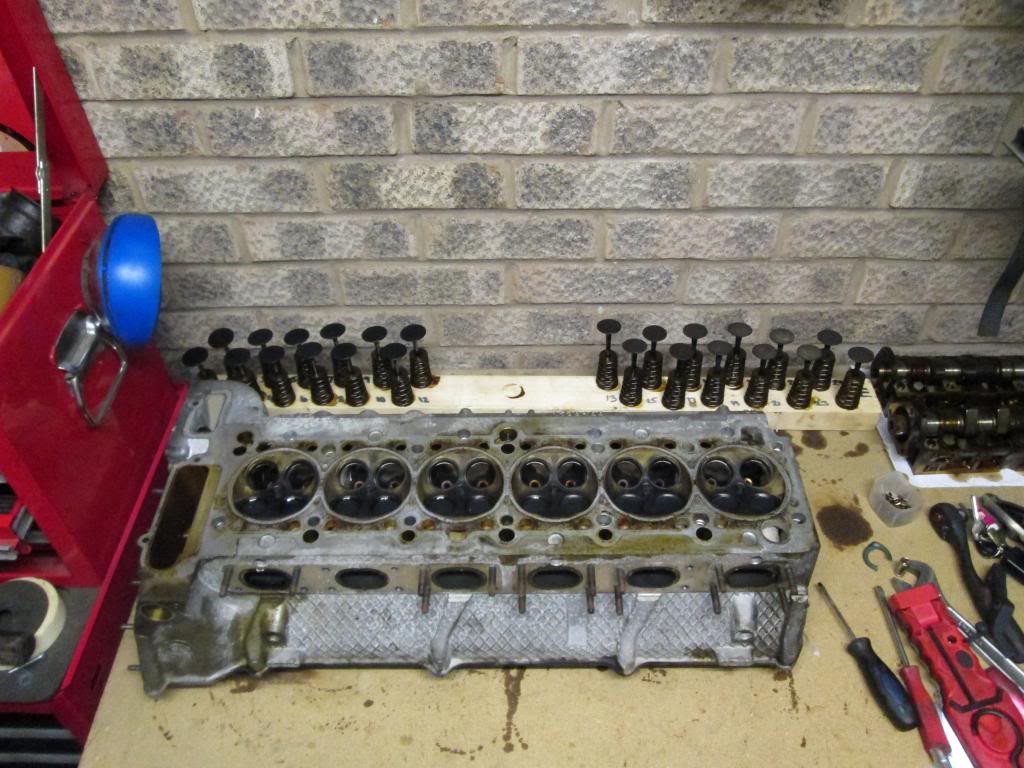

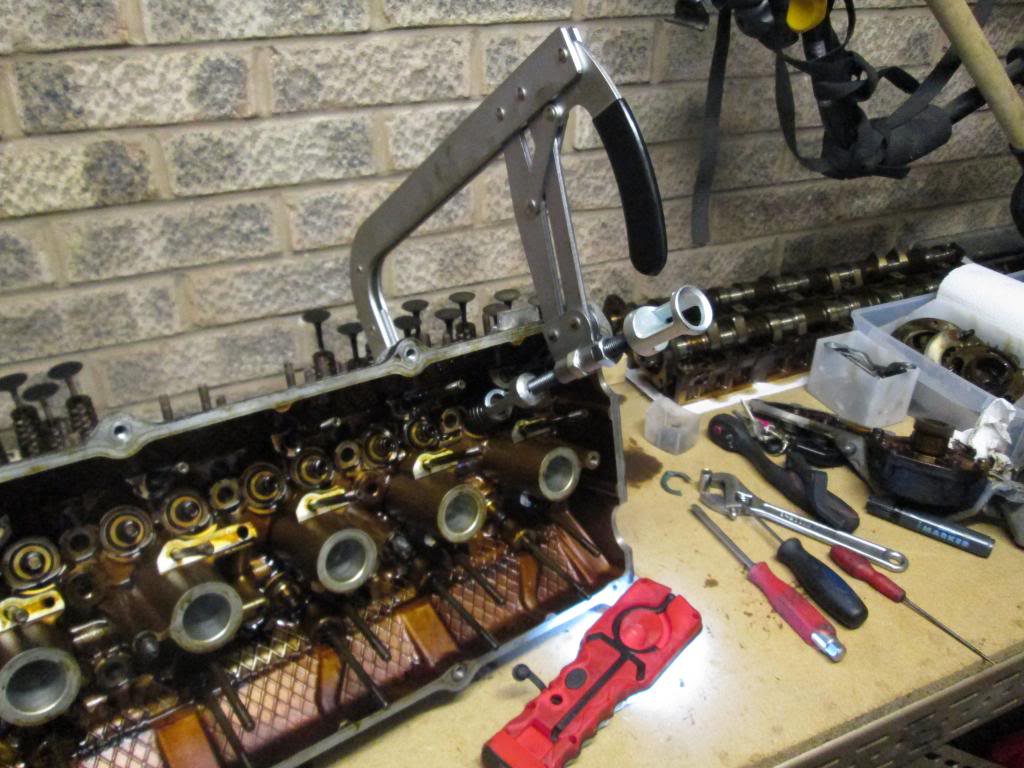

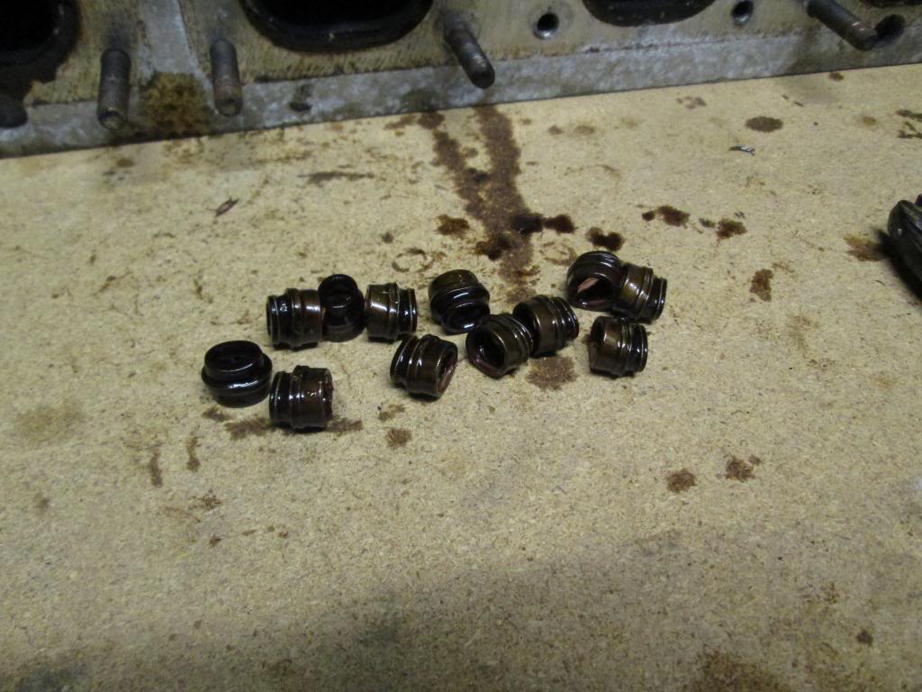

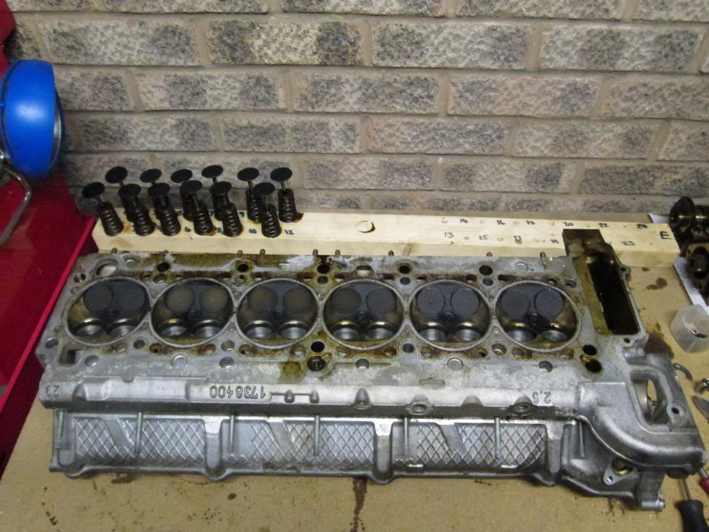

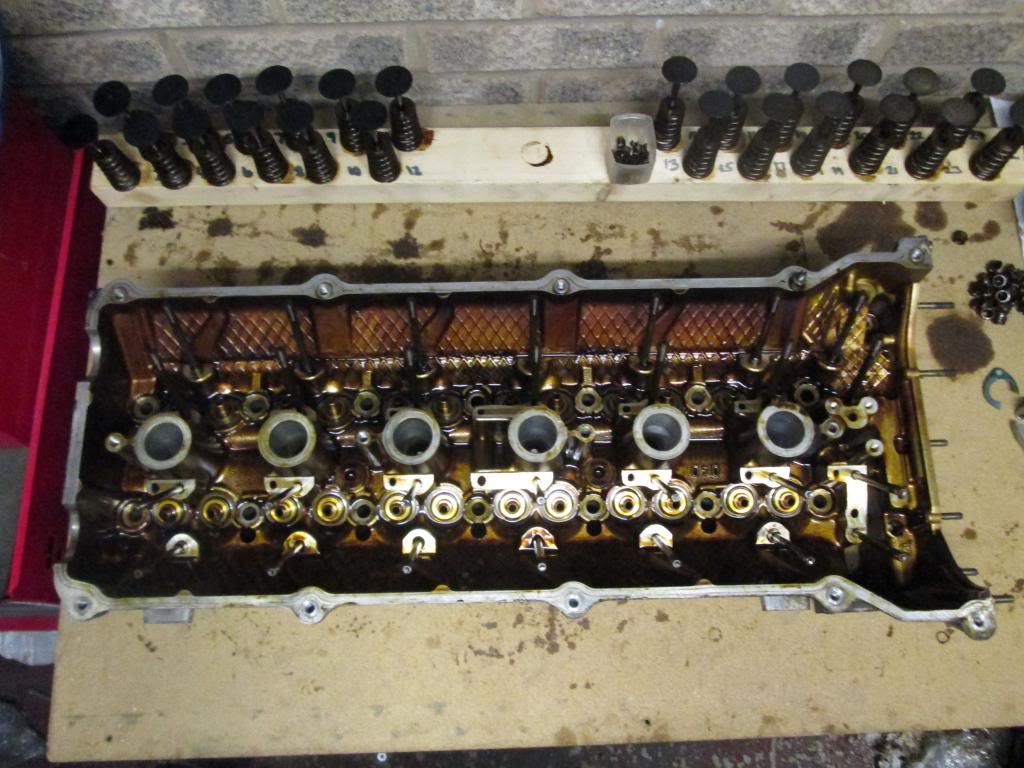

Had a bit of time before so stripped the rest of the head down ready for machining. Didn't take all that long.. :clown:
Started with removing the sensors and studs that will get in the way, then removed all the valves. Forgot how much I hate retaining collets.
Stem seals removed..
Ready to be skimmed..

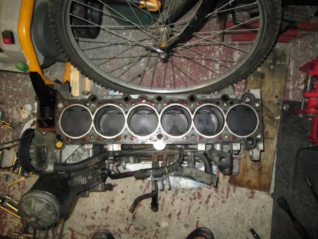

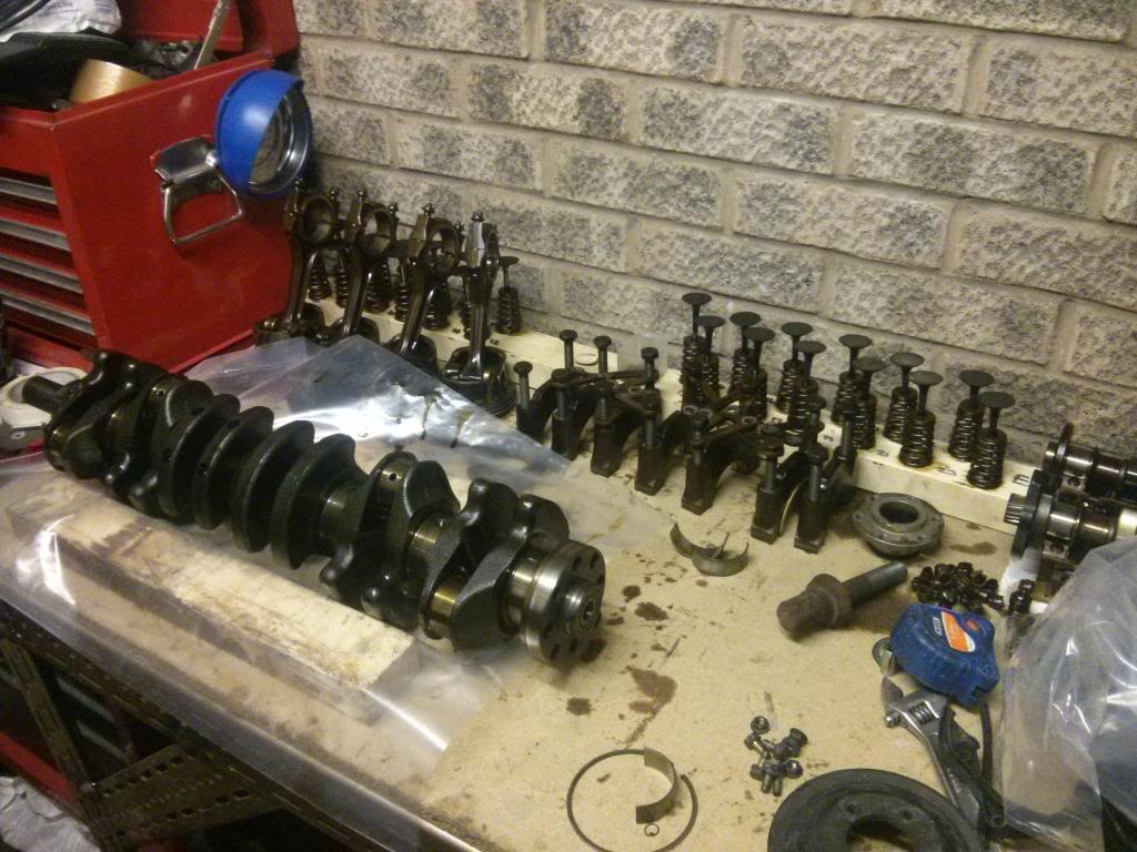

Bottom end stripped to a bare casing - block is actually lighter than the head, can pick it up with one hand :clown:
Dropped off the head and block at the machine shop for refacing and honing, probably have them back next week. Now to collect the rest of the bits.

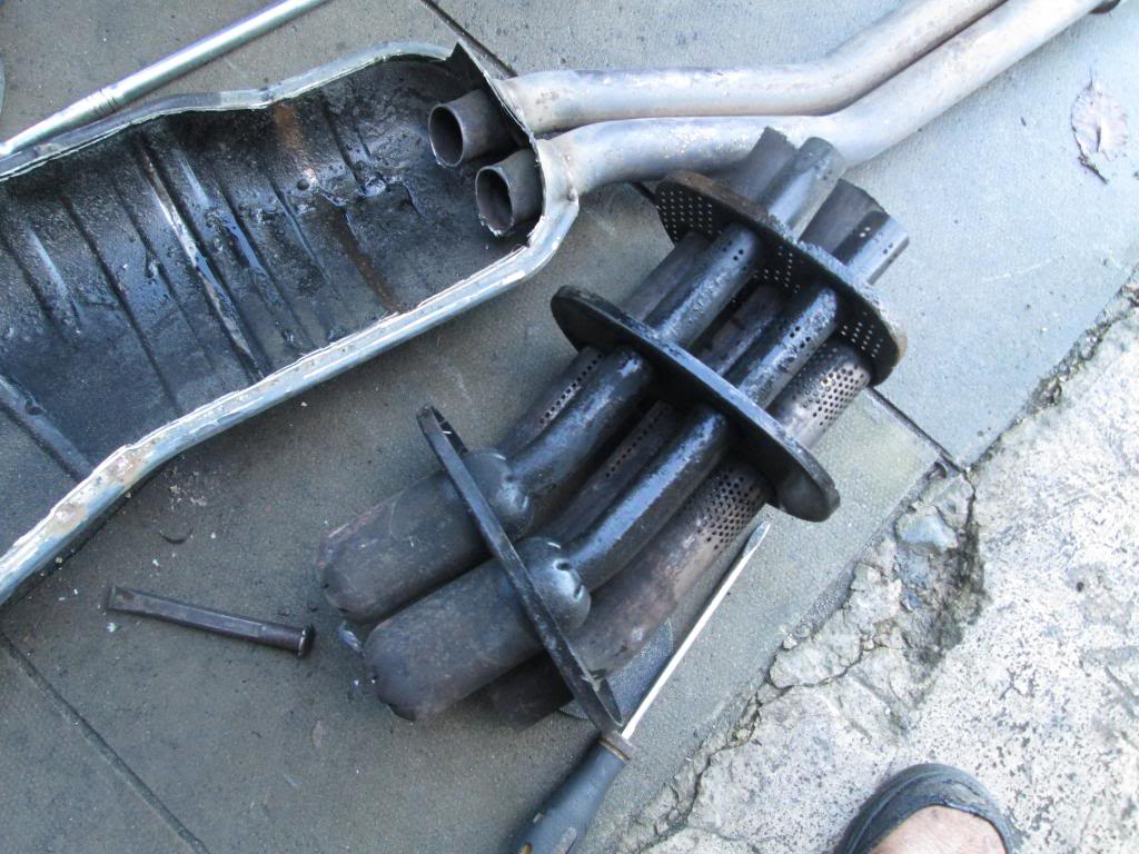

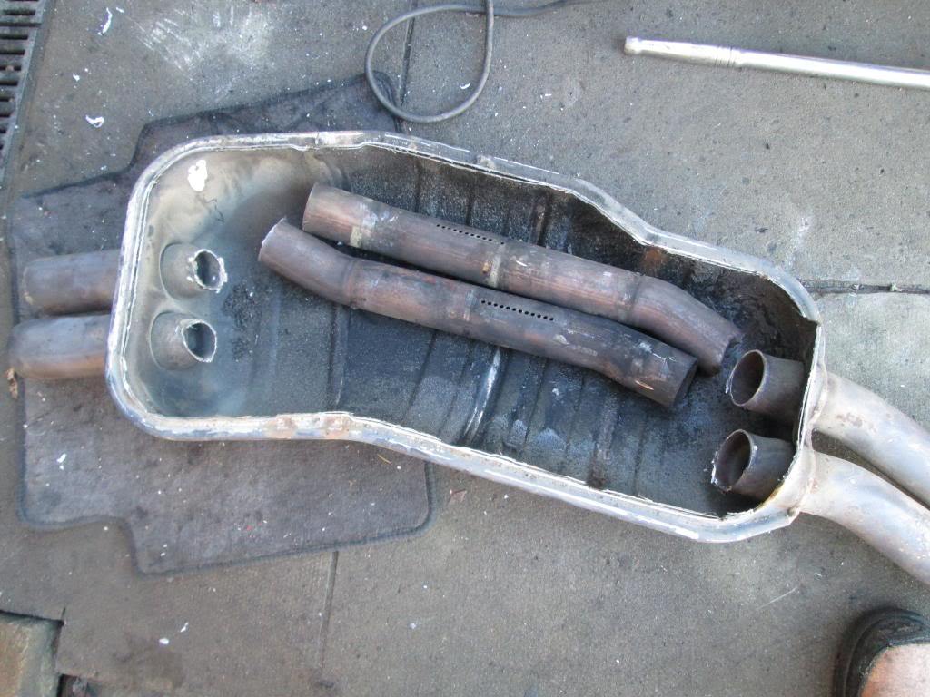

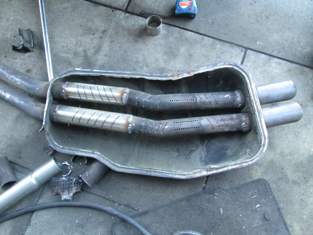

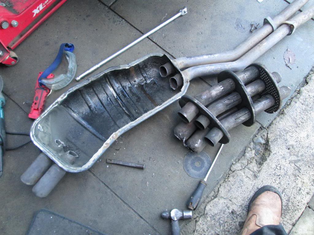

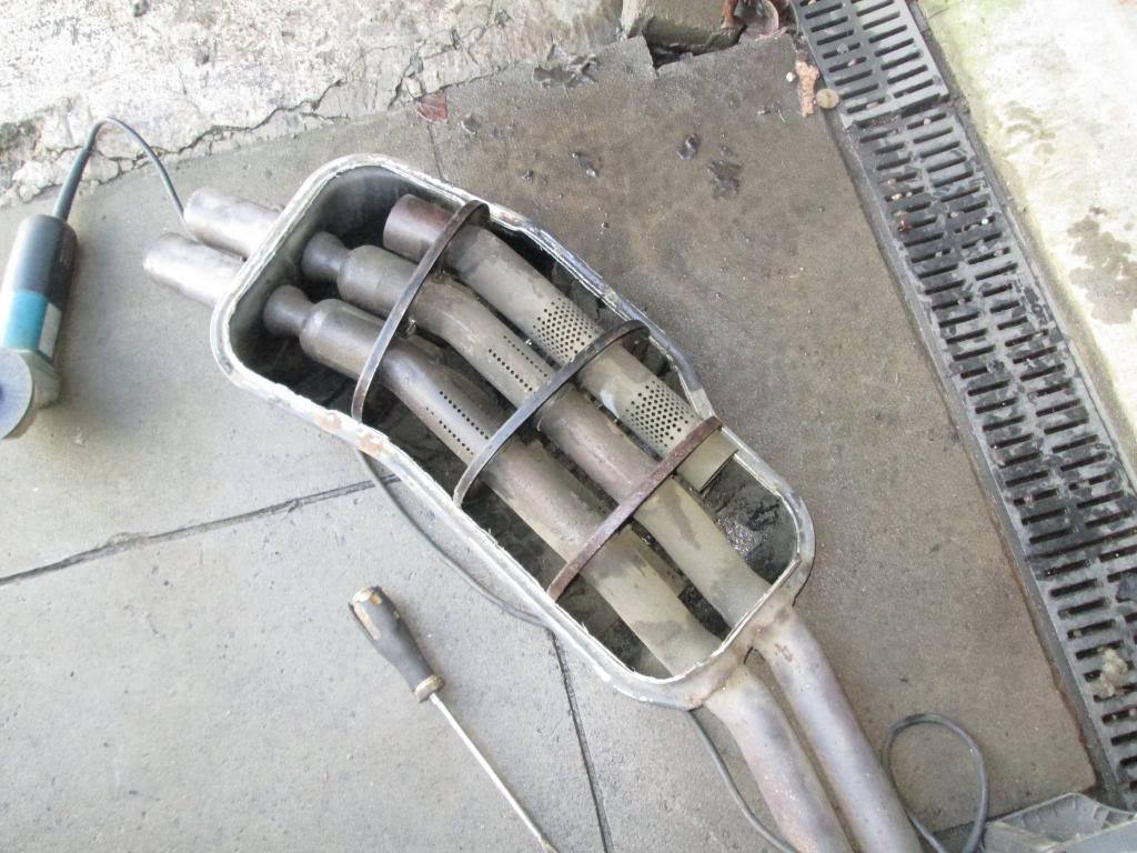

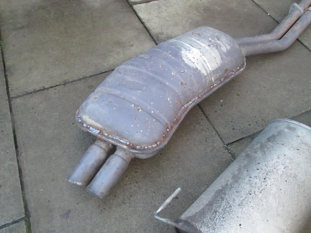

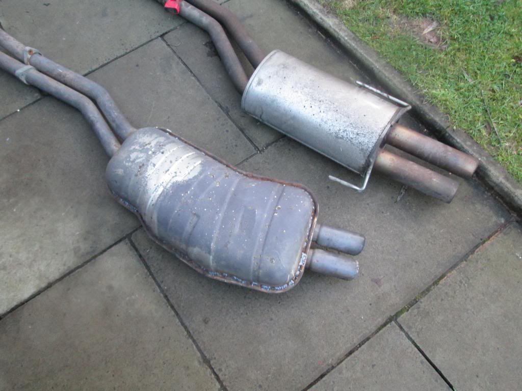

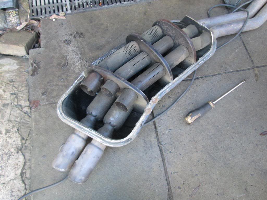

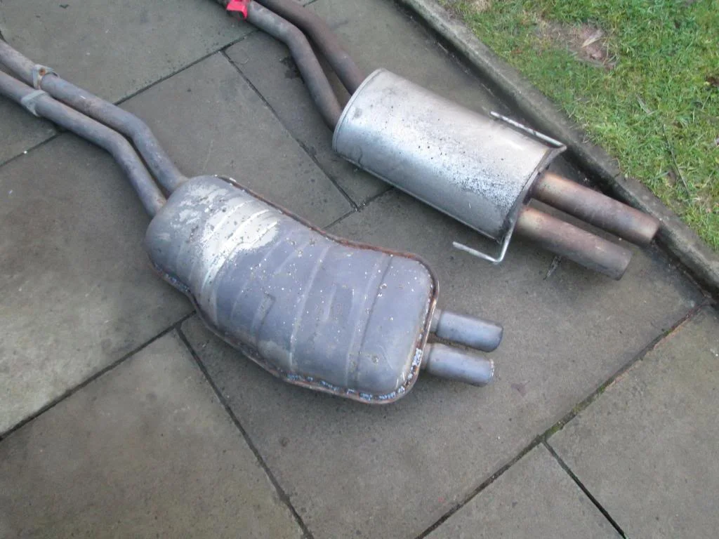

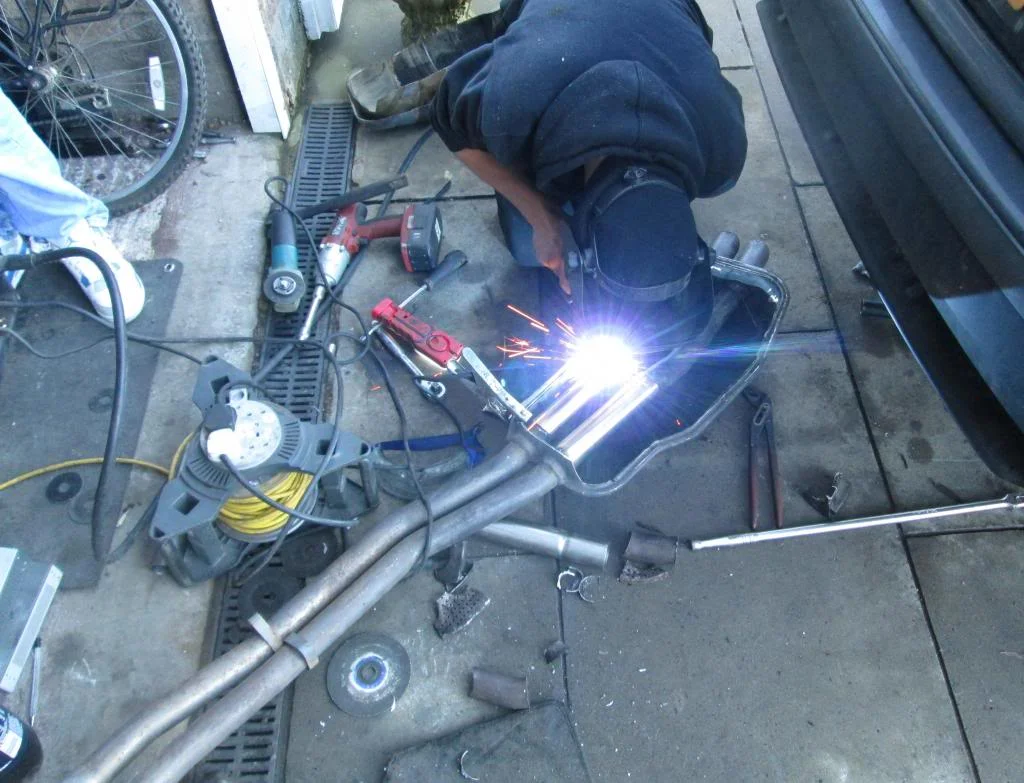

Had a couple of hours free today so thought I'd look at the exhaust. The one that the car came with was always a bit boomy - literally louder inside the car than outside. Not that it bothered me how it sounded outside, just wanted rid of the 'boom' from inside. A common mod is to gut a standard backbox, to give a slight bit more noise over a standard system but not over the top volume wise.
Started by cutting the top of the back box off to reveal the complex design beneith..
Cut it out from either end..

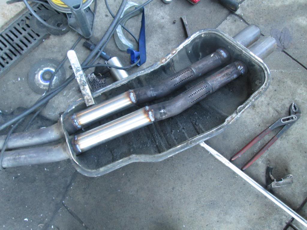

Instead of using all new pipe I just re-used two of the pipes..
After a bit of cutting to shape and welding them in place, it resulted in..
To take a bit of the 'edge' off the noise some slots were cut in the pipes..
Then finished by welding the lid back on..
Fitted it to the car and its much better. No 'boom', stock volume on idle, opens up with some rasp and volume on WOT. May change the tips at some point, but will see how it goes for now.

I cut it open again today, it was a bit too 'raw' on WOT. I've added some wadding and closed it back up, much better now. Swapped the tips over from the other exhaust too. Will get a couple of clips over the next few days!

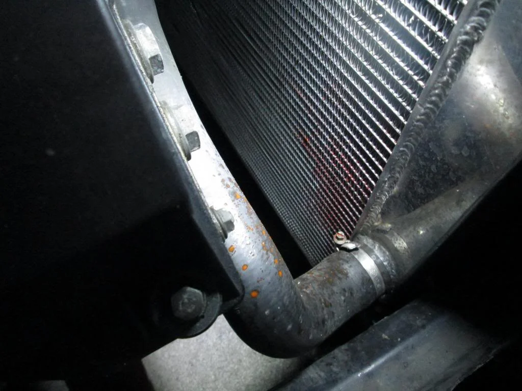

Deja-vu! The 'new' radiator from a couple of months ago started leaking a short while ago. Seems there must be a crack where the core joins the side tank..
It was randomly spraying coolant everywhere too. Contacted Driftworks and they didn't question it, sent a replacement out straight away. Fitted it and no more leaks :sleepy:

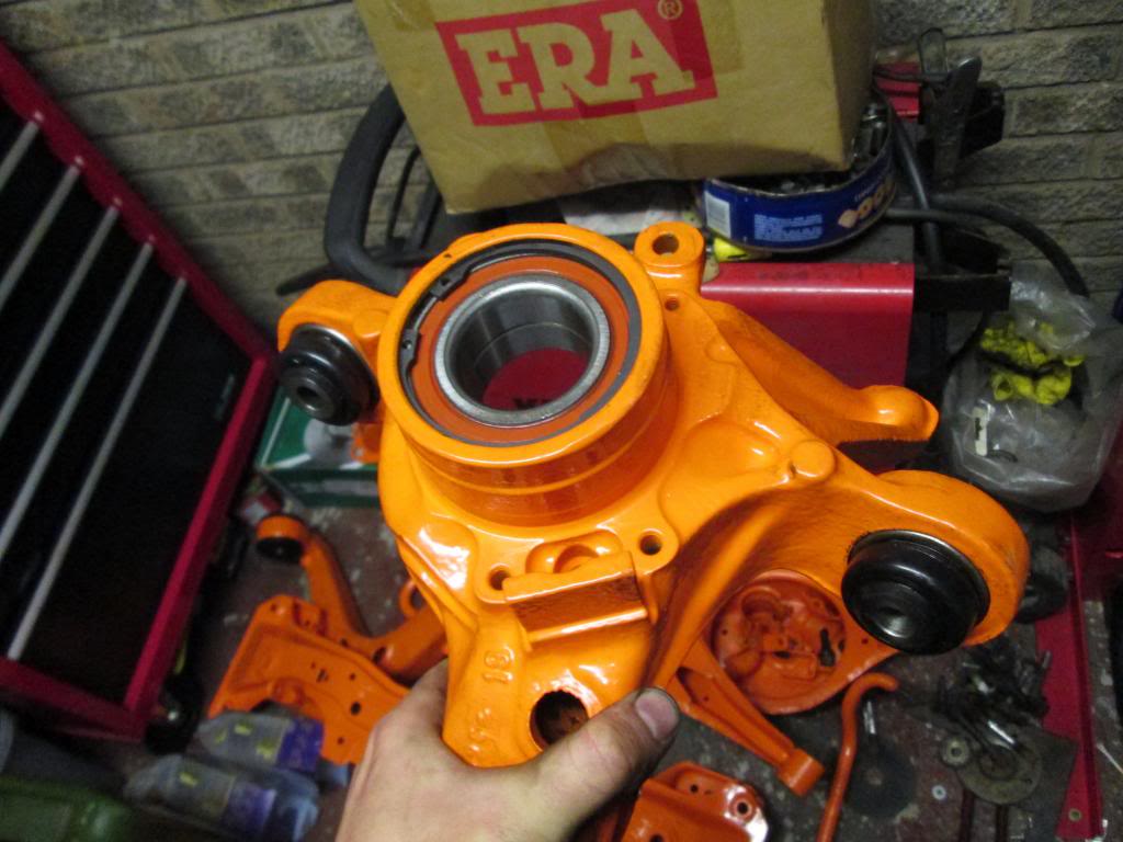

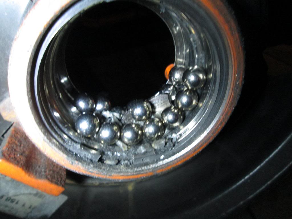

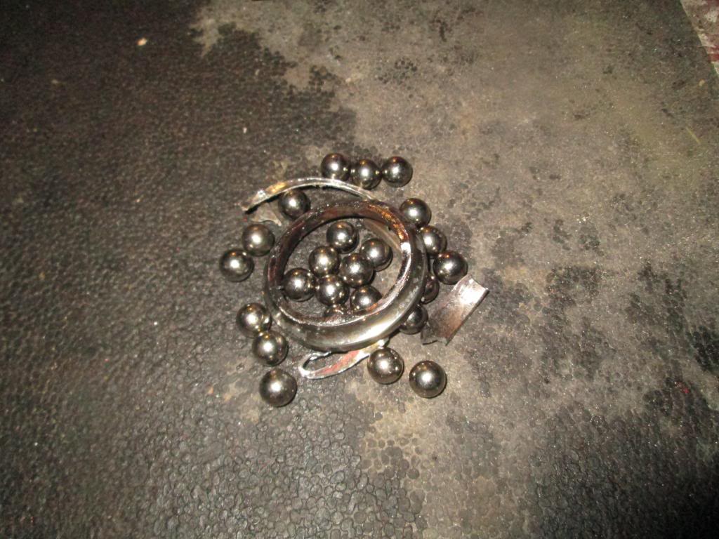

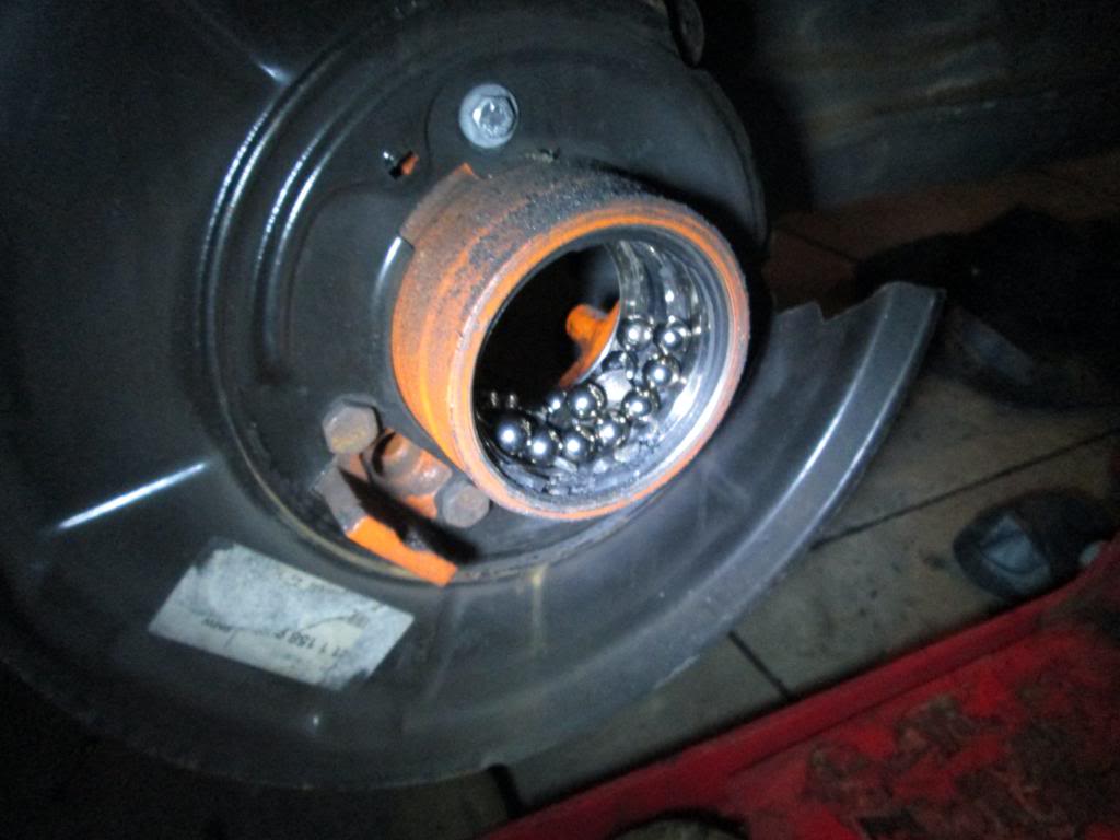

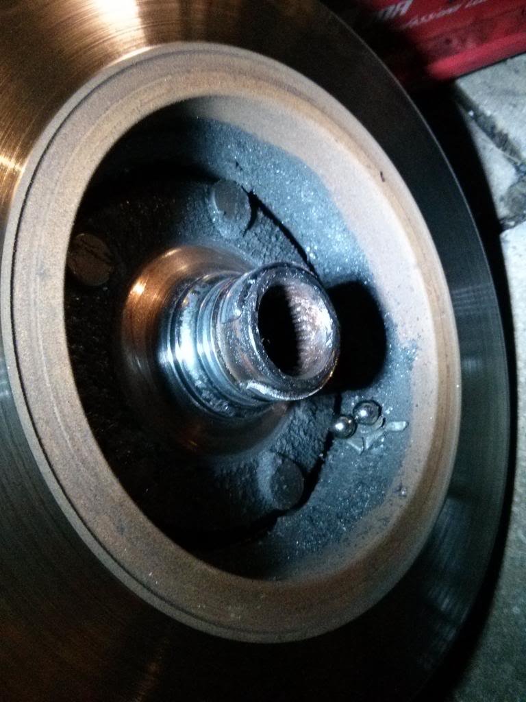

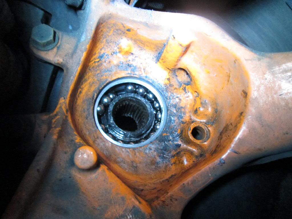

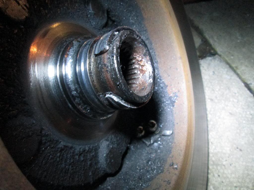

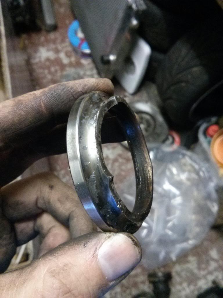

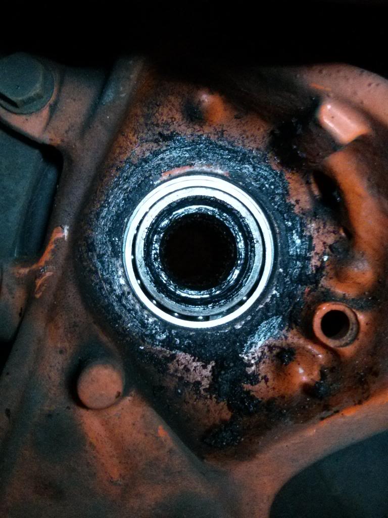

So remember new bearings were fitted to the trailing arms when the subframe was done?
Had a bit of a noise from the rear N/S, although there was no play in the wheel. Started clicking on rotation, thought it was the CV on the output shaft. Removed the shaft to find..
Just a bit of movement here..
Part of the inner race looks to have cracked and broken off..
Then removed the caliper and the disk/stub axle literally fell out..
Well that lasted a good 2 months! :banghead:
