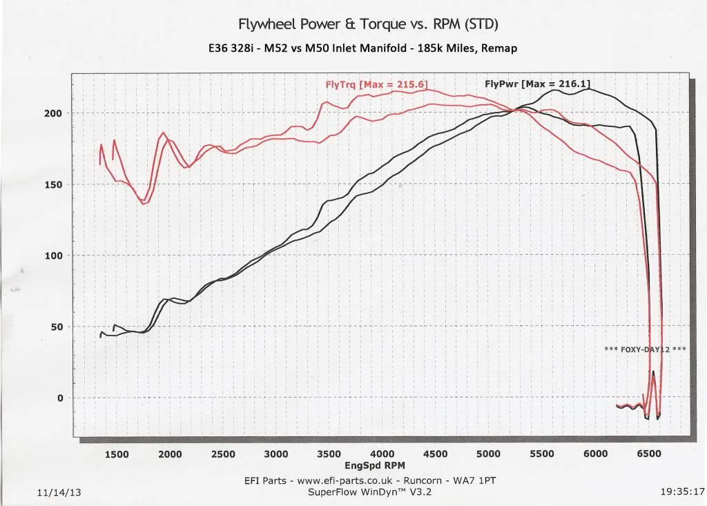

216hp. I will upload the graphs later. We put the old graph from the Blue E36 (Non M50 inlet, etc) over the top of it and you can clearly see the difference it makes. I guess peak power is slightly down compared to other cars of the same spec but its to be expected from a Nikasil 180k block with slightly low compression I guess!

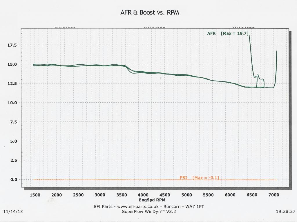

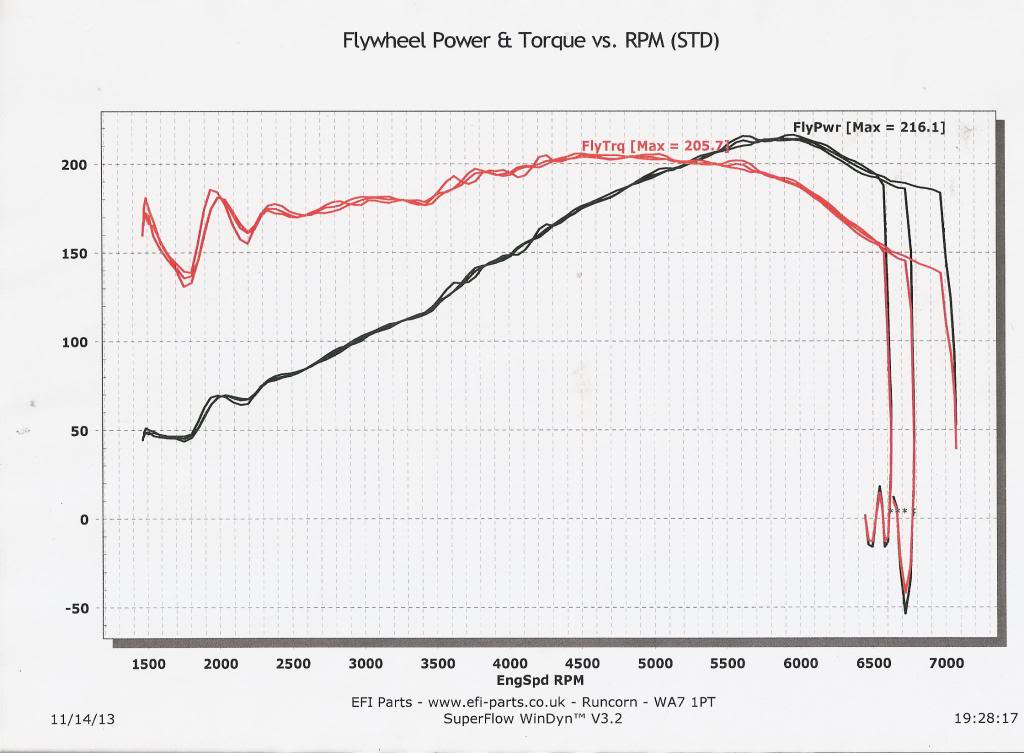

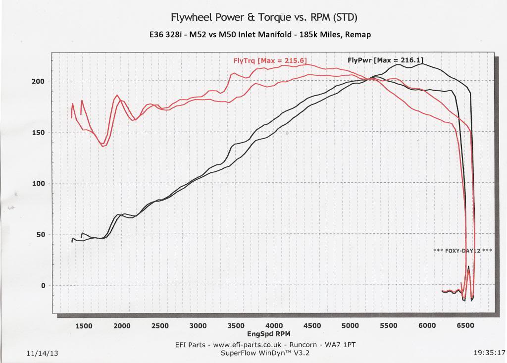

So continuing from the RR video, here are a couple of graphs..
Ended up making 216hp/205lbft..
Then we put the graph over the top of the other E36, without the M50 inlet..
Quite some difference. Lost 10lbft, but gained much more peak power. Its actually revving to 7300rpm, but the power tails off so quite pointless. Handy to have the revs though as we found at Oulton Park yesterday. Update on that later

Very interesting! Didn't realise the inlet/map made that much difference.
After seeing it out on Saturday I'm very impressed. It seems so composed as well.
Re: E36 v2
Its one of the 'must do' sub £100 mods really. The map to suit makes it better again. It would probably make more power/torque with a stronger engine compression wise but it still runs sweet so there isn't any need to mess about for now. It's really well balanced when on the limit
