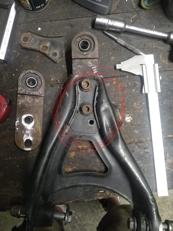

Saw a pic in my FB feed the other day of a cup racer wishbone.
It had some kind of insert in the outer end (for stiffening?)
Today i'm looking at the parts catalog, and it is not in there, did it only come with the wishbone?
NorthloopCup
Found another pic, it seems to be a seperate part.
thinking of making a set, as leverage on the wishbone has indeed increased.
It was a separate part to strengthen that part of the wishbone from the extra leverage. Worth pointing out though that the cup racers didn’t run the extra castor wishbones like you find on the 172 cup/182’s. The castor was taken car of by offsetting the mounting bushes, so the wishbone sat further forward.
