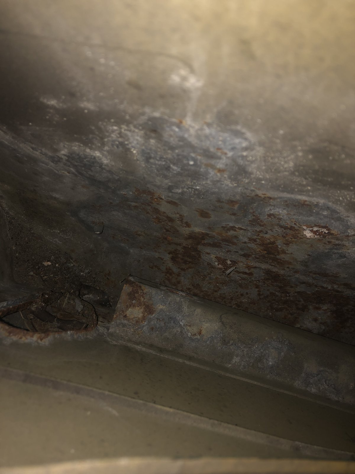

Lots of issues with phase 1s rusting inside out behind rear door cards. Is this a problem for the 182s? Sure I have seen pics of inner arches and it was waxed from factory. Am I correct or wrong?
Coops Mk1
  Lots of Scrap...
Mine wasn't, same as my 172 so I lathered it up when I treated the inner sills. Which had surface rust in them too, worse than the phase 1, so basically get your rear cards out and check imo

Mines not bad but there must be done shockers coming up and people don’t know. I certainly will not be buying any 182 without checking moving forward especially a trophy!

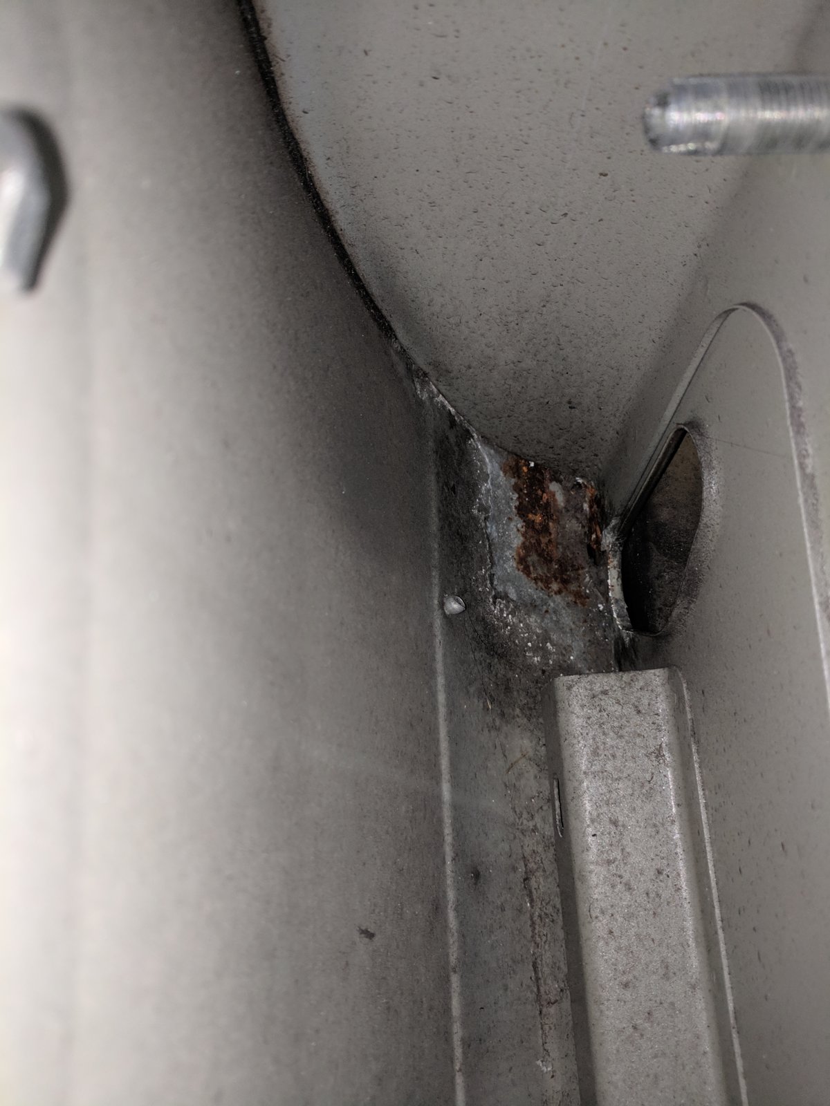

Looks similar to my rb that although gone further up the inner panel on yours to where rub strip mounts
Ant1
Brembo! Brembo! Brembo!

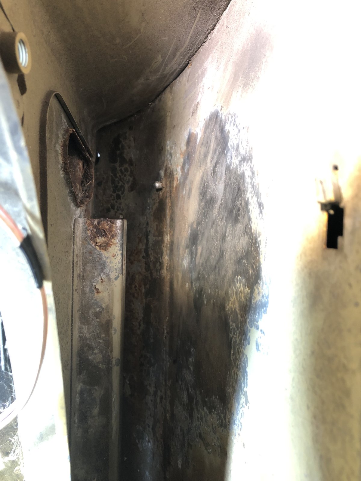

About halfway from bottom top side strip, I wire brushed higher to make sure nothing was left.
Coops Mk1
  Lots of Scrap...
Exactly what I did, wire brushed lot, then over few days good few coats of hydrate 80 then few coats of hammerite with waxoyl
Ant1
Same process really, only use bilt products.

No didn't bother with actual paint, just the bilt hamber hydrate then hammerite wxoyl

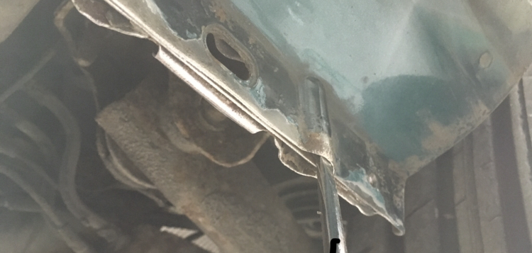

Drivers side looks like had plate repair anyway? Or that just trick of light in pic?

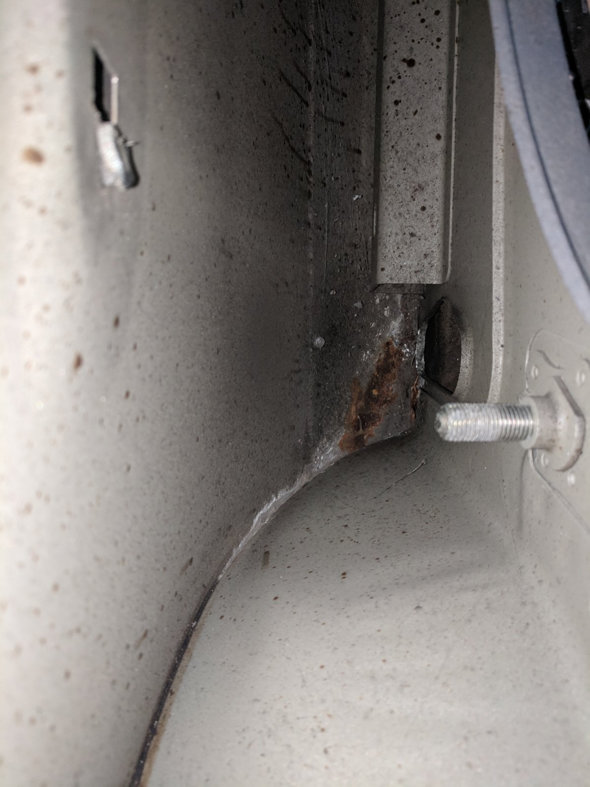

My 2002 172 had wax oil or similar all around the sill area, considering the rest of the car it was in better condition than I'd imagined
DomP182
  ph1 172, Arctic182
It was rather dirty with a colony of spiders though, would it be advisable to flash it out with soapy water and rinse before a dry out and relax?

Yeah can do but use a damp cloth rather than poor water down there. Make sure you can see daylight In the very corner (drain hole) i would advise this hole is poked every year to make sure it’s clear.
I use a Allen key.
