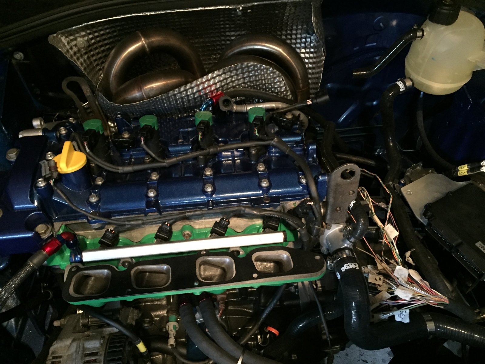

Not the best of pictures, but if you zoom in it's to the left of the lifting eye.
  Clio 182
Awesome, doesn't look like it's an easy retrofit... I'll look at sorting it using a different sensor
